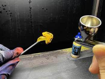

And remember, light colors like yellow and white need more coats to build up the color. Naturally less opaque than other colors, white and yellow can seem almost transparent as they go on, allowing the base coat or primer to come through. A pink primer under yellow paint provides the perfect vibrancy, and gives an almost orange hint to the paint. If you don’t want that, white primer is best because it won’t change the shade of the yellow like gray or black, which will give the yellow a greenish hue.
For painting Mecha Color Sand Yellow, I thin at 6:1 paint to mixing sauce; this is because yellow is a bit more translucent than other colors. I want to be able to build a rich color affected less by the color of the underlying primer.

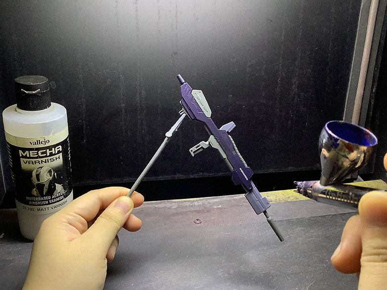

After you’ve completed your base coat, seal the paint with matt/flat, satin/semigloss, or gloss varnish (clear coat), depending on the look you’re going for. I’m using Mecha Color Gloss Varnish (No. 27.701), which will provide a smooth surface for decals and panel lining.
Let the varnish cure overnight in a dust-free area or put it inside a big plastic container to ensure no debris or dust gets trapped in the clear coat. When it’s dry, assemble your Gunpla limbs and weapons before applying decals. This tidies your workspace and prevents you accidentally losing small parts.
A tip about clear coats
If you plan to use water-slide decals, apply a gloss varnish to your model. The smooth surface will expedite decal application and minimize silvering (when the decal doesn’t adhere completely). After you’re finished with decals, you can go over the part with a matt or satin varnish for your preferred appearance.
