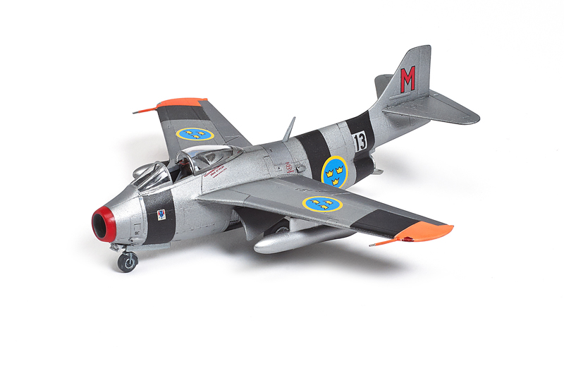

This is a limited-run kit, so expect to exercise your modeling skills to get the job done. I generally followed the instructions, which have you start with the cockpit. Detail here is a little soft. But the resin seat is nice; it just needed some tape belts/harnesses and a wire ejection handle to make it look better. Be sure to add plenty of ballast to the forward fuselage to keep the jet on its toes.
With a modest parts count, construction proceeds quickly. I did leave off the exhaust (Part 14) until the end so I could use the opening to insert an old paintbrush handle to hold the model while painting.
The only areas requiring additional attention were the wing/fuselage joint and the wing-mounted pitot tubes. On my model, the wing roots were slightly thicker than the corresponding stubs on the fuselage. Careful sanding will remedy this situation.
Regarding the pitot tubes, there is not much purchase where they join the wings. Rather than drilling holes in the wings, I filed notches and super glued the pitot tubes. Then, I sanded the areas flush with the wings. Predictably, I broke one off near the end of the project.
Early on, I decided to do the version with the black exercise stripes and day-glo orange wingtips. First, I sprayed on Alclad II black primer. Then I masked the stripes; Tarangus thoughtfully provides the dimensions for these.
Next, I used Alclad II dull aluminum as a base and sprayed other metallic shades for contrast. In retrospect, the model looks too dull to me; I should have used a different base color.
I sprayed the fluorescent orange panels with Testors enamel over Tamiya white acrylic. The external fuel tanks remained natural metal. The decals were excellent. They were opaque, easily moved into position, and settled into the recessed detail without any setting solution.
Tarangus has given us a really nice model of this important early jet fighter. A beginner who has completed a few models can handle this build. I spent 23 hours on my Tunnan, with the masking and painting consuming a large portion of that time.
