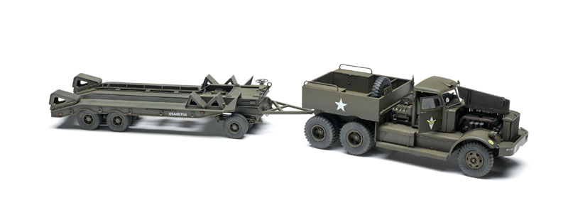

Early in World War II, the British needed a vehicle capable of navigating narrow country lanes to transport tanks stocked in central England to the front in the event of an invasion. Diamond T Motor Car Company of Chicago, Ill., produced a unit that met British as well as U.S. Army standards: the 12-ton 6 x 4 M20 Diamond T Model 981 and M9 45-ton trailer. Together they were known as the M19 tank transporter.
Merit International has made a splash with the M19 as its first 1/35 scale release. It’s a big model: 698 plastic parts molded in dark yellow, with clear-styrene lights and windows. There are also 37 vinyl tires, two photoetched-metal frets, and a piece of string for the winch cable.

Based on the markings, you have only one color choice — olive drab. British vehicles in the Mediterranean and North Africa had some colorful schemes, but you’d need different markings.
I gave the model a coat of Vallejo olive drab primer followed by Tamiya olive drab for the primary color. Spraying olive drab lightened with Tamiya yellow green imparted some color modulation. On the trailer, LifeColor olive drab provided some variation. I painted details with Vallejo, Humbrol, and Testors Model Master colors and weathered with various Mig and AK Interactive washes and filters.
The decals are some of the best I’ve ever used — easy to move without tearing and drying dead flat with no silvering. The finished model is absolutely stunning.
