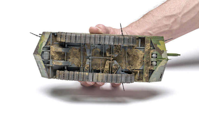

Next came the lower hull. I recommend prepainting the rollers and their housings. There is some play in the placement of parts A23 and A9 in Step 18, and parts A10, D41, and D42 in Step 22. To aid alignment, I temporarily attached parts E2 and E3; then the top return rollers can be snapped into place.
Steps 27-33 assemble the lower suspension. This assembly is fragile and needs care to avoid breakage during subsequent building and painting steps.
I did not follow the assembly sequence in Steps 28-31. Instead, I glued the inner road-wheel brackets to the lower plates first. When these were dry, I glued the wheels and outer brackets. I had to trim tabs on the inner and outer brackets to fit them into the grooves on the lower plates. Then I went back to add all of the support brackets and other details I had skipped. I did have trouble getting the U brackets (A13) to align with the base plates (A2).
I painted the hull floor and road-wheel assemblies with Tamiya dark gray (XF-24). Then I glued the floor plate and the lower plate (E34) to the upper hull.
Each track link is made of three parts; it takes 36 links per side. They’ll be workable if you are careful. Make sure the first track link has an extra set of loose parts (parts B2 and B3). These connect the ends of the track when they are placed on the tank. Then you can glue the final track shoe to complete the run.
I painted the tracks Vallejo Model Air black gray and weathered with AK Interactive washes and powders and Vallejo Panzer Aces rust colors.

The decals adhered well over a gloss coat with no silvering. I did have to use Solvaset to lay them into some of the details on the hull, and I punched holes for the large rivets. Mig washes and AK Interactive streaking colors finished the weathering, and CMK powders added a touch of mud.
With only 488 parts, the model took a surprising 40 hours to finish. Most of the time was spent assembling the tracks and painting the complex paint scheme. With no photoetched metal included, it is an uncomplicated build for anyone with a little experience.
