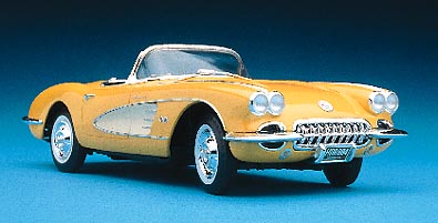

Using Testor Model Master paints, I modeled color scheme 520B: yellow body with ivory coves. The charcoal gray interior is unique to 1958.
In step 20, the windshield illustration seems backward – the windshield fits into the frame from the rear, not from the front as shown. The windshield provided in the kit has some distortion (probably from its thickness), and seems to curve from top to bottom more than it should.
A convertible top with a clear rear window buttons up the Corvette, but I wish a removable hardtop had been included, too. Ignition wiring would also have been appreciated, but it’s available on the aftermarket.
The kit’s decals are thin, strong, and went down properly with a light application of Solvaset.
The finished model looks great, has the correct stance, and scales out closely to the dimensions in the Illustrated Corvette Buyer’s Guide by Michael Antonick. Beginning modelers may find this kit challenging. Experience with self-adhesive metal foil and lots of close-fitting parts will be helpful. I spent more than 31 hours on this kit, more than usual. However, my collection of Corvette kits is growing, and this one is definitely welcome.
