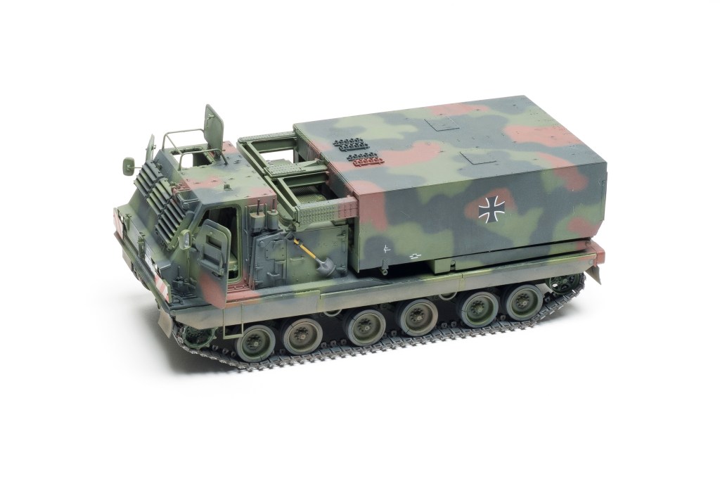

I painted the vehicle with Tamiya NATO green, brown, and black, then added the decals over clear gloss; they responded well to Micro Sol. After applying a flat black wash, I sealed the markings with Tamiya clear flat.

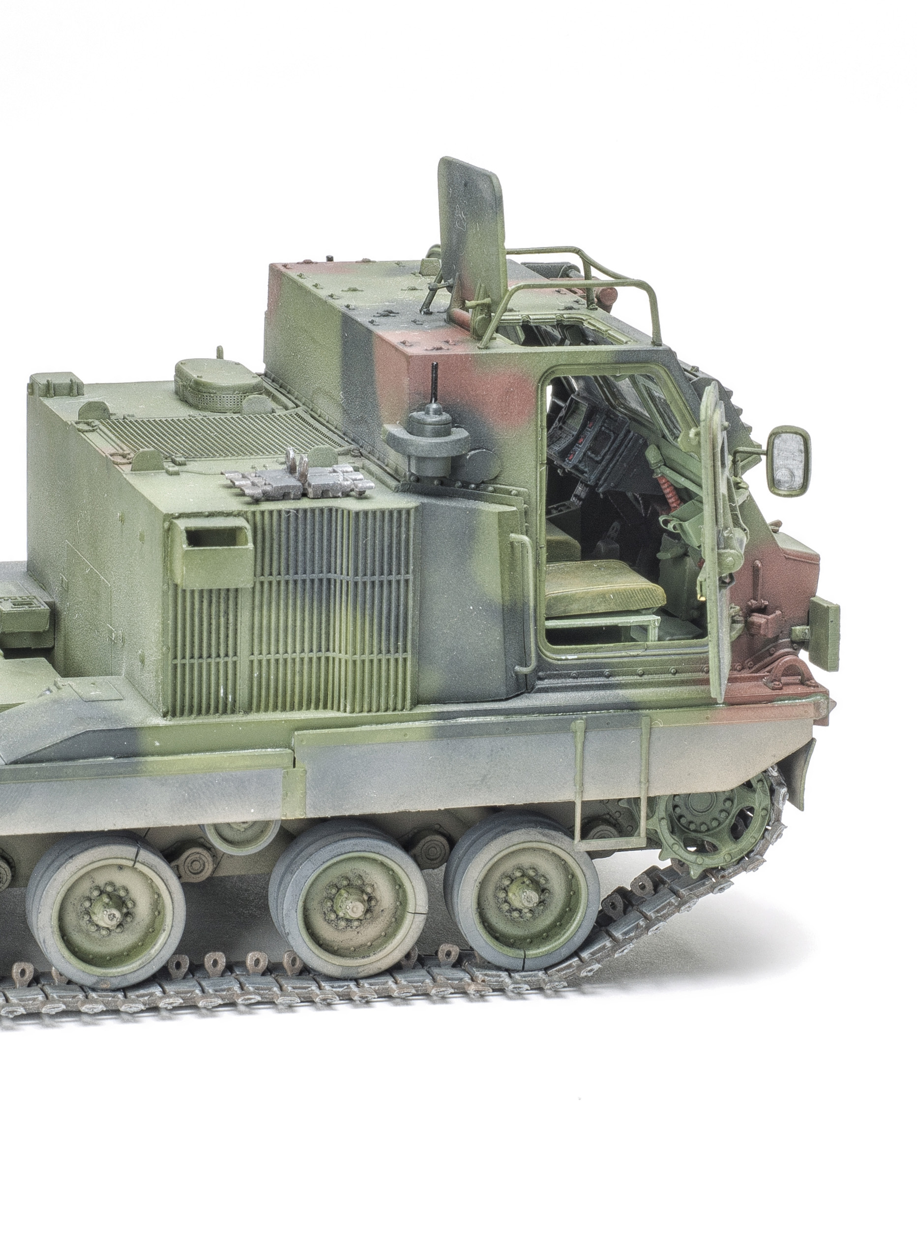

Finally, I added the tracks, starting with the tedious process of cleaning each link and adding the guide teeth. I had problems aligning the teeth, so I made a small jig to build about 10 links at a time.
The links click together, but the connections lack strength and several separated during installation. My solution was to make two sets of tracks for each side, one for the upper run, the other for the bottom. (The instructions call for 87 links per side, but I used 85 instead for a taut set of tracks.) Then, I ran Weld-On 3 down the center of each run with a Touch-N-Flow applicator. After 20 minutes, the glue held the tracks but the runs were flexible enough to bend around the drive sprockets and idlers. Once everything was aligned, I glued the tracks to the running gear.
While installing the tracks I heard a strange snapping noise, which turned out to be all but two of the outer tires cracking from stress. I didn’t use glue for the tires and the fit was snug, so perhaps gluing them might prevent the cracking.
I spent 47 hours building my M270. While the kit presented some challenges the finished model looks great. I think any armor modeler with some PE experience and without a fear of individual-link tracks could handle this kit.
