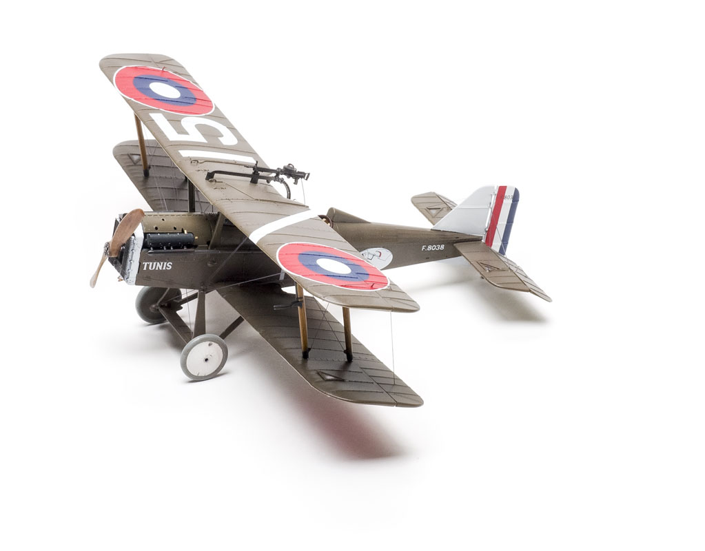

Closing the fuselage proved anticlimactic after all the interior work; I used a bit of putty to blend the aft join. The rest of the airframe assembles just as easily.
I left the cowling loose so it could be removed to display the nice engine. I replaced the kit’s plastic radiator with a more detailed Brassin set (No. 648298), removing the square radiator cap from the upper cowl for fit — this wasn’t mentioned in the instructions.
Triangular projections on the radiator’s rear must also be removed. I left the engine and radiator off for painting.
I prepared the model for painting by installing the control-cable inspection windows. The kit parts were too big, so I replaced them with .005-inch clear plastic. All the masks were installed, and the model painted with Tamiya acrylics: deck tan (XF-55) with desert yellow (XF-59) shading for the lower surfaces, and a mix of khaki (XF-49), olive drab (XF-62), and flat brown (XF-10) on the upper surfaces.
Decals were applied with help from setting solution; the white was nicely opaque. It’s disappointing that Eduard did not include either masks or decals for the narrow red rings on the wheels for the color option I chose.
I attached rigging to the upper wing using EZ Line, then installed the center section cabane struts using a business card template marked for proper spacing. Once the struts were dry, I installed the upper wing followed by the outer struts. The struts and landing gear fit well. A little trimming was needed for the rear gear leg mounts. Clear diagrams made rigging easy. Finally, I added the Lewis gun and propeller.
I spent a little more than 34 hours on my SE.5, much of it painting wood grain and details; rigging took time as well. The finished model captures the utilitarian look of the real aircraft superbly. I can’t wait to see the next kit in Eduard’s growing WWI stable.
