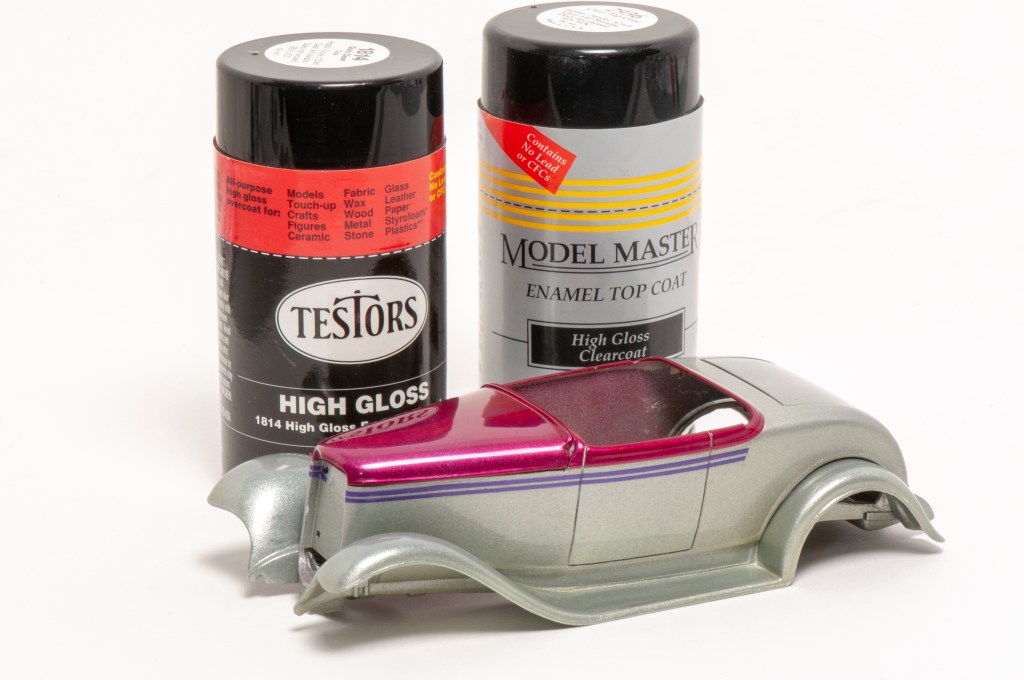

Testors/Model Master High Gloss Clearcoat Enamel
Pros: Glossy and smooth finish when appropriately polished after it’s dry.
Cons: Slow to dry. Yellows over time, which is most visible when used over white, pales colors, or silver paints. Modern enamel formulas area somewhat less forgiving than their 1960s-1980s equivalents. Testors has been reconfiguring its hobby paint lines in recent years and availability may be affected.
Advice: Use with a dehydrator to hasten drying time and fully harden paint surfaces. Consider trying one of the lacquer-based alternatives described above and see which results you prefer.
