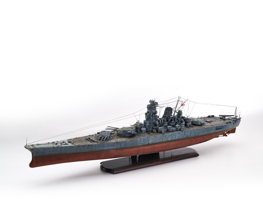

Final Thoughts
Having finally experienced this monster, it has now given me a whole new appreciation of large-scale ships. If you are a Yamato or Musashi fanatic, or interested in large ships and love PE, then this model is for you. It will take some thinking and test your skills, but it’s a satisfying journey all the same. Just make sure you have the real-estate to display it!

Occasionally, a kit comes along that takes the modeling community by storm and this is one of them. Only one word can describe Gallery Models’ Yamato — massive!
This kit arguably holds the record as the largest injection-molded plastic kit ever produced at almost 5 feet long. The box contains more than 2,800 parts and 15 photo-etched metal (PE) frets and weighs 21 pounds. It marks the first 1/200 scale kit of this World War II behemoth since Nichimo released one way back in 1968!

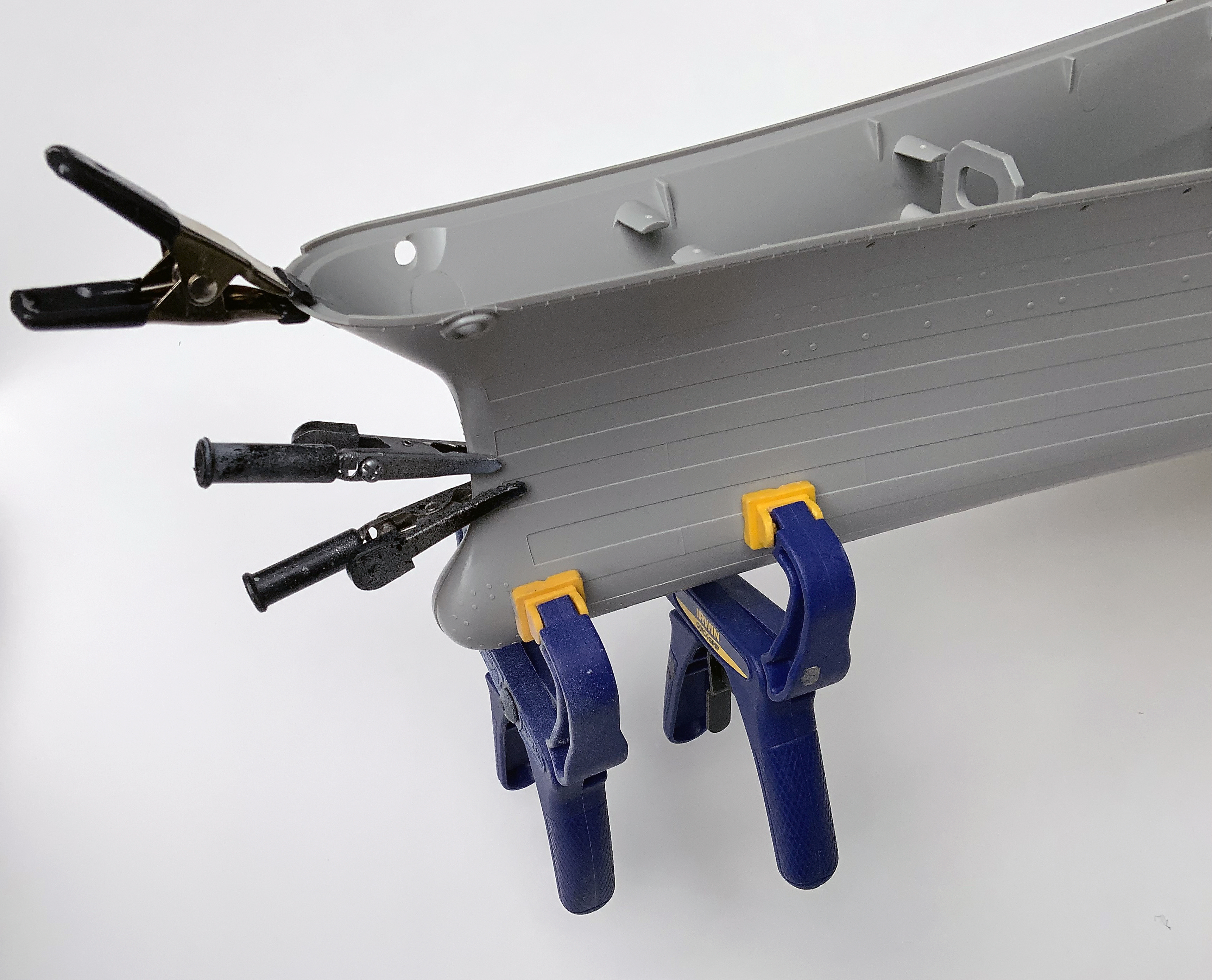

The hull comes partially assembled with several hefty metal U-shaped metal braces supporting it, 6. While you are required to re-tighten the screws, do not tighten them too much or you risk warping the hull resulting in an ill-fitting deck!
With the brackets in place, I ran liquid cement along the center seam, 7. To ensure the long seam stayed together, I reinforced sections with 5-minute epoxy and thick styrene sheet.
Clamps kept the bow and stern together and aligned as the glues set, 8.
Before adding the main deck, I glued styrene blocks atop the large ejector-pin marks inside the hull to help support the part, 9.
Although the kit features mostly good fits, the starboard side needed encouragement in the form of a large bar clamp to meet the forecastle deck, 10.
