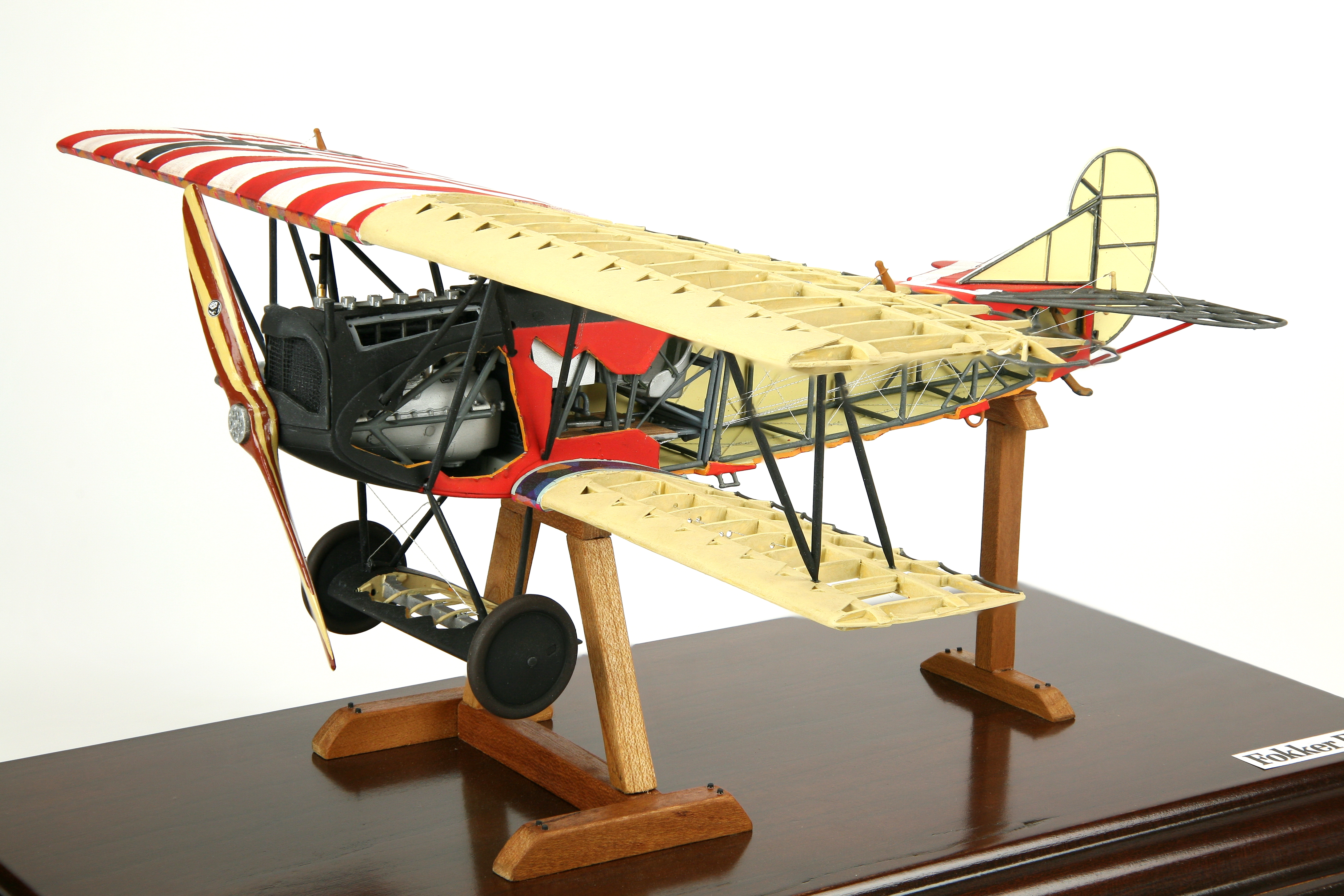

Being a cutaway project, I cut off both port-wing panels and drew plans for spar and rib locations. I cut the ribs from .30-inch styrene sheet. The completed skeletal wing panels were mounted to the kit panels. Internal bracing wires, aileron cables, and pulleys were installed after painting.

Using my rotary tool, I routed out the cutaway areas, choosing to expose the internal spaces of the aft fuselage, cockpit, and engine. Starting at the aft fuselage and referring to the illustrations in An Illustrated Anatomy of the World’s Fighters (by William Green and Gordon Swanborough, Zenith Press, ISBN 978-0-76031-124-0), I scratchbuilt the tail skid assembly. The tubular steel frame was replicated with .30-inch styrene rod detailed with silver thread for bracing wires. The many cockpit fittings, control panel, main fuel tank, and ammo can were all scratchbuilt.
I used the kit’s seat, floor, and aft bulkhead, but modified each of them to suit my purposes. The nose area was detailed inside, and the kit engine, as nice as it was, got the spark-plug treatment and further details. I found the engine sat too low, so I shimmed the cylinder bank with .40-inch styrene sheet and raised the cylinders and exhaust pipe up out of the cowling to the right height.
I cut out the front of the radiator and installed a mesh screen and scratchbuilt a radiator to be mounted behind that.

All of these subassemblies were painted, installed to the starboard fuselage half, and the fuselage halves were glued together, trapping all that cool-looking stuff inside. At this time, all of the exposed internal areas were taped off for painting the fuselage exterior. The rudder and elevator cables were installed later, after painting.

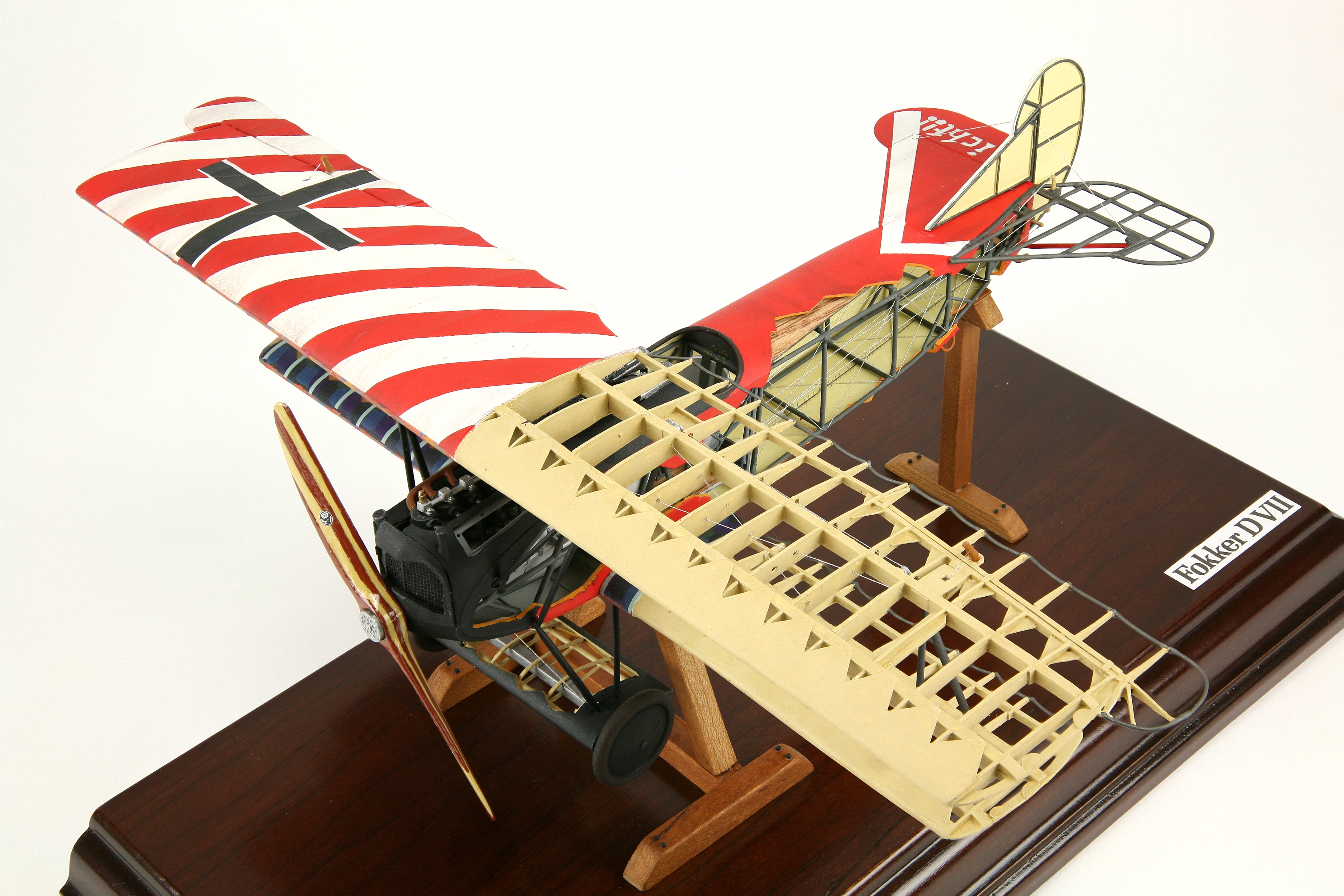

I simply cut the port side of the elevator off, traced around it, and made a new one from .20-inch styrene rod to simulate the steel-tube construction. I sanded the left side of the rudder and fin smooth and glued .20-inch rod onto the parts.

Looking at color drawings of his biplane, I painted the top starboard wing panel with red and white stripes. The bottoms of both starboard wings and the top of the upper starboard wing were covered with Battle Axe lozenge camouflage decals. Blue and red pinking tapes were applied over each rib by hand with airbrushed decal material.

The Fokker’s nose, landing gear, and struts were painted flat black and dry-brushed gunship gray. The aft fuselage was sprayed with Testors Flat Red. Udet’s biplane had the phrase “Du Doch Nicht!” in white letters on the elevator with a white stripe on the stabilizer.

Udet had his girlfriend’s initials on the fuselage sides below the cockpit in white letters. I applied these markings with white decal material. The German crosses were kit decals.
