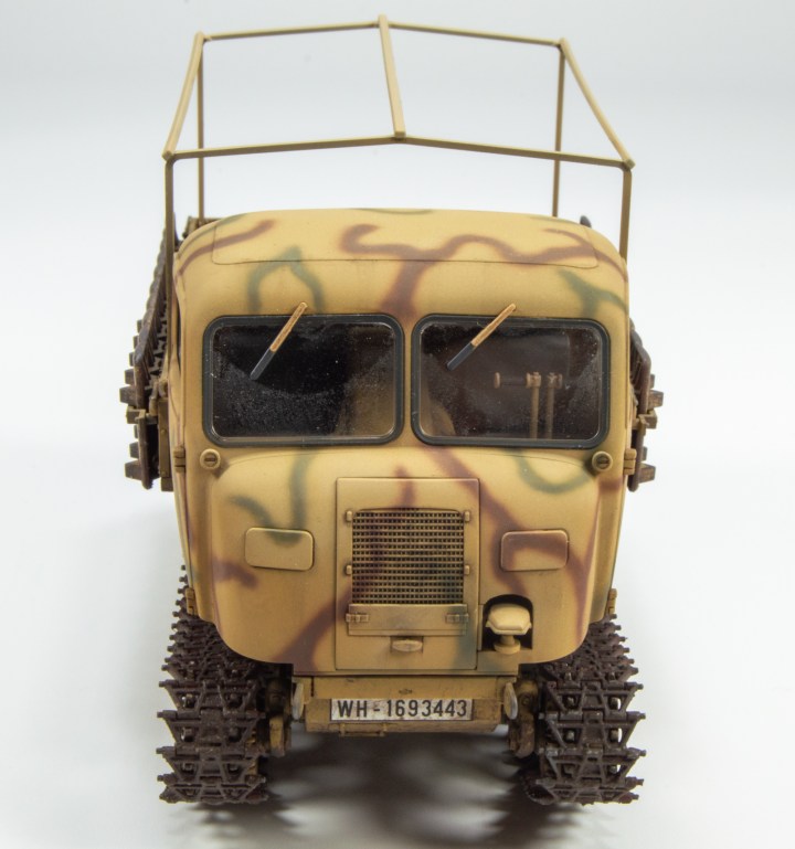

The lower part of the door windows will be visible through holes in the interior door panel. The glass was easy to install, and the parts held the clear plastic firmly in place. However, it did not seem to me that glass would be visible like this, especially with the window up. So I painted the lower part of the door glass flat black to help hide it. With the doors closed, it’s hardly noticeable.
While it might first appear that Tamiya included cab window masks for both the interior and exterior, this is not the case.  The first set of masks fit the glass inside the gaskets molded into the clear parts. The second masks cover the entire window, including the gaskets, while painting the exterior. I only used the first set of masks to paint the gaskets. I fitted the cab parts (minus the windows) without gluing them for painting and installed the windows afterward. The masks did fit well and are a nice addition to the kit.

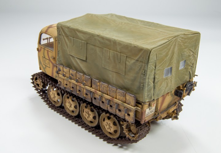

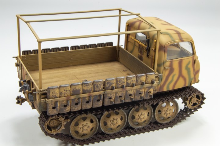

For the bed, Tamiya’s molded wood-grain texture looked fantastic and is some of the best I’ve seen. It assembled quickly and easily and provides an option to represent the vehicle with just a cover frame or with a canvas cover. You can also model the RSO/01 with the snow tracks stowed on the bedside. If you leave off the snow tracks, you will need to modify the holders to remove the pins for fitting the snow tracks.  I thought it would be more interesting to fit the snow tracks and fill the bed with supplies, but the canvas bed cover was also nicely molded, so I built it too. The snow tracks can be fitted with the bed cover in place, so I wanted to have both options available and make up my mind later about cover or no cover. The frame and canvas covers fit nicely without glue, so if you’re like me, you can finalize your decision later.
A nice addition, I would have liked the snow tracks to have been individual parts rather than molded all together. I spent some time trying to deepen the lines between each track with files, a razor saw, and a hobby knife, but they would have looked better as individual pieces.

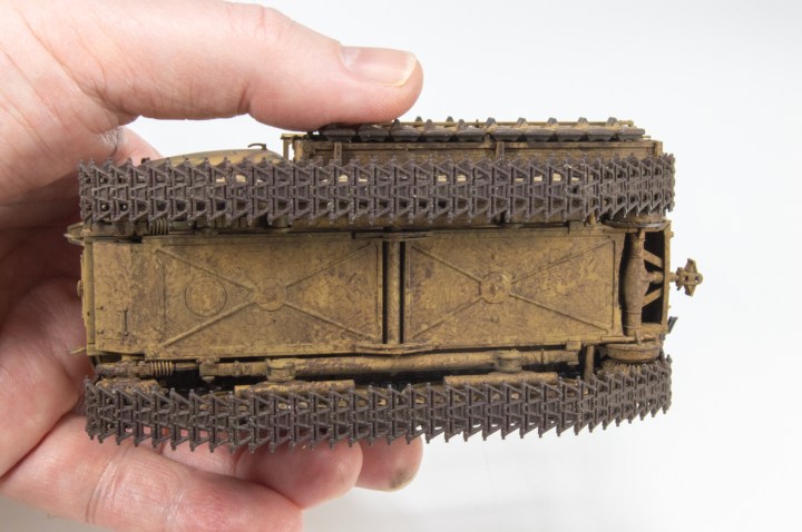

The link-and-length tracks have slight ejector-pin marks. I removed these with files and a hobby knife. If you intend to display your build in heavy mud (and why wouldn’t you?), this may not be necessary.

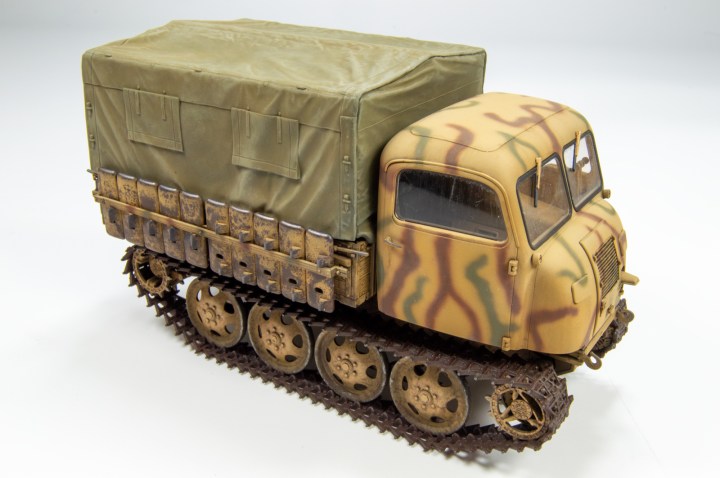

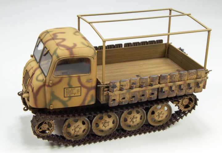

I finished my build in the three color camo scheme. The RSO is a vehicle that begs to be displayed in extreme conditions. I intend to do more weathering at some point in the future, so I kept the weathering minimal at this point.
