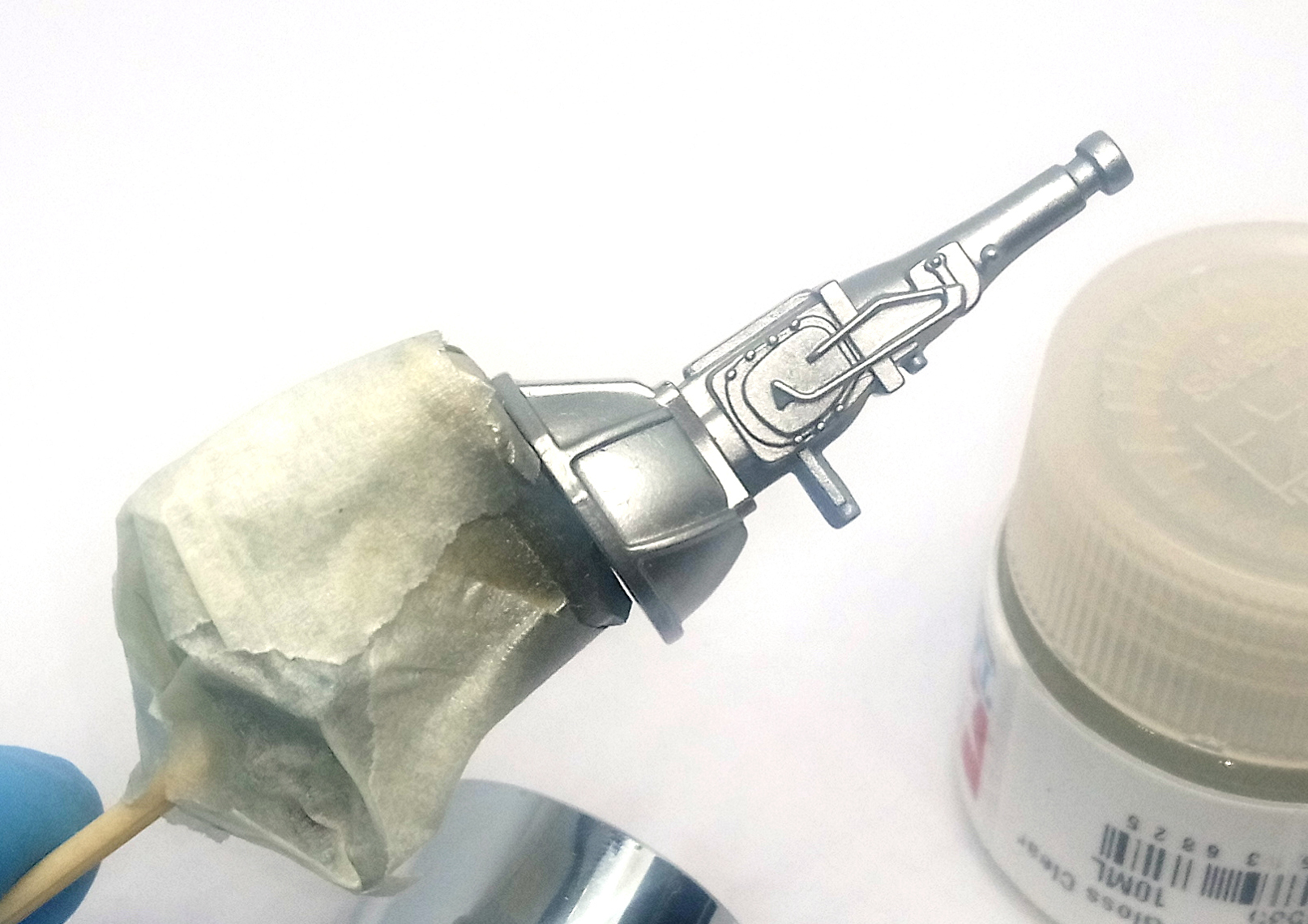

Mask the engine and airbrush the transmission an accurate color for the topic you are modeling — dark aluminum, in this case. Remove the masking and coat the assembly with semigloss clear to protect it from the washes to come.

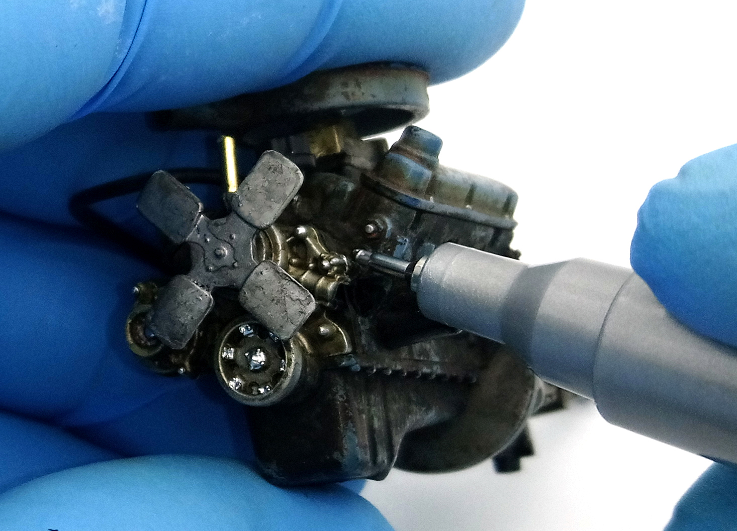

Not everything on the engine would be rusty, and you’ll want to create some visual interest. Highlight bolts, linkages, and other parts that you want to stand out with a silver marker or paint.

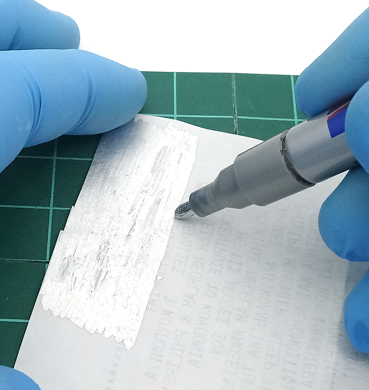

Hose clamps can be easily made by coloring paper with either a silver marker or paint and cutting it into strips.

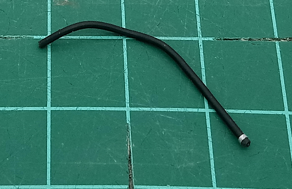

Lace the paper fan belt through the pulleys and affix it with white glue. Again, you can purchase aftermarket ignition cables, use wire of the proper scale diameter for your engine, or even make your own from stretched sprue, as shown here. Your completed engine is now ready to install in your model pickup truck.
