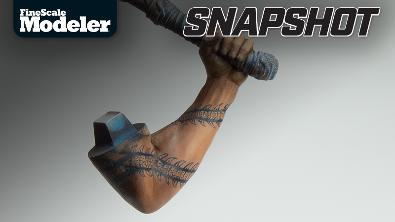

Small details can often be where we challenge ourselves the most. When finishing painting a Sabot miniatures Viking bust, I learned that archeologists believe tattoos were common among Vikings. Satisfied with the face, I tried giving the warrior a bit of ink on the arm.
The arm of the bust is a separate piece. I stopped short of the highlights and blending, but otherwise completed painting the flesh colors.

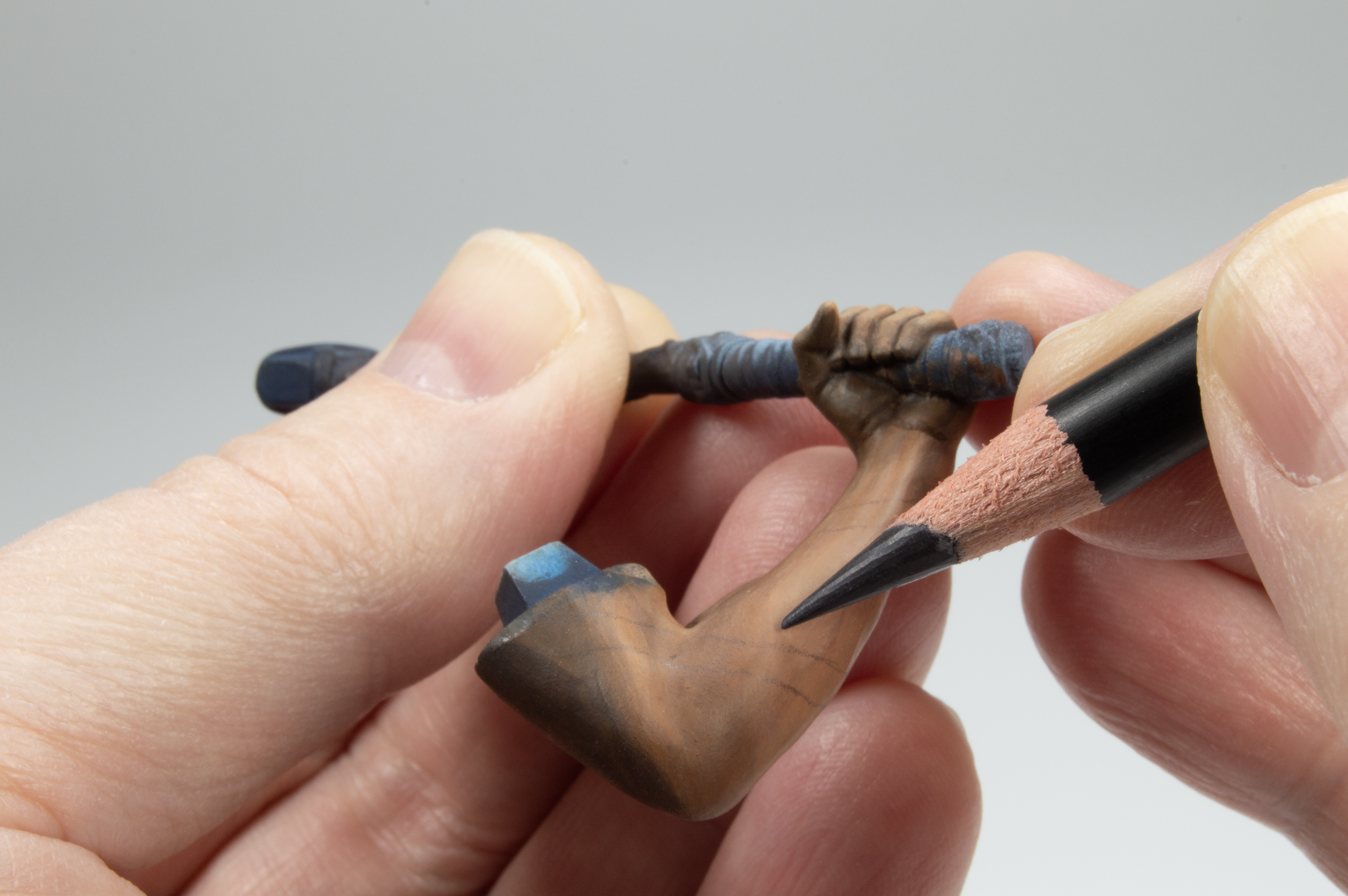

Since the arm was a separate piece, I painted a Viking dragon tattoo wrapped around it. Using a colored pencil, I sketched the outline. Note: The painted acrylic skin was dry when adding the tattoo. The water-based colored pencil will blend under acrylic highlights.

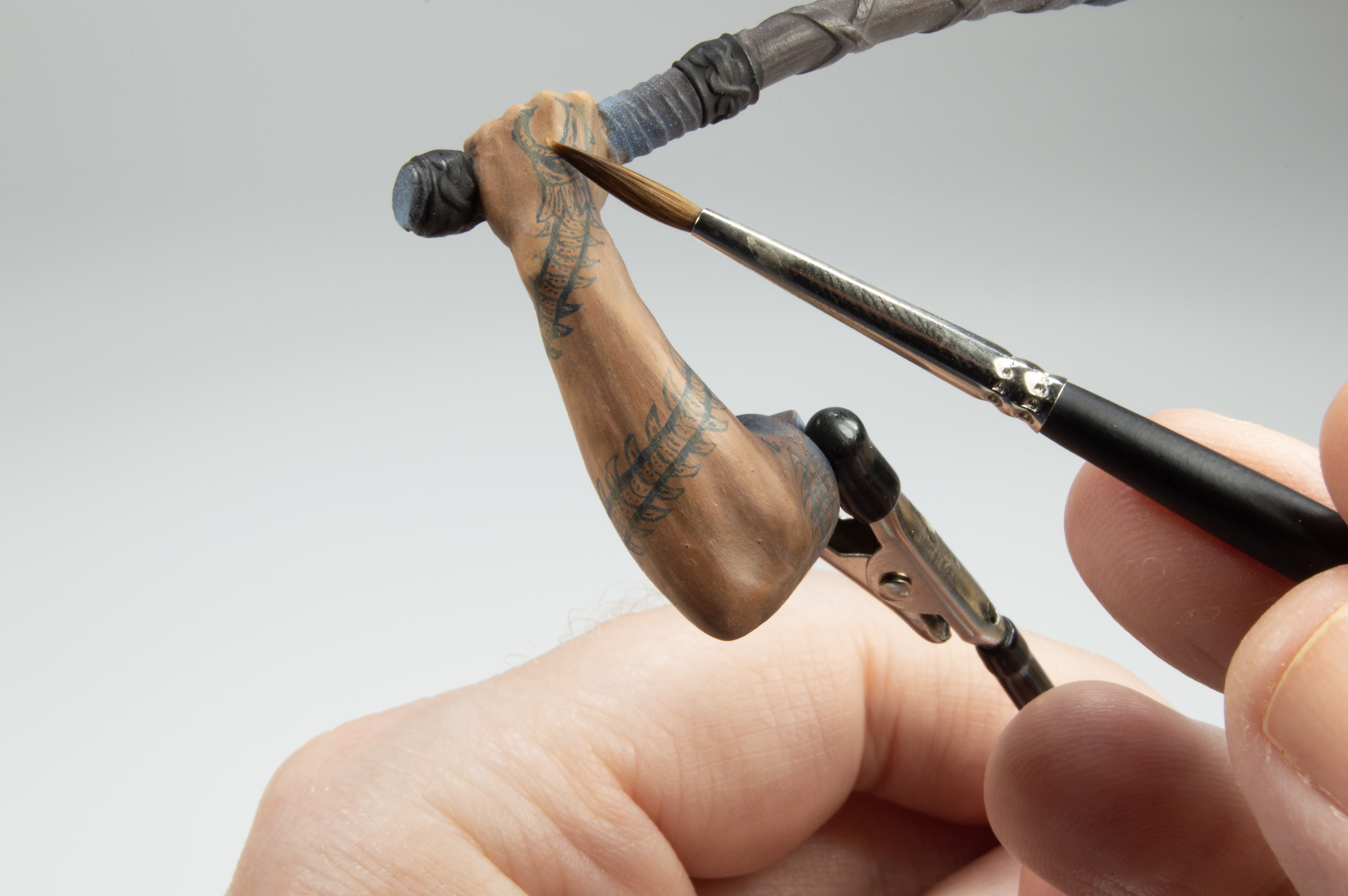

Use a size 0 brush to paint over the outline, then add details. Work slowly, keep the brush loaded with paint, and avoid brush strokes by maintaining a properly formed brush. I corrected some mistakes with a dry brush; others became part of the design.

On the finished bust, the arm is more in the background, so the tattoo is not immediately obvious and does not draw your eye right away when you look at the finished piece. This is perfect for a tattoo intended to be an extra detail, not a central detail. But for those who take a closer look at other angles of the finished piece, the tattoo pops out. It is an extra finishing touch that helped build my painting skills and rewards those who look more closely.
