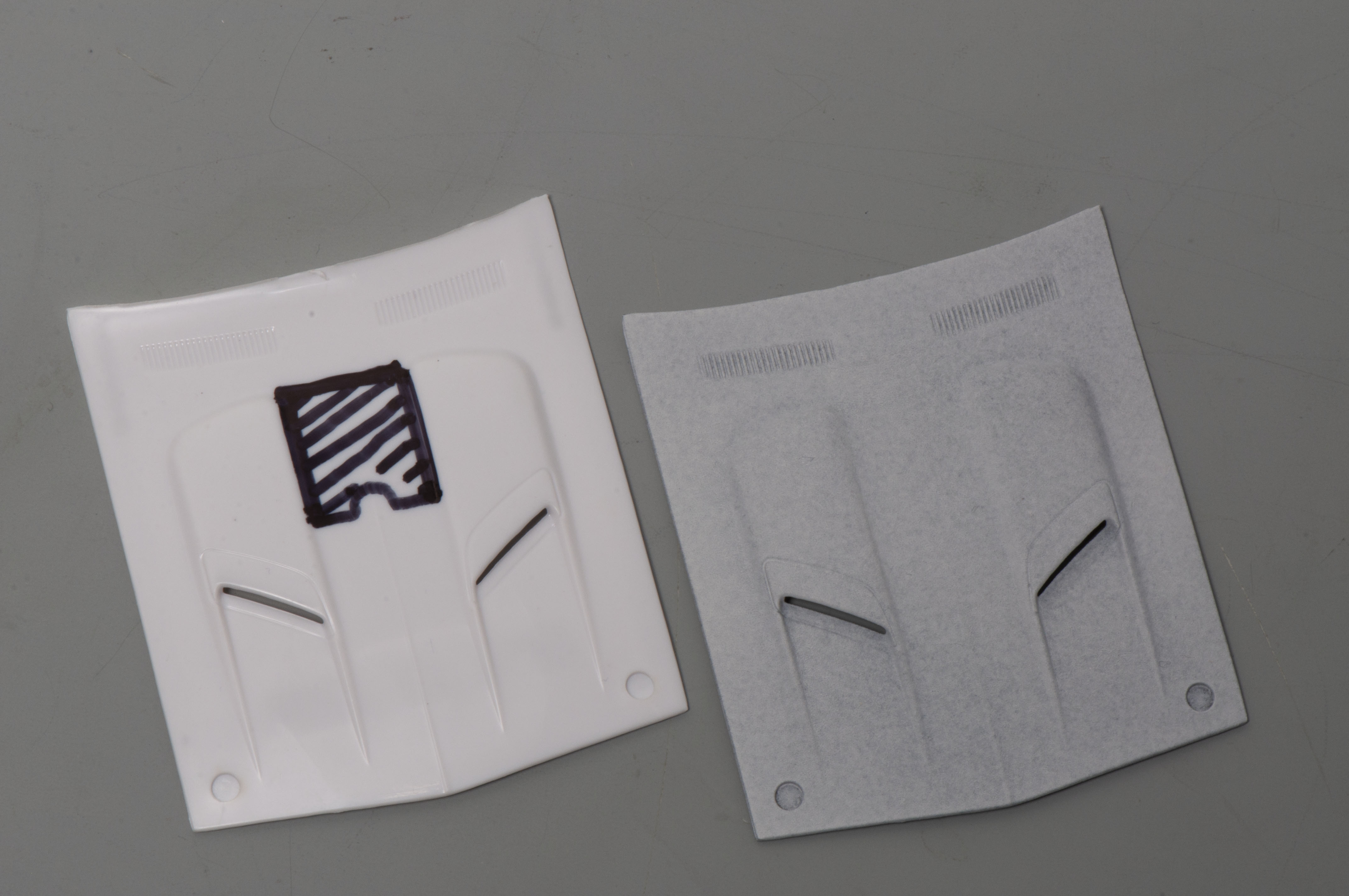

The standard hood for all 1970 ’Cudas (except the Hemi) was a twin scoop design; the Hemi engine required the Shaker hood as standard equipment. Regardless, Revell included the double scoop hood as a build option in its Hemi ’Cuda kit, but it incorporated an unrealistic bulge at the rear between the two scoops (probably to clear the Hemi engine in scale). If you’re building a stock ’Cuda without the Air Grabber, file down the shaded area on the hood at left to get as close as possible to eliminating the bulge, as shown on the hood at right.

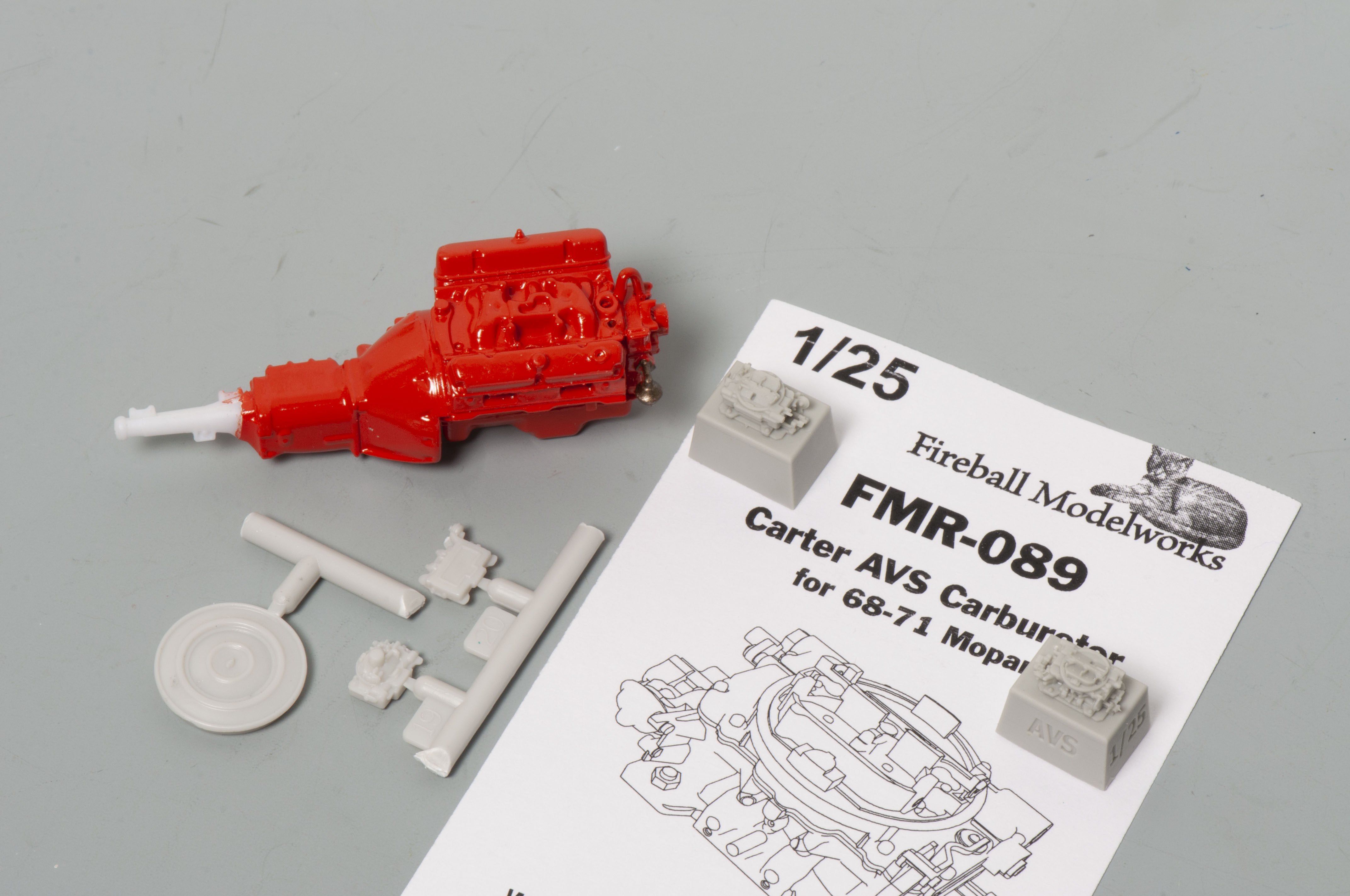

For a factory-stock ’Cuda 340, use the Revell AAR engine and substitute the four-barrel carb intake manifold and air cleaner from the AMT 1971 Plymouth Duster 340 kit. You can use the Duster’s Carter Thermoquad carb, but, to be accurate, you should source a scale replica of the Carter AVS carb that was factory spec’d for the 1970 version of the 340 V8. Fireball Modelworks (www.fireballmodels.com) has exactly the carb you need, and it’s highly detailed to boot.
