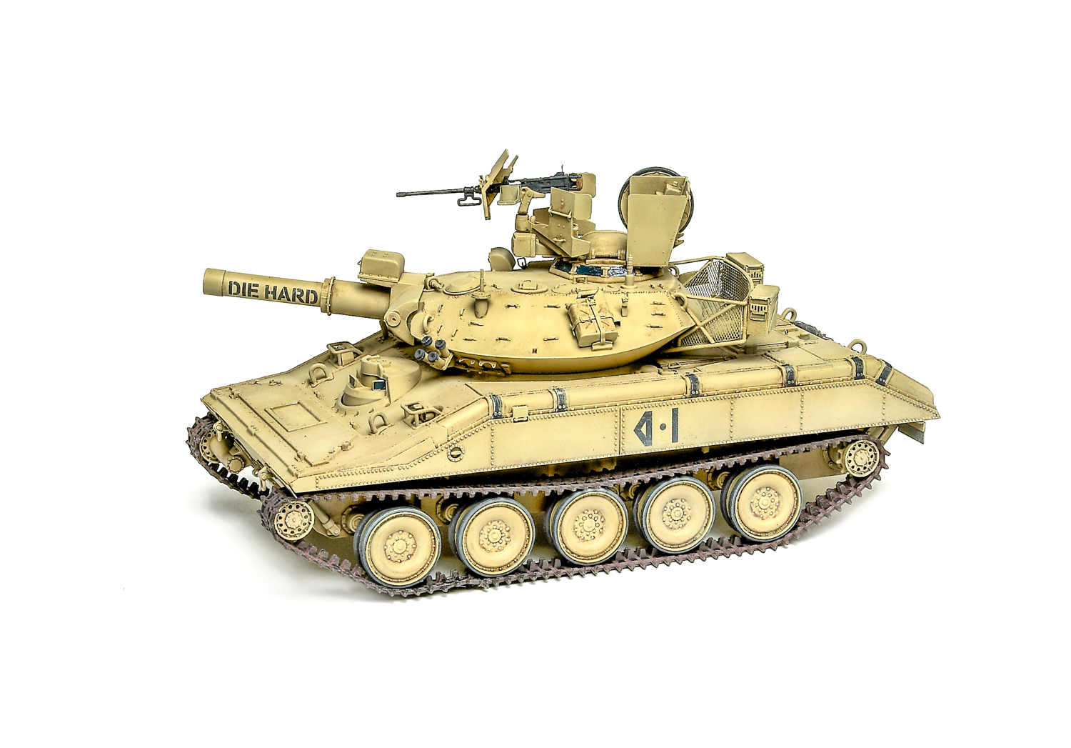

Aaron applies a wash of burnt umber artist’s oils to a desert tan Sheridan. The Academy 1/35 scale kit features finely molded surface details that really benefit from a wash as part of the weathering process.

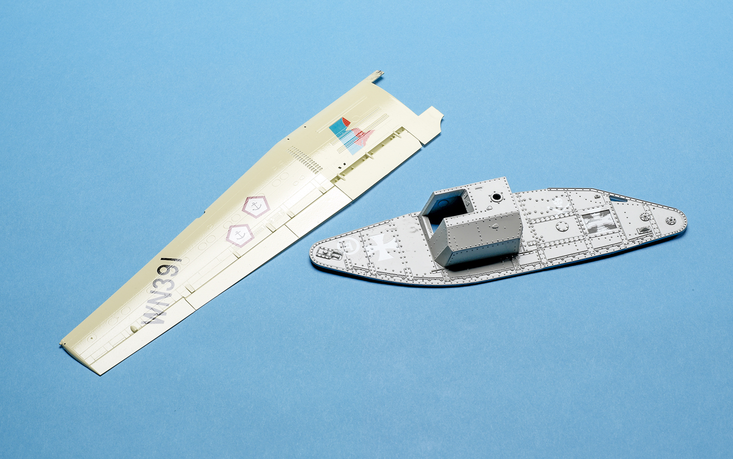

A coat of clear gloss allows paint to run freely, enhancing the capillary action that draws the wash into recesses and details. On the left is a 1/72 scale C-160 Transall wing painted with enamels; on the right, a hull side from an Emhar Mk.V tank painted with gray acrylics.

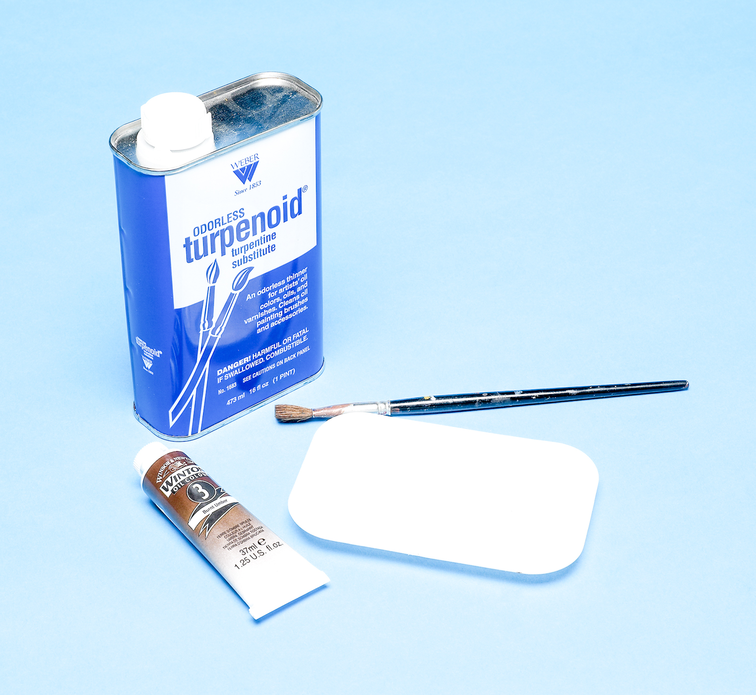

Oil's well

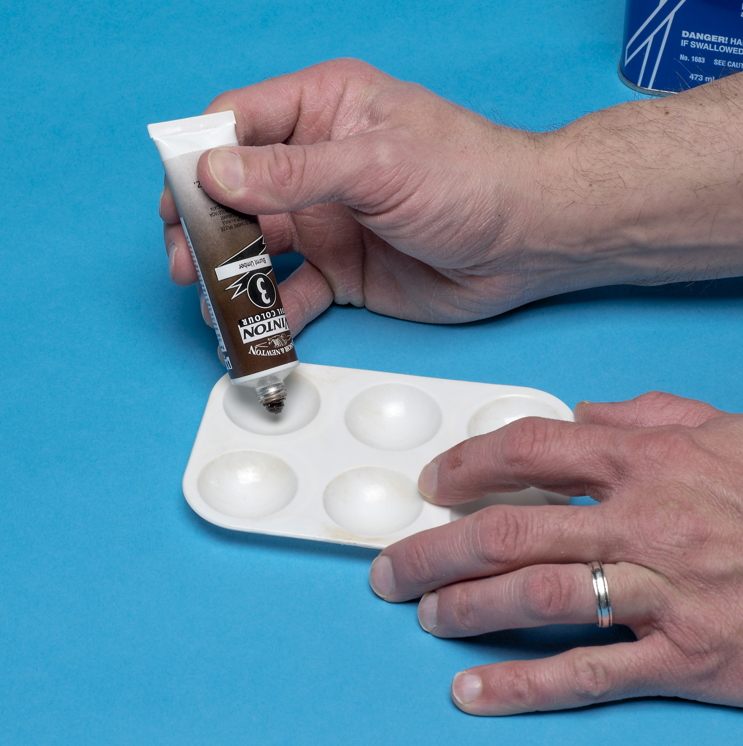

The ingredients of an artist’s oil wash: a tube of paint (in this case, Winsor & Newton burnt umber); Turpenoid (or other thinner); a brush; and a palette.
FSMUK0708_09

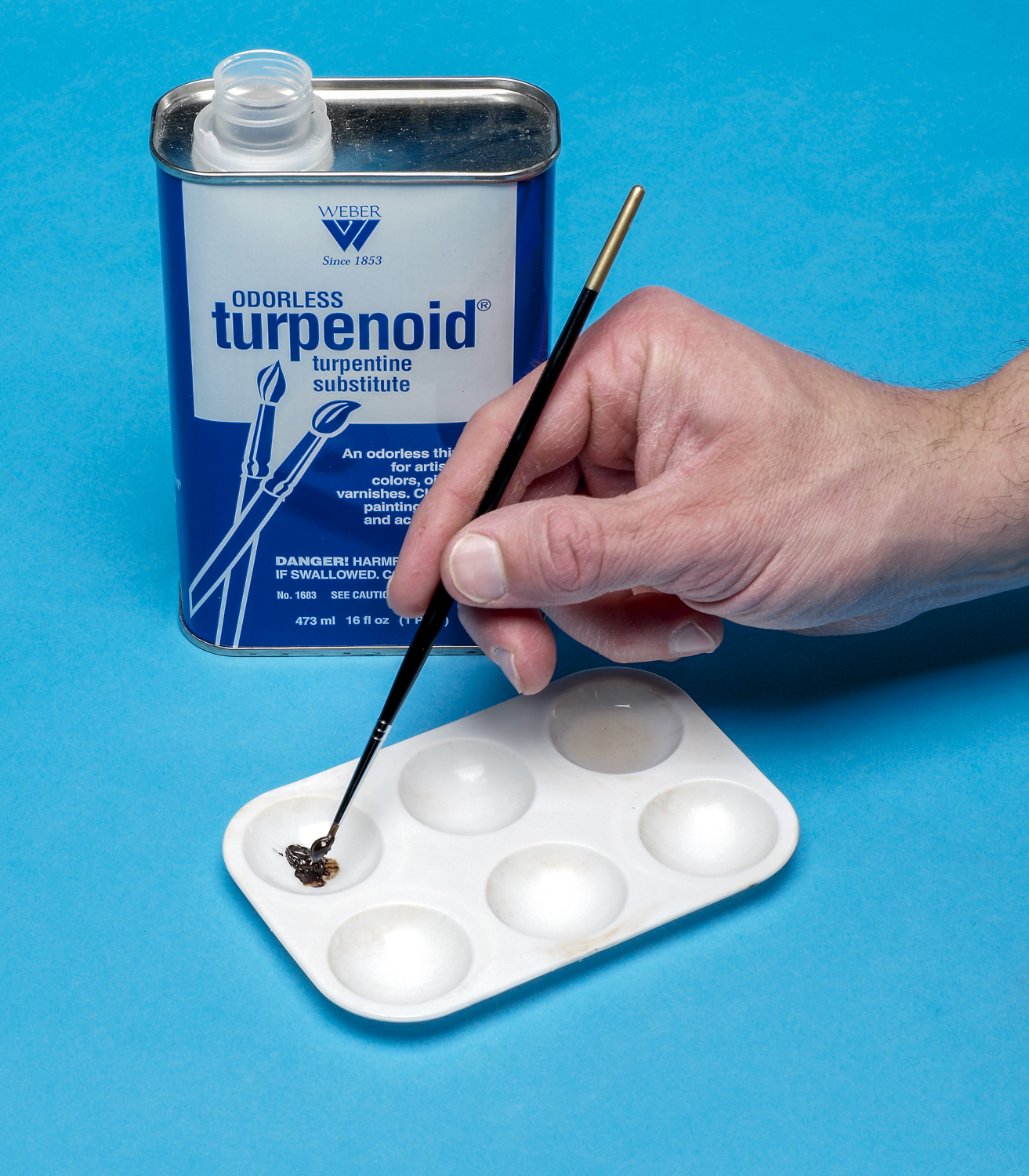

First, squeeze out a small dollop of paint. You don’t need much; a little goes a long way. This is an inexpensive plastic palette, but almost any hard plastic container will do; test it first to ensure the thinner doesn’t melt it.
FSMUK0708_10

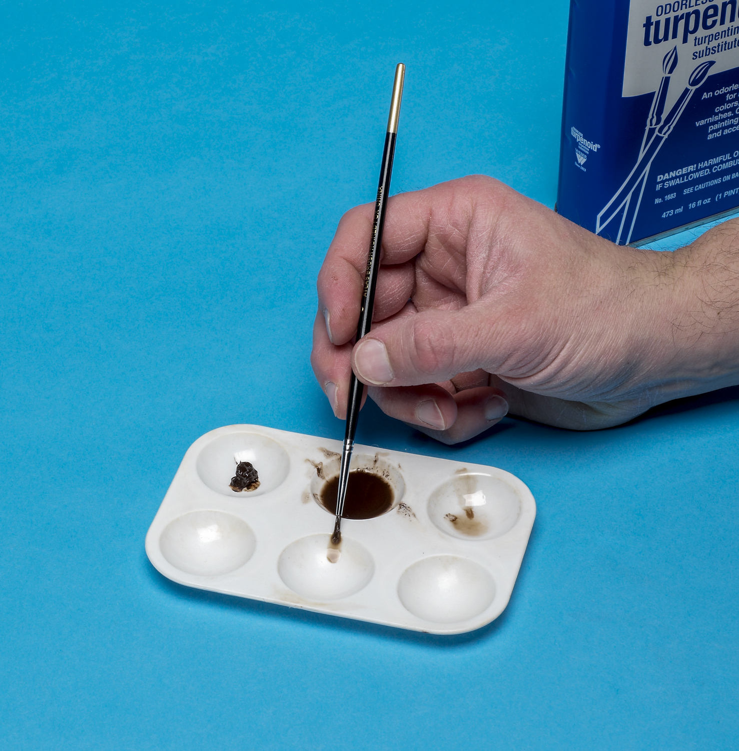

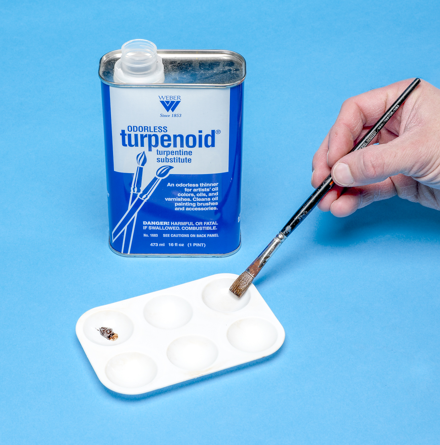

Transfer some thinner into a separate container or area of the palette. To avoid spills, I use a large brush, dipping it into the Turpenoid can, then squeezing it into the container.
FSMUK0708_11

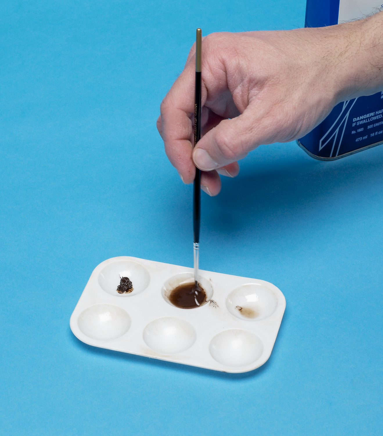

Use a small brush to transfer a little paint into the final mixing container. This lets you add paint and thinner to refine the mix.
FSMUK0708_12
Add thinner to the paint and mix well to avoid any unevenness in the mixture that can cause changes in the density of the wash.
FSMUK0708_13
For a general-purpose wash, I aim for a mixture that looks slightly tinted when the loaded brush is touched to the side of the container.

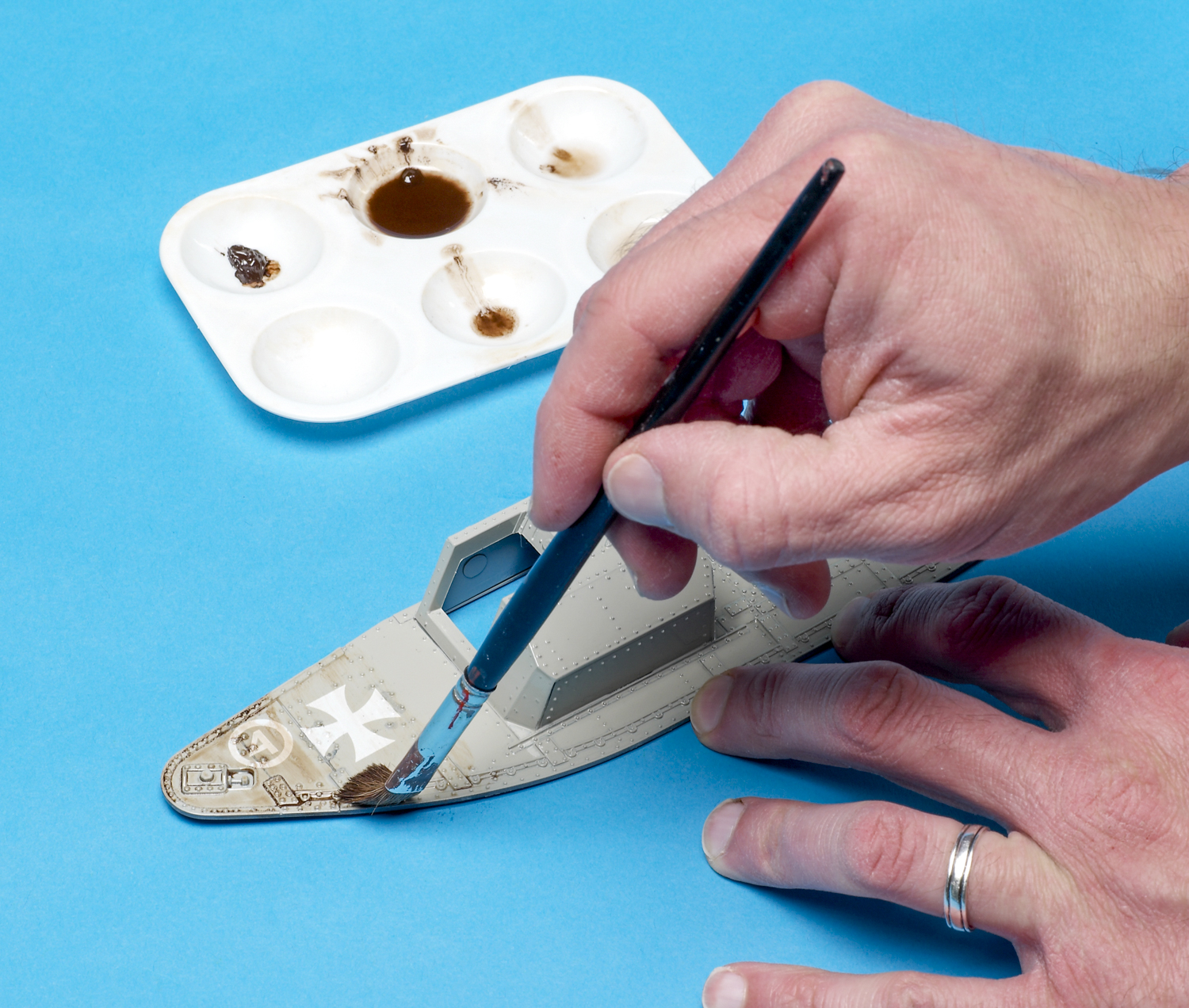

For a broad approach, use a large brush and apply very thin paint (I’m using a darker mixture than normal to make the effect more visible) over the entire surface. Note how the paint collects around details like bolts.
FSMUK0708_15
To refine the effect, I dampen a brush with clean thinner and stroke it across the surface, pausing frequently to wipe the brush on a paper towel. Stroke in the direction that water or air would move across the vehicle’s surface.

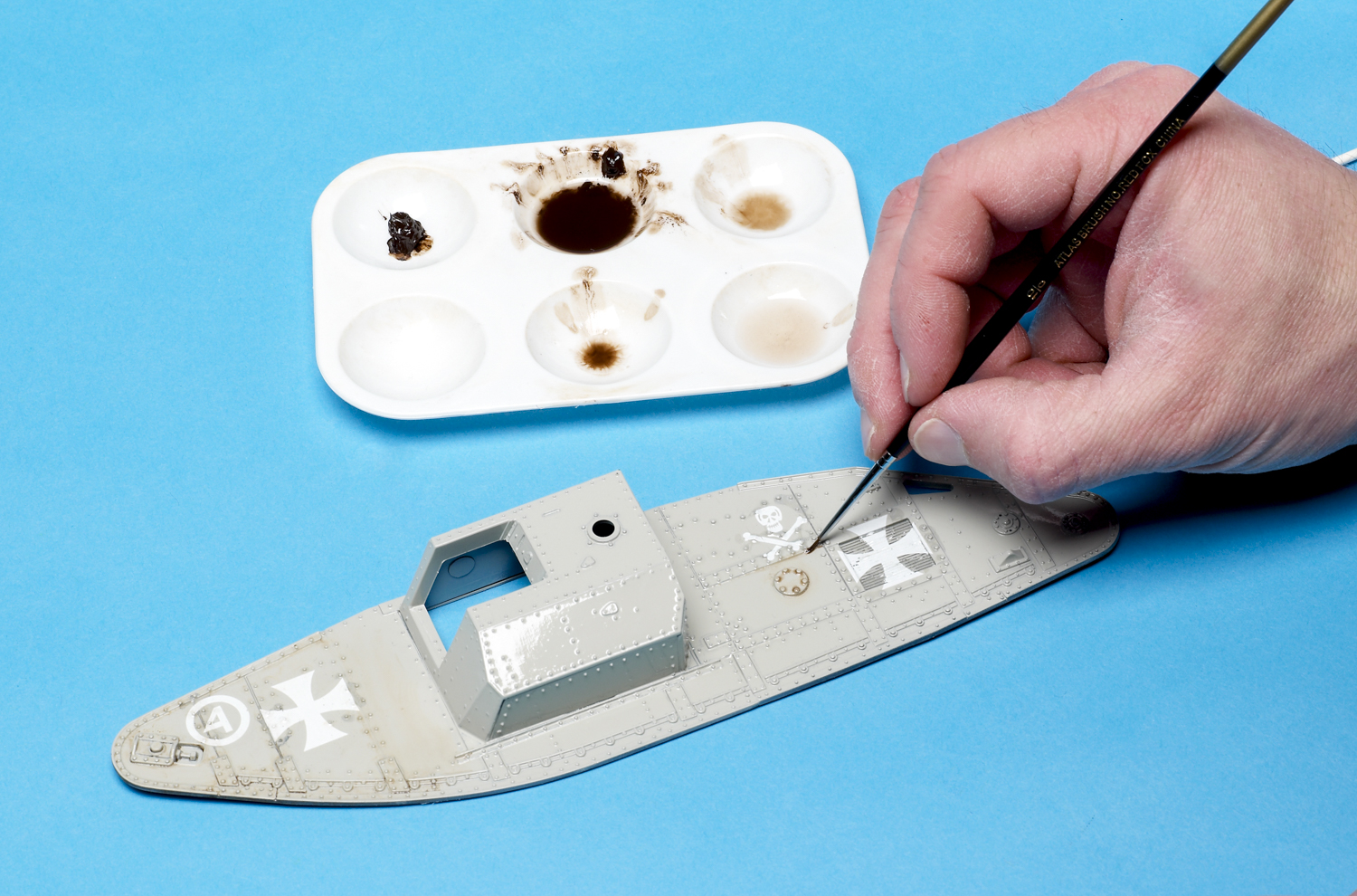

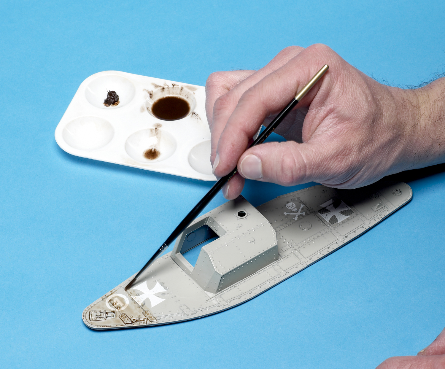

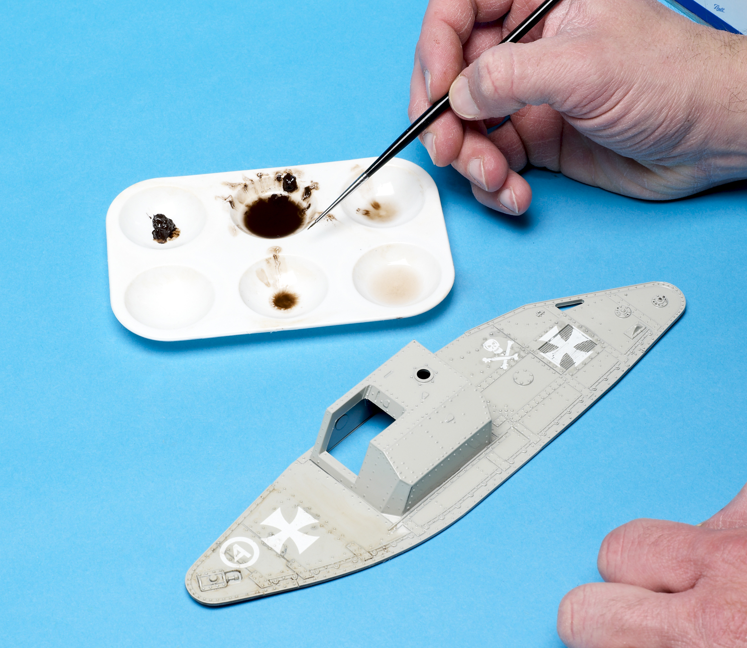

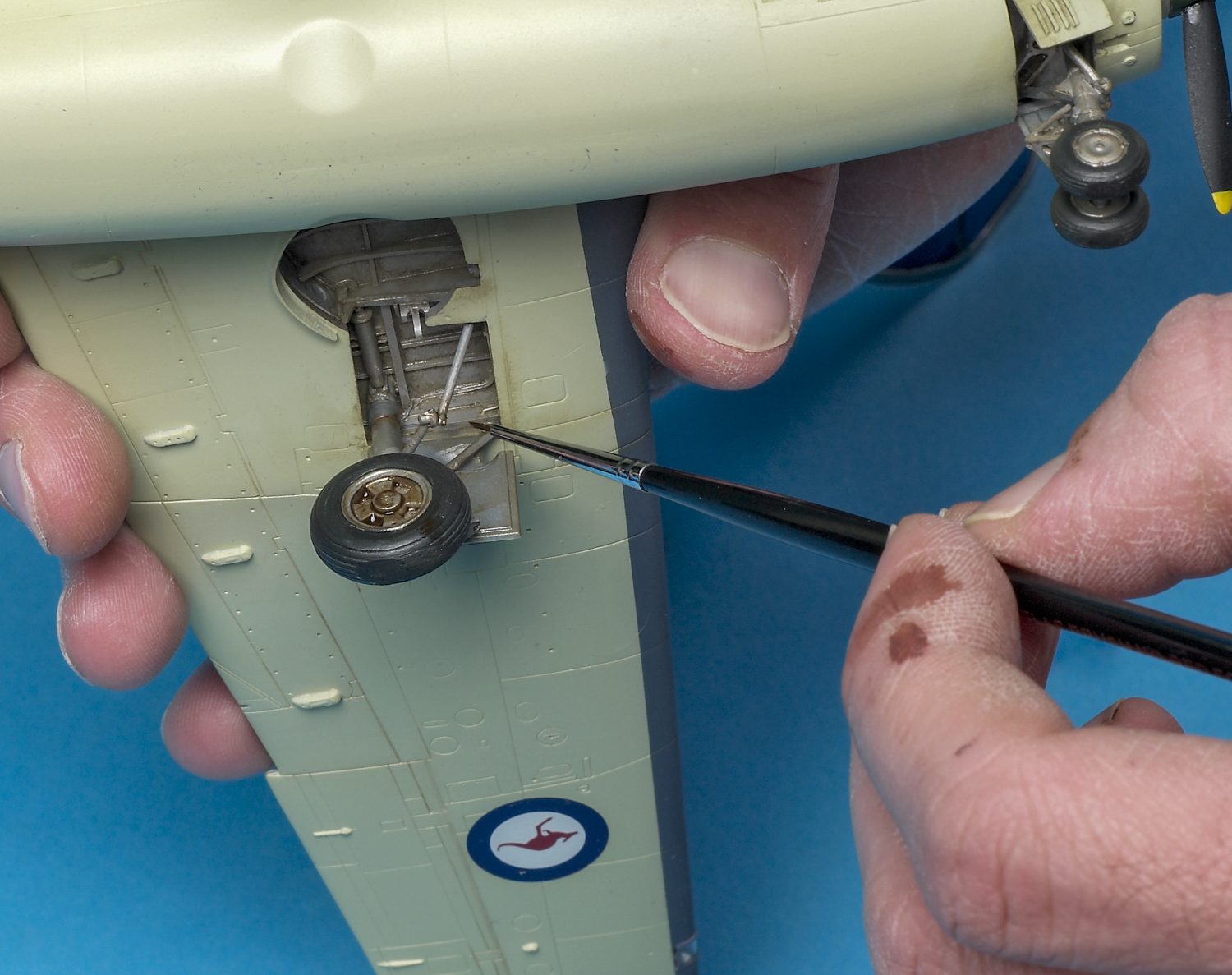

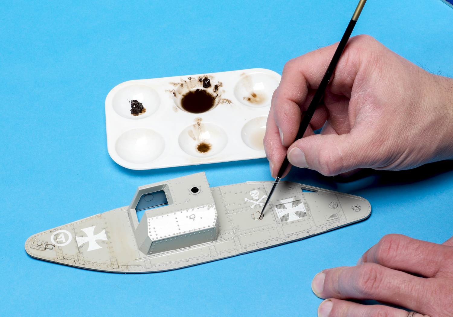

Pinwashes are precisely applied washes. Instead of using a large brush loaded with paint to cover the entire surface, you’ll use a fine-point brush on specific areas or details.
FSMUK0708_22
Touch the tip of the brush to the edge of a feature you want to accent — capillary action will pull the wash around the detail without affecting the surrounding surface.

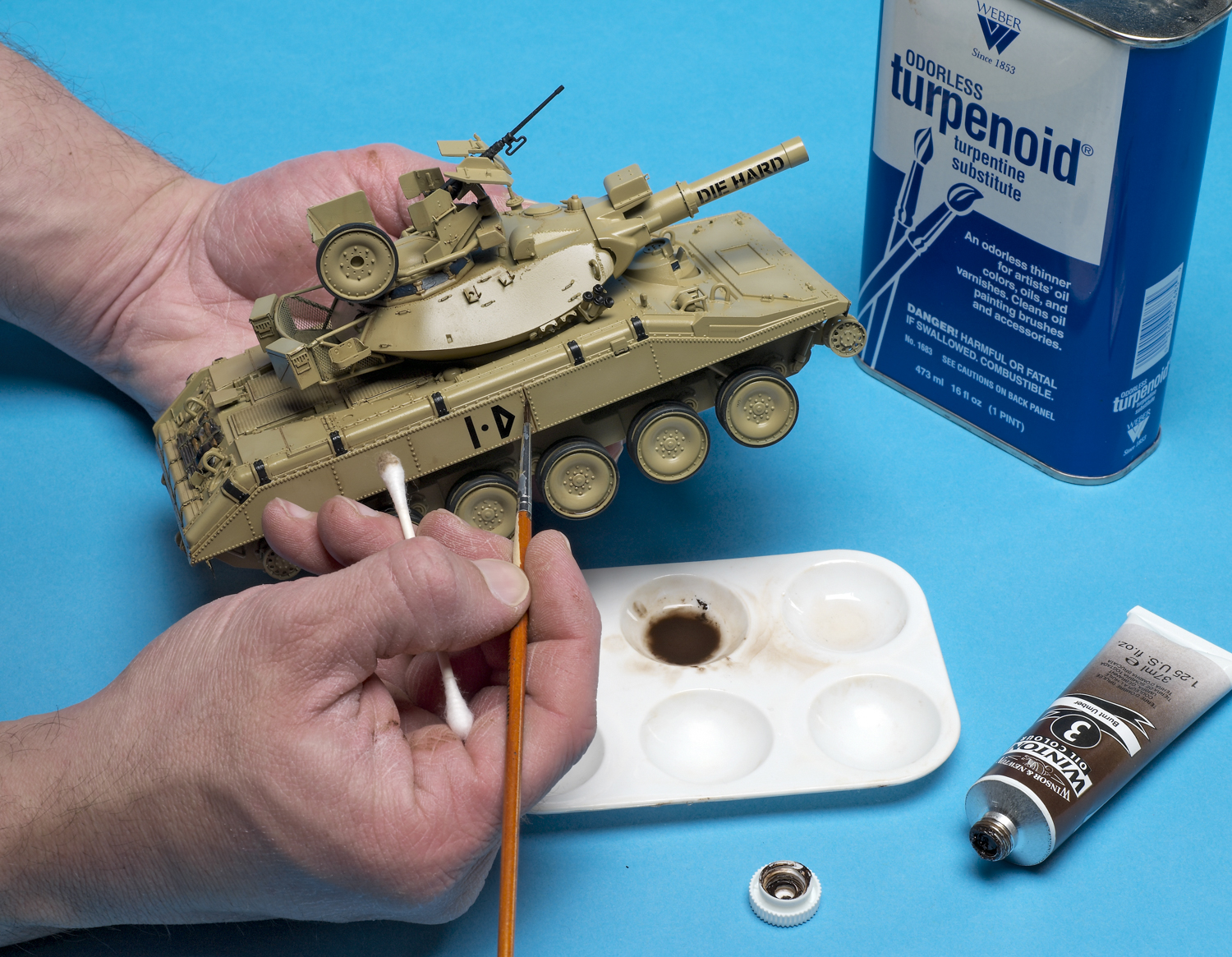

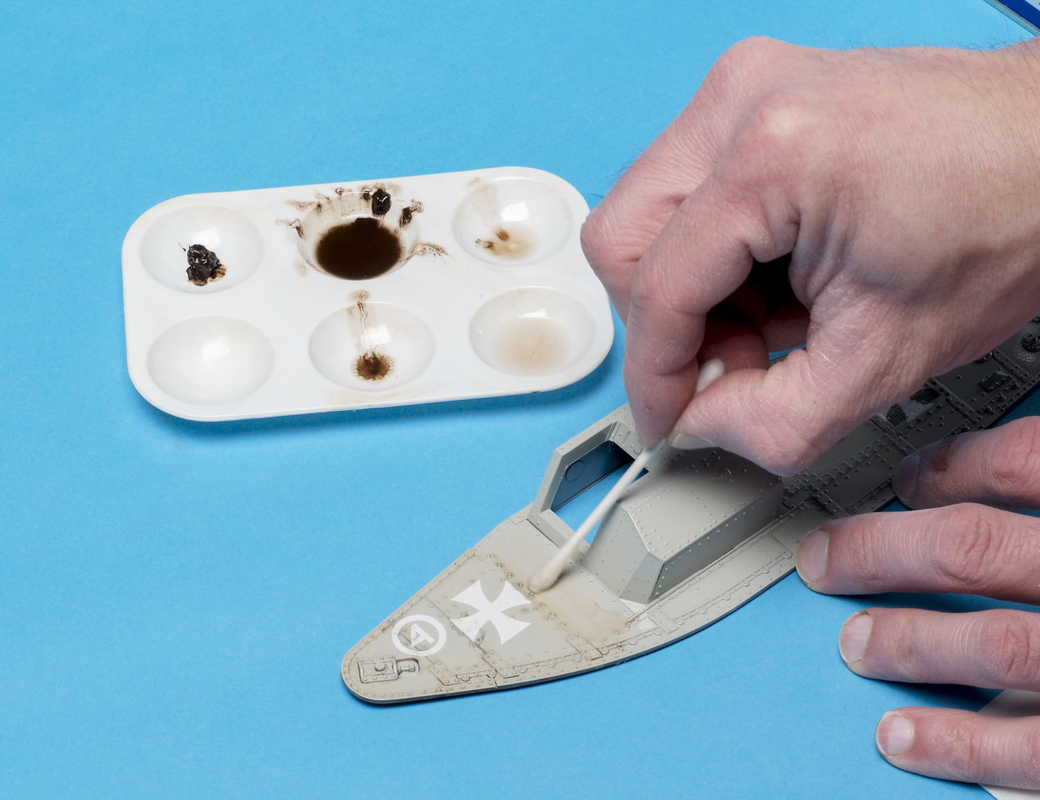

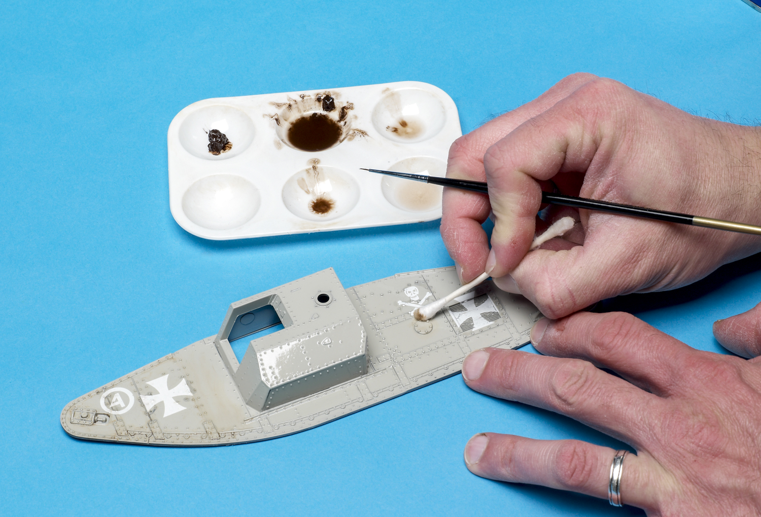

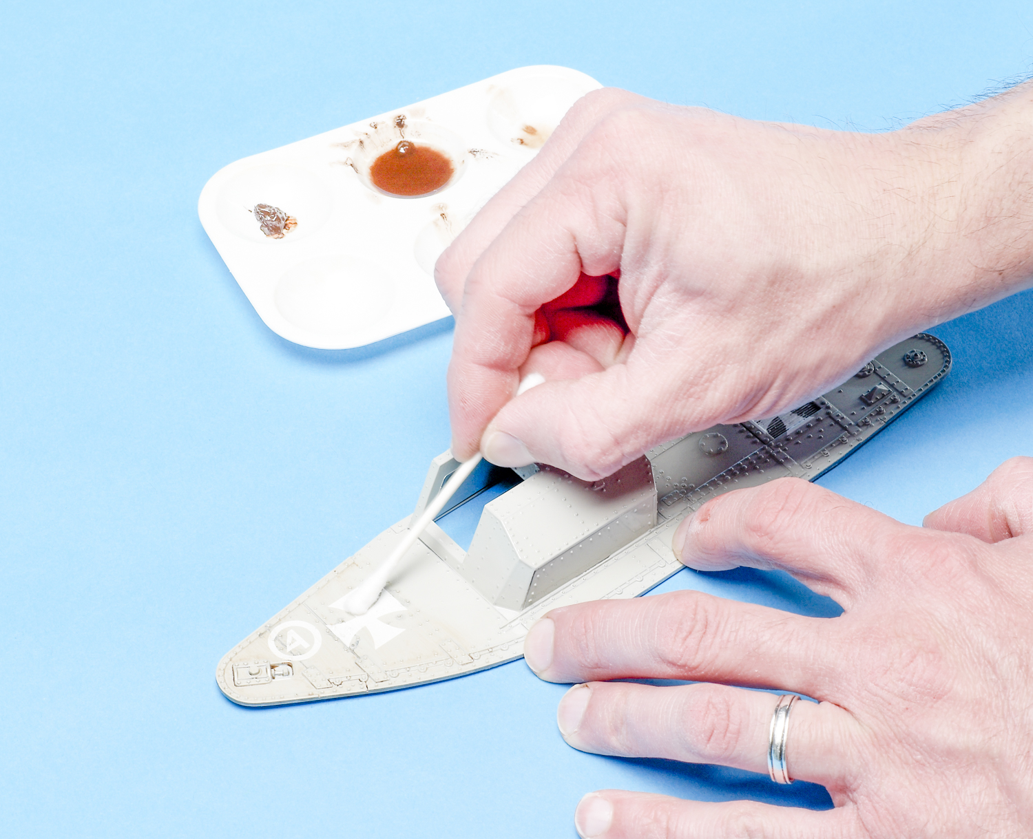

Artist oils’ long drying time makes it easy to fix mistakes (such as paint in the middle of a panel). First, dip a cotton swab in clean thinner. Use swabs with cardboard stems; thinner will melt the plastic-tube variety.
FSMUK0708_18
Rub the surfaces where you don’t want the wash. You can use this technique to feather edges and further refine the wash.

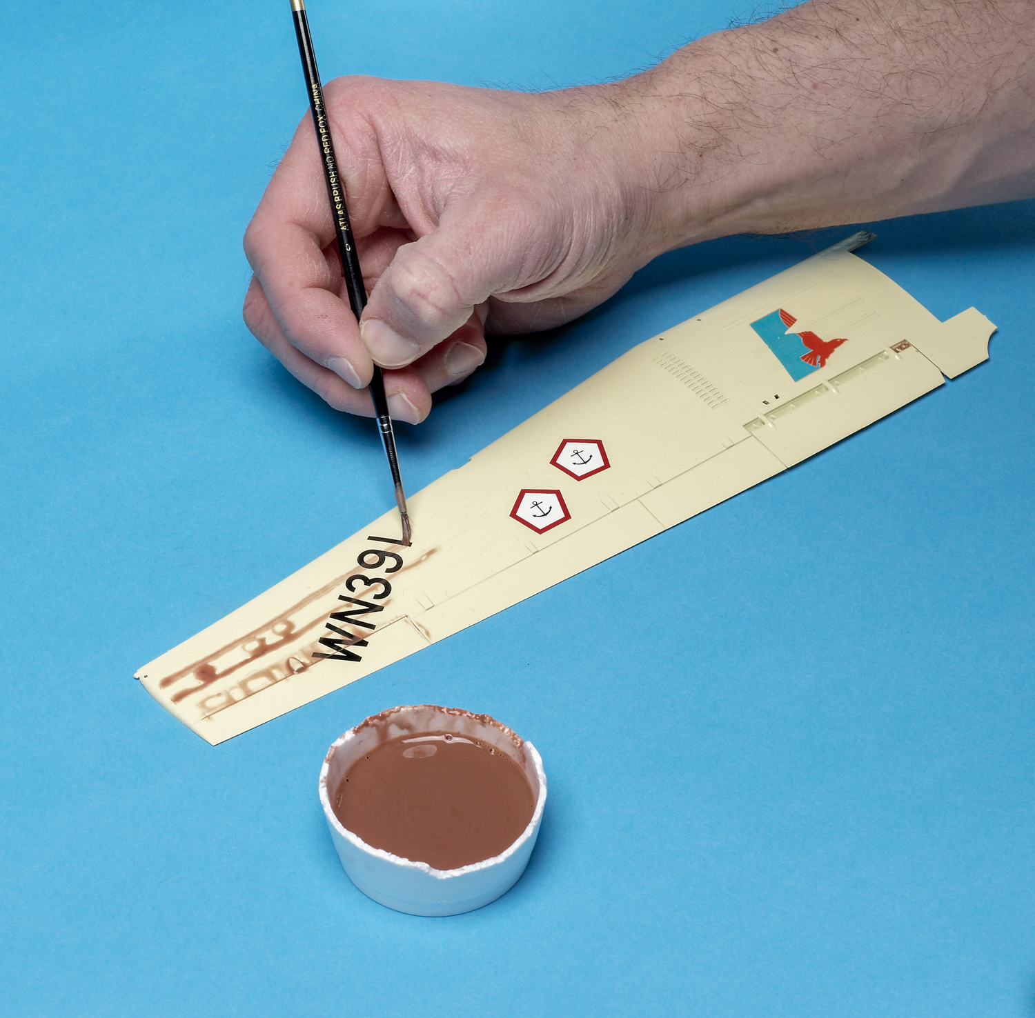

FSMUK0708_05

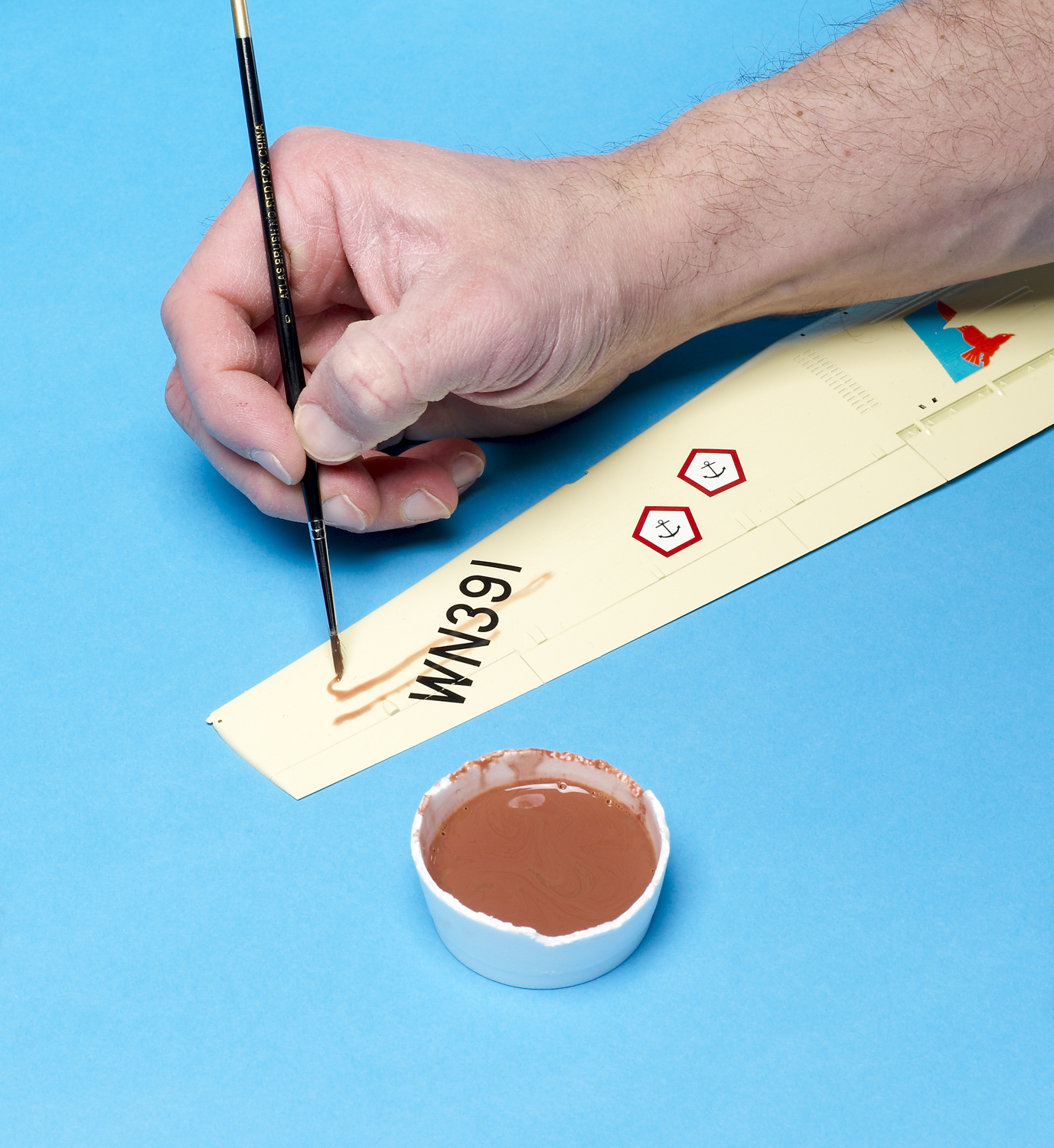

Use a brush to paint the sludge along panel lines and around details. Don’t worry about neatness; you’ll be removing anything you don’t want.
FSMUK0708_06
I’m using oxide red for effect, but sludge washes can be mixed with almost any color; white is particularly useful on dark schemes.

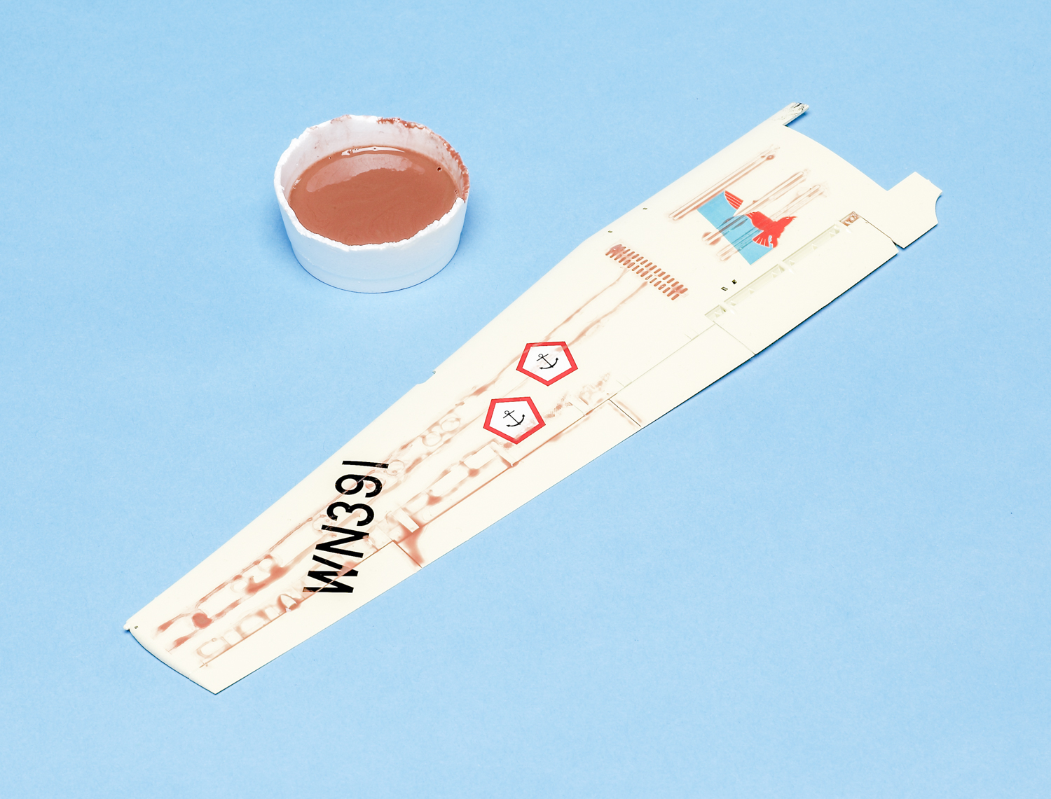

FSMUK0708_07
With the sludge in place, it’s time to wait. The paint should dry for 15-30 minutes. A hairdryer can speed the process for the impatient.

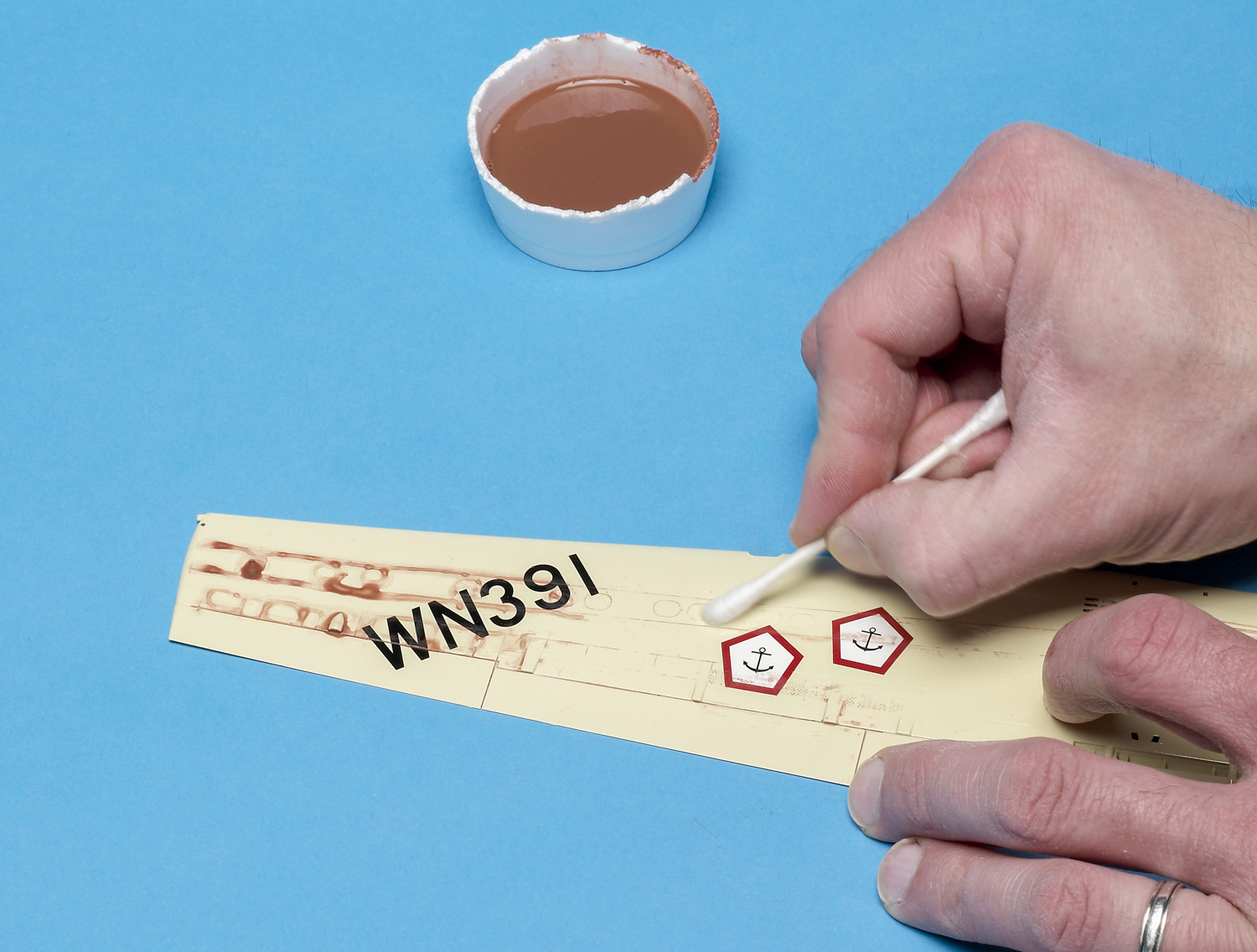

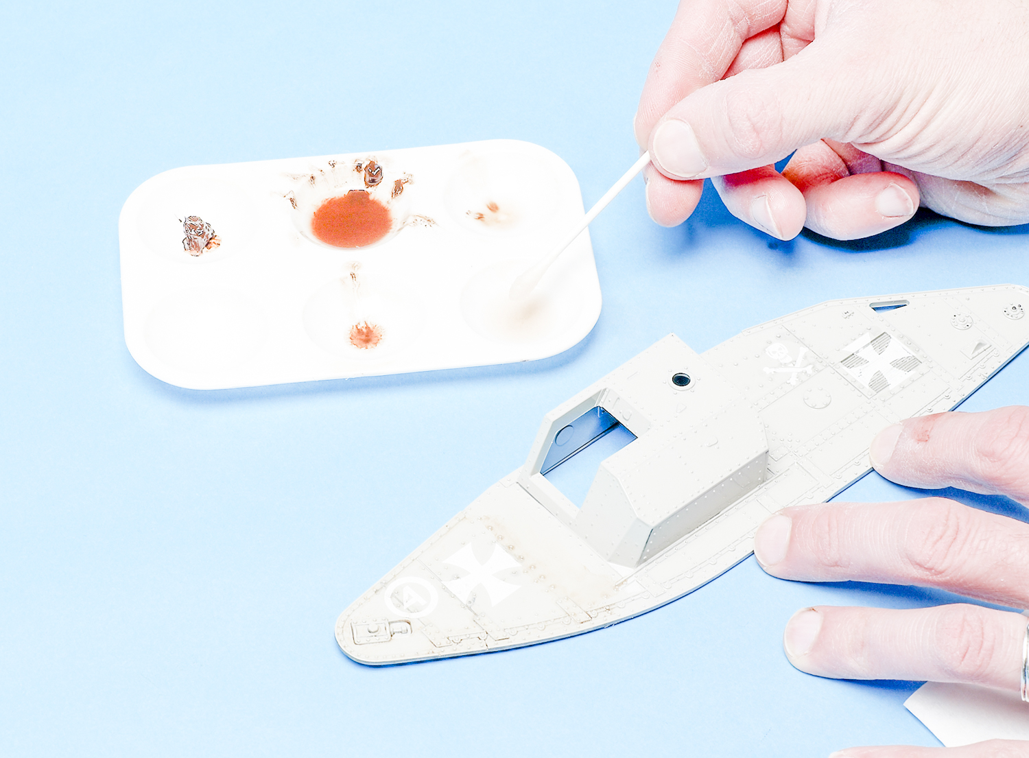

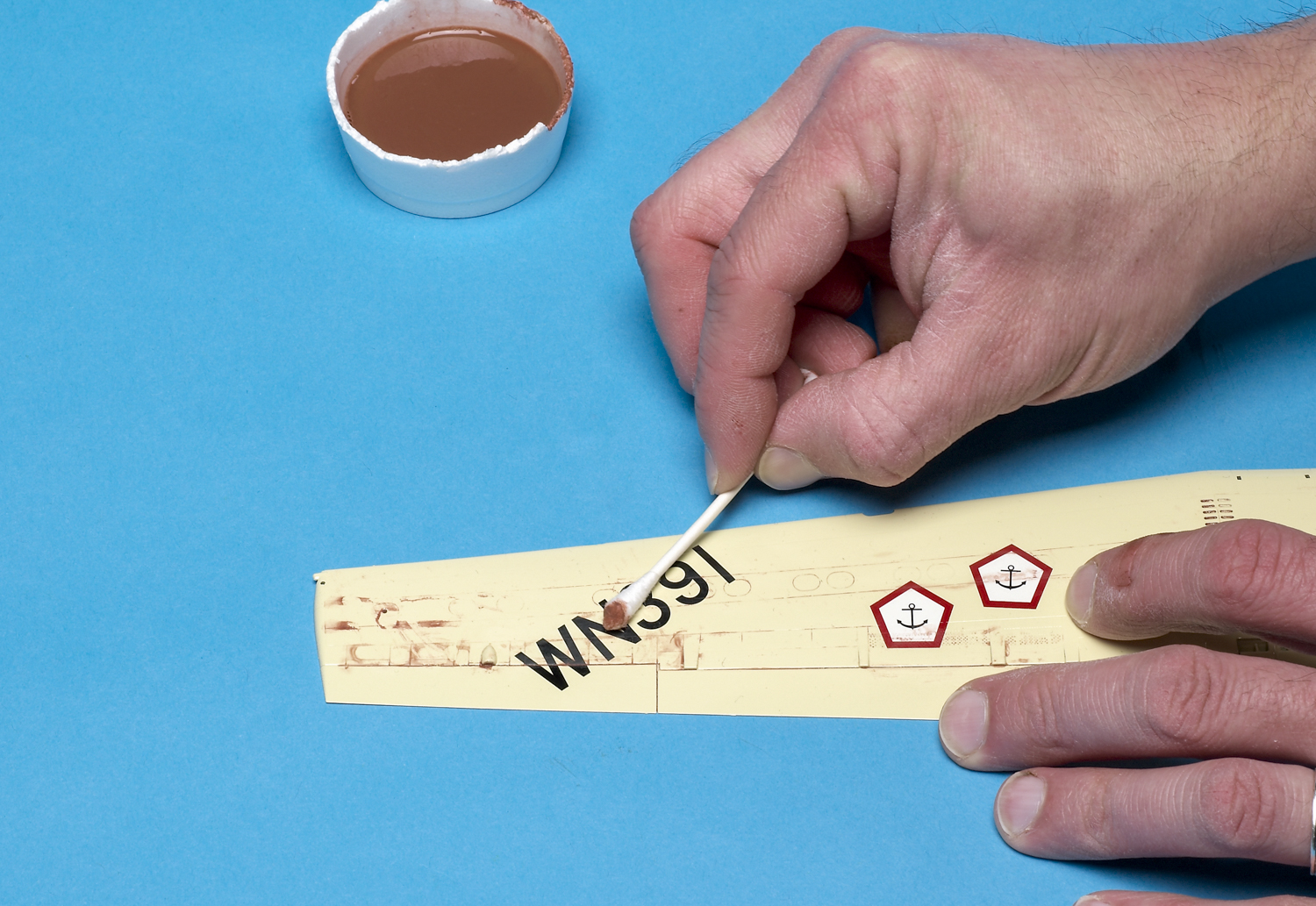

FSMUK0708_25
Now, rub with a rag or cotton swab to remove paint everywhere but in the lines and recesses. Use just a little pressure, and be careful around decals.

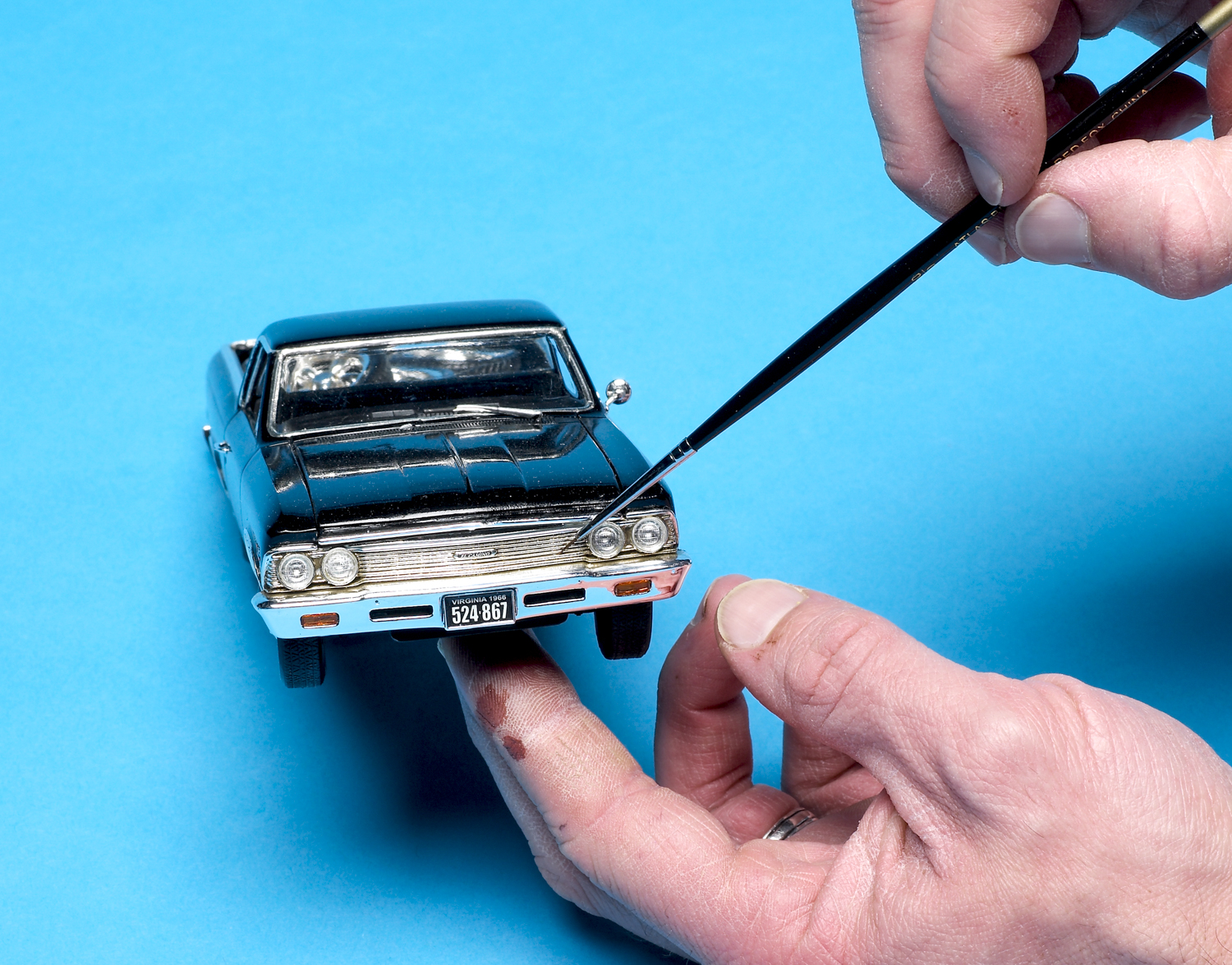

The front grille of Revell’s 1/25 scale 1966 El Camino is a single chrome piece. Several washes of dark oils made the recesses appear open.
Other wash ideas
Washes are great for accenting surface detail. But this versatile technique has many other applications. Use it on aircraft engines, landing-gear legs, and wells. 1. Inside cockpits, a dark wash makes it a lot easier to see details on instrument panels, floors, and walls. For armor, wash variations can represent dirt and dust that builds up on running gear and horizontal surfaces. Targeted applications can depict fuel stains around filler caps or dark rust on tracks. Even car modelers, who aim for clean finishes, use washes. Dark paint fills the recesses on solid-molded, chrome grilles, giving the illusion of openness and adding contrast. 2. Washing chromed hubcaps and wheels makes them look more realistic, too.
FSMUK0708_99
As part of a balanced weathering process, washes definitely make models look more like their full-size counterparts. Combining washes with dry-brushing and pastels makes Academy’s Sheridan pop.
