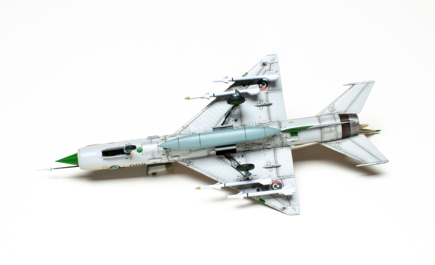

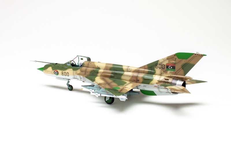

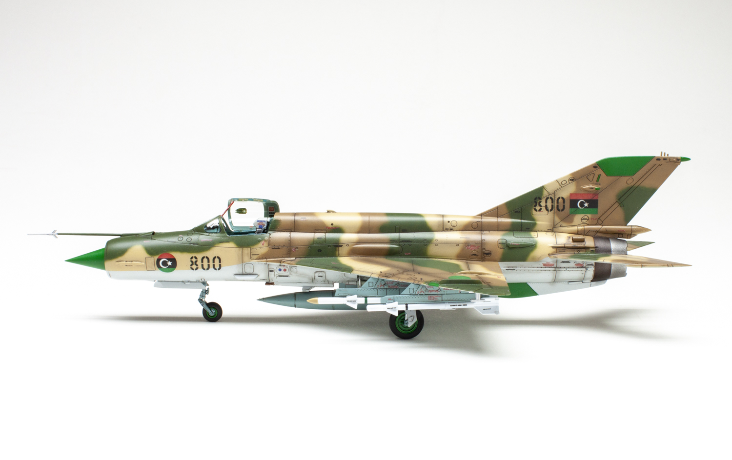

Next, the engine and main landing-gear well have the same outstanding level of molded details. With those complete, the fuselage can be closed up. The fit was good, but I had to really squeeze to get the join around the cockpit closed up, and still had a very small gap on the bottom side that needed filling. The topside spine is a separate piece, so no worries about the seam there.
The ailerons and flaps are separate parts, and though not posable out of the kit, it probably wouldn’t take much effort to change that. Don’t forget to drill the holes if you attach the underwing stores. The drill size called out in the instructions is too small, but makes a good pilot hole. The top of the main wing fit excellently to the fuselage. The lower part of the main wing incorporates a section of the lower fuselage, and the fit there had an ever-so-slight gap and step to the main fuselage. You have to look pretty closely to notice, but it’s present.
The landing gear tires are molded separately from the wheel hubs, a nice touch so no tedious masking is necessary. The landing gear themselves could have used a little more positive location, especially the main gear retracting struts.
With all the details in the cockpit, I chose to build my MiG-21bis with the canopy open, but you have the option to close it, too. Several different canopies are included, so be sure to pick the proper one. You can also choose between an open or closed speed brake.
Finally, there are all the ordnance and drop tanks to sort though. I’m not sure if all the included parts would have been used on the bis version, so check your references as to what is appropriate for the version you’re building. You will certainly have a bunch to add to your spares box.
