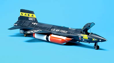

The completed model looks impressive, with its black finish accented by the high-visibility external fuel tanks. The outline of the nose looks a bit swollen compared with photos of the real X-15s. A good reference on the X-15 is Aerofax Datagraph 2, North American X-15/X-15A-2 by Ben Guenther, Jay Miller, and Terry Panopalis.
All told, I spent about 30 hours on my X-15. The need to fix fit problems and deal with all those small resin parts means this kit should be attempted by experienced modelers only. Once completed, this challenging kit is an attractive model of the craft that brought man to the edge of space.
