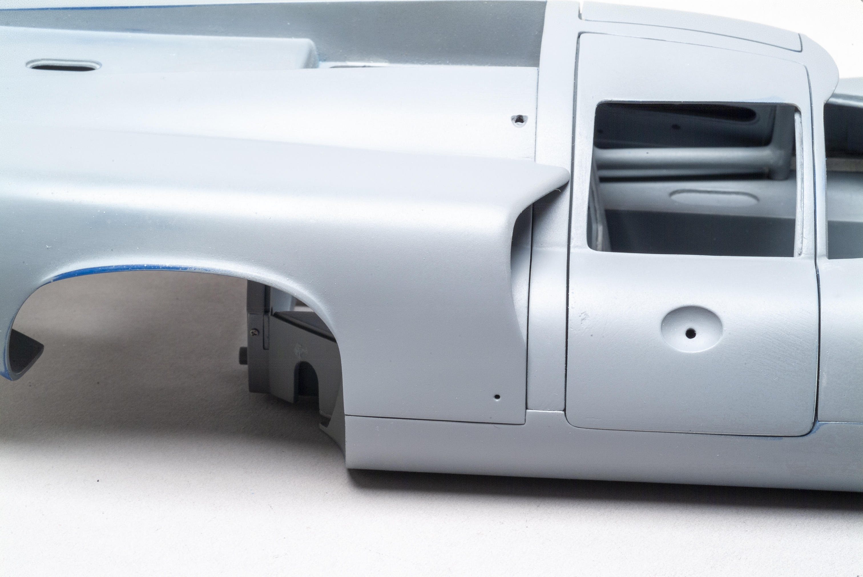

I’ll use four 1/8- x 1/16-inch neodymium magnets to secure the hinged engine cover on a Tamiya 1/12 scale Lola T70. First, determine where the magnets fit and work best. (You can even correct warped panels.)
FSDSNAP73_02

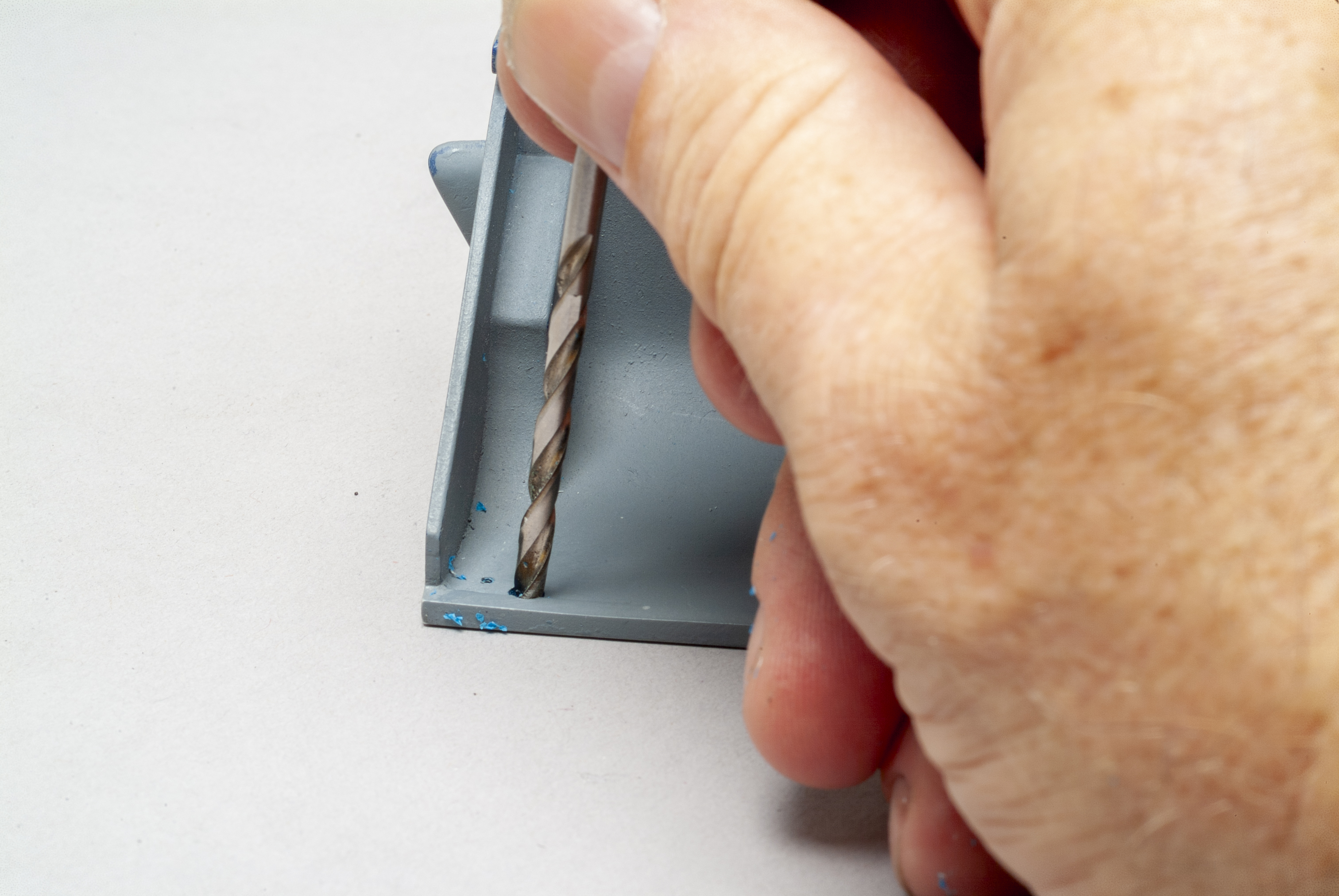

I measured and marked the engine cover where it and the chassis had a good mating surface and drilled a pilot hole with a pin vise through the cover, and made a dimple in the mounting boss. Then, I removed the engine cover and drilled the hole in the boss deeper.

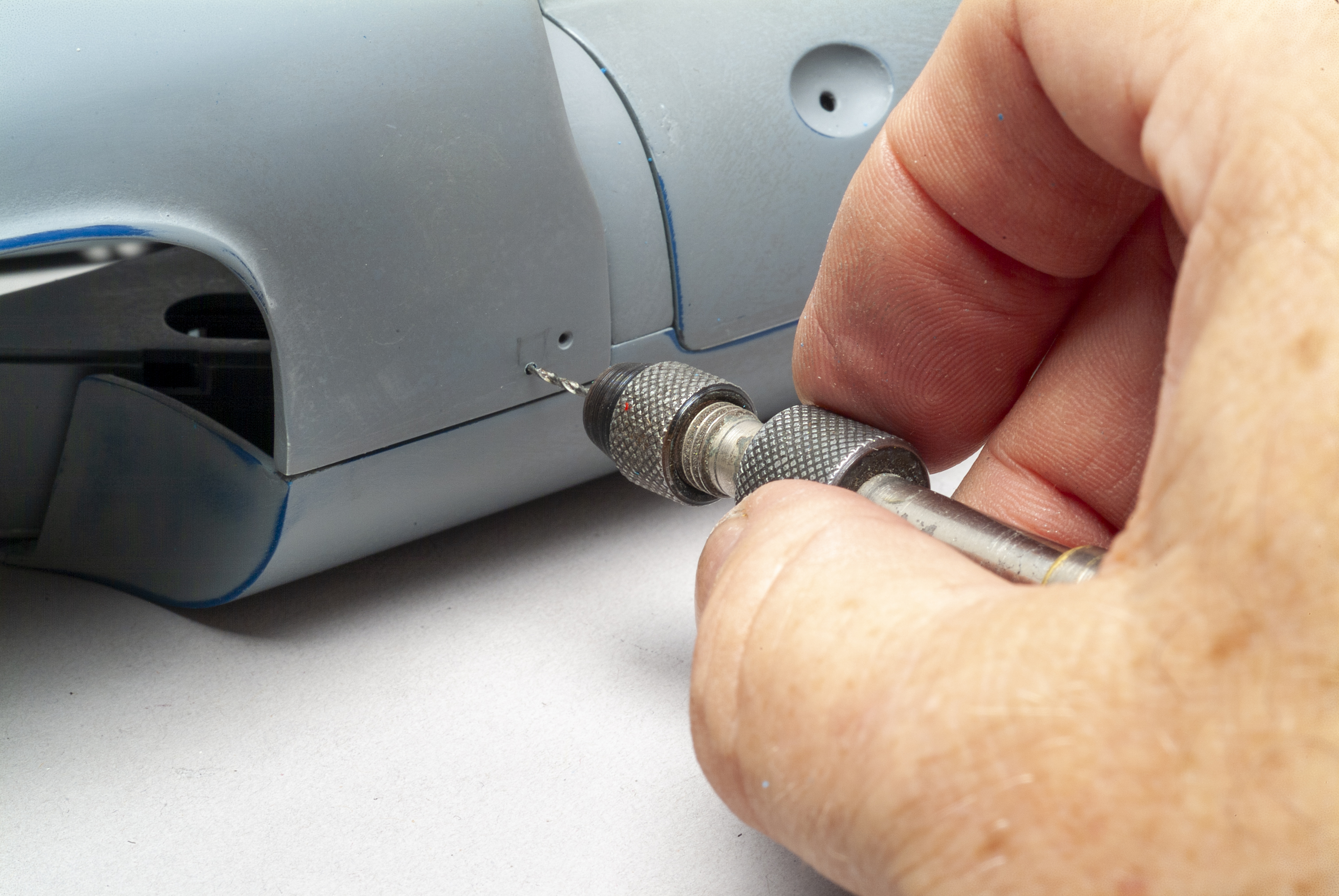

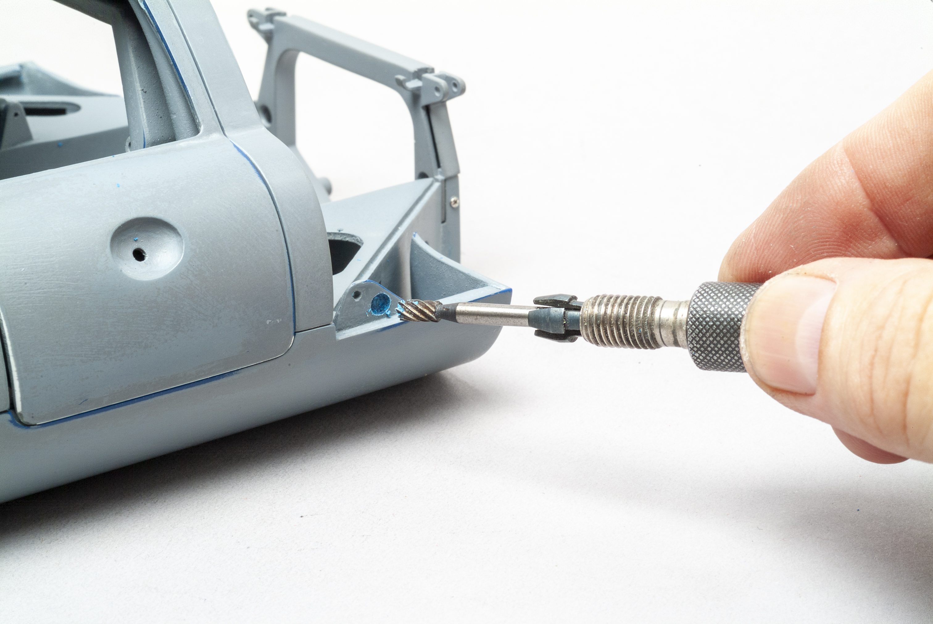

The pilot holes on the engine cover and tub were enlarged by hand with a #31 (0.12 inch) drill bit. These four holes (two on each side) were drilled to a depth of about 1/16 inch — the thickness of the magnets. I used a smaller drill than the 1/8-inch diameter of the magnet, so the final hole size would not be too oversized.
FSDSNAP73_04

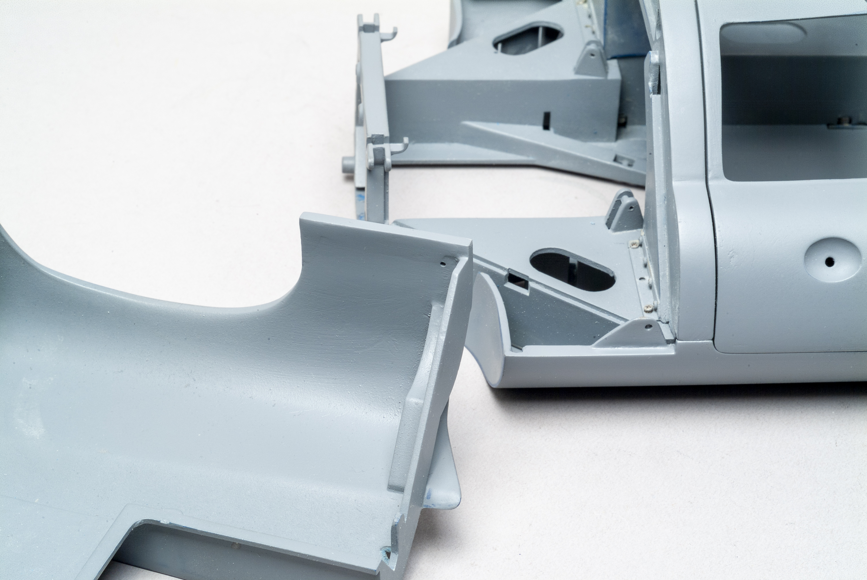

A 1/8-inch rotary tool cutting head chucked in a pin vise worked well to make the magnet recesses the final size. It gave the holes a flat bottom for the magnets to rest against, but the holes do not have to be exact, tight fits.

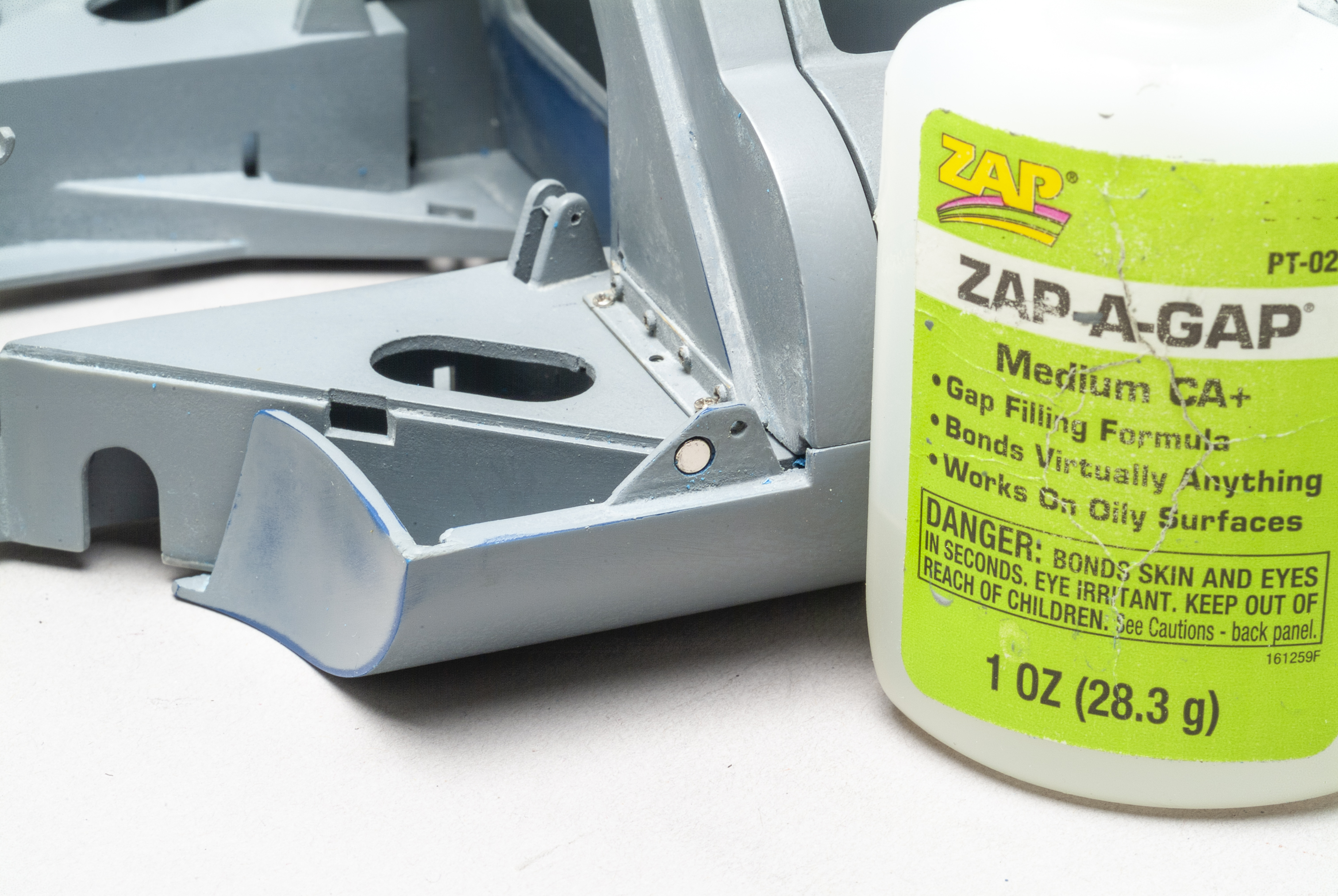

I superglued the magnets in place. I like superglue because it’s quick and can be sanded. However, you could use 5-minute epoxy. A second drop of superglue on top of the magnet seals it into the part. Beware the magnets’ polarity and make sure to install them so they attract instead of repel their mated magnet.

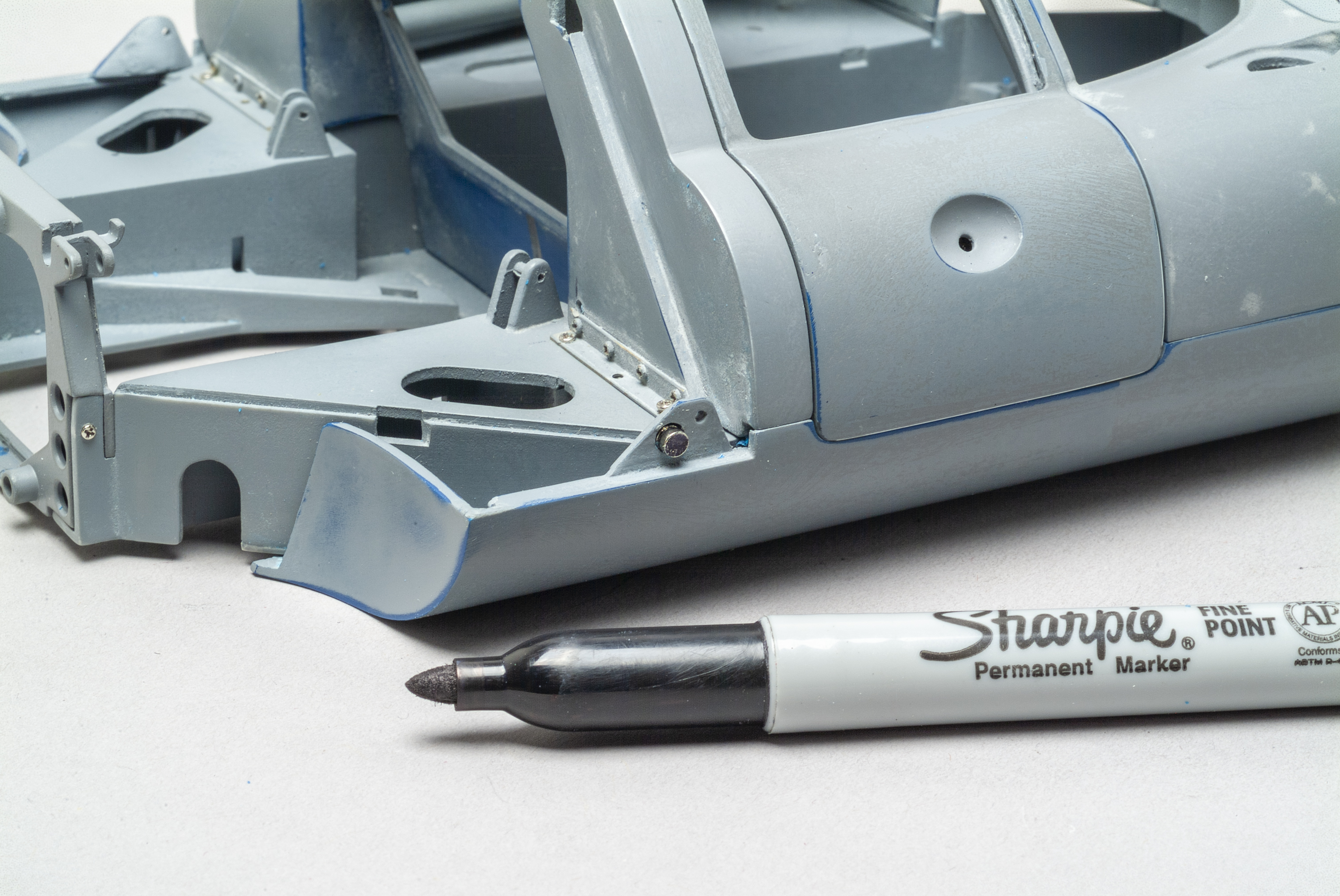

To ensure I installed the second magnet with the correct attracting polarity, I set it on its mate already installed. Then I marked the side that would be glued to the engine hood with a black marker — ink side means bottom of the recess in the mating surface.
