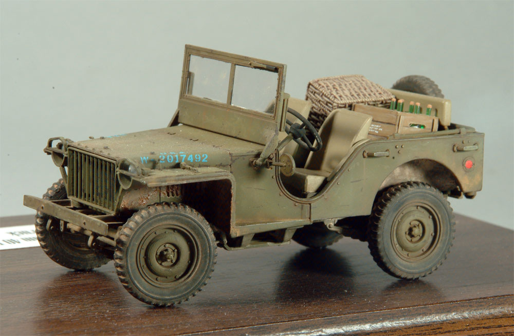

David, a jeep fan, built Miniart’s 1/35 scale Bantam BRC 40, adding a little Eduard photoetched metal to detail the dashboard and modifying the front axle to pose the wheels turned. He used the kit decals to deploy the vehicle with U.S. Army in early World War II. He weathered with artist’s oils and Mig pigments.
