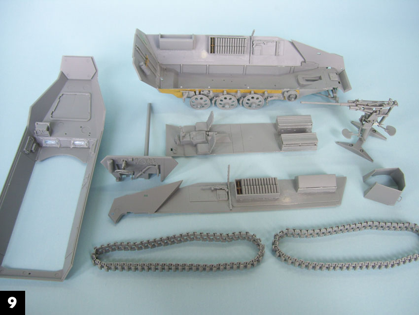

Working in subassemblies aided the painting process, 9, as I would have to paint and weather the interior before I joined the upper and lower hull. I added accessories to the interior after painting and weathering all the pieces, then carefully added the top hull, wrapping rubber bands around it to clamp the seal. (I was not impressed with the difficult alignment of the hull sides.)
