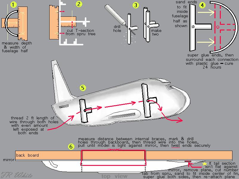

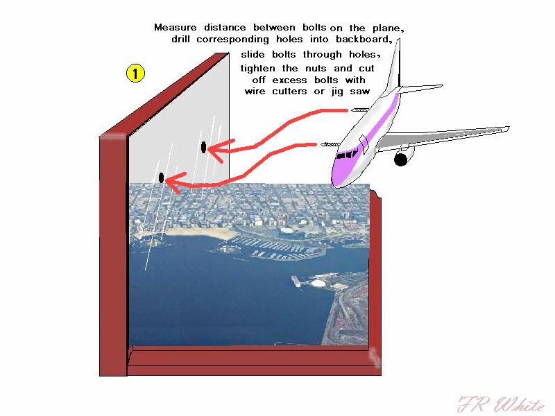

In the December 2010 FSM, Frank White explains how to create a mirror display diorama. See more of his display ideas and check out some of his illustrations.
mirror02
I also provided illustrations to go with my mirror-display story in the December 2010 FSM. They include some other attachment ideas as well as tips for modifiying kit parts.
