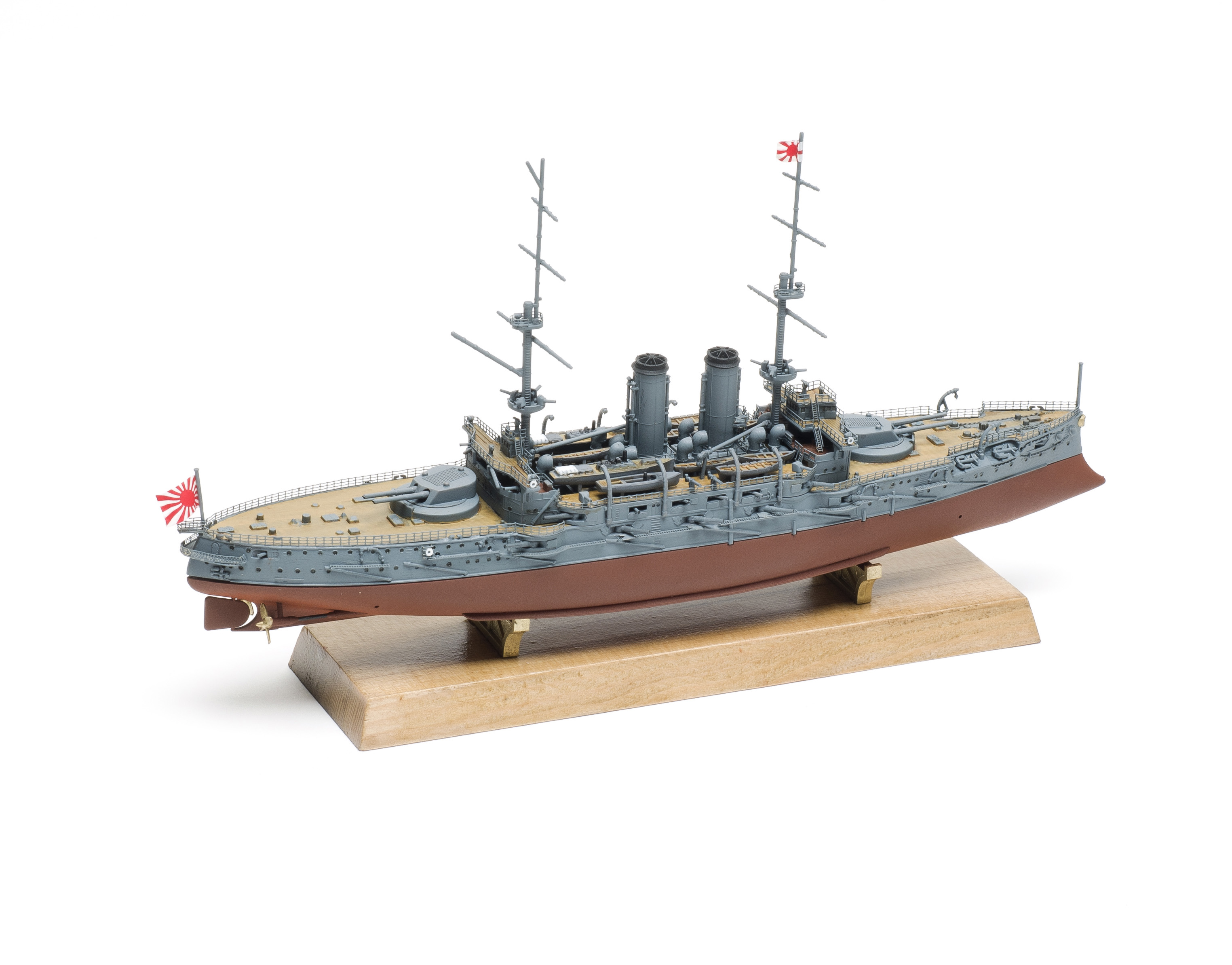

In Step 1, glue the three internal braces (parts D1-D3) for the upper hull to one half, rather than both as shown. This provides play in the upper hull when attaching the lower hull. I followed the instructions and had to shave the inner section of the hull to correct the fit. Step 1 also shows an option to drill holes for davits on the quarterdeck for the 1902 version.
Addition of PE parts, shown in separate instructions, begins with Step 4; pay careful attention to both sheets.
Take care attaching the central citadel structure to the deck. Mine had a slight curve, and clamping it to the deck caused the bow to rise. I loosened it with liquid glue to correct the hull’s shape, leaving a fine gap at the front of the structure.
The rest of the build was trouble-free, if fiddly given the amount of PE involved. I spent about 25 hours on basic construction and painting, but adding all of the PE took about 50 more hours; much of the extra time was spent trimming, bending, and attaching — as well as fixes for accidents. I appreciated the excellent PE railings with attachment points on the top and side sections, leaving the gluing surfaces smooth. Vulnerable catwalks for the torpedo netting and the captain’s walk fit nicely and proved to be sturdy during construction. I bent most gangway ladders to shape while still on the fret, leaving one side attached.
