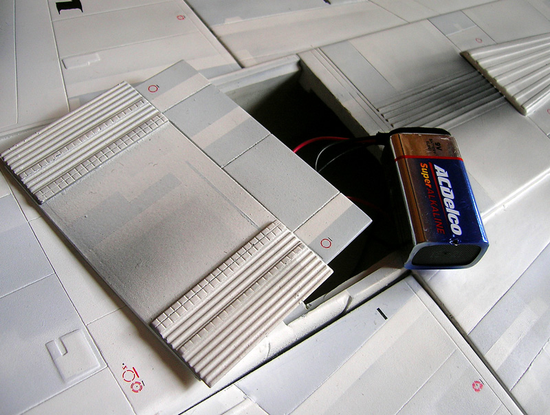

“The only removable part was a panel under the tail for the battery,” Theo says. “In retrospect, I should have made a removable bottom scoop triangle to cover a mounting point. Well, maybe next time.”

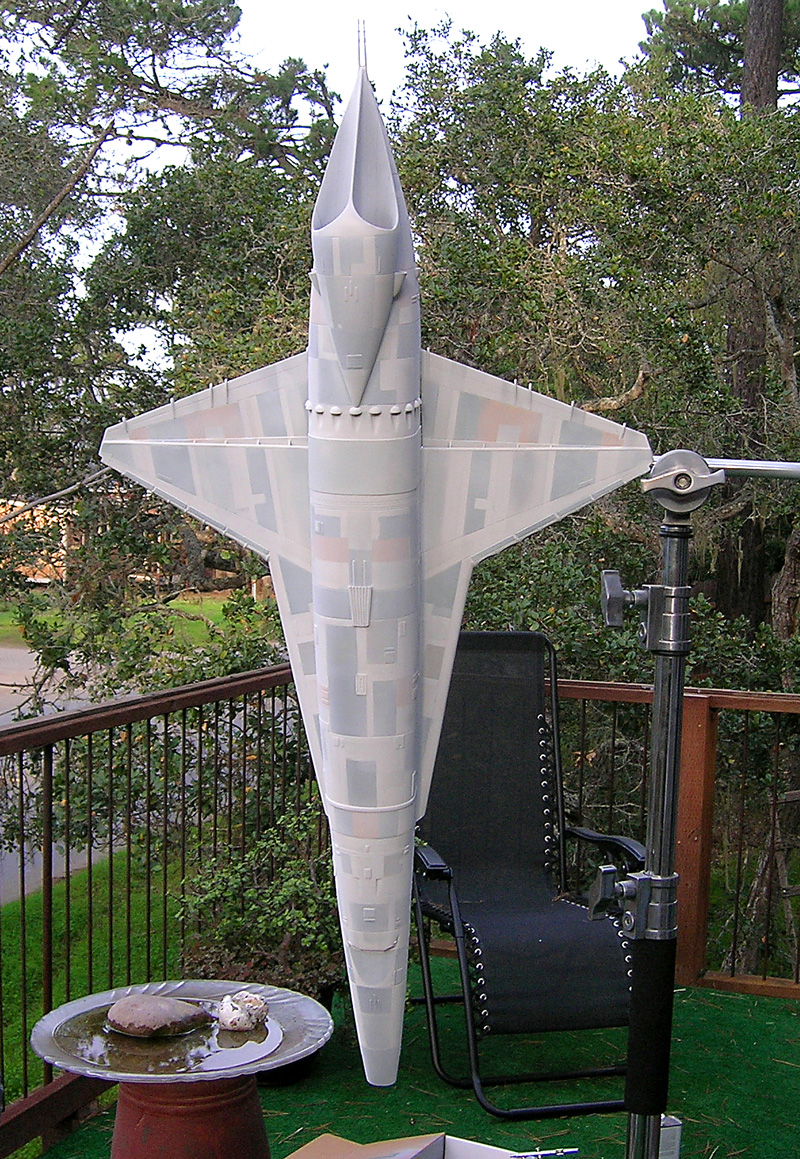

Painting a model this big in detail does get a bit cumbersome. Theo says, “I found it difficult to handle the model for the rest of the painting process due to it being in one piece and so heavy. I had seen pictures of another Orion model with multicolored panels, purported to be based on confidential photos which I was not privy to. I chose, however, to go with the warmer and cooler grays to be closer to what is seen in the film. I used Testors brand colors — radome tan, light gull gray, ghost gray, and aircraft gray. Once paneling was completed, everything was misted with Humbrol flat white to bring the contrast to an acceptable level.”

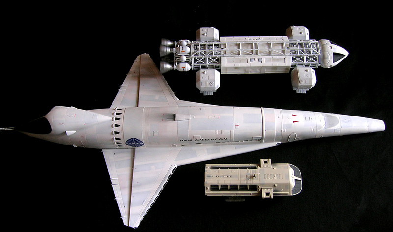

Theo says, “I determined this Orion kit was about 1/48-1/50 scale, about the scale of the Aurora/Moebius Moon Bus. I also found the new MPC Eagle kit to be in this scale as well. So the Orion and Eagle are not 1/48 scale, strictly speaking. Putting these three kits together shows how small the Moon Bus really is.

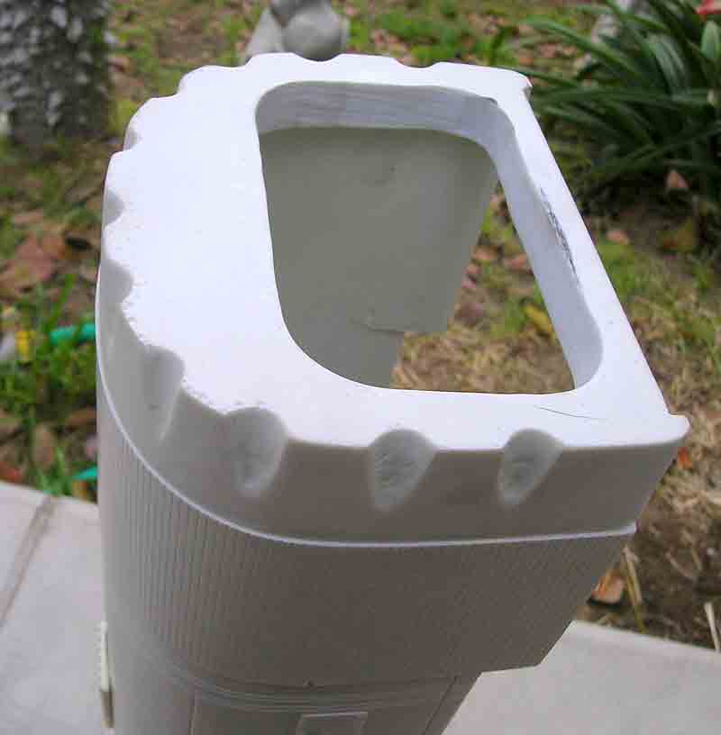

Theo cut out the ends to make access to the main body parts easier and reduce the weight.

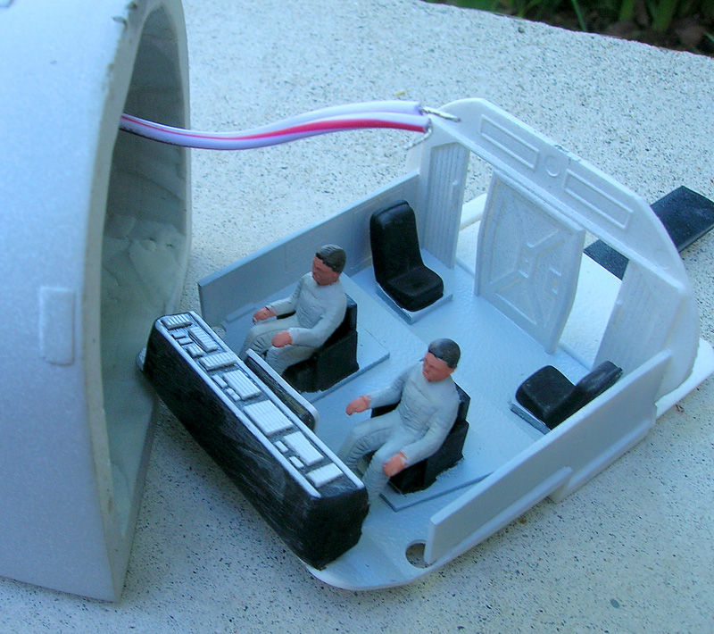

And, of course, now that he had raised the interior issue, Theo thought he might as well add a cockpit — but he knew the rabbit hole was getting deeper. “The flight deck was built with consoles and pilots, but I had to restrain myself from going too far,” he says.

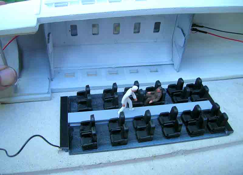

“I looked into the newly cut out windows and decided a model of this size should have an interior with lighting,” Theo says. “It needed only to be a basic interior, not blueprint perfect. Of course, this made things overly complicated for me.” Having judged the scale was close enough, Theo used the Moon Bus interior, casting resin copies for additional seats in the cabin. He also converted 1/48 scale figures for a passenger and crew, “the most drastic being the stewardess,” he says.
