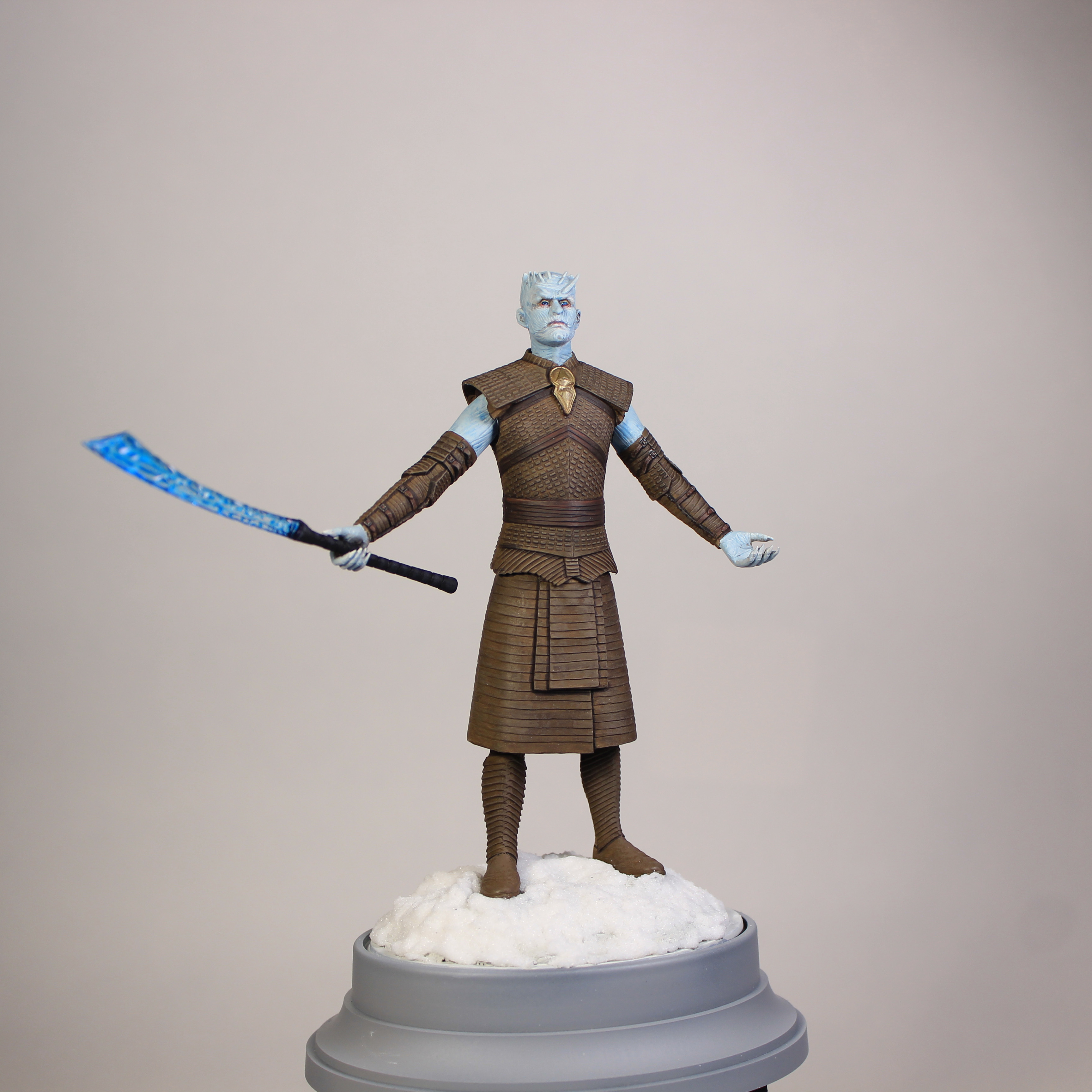

The build is straightforward but there are several parts that make up the head and hands. The head is in four separate pieces and there are several seams along the neck and back of the head that required putty.

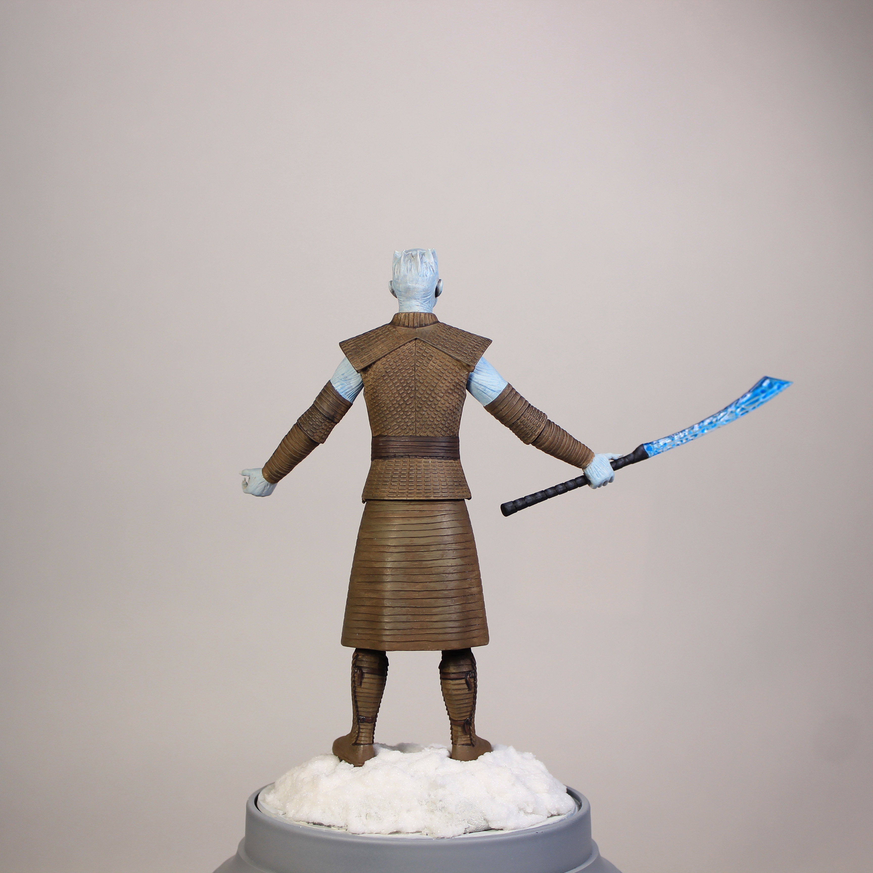

The hands comprise two parts each and required putty to eliminate seams. This is where you will have to make a choice: You can either glue the sword in place now or keep it out of the way by gluing it in later. If you choose the first, you’ll glue the sword into the palm and then assemble the rest of the hand. Or, do as I did by assembling the hands, painting the figure, then cutting the sword hand into two pieces, sliding the weapon into the palm, and reattaching the fingers.
When joining the two sections of the long skirt, there are major seam lines on both sides. These obviously need to be filled, but take care to not remove any molded details.
I painted the Night King using Vallejo and Andrea acrylics. The last thing I did was apply putty to the base to add height and then covered it with scenic snow.
All in all, this was a fun project and even with the cutting and putty, I spent only eight hours building and painting this terrifying creature.
