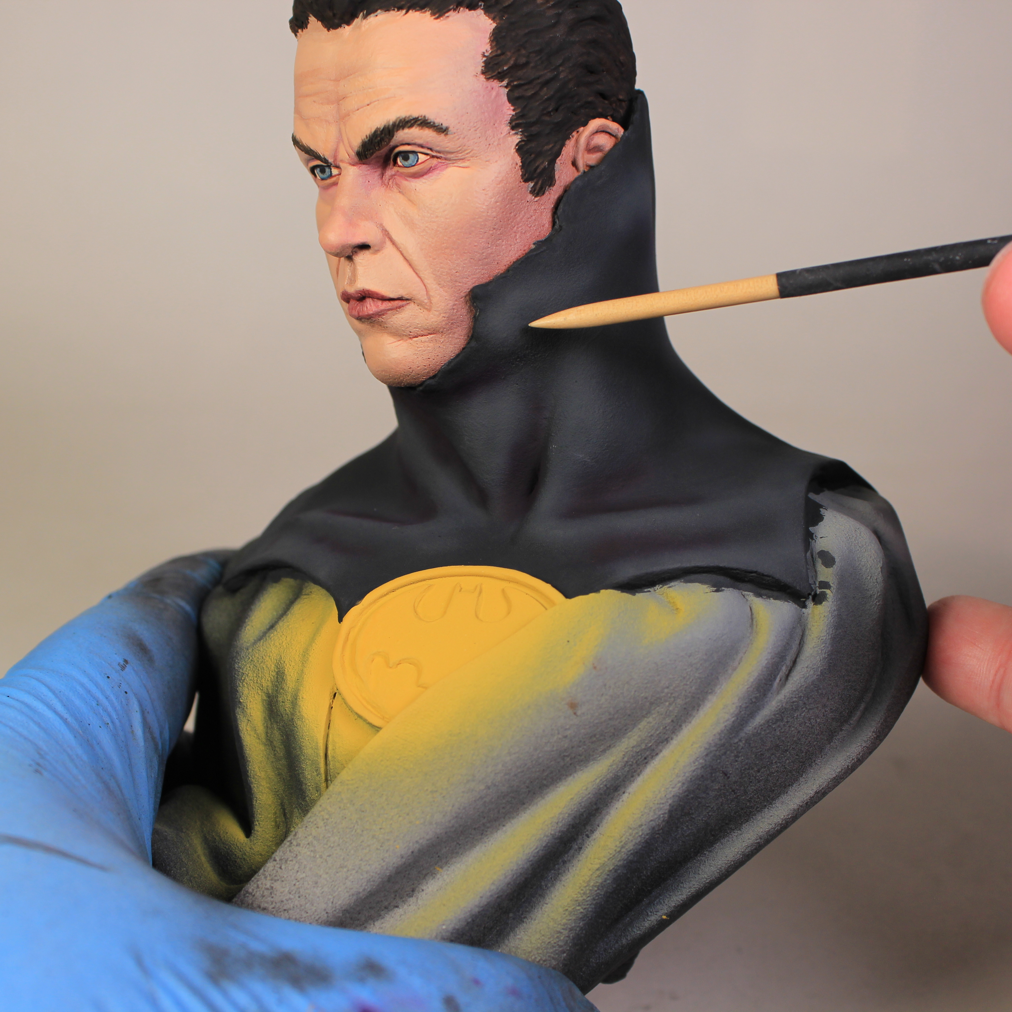

I took the Andre Yellow paint set No. 2 and No. 3 to get the desired yellow shade and I airbrushed it onto the bat emblem area.

Here, I am base-coating the cowl using gray graphene and flat black.
09PaintBatmanCapeIMG_5782
I do this to help me see if what I have done is to my liking, or if there are things I need to correct or adjust. For example, this is when I realized that the eyes were too bright, and I corrected them later.

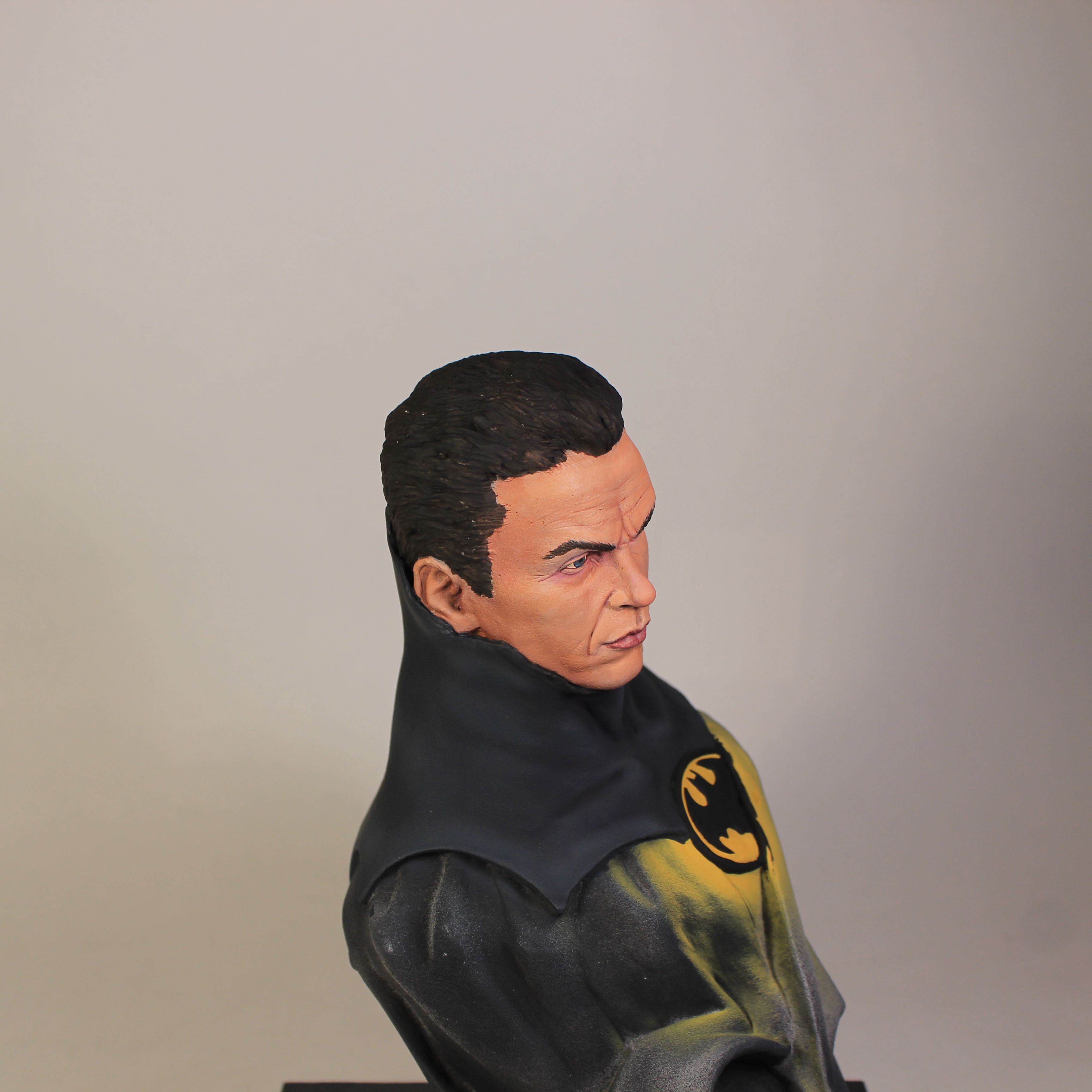

00PaintBatmanCapeIMG_6065
In the November 2020 issue, Joe Hudson painted the face of Michael Keaton as Batman using airbrushing and hand-painting techniques. Here, he shows you how to paint the Caped Crusader’s sleek black cape and bat emblem.

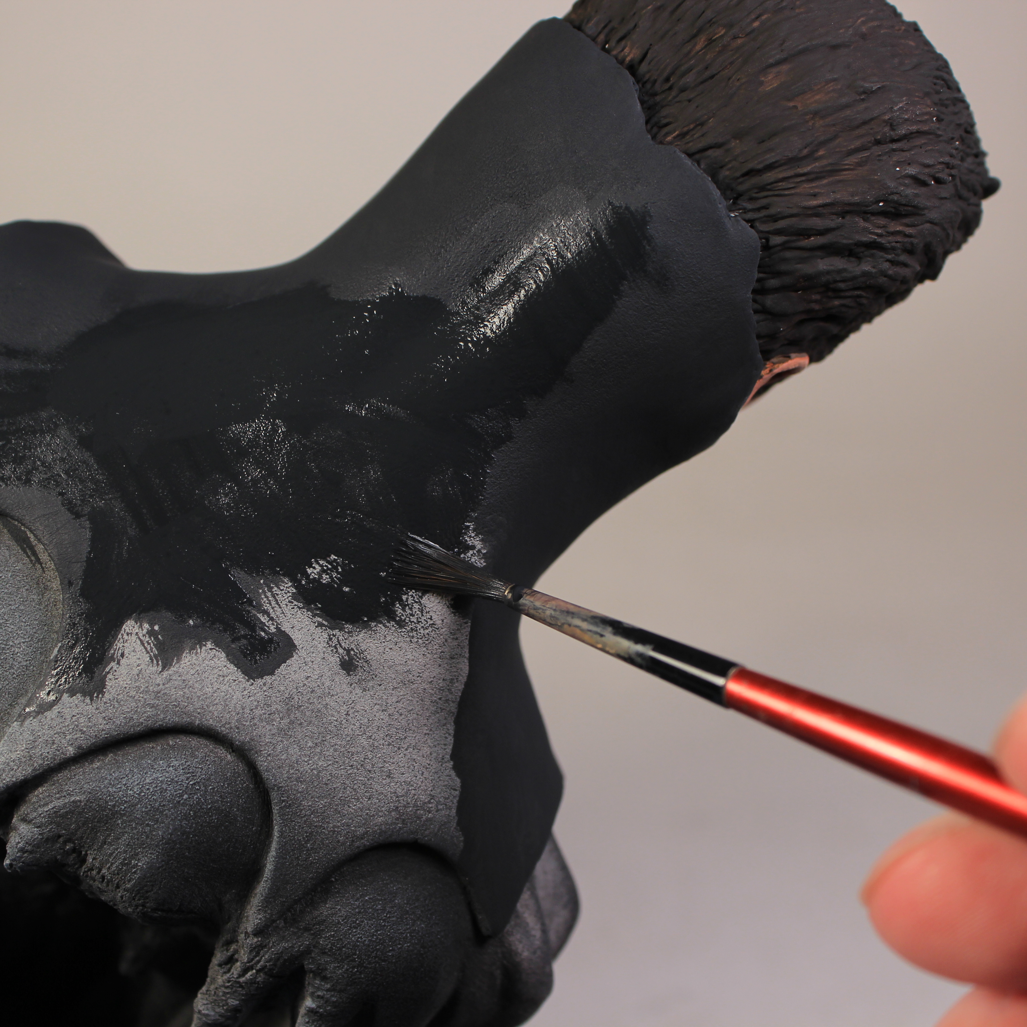

The next thing I did was spray flat black on the left side (the figure’s right side) because this side would be more in the shadows.
03PaintBatmanCapeIMG_5715

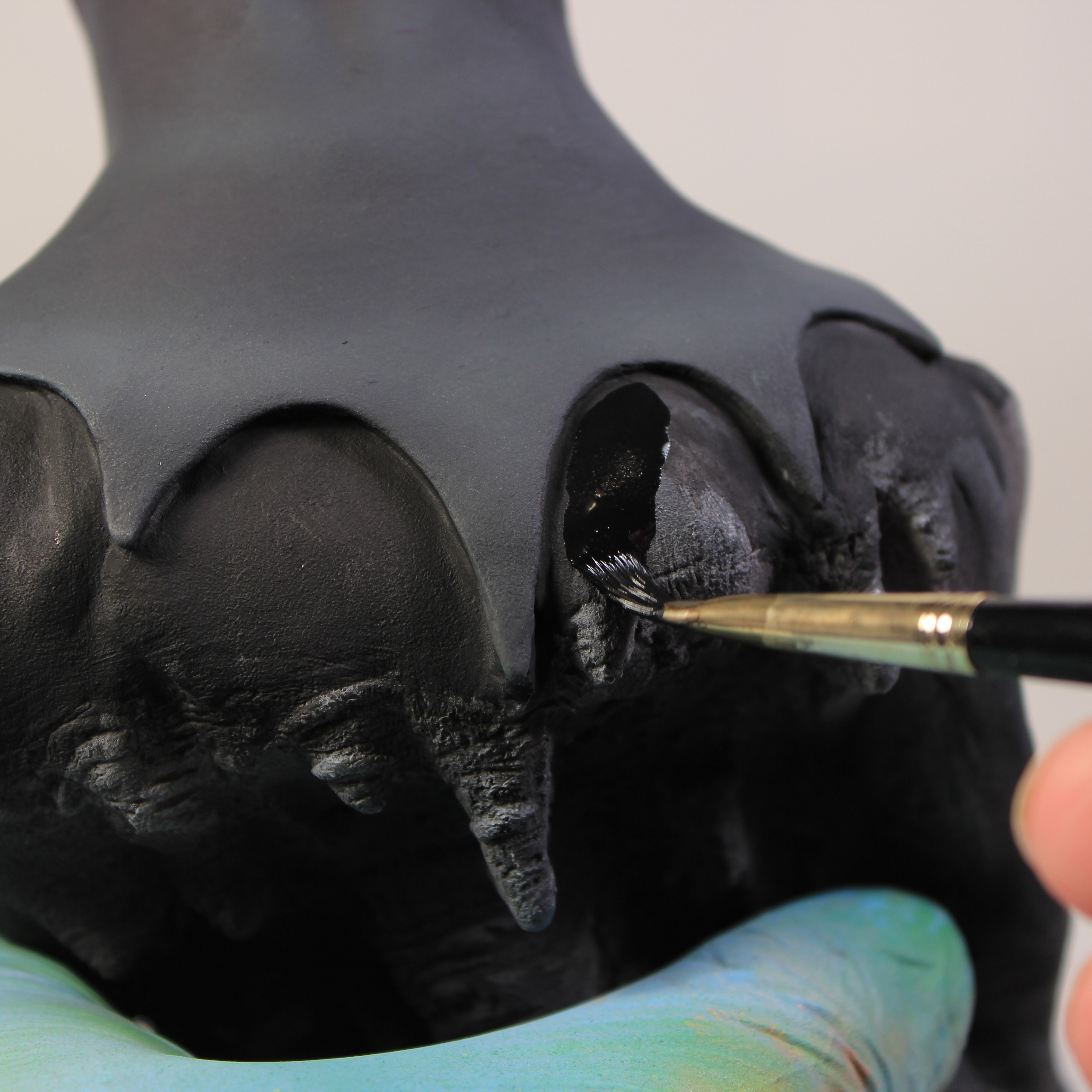

I used my brush and pure gray graphene to edge the broken areas from the cowl.
16PaintBatmanCapeIMG_5797
