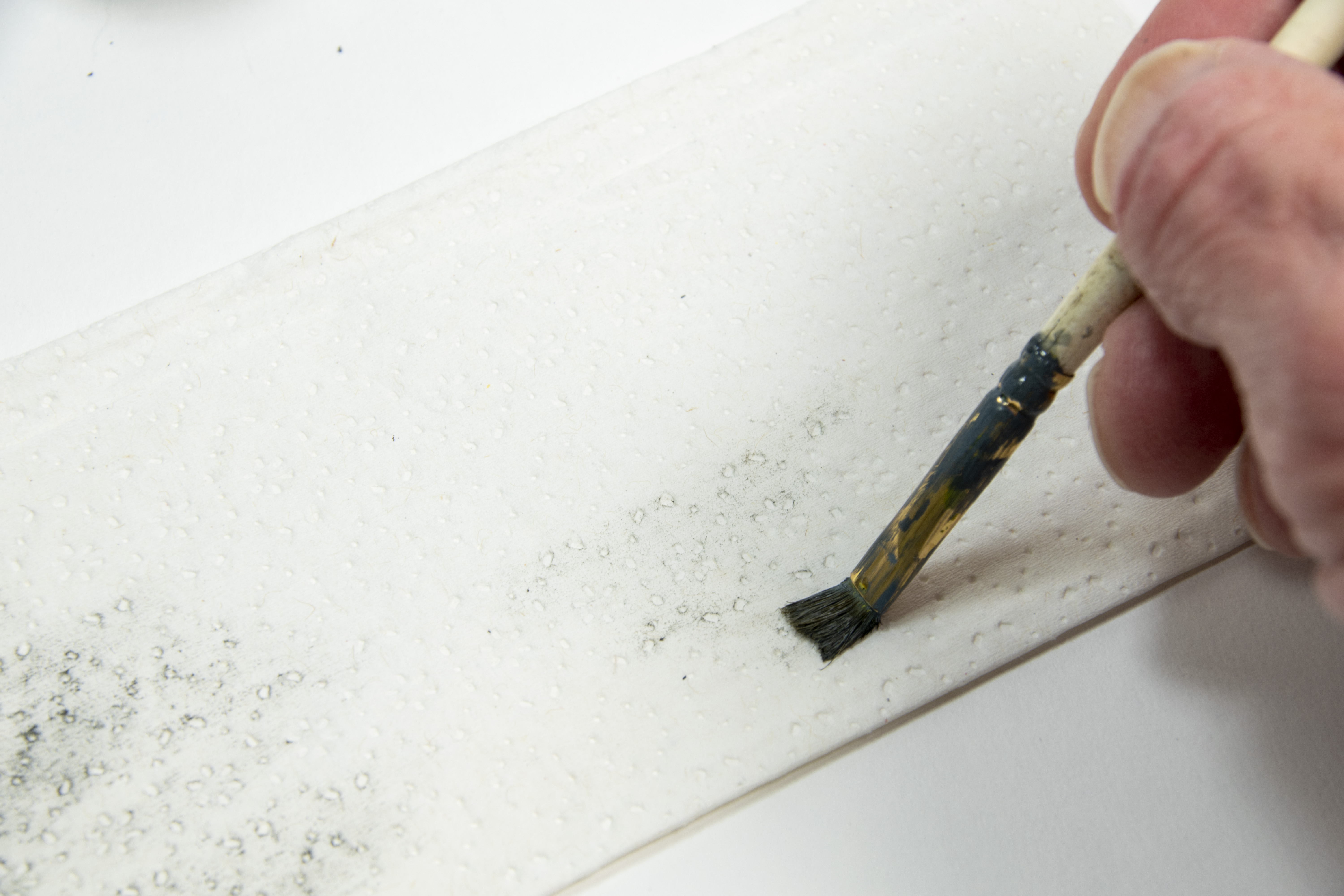

Drag the brush repeatedly across a paper towel to remove the paint. How do you know when the brush is ready to use?
FSDSNAP024_04
When the brush is leaving almost no mark on the paper towel, it is ready to use on the model. Basically, the brush is dry, hence dry-brushing.

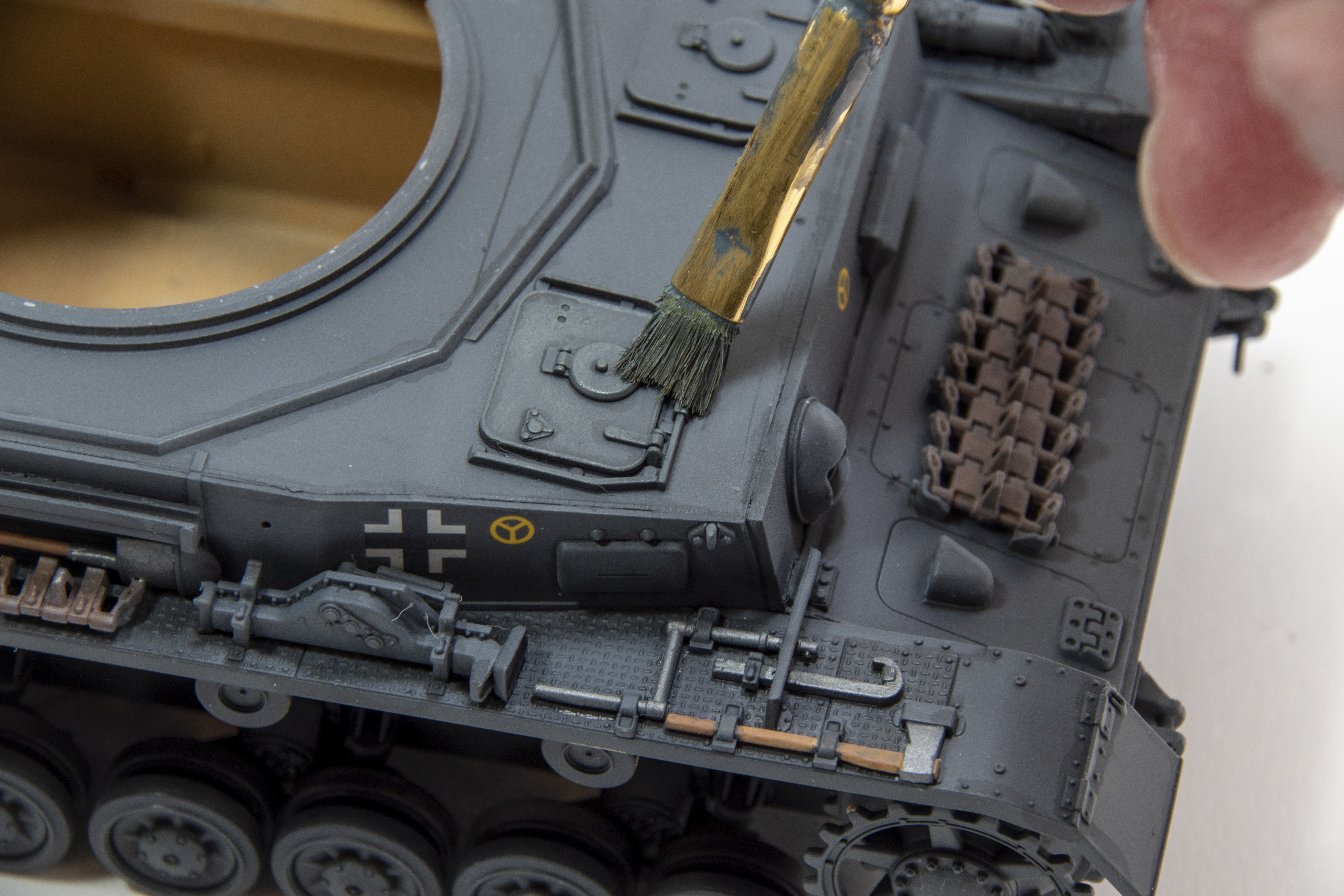

Here’s where the magic happens. Gently and repeatedly stroke the brush across raised details, like this radio operator’s hatch, to deposit a little of the lighter shade on edges and ridges. Rubbing harder or using a scrubbing motion can add wear or fading to flat surfaces.
FSDSNAP024_06

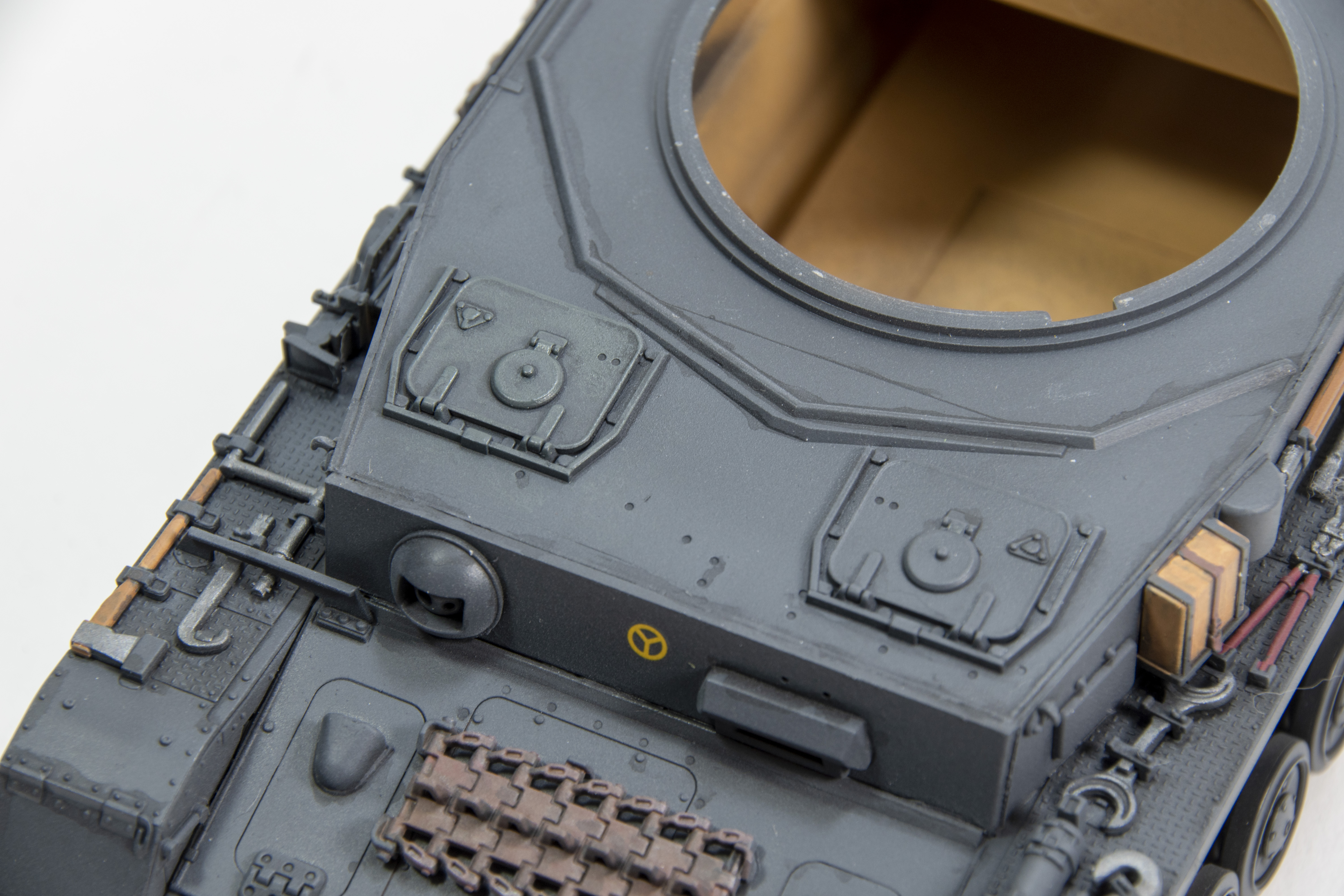

Note the effect on the dry-brushed radio operator’s hatch (left) and the untouched driver’s hatch (right). Keeping the effect subtle makes it appear the details are catching light and adds visual interest without making the effect appear cartoony.
