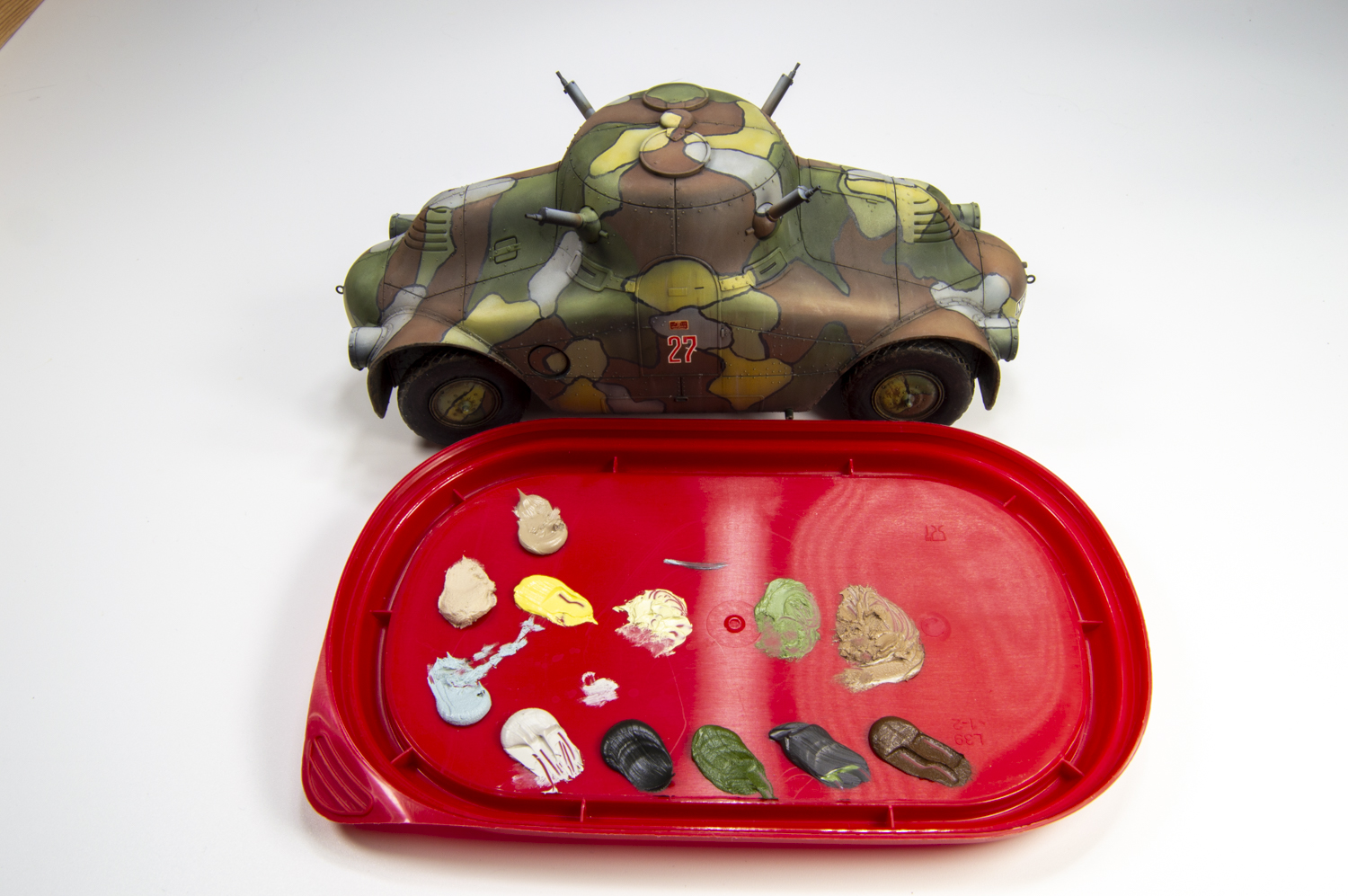

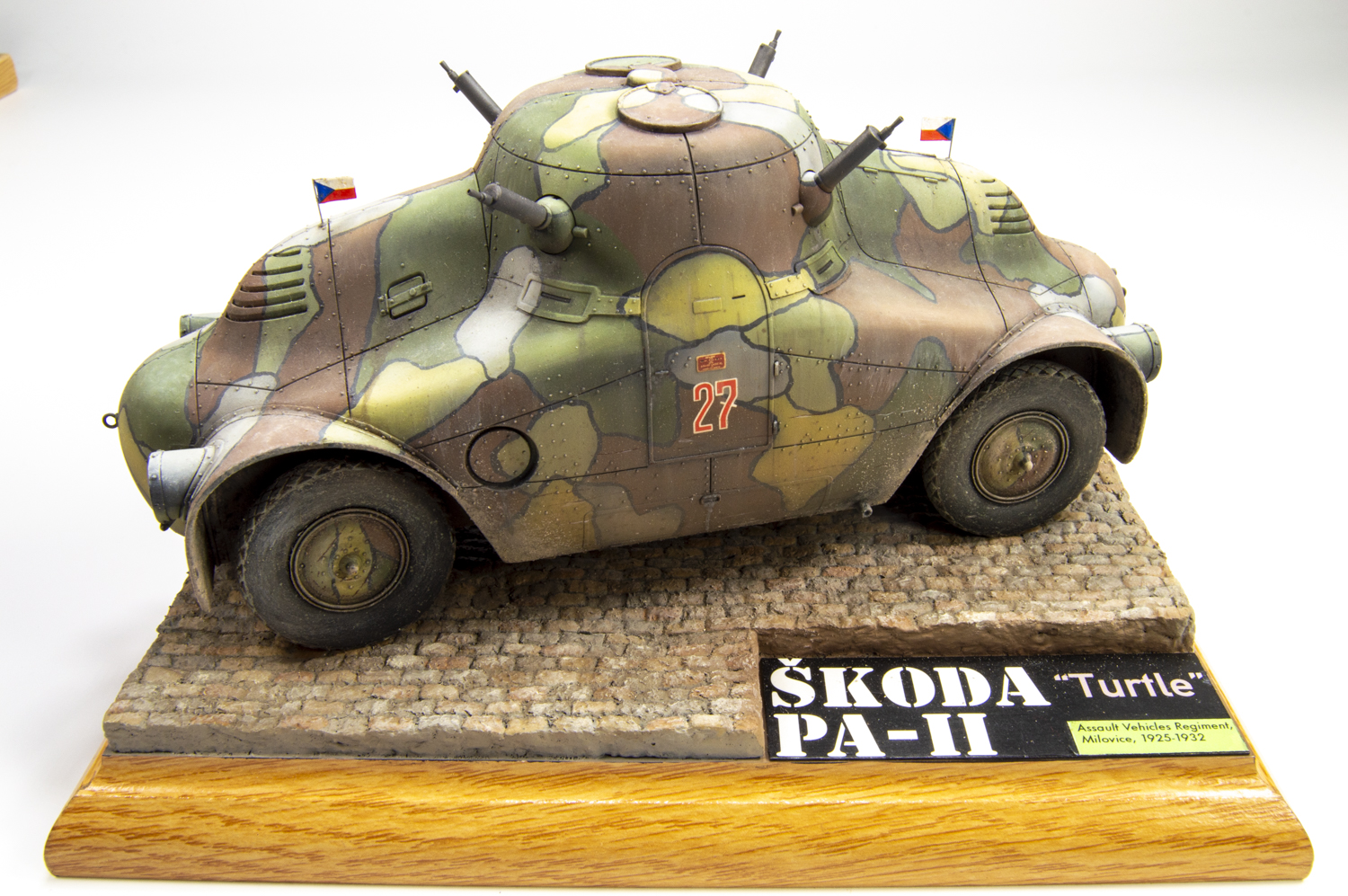

The multi-color, pre-World War II scheme on Takom’s 1/35 scale Skoda PA 2 Turtle is depicted beautifully on the box art, which inspired me to replicate it on the model.

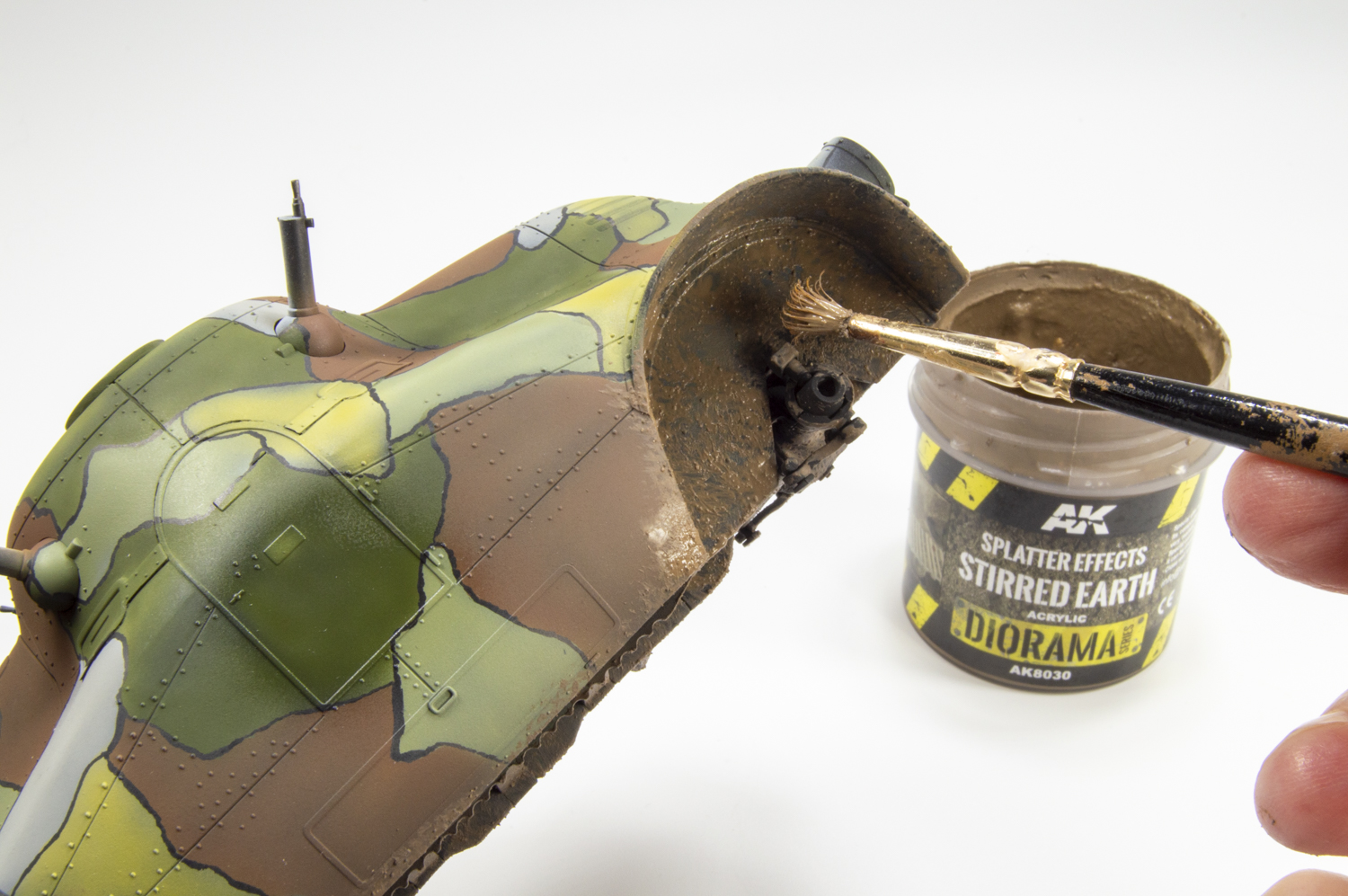

After repeating the painting-and-masking process for all four camouflage colors, I drew the demarcations between them with a Real Colors Flat Black paint marker (No. RCM033). I used AK Splatter Effects Stirred Earth (No. AK8030) to build up mud in the wheel wells and put a little on the bottom to show where mud would build up.

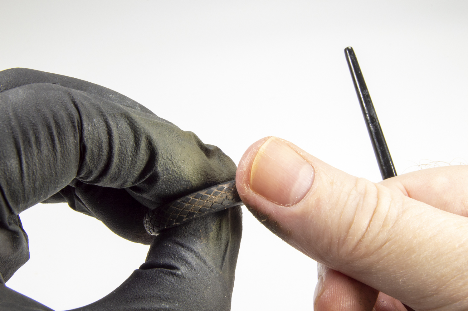

The kit comes with hard rubber tires that needed weathering. I started by coating the treads with the AK stirred earth and rubbing it in with my thumb. I also dry-brushed the side walls to achieve a dusty effect and tone down the rubber.

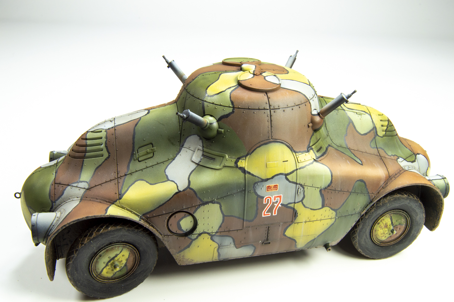

To reintroduce the highlights that accentuate the body lines, I made several mixes of artist oils to create highlights for each of the camouflage colors. I dry-brushed these to blend the oil paints and accent the areas on the armored car that would catch the light.

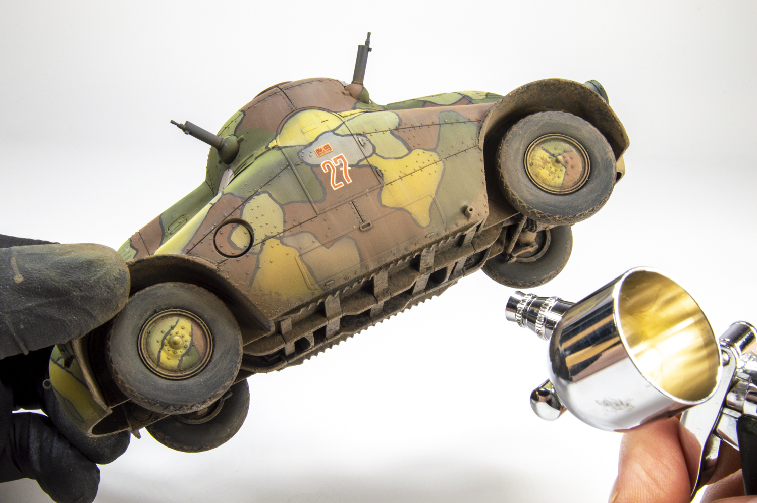

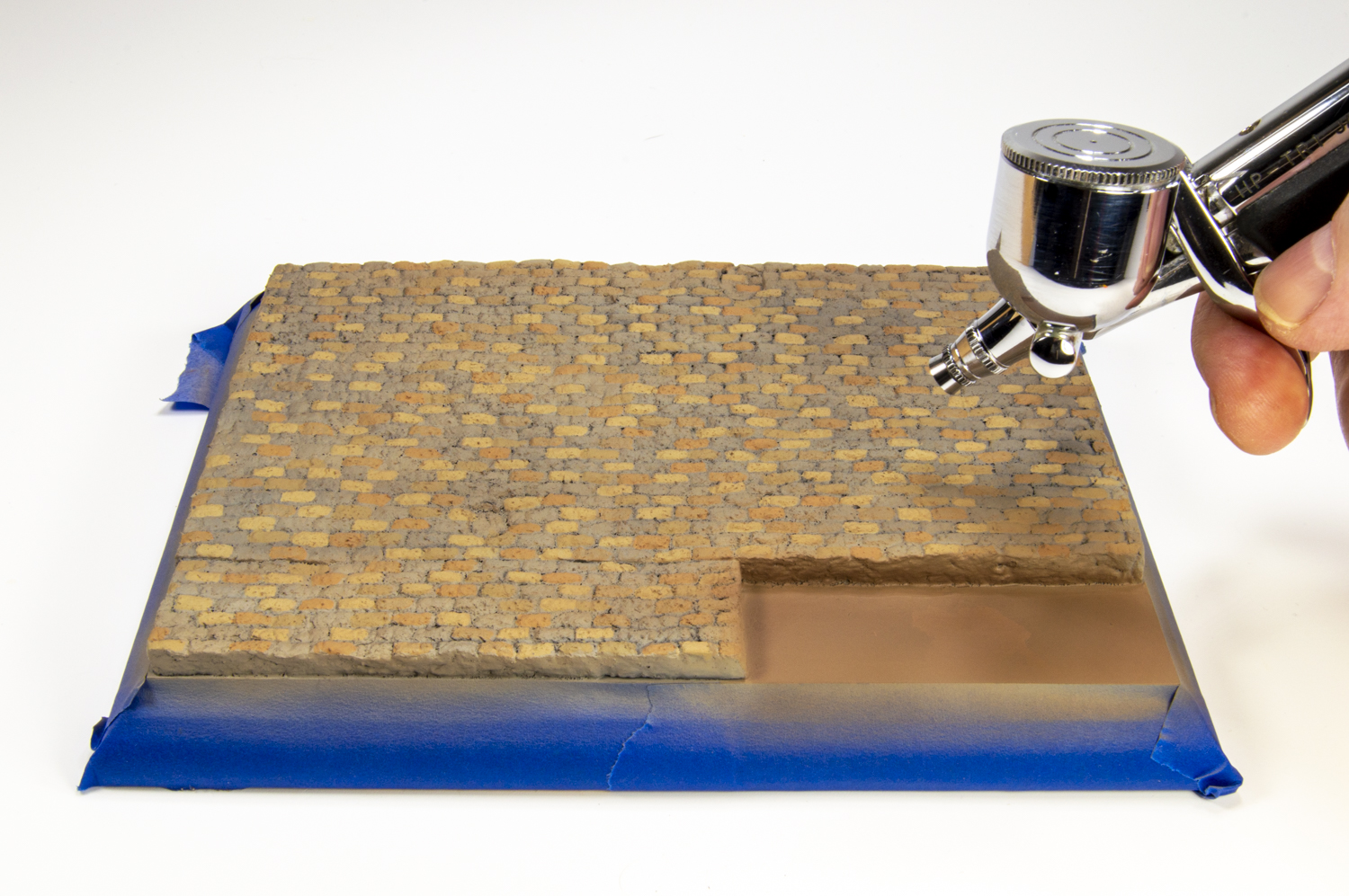

With this done, I misted on thinned Tamiya Flat Earth (No. XF-52) onto the bottom of the model and on the base to tie them together.
FSDSNAP076_ender
After painting a few more details and adding the flags, this project was complete. I was happy with how the result matched the box art. The color scheme is complex, but with a bit of time invested in masking with Silly Putty, it wasn’t too difficult to achieve. When you take a look at the kits in your stash and see one where the box art just grabs your attention, seize the inspiration and make it come to life. You will be glad you did.
