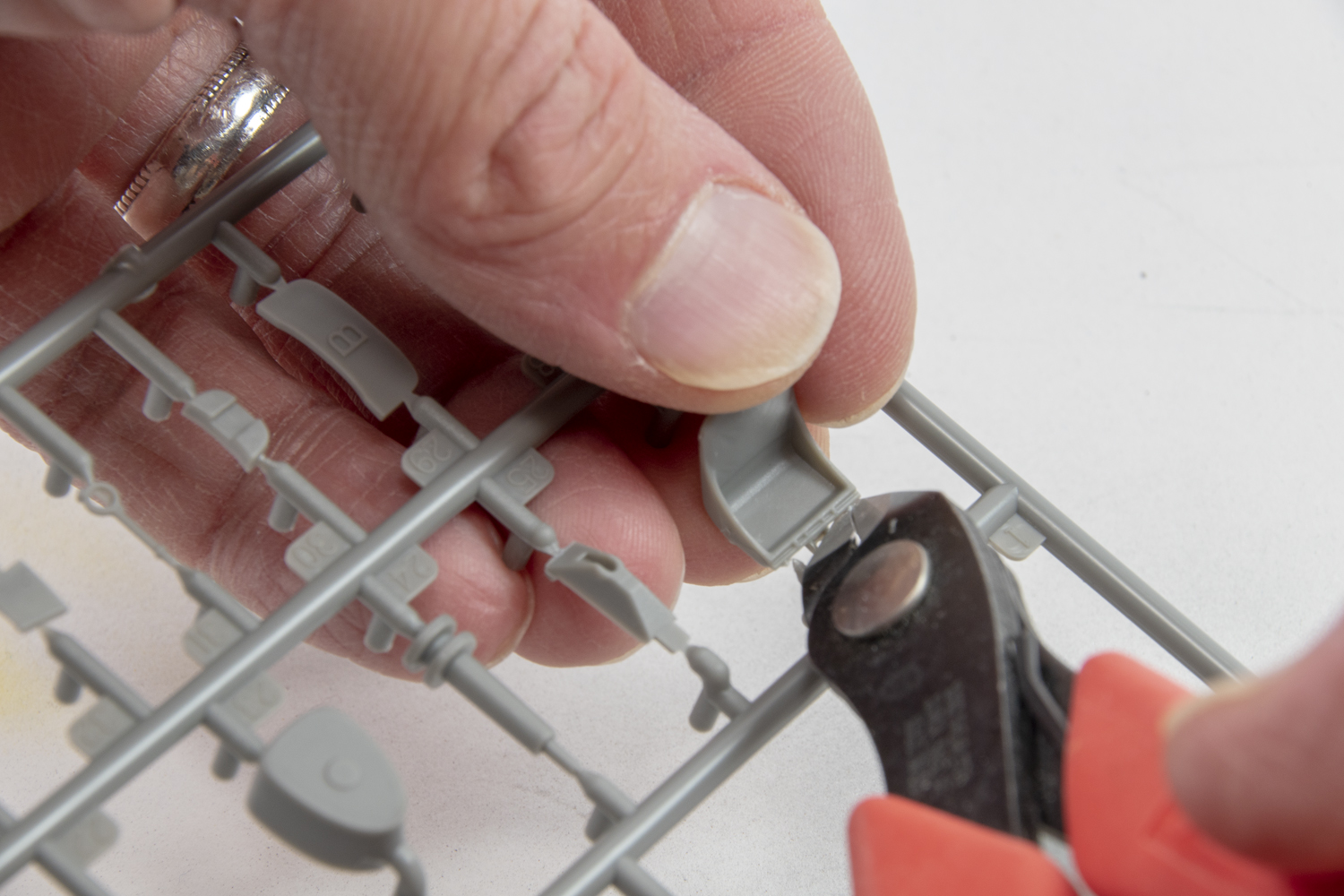

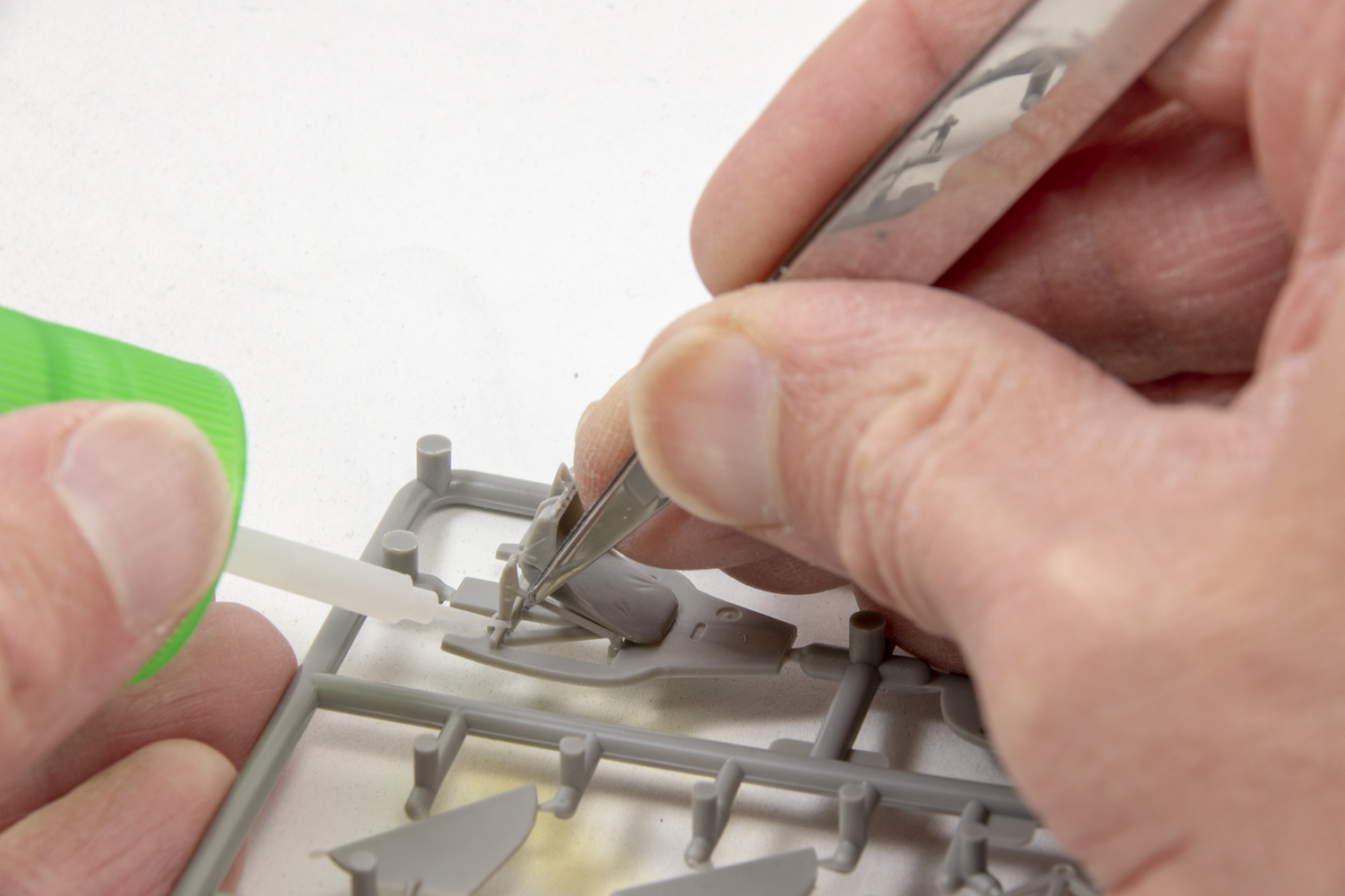

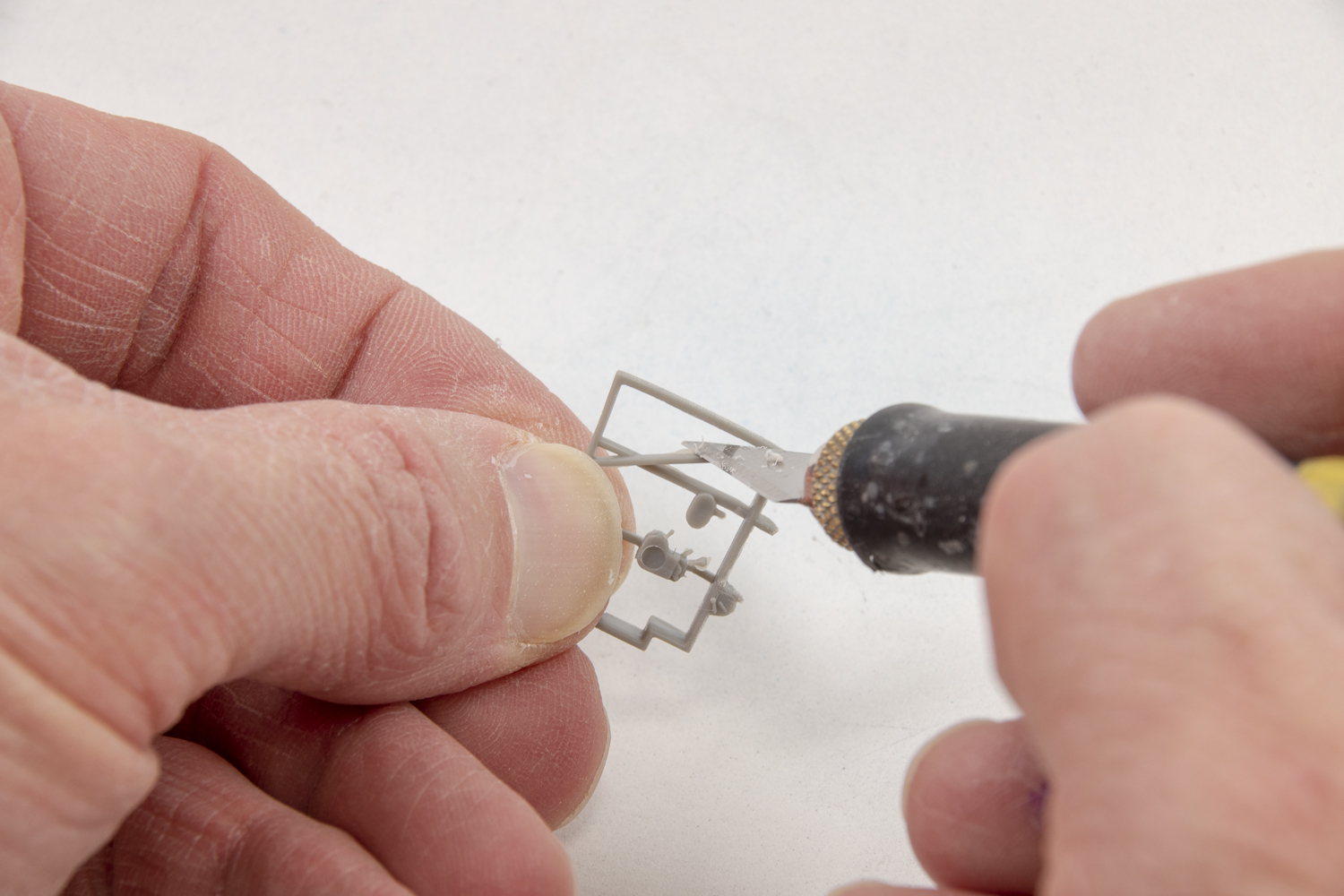

To remove plastic model parts from the parts trees, place the flat side of the cutter against the needed piece and gently squeeze the jaws closed through the attachment point. Remove parts as you need them to avoid losing any.to avoid losing them and to keep track of similar items.
FSDAB1122_02

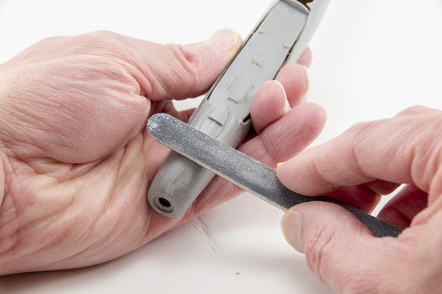

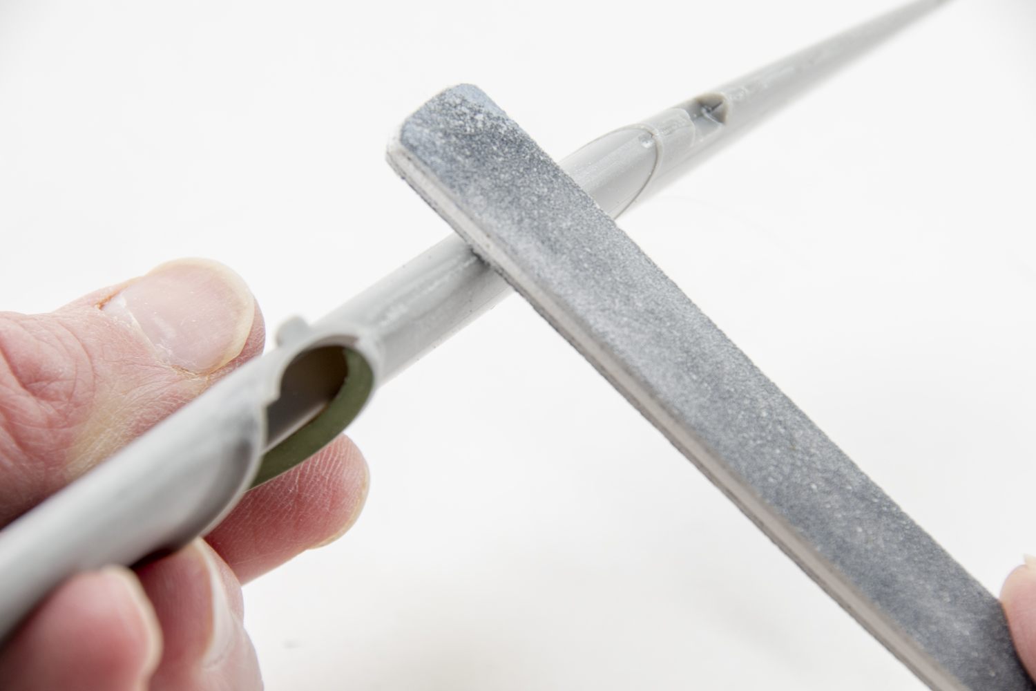

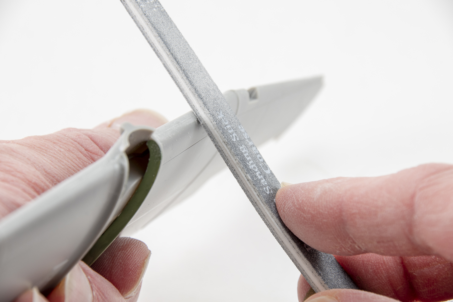

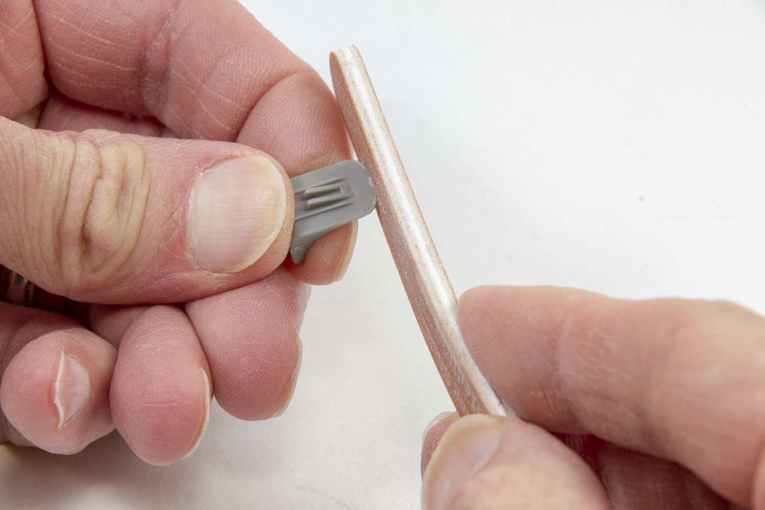

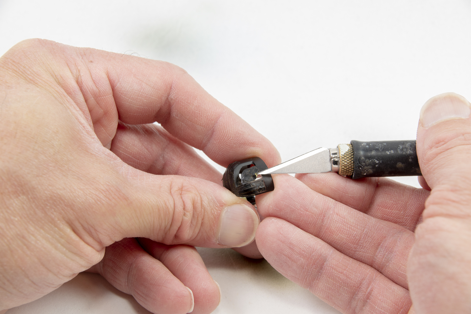

Remove remnants of the attachment point on plastic model parts with a sanding stick. All it takes is a few gentle strokes to smooth the surface. Using a finer-grit sanding stick will take care of scratches.
FSDAB1122_04

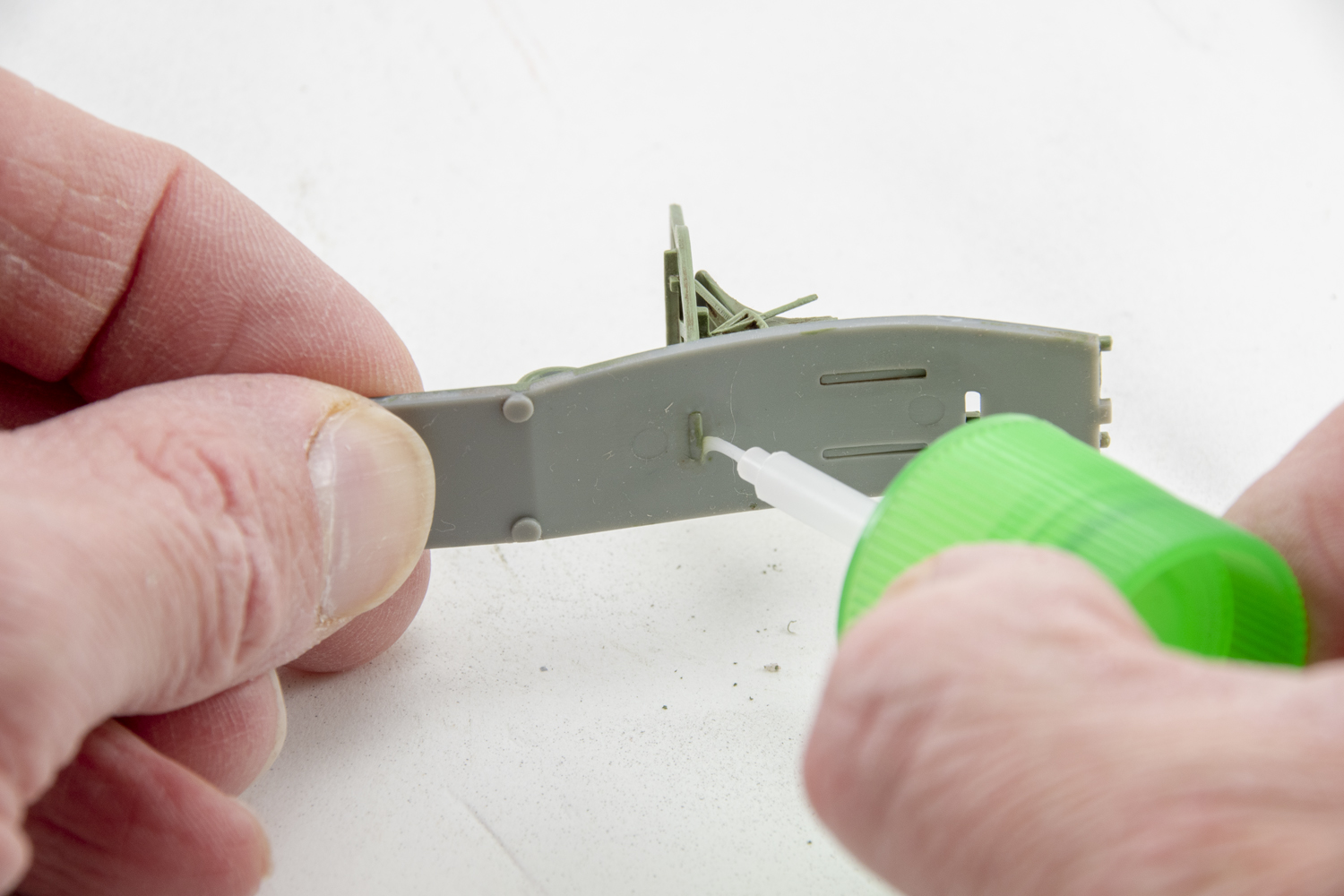

Hold small model airplane parts in place with tweezers as you apply cement. The cement works by dissolving the plastic along the joint and welding the surfaces together.

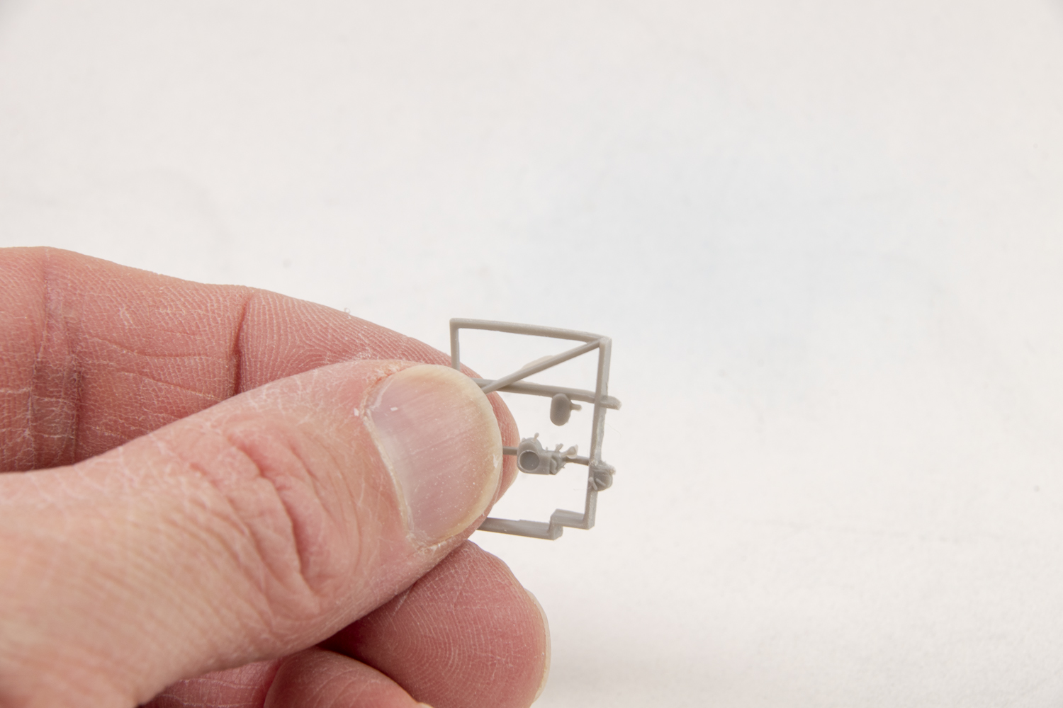

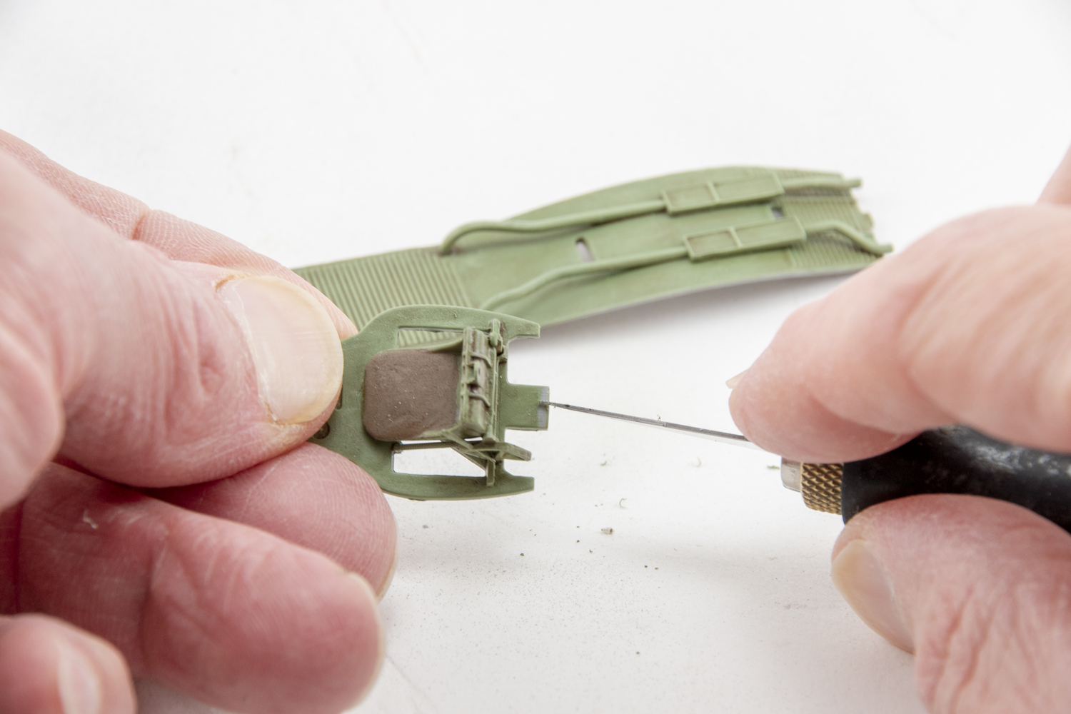

Occasionally, a little plastic can flow between the mold halves during manufacturing, producing a thin film that is known as flash (top). Slice it away with a sharp No. 11 blade. Be careful and go slowly to avoid cutting too deeply into the part or slipping and cutting yourself.

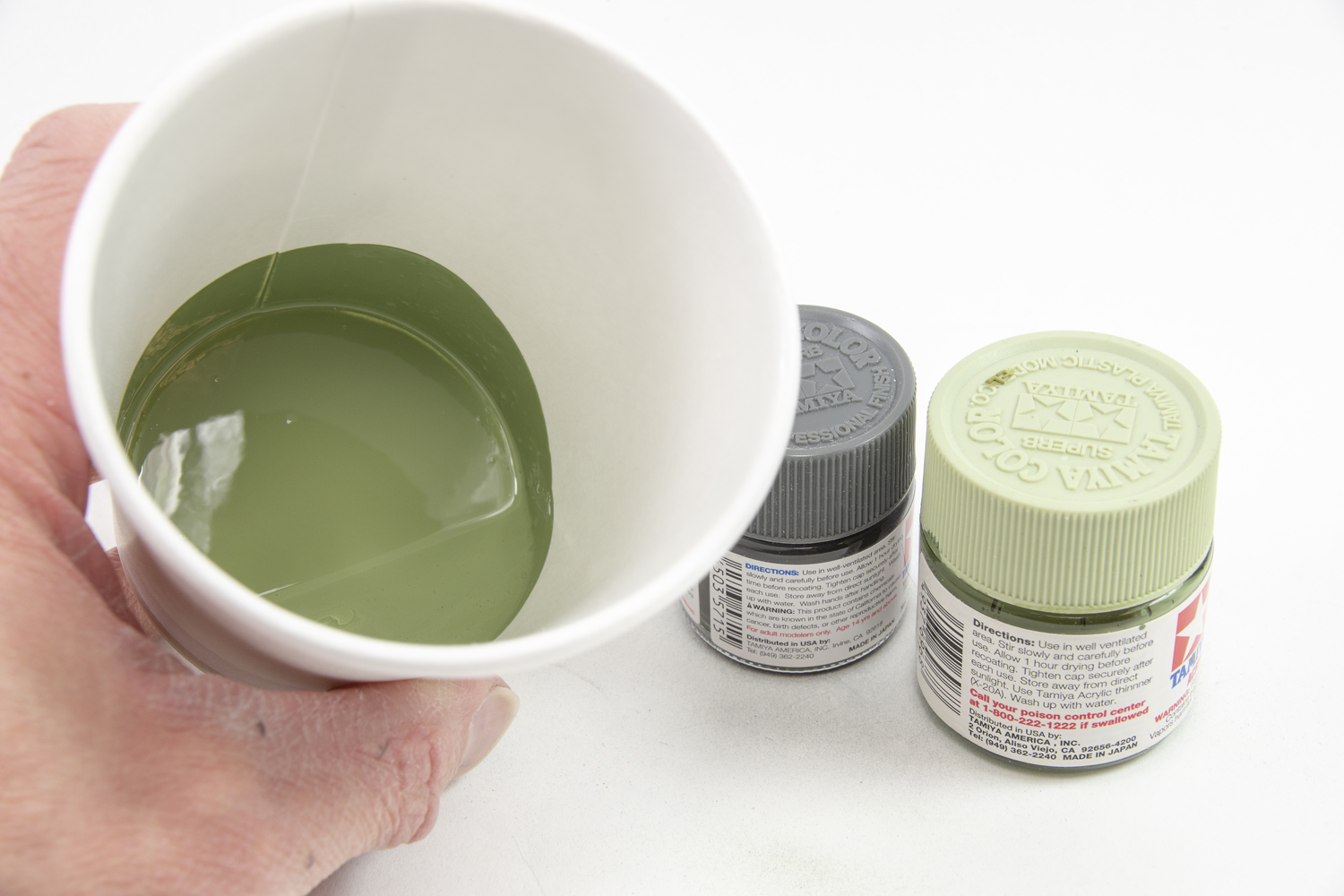

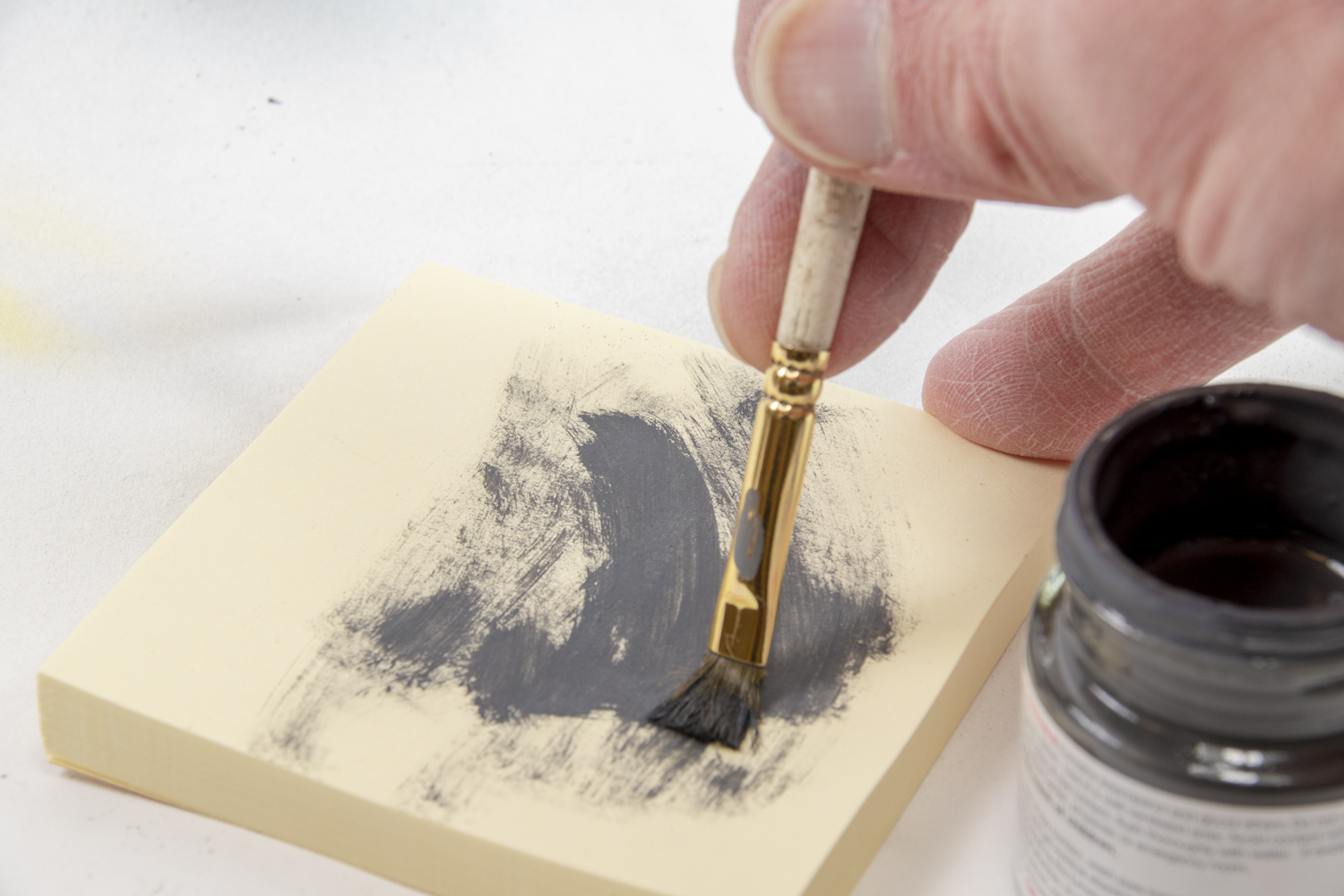

Tamiya acrylic paint was used for this military aircraft, so I mixed a little dark gray (XF-24) with cockpit green (XF-71) for a base coat. Some Tamiya thinner in the mix helped the paint flow.
FSDAB1122_08

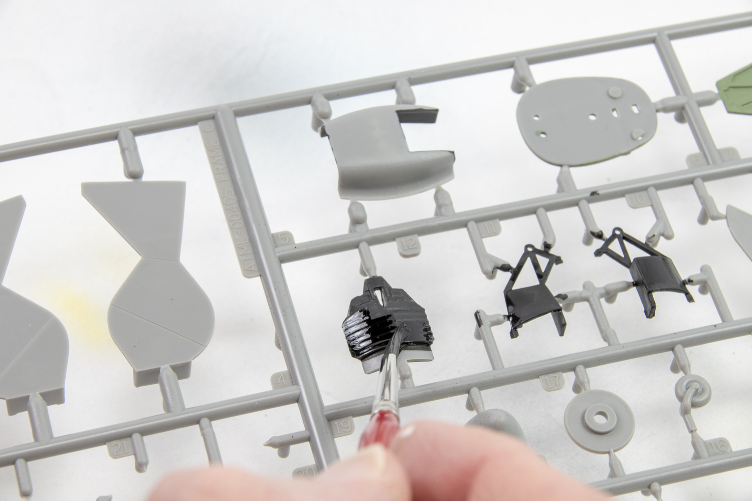

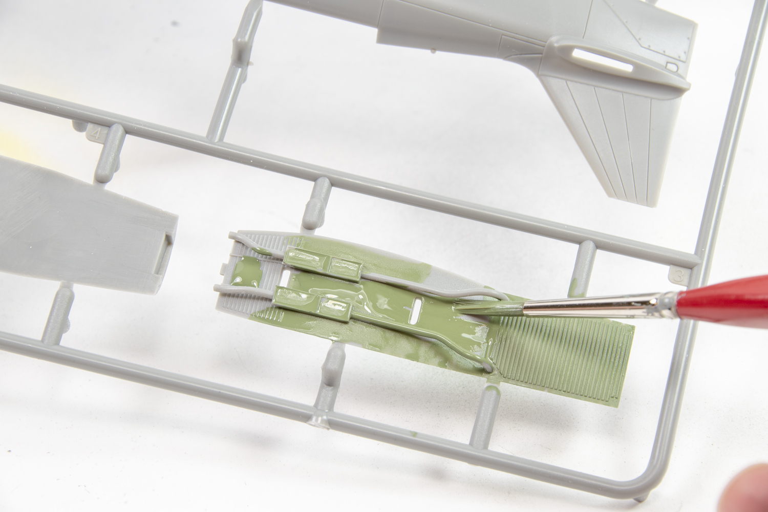

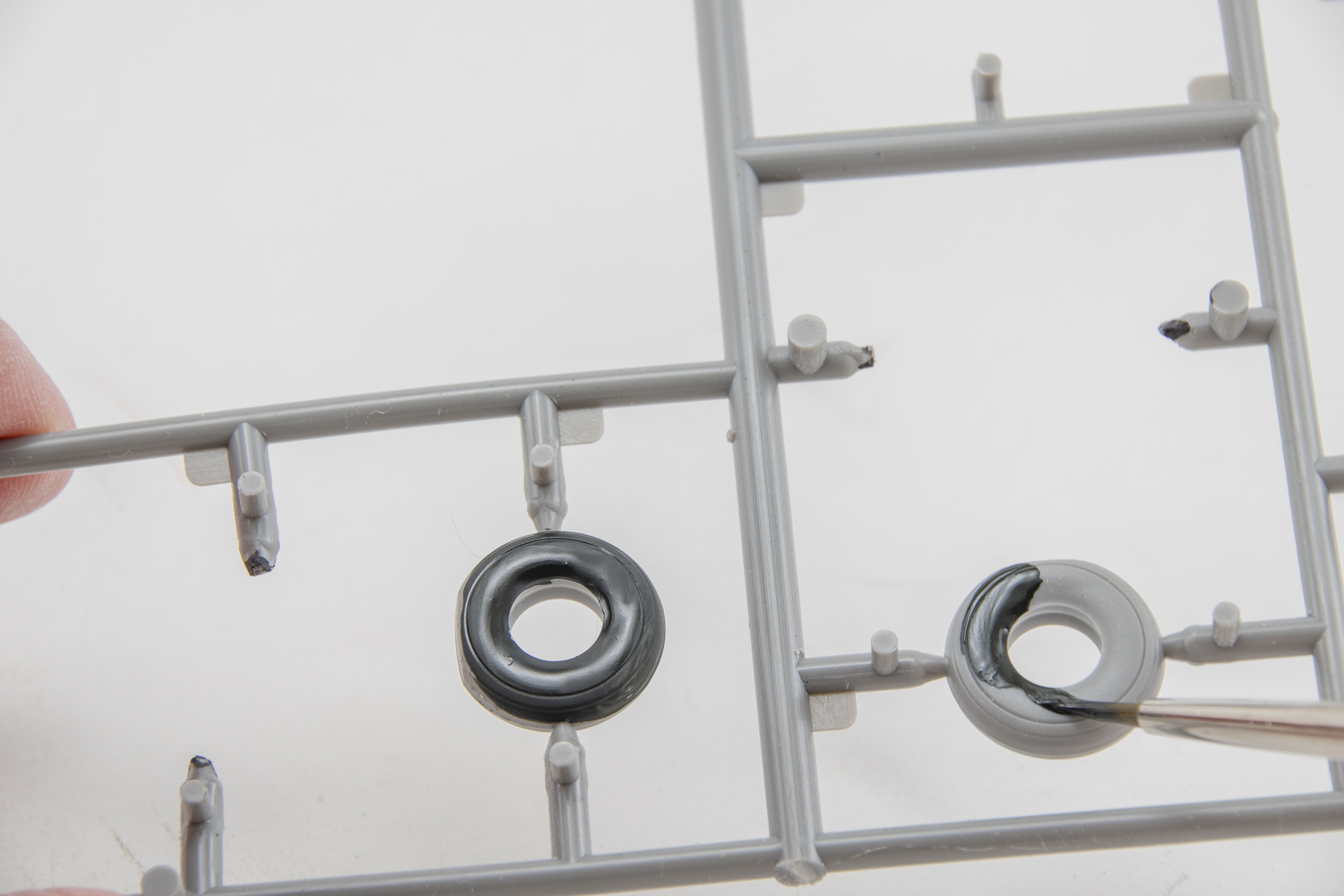

After wetting the bristles of a No. 2 paintbrush with Tamiya acrylic thinner to prevent paint drying in the brush, I dipped it in the paint and began painting the model plane interior parts. Apply the paint in a few long strokes.
FSDAB1122_09
The slightly thin paint may not completely cover the first time. But wait until the first coat is dry before applying a second.
FSDAB1122_10

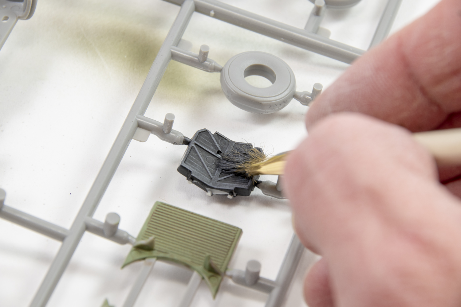

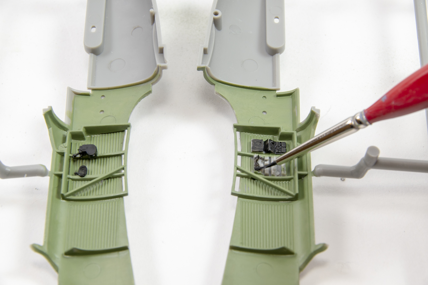

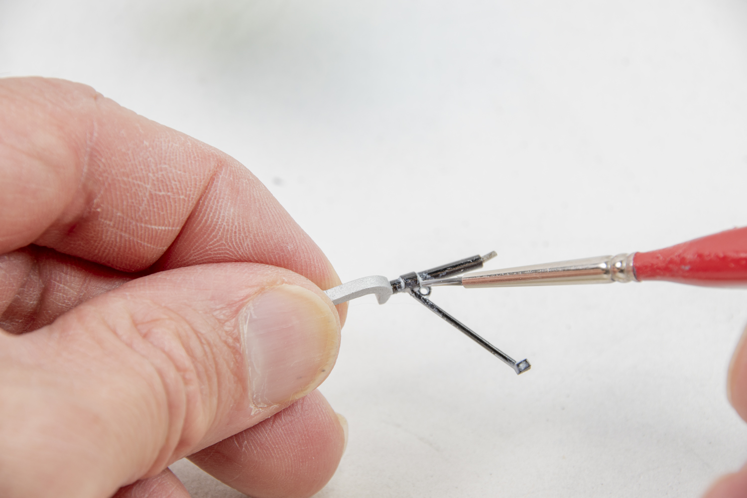

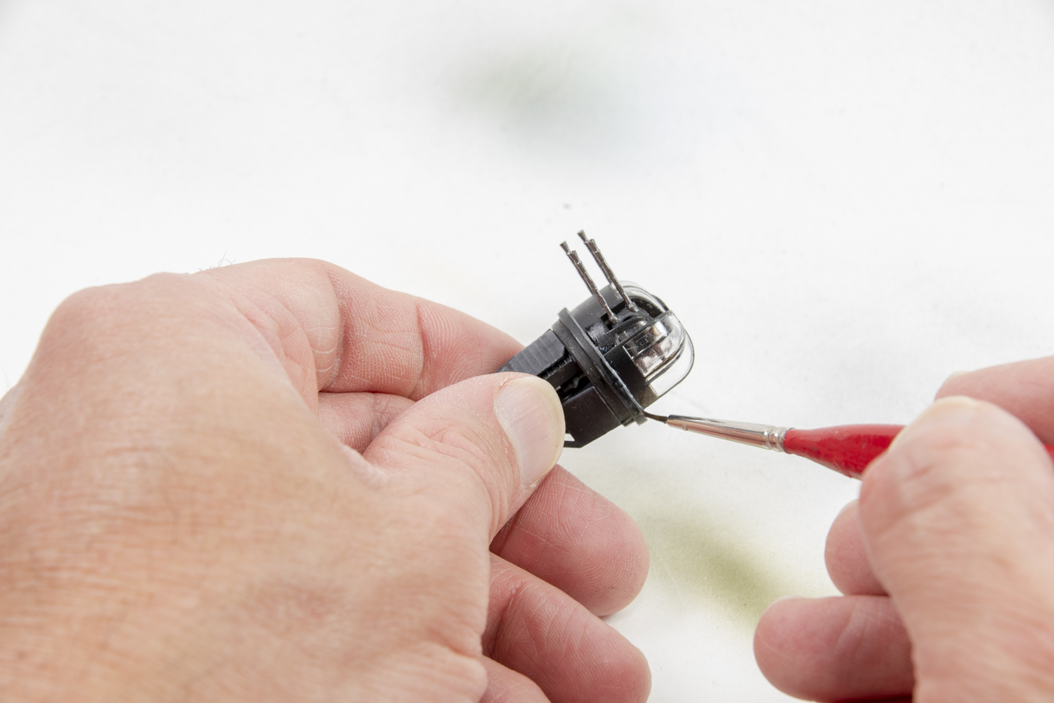

Black is used for many of the parts in this model aircraft kit, including the turret interior and instrument panel, which I painted with the No. 2 brush …
FSDAB1122_11
… and small details such as the controls and boxes along the walls. Use a No. 0 brush for more control when painting small surfaces.
FSDAB1122_12

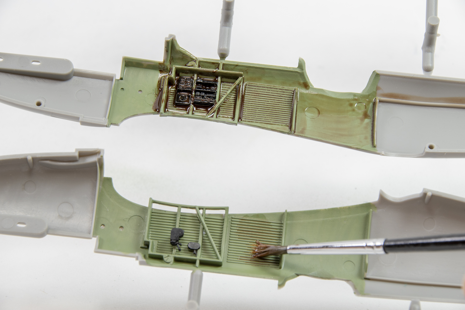

To punch up the model airplane’s cockpit detail, mix a wash of burnt umber artist oil — you only need a little paint and odorless turpentine. The important thing is to thoroughly mix the paint and thinner with the goal of something akin to colored thinner.
FSDAB1122_13
Using a No. 2 brush, flow the wash into the cockpit detail; the thin color naturally wants to settle into aircraft model’s recesses. As it dries, the brown wash outlines raised details and deepens shadows.

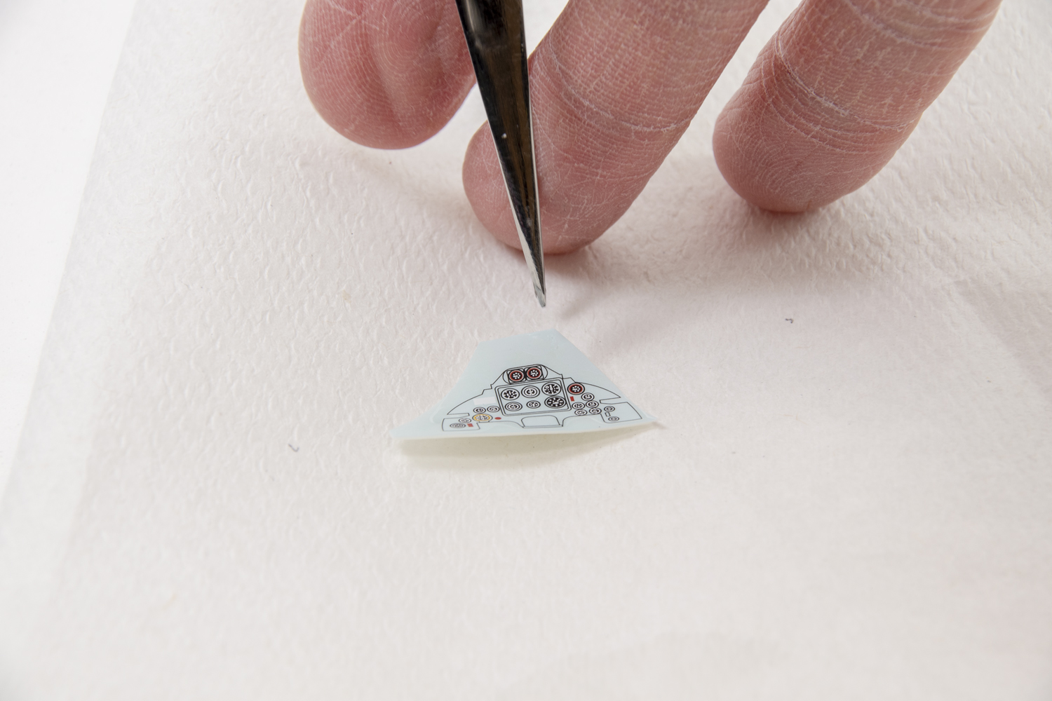

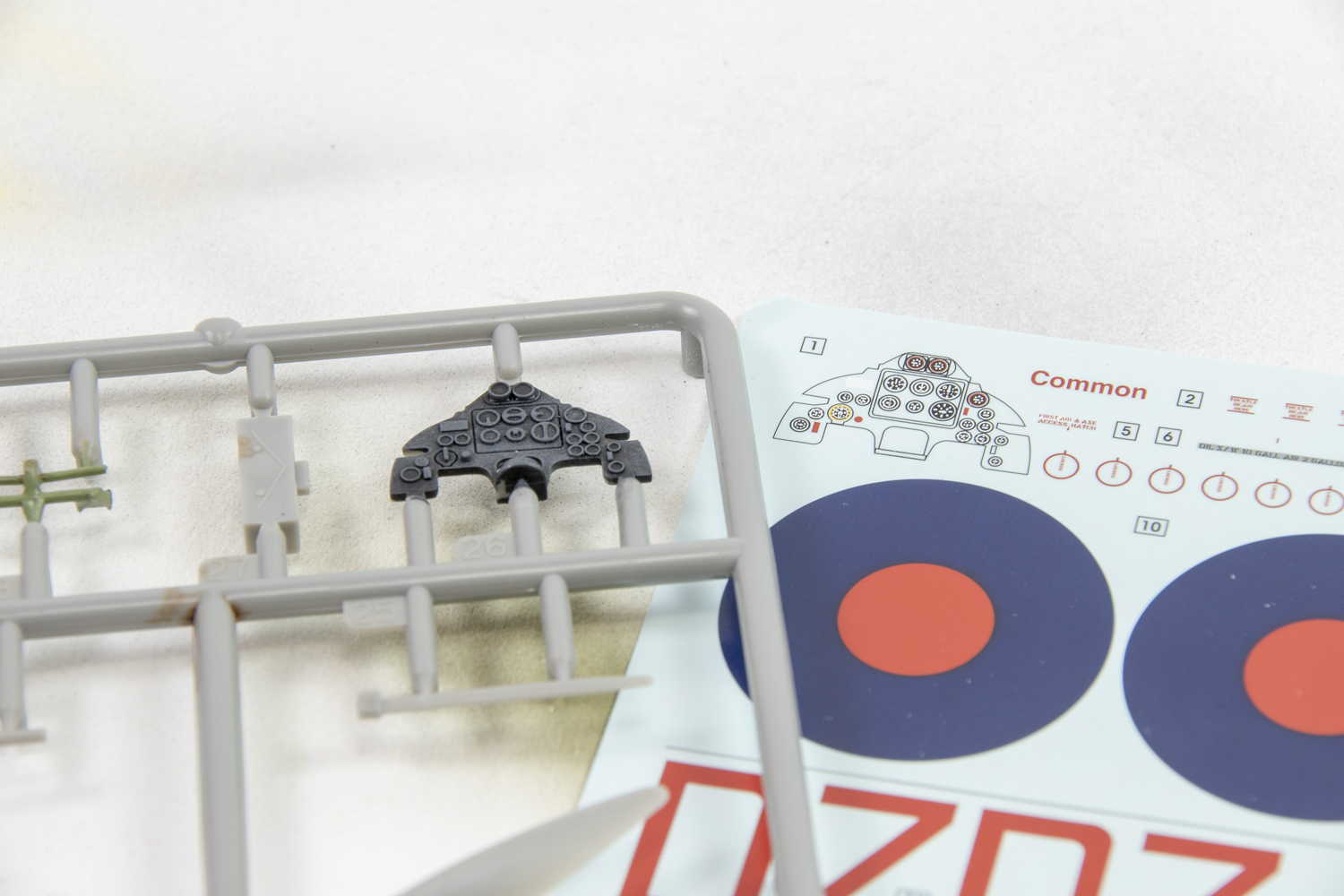

Airfix provides a decal to detail the dials on the painted instrument panel. If your model aircraft kit does the same, carefully cut around the decal with fine, sharp scissors.
FSDAB1122_17

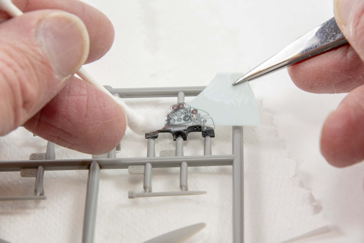

After dipping the model plane panel decal in warm water for a few seconds, place it on a paper towel to let the water activate the adhesive. Don’t leave the decal in the water too long or the marking may float off or the adhesive may become too diluted to be effective.
FSDAB1122_18

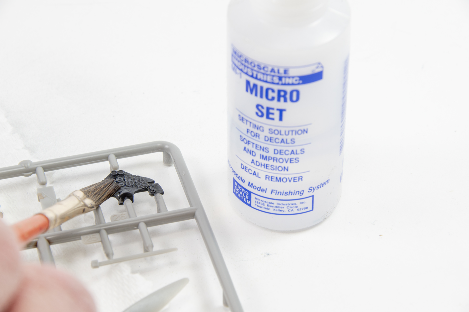

While the decal soaks, brush the model airplane kit’s instrument panel with Micro Scale Micro Set setting solution. It helps the decal will settle over and around molded detail.
FSDAB1122_19
When the decal moves freely on the backing paper, place it in position on the model plane part, hold it in place with a cotton swab, and gently slide the paper out from under the film. Do not use your finger to slide or hold the decal as it will likely stick to your skin better than the model.
FSDAB1122_20

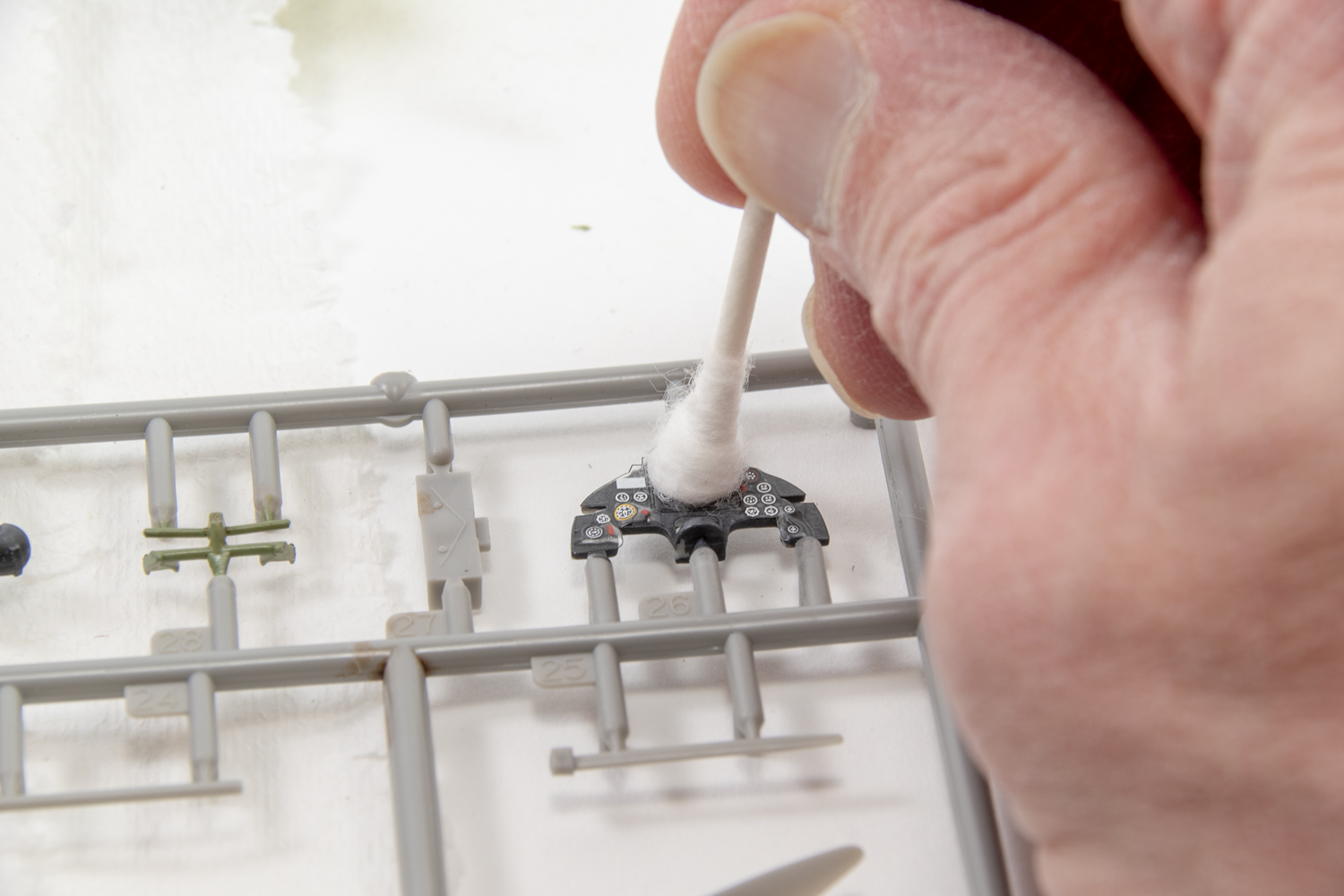

Once you are sure the model plane decal’s location is spot-on, use a wet brush or cotton swab to gently press the film into the detail.

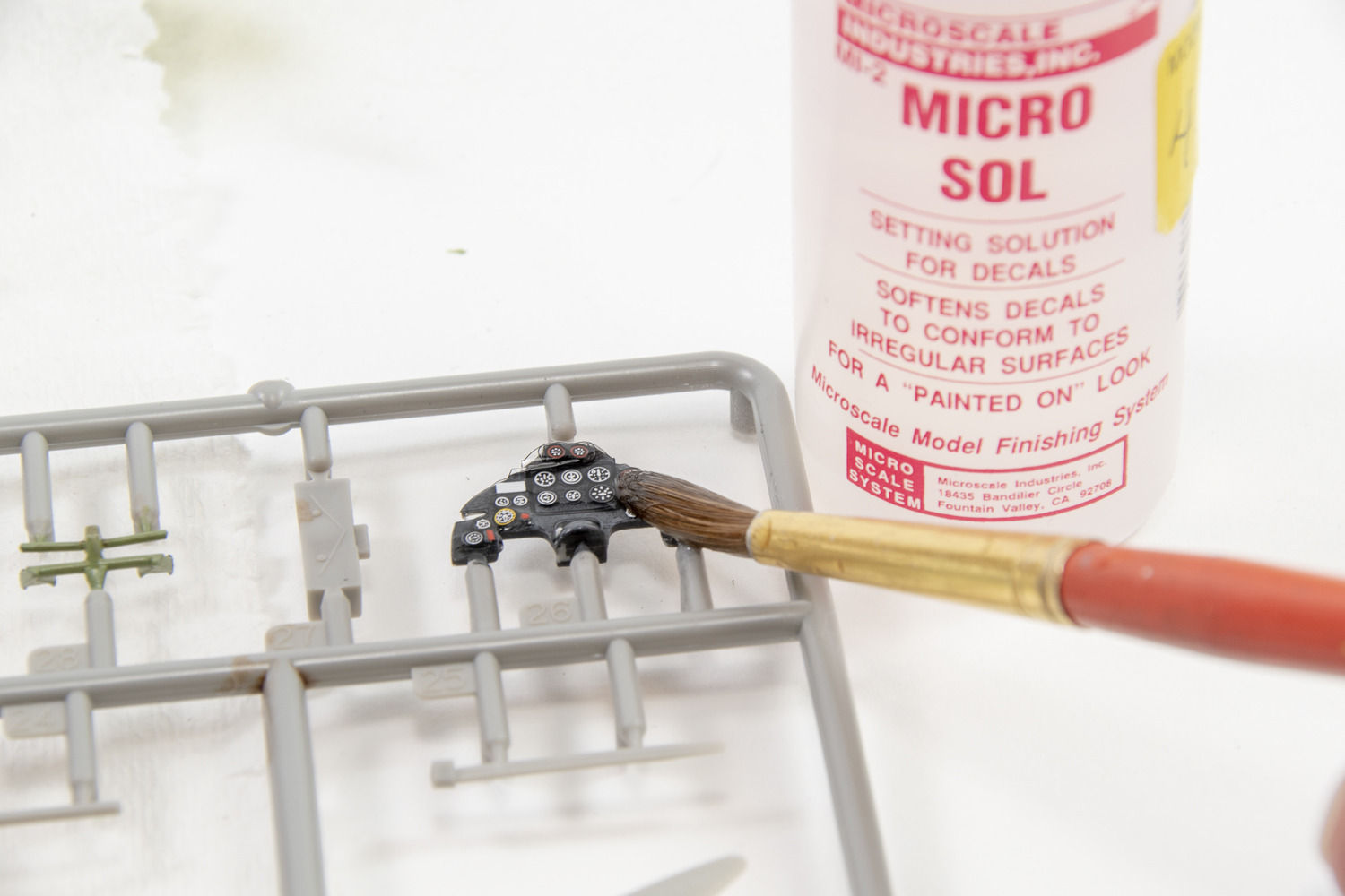

Finally, apply Microscale Micro Sol. This mild solvent softens the decal film and helps it conform to detail on the aircraft model’s surface. The decal may wrinkle as the solvent works, but don’t touch it. It should flatten as dries.

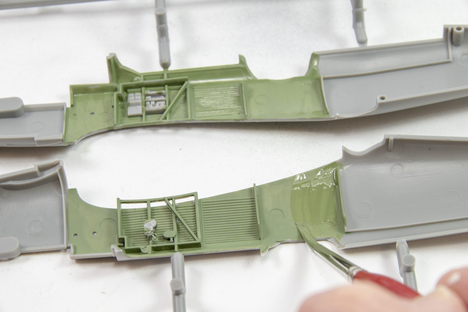

Paint interferes with plastic cement, so remove it from your plastic model joining surfaces. For example, drag the edge of a No. 11 blade held perpendicular to the surface across the gluing surfaces on the cockpit wall and the corresponding areas on the floor.

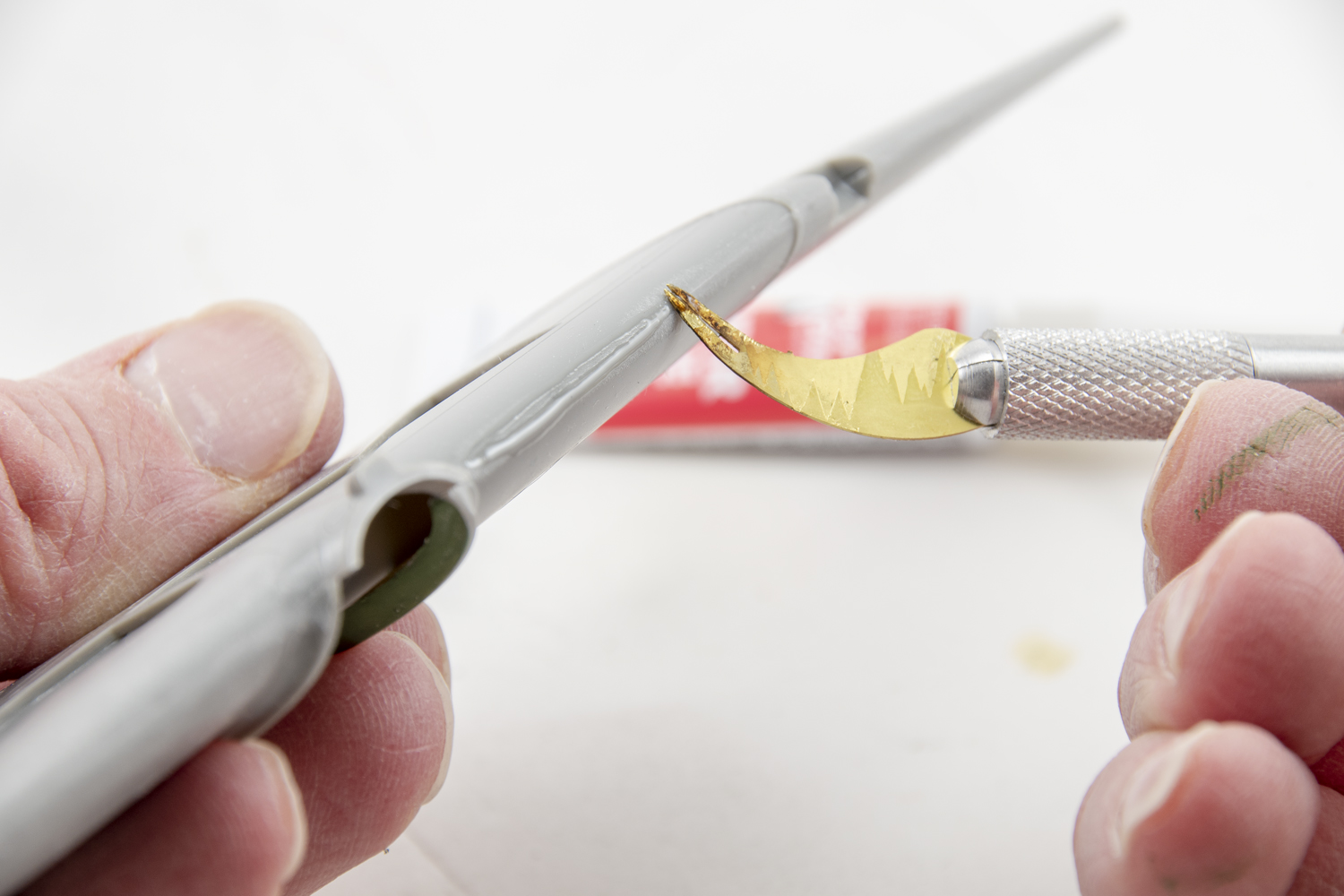

After the glue has dried, check the model airplane’s seams. You may find areas where the fuselage halves were mismatched, causing a step. Smooth them with progressively finer sanding sticks.
FSDAB1122_26

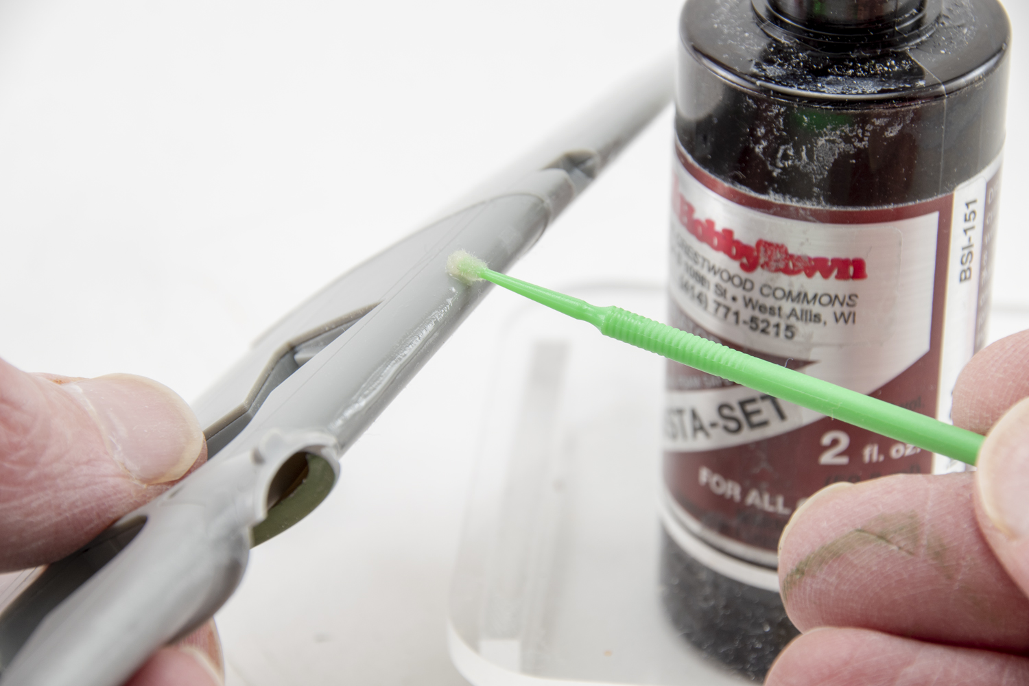

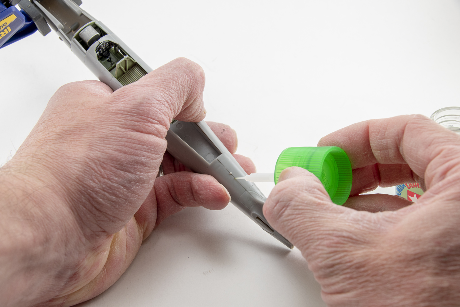

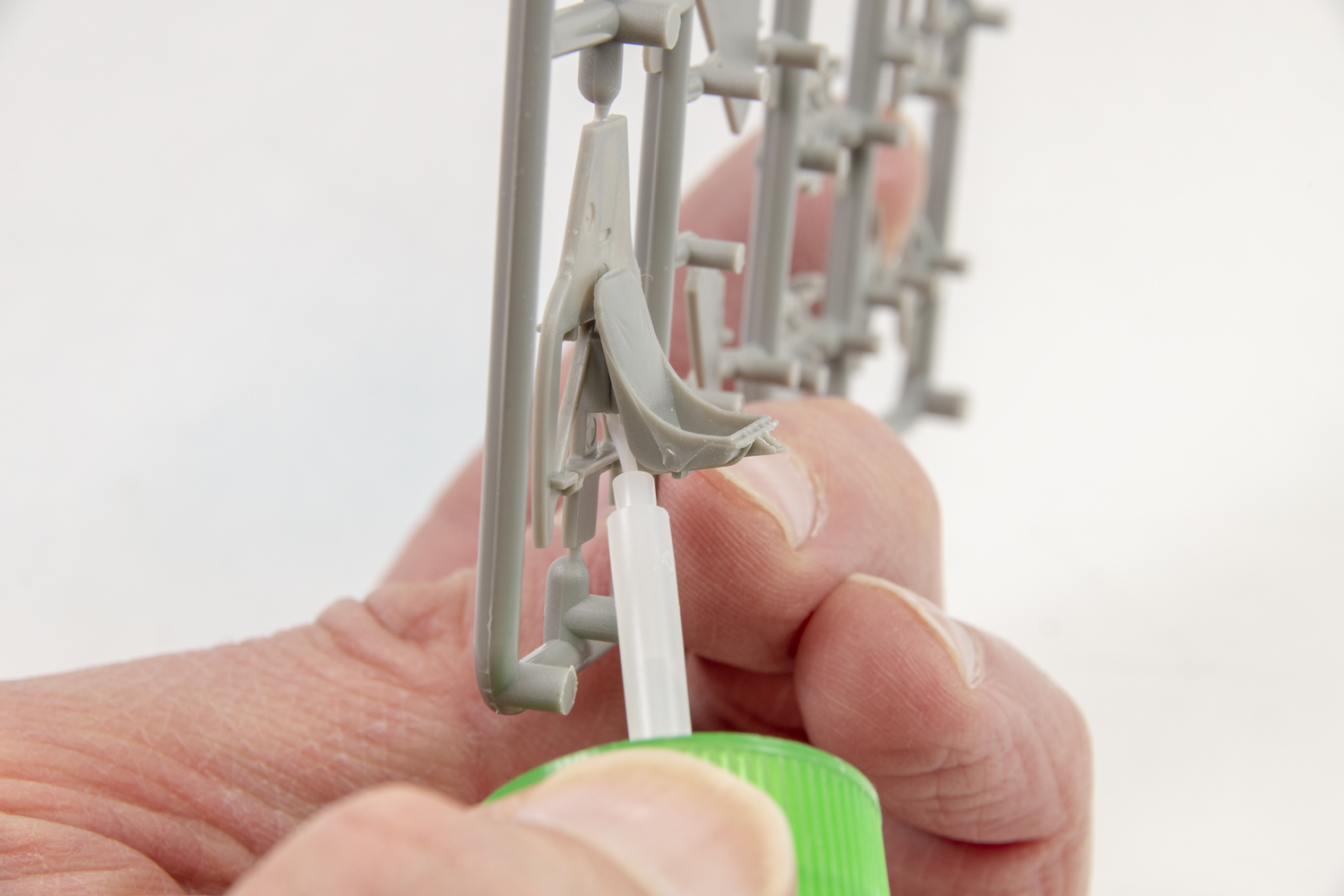

To ensure a solid joint for the wings of your aircraft models, apply liquid cement from a container equipped with a metal tube. This thicker glue will flow through the joints as pressure is administered.

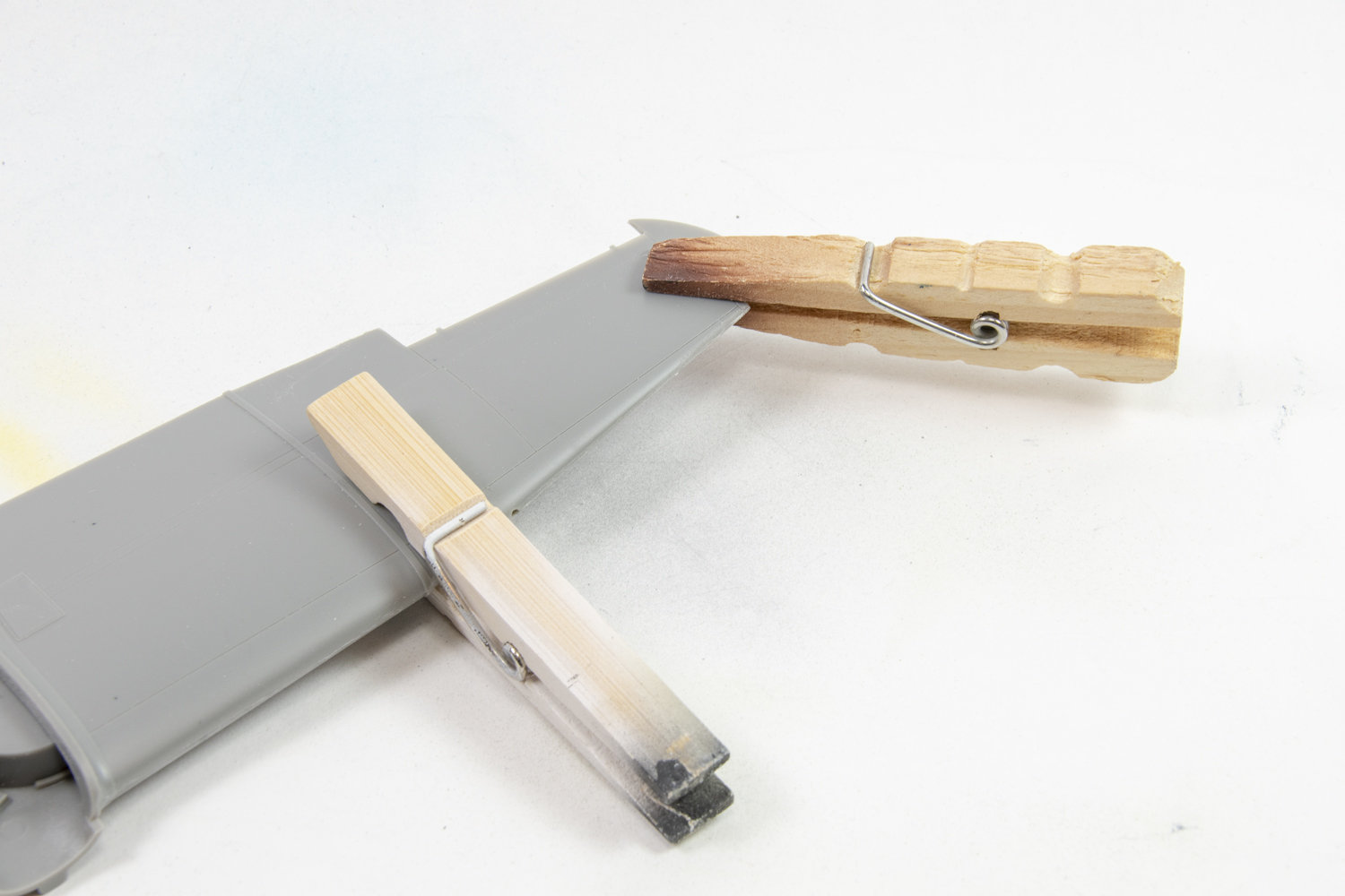

Wooden clothes pins make useful clamps to apply gentle pressure to plastic model plane wings as the glue sets. You can flip the parts of the clothes pins over to get a different shape.

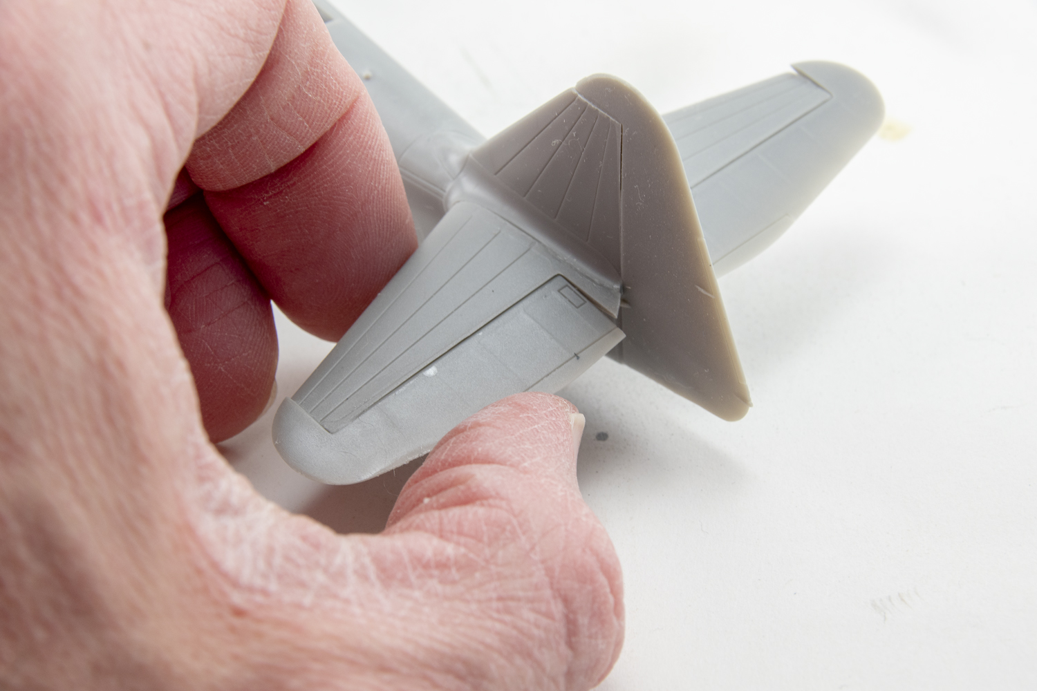

The seam may still be visible in places on your model airplane’s fuselage. The seam may still be visible in places on your model airplane’s fuselage. Fill these gaps with superglue. First, apply a little to the problem seams.
FSDAB1122_30
Then flow a little superglue accelerator (sometimes called kicker) over the seam, taking care not to touch the brush directly to the glue. The superglue will set instantly.
FSDAB1122_31
Sand the glue flush with the surrounding surface within a few minutes and your model airplane should have a smooth surface with no hint of the joint. Repeat the process if the seam remains.

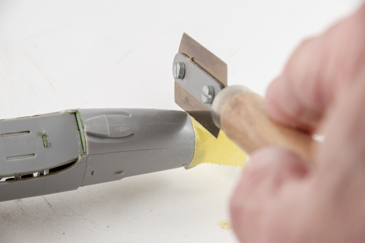

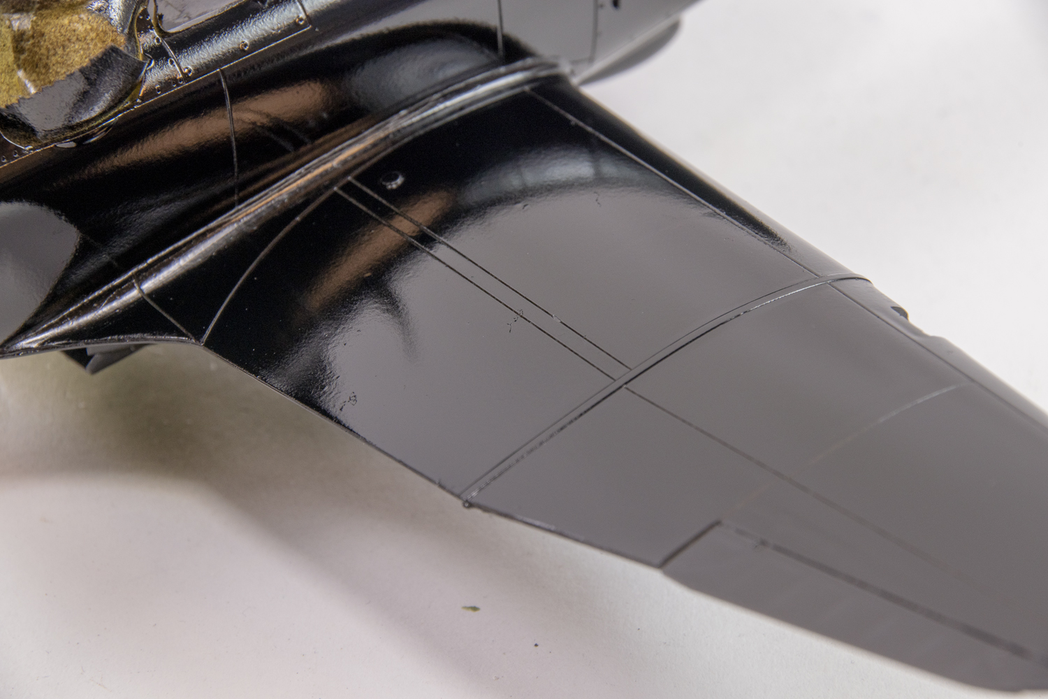

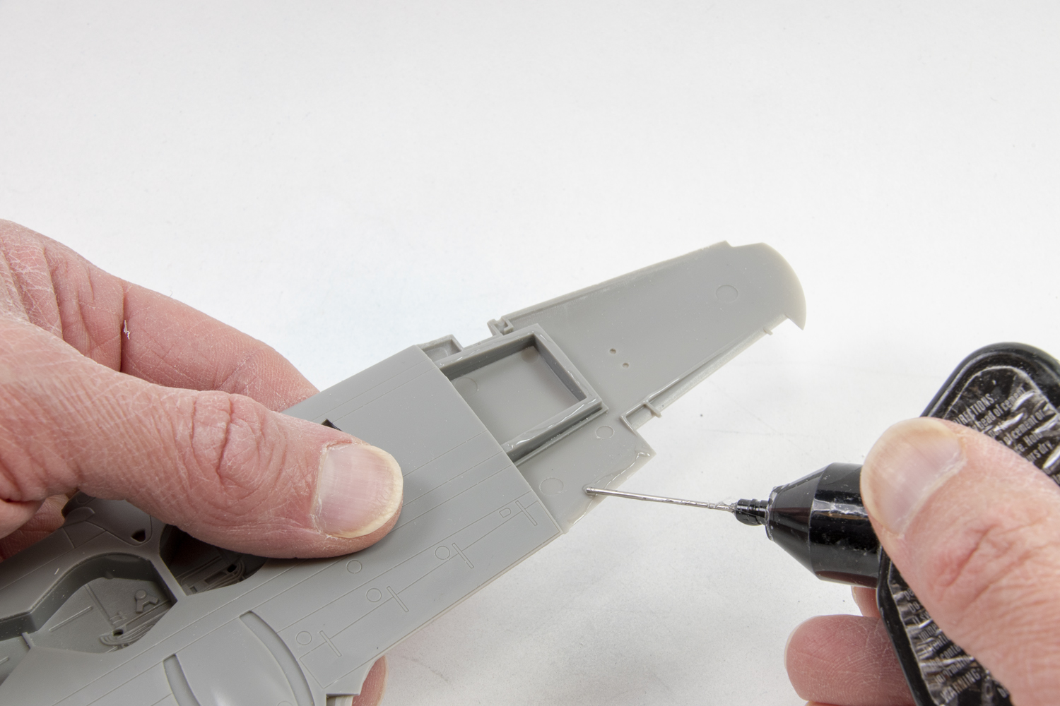

Restore partially eliminated panels lines on your model airplanes by placing tape along the line to serve as a guide and then drag a fine razor saw gently along the tape’s edge. A few passes will remove just enough plastic to produce a consistent line across the seam.

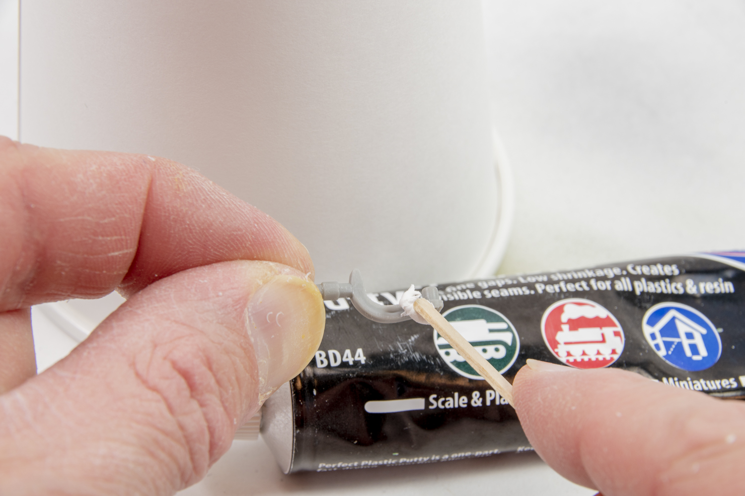

In this model aircraft kit, sink marks mar the landing gear legs. Fill them with Deluxe Materials Perfect Plastic Putty, sanding it flush after the putty hardens.

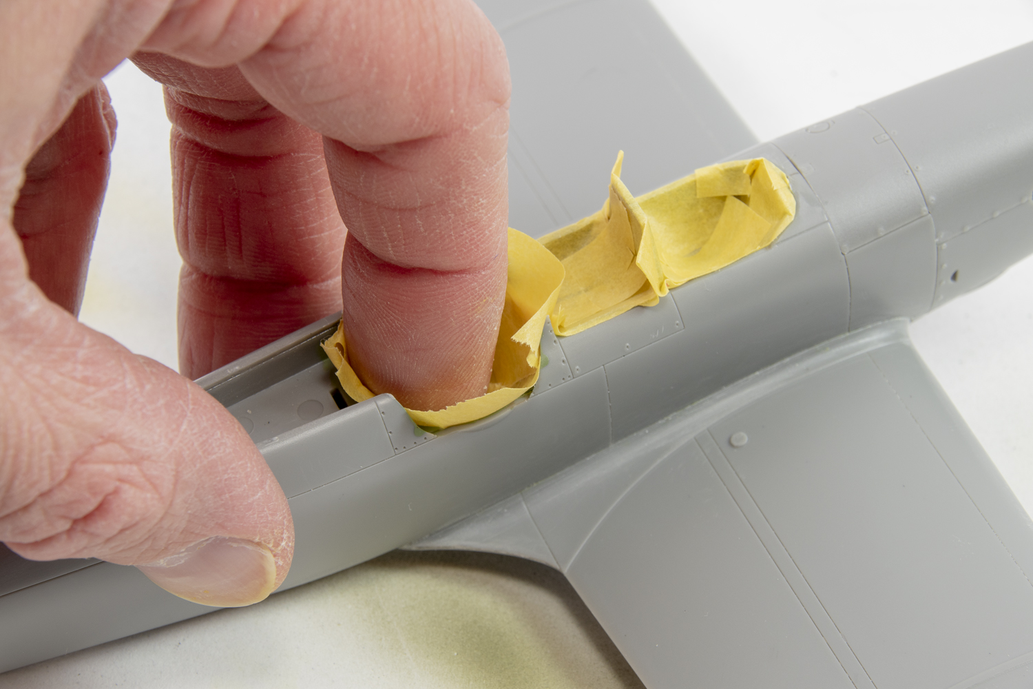

In preparation for painting, mask you model plane cockpit openings with pieces of masking tape carefully placed along the edges of the openings and pressed into the holes.
FSDAB1122_36

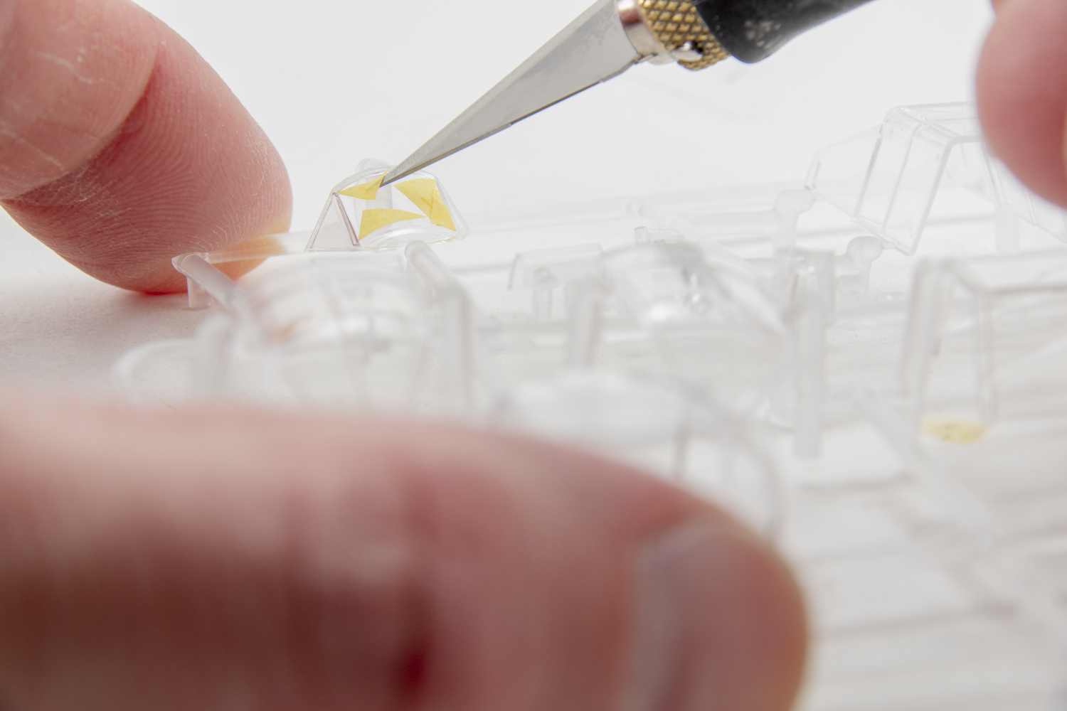

Take small triangles of Tamiya tape and place them into the corners of model aircraft clear parts panes with a hobby knife. Gradually fill the pane with small sections of tape until it is entirely masked.
FSDAB1122_037
Mask the model airplane clear part’s interior with large sections of tape burnished into place to protect from overspray. Tamiya masking tape is thinner than masking tape you might find at the hardware store and conforms better around details.

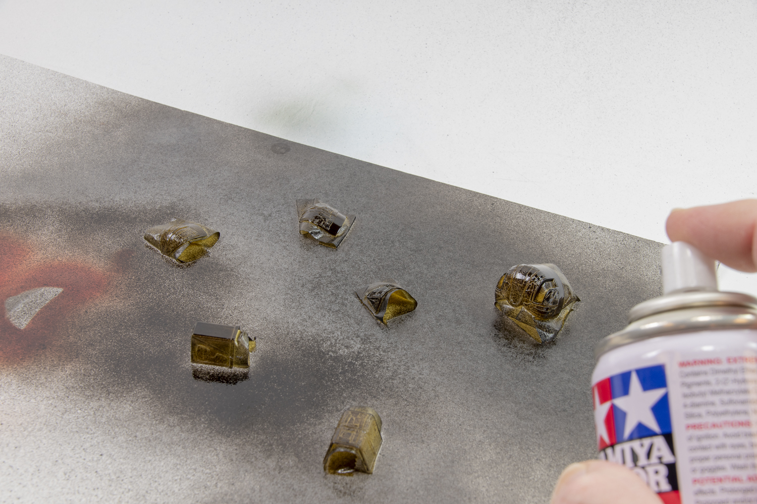

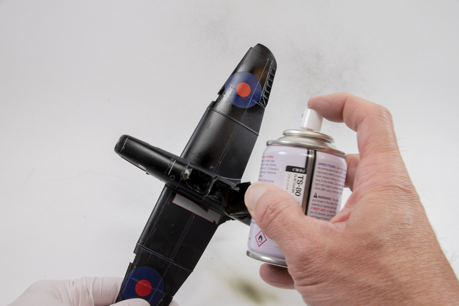

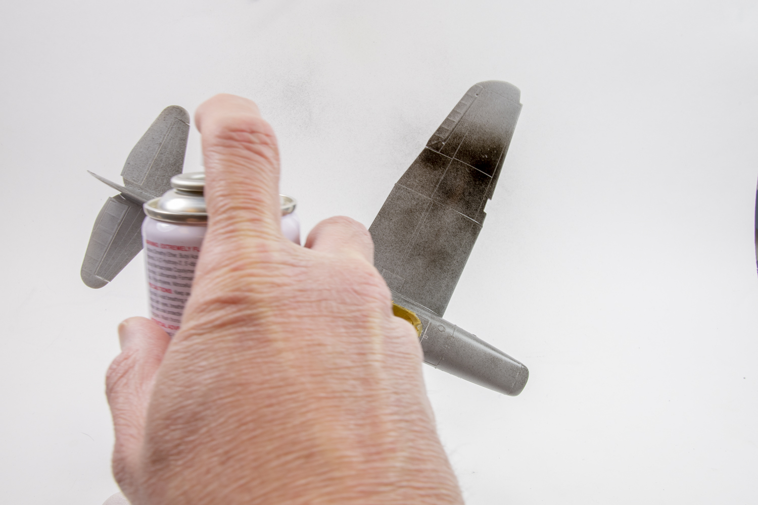

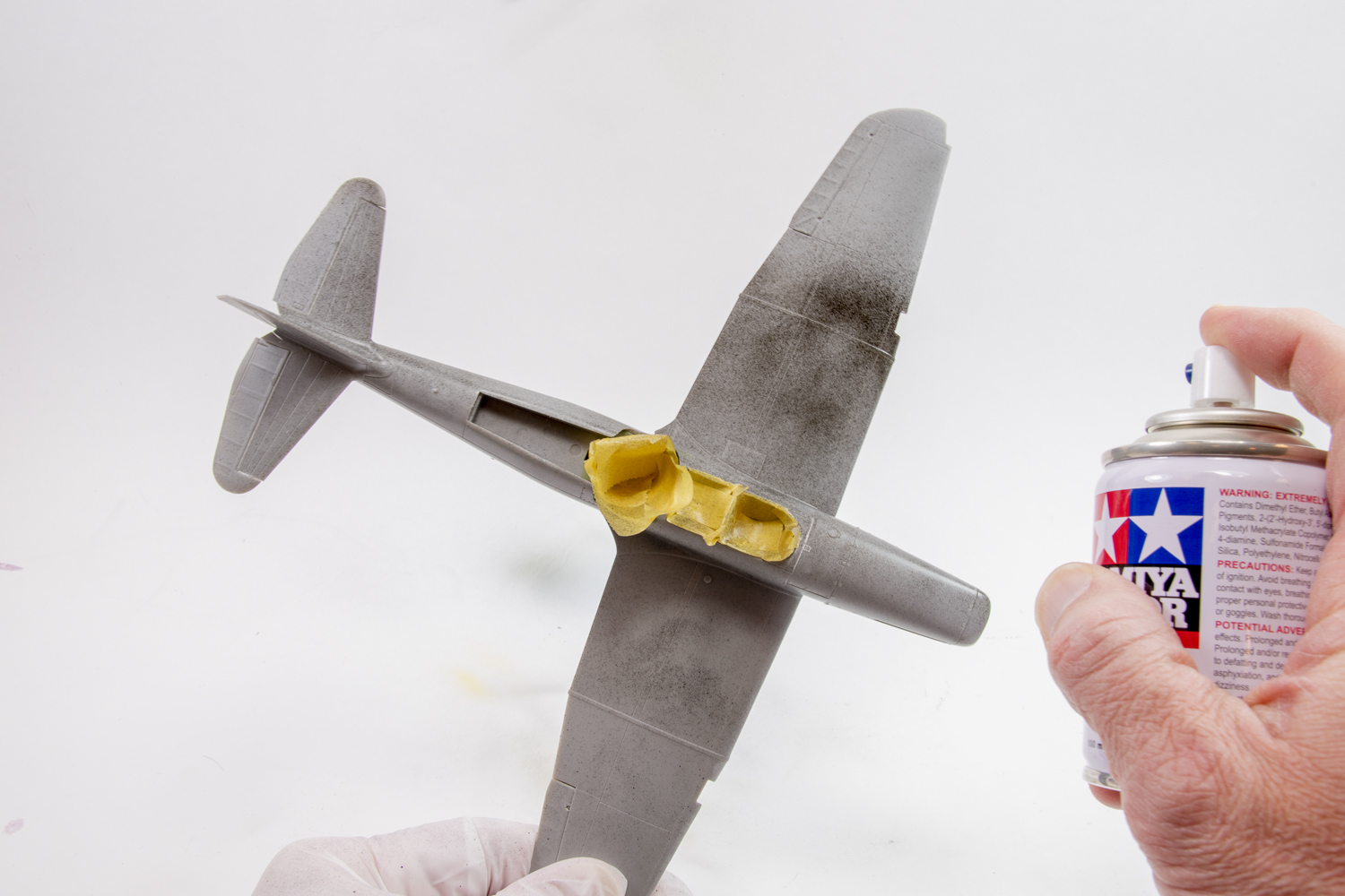

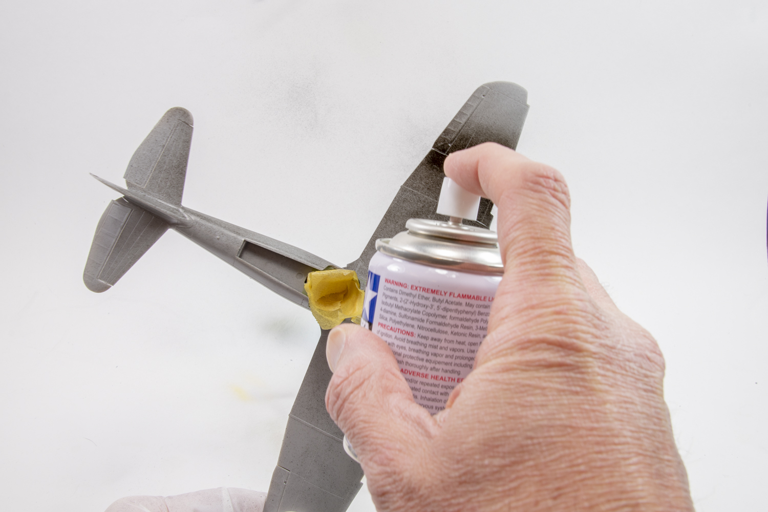

Before using a spray can, vigorously shake it for a minute or two. Then you can spray the model plane, starting the flow of paint off the model …
FSDAB1122_39
… and go over the plastic model in smooth, even passes ending each one off the model. Starting or stopping the flow of paint on the model can produce splatters.
FSDAB1122_40
Try to spray the model in three passes waiting a few minutes between each. The first won’t entirely cover the model but provides bite for subsequent layers to hang on to. The second one should cover, and the third will even everything out and produce a smooth surface.

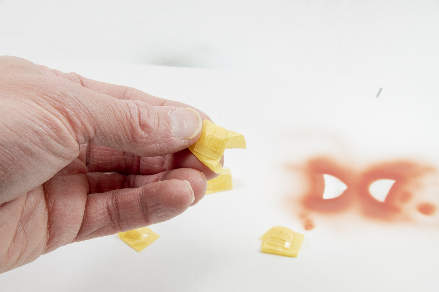

Attach the model airplane kit’s masked clear parts to cardboard to serve as a handle during painting. Go slowly to avoid flooding the parts and having paint bleed under the tape.
FSDAB1122_42

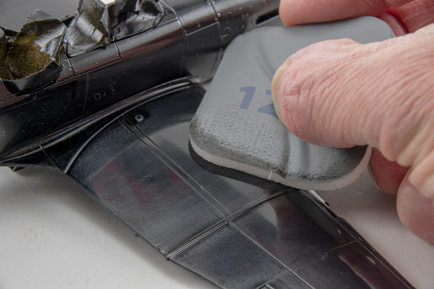

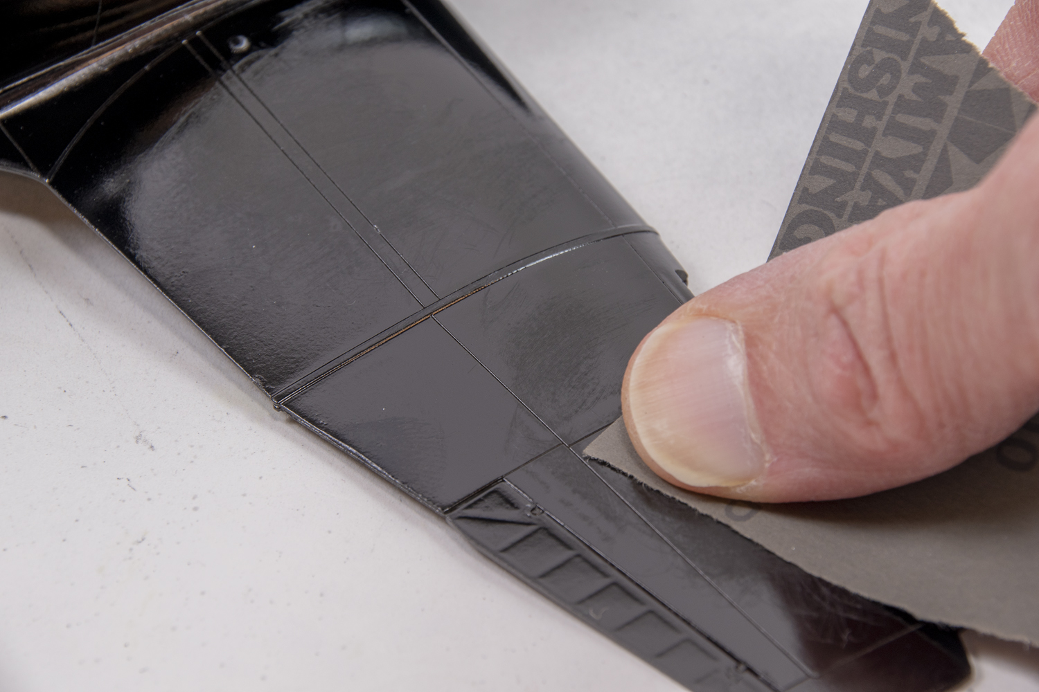

These blemishes are usually easy to remove with the gentle application of 1000-grit sandpaper. If you sand through the paint and reveal bare plastic, simply respray the affected areas.
FSDAB1122_44
Otherwise, use progressively finer sanding pads to smooth the paint on your aircraft models — they often come in sets that include these grits: 3200, 3600, 4000, 6000, 8000, and 12000. Start with the coarsest and by the time you reach the last, the surface should be glass smooth.

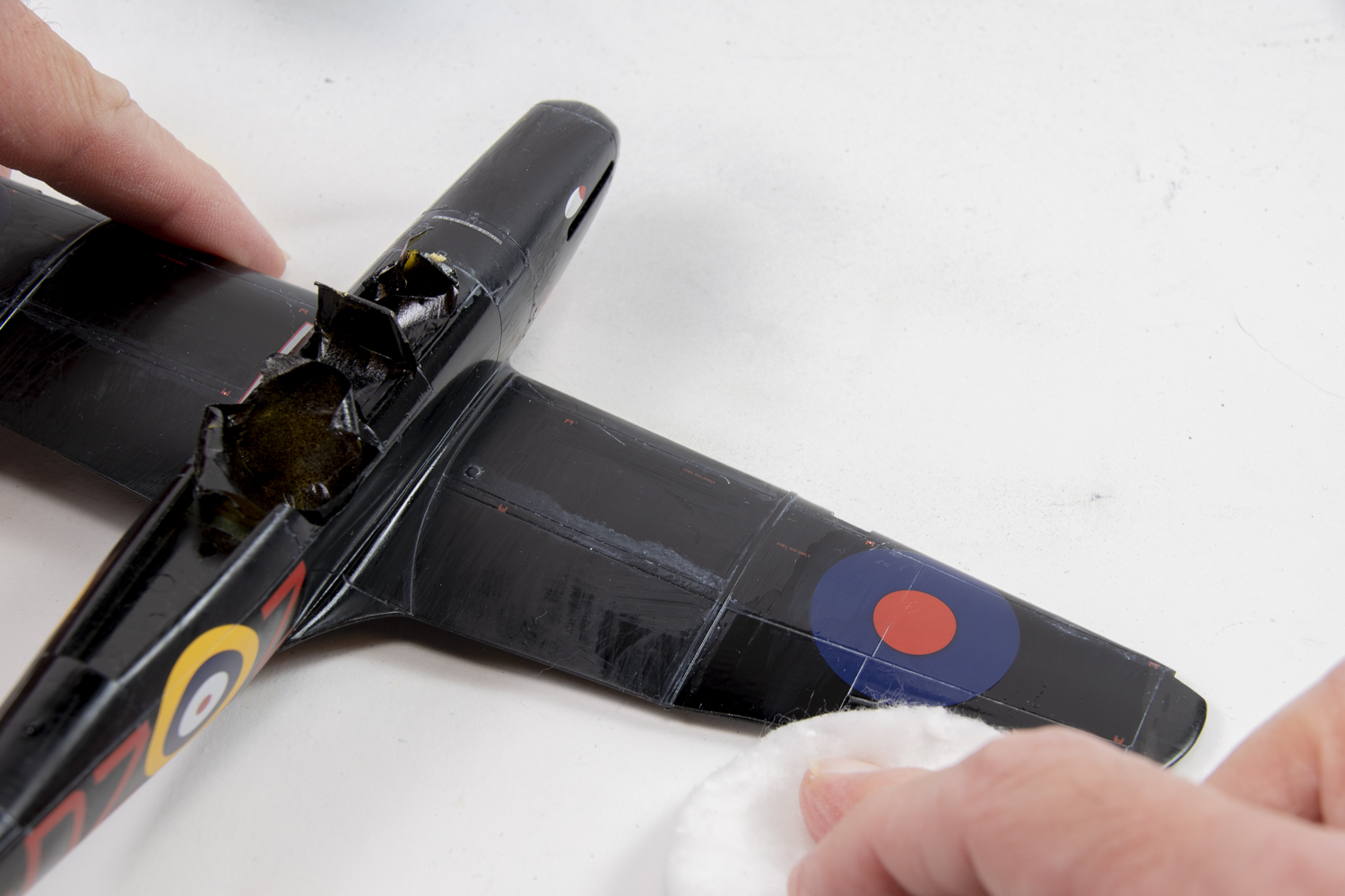

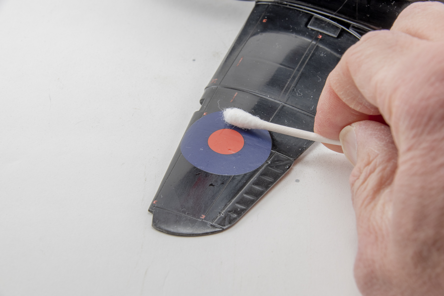

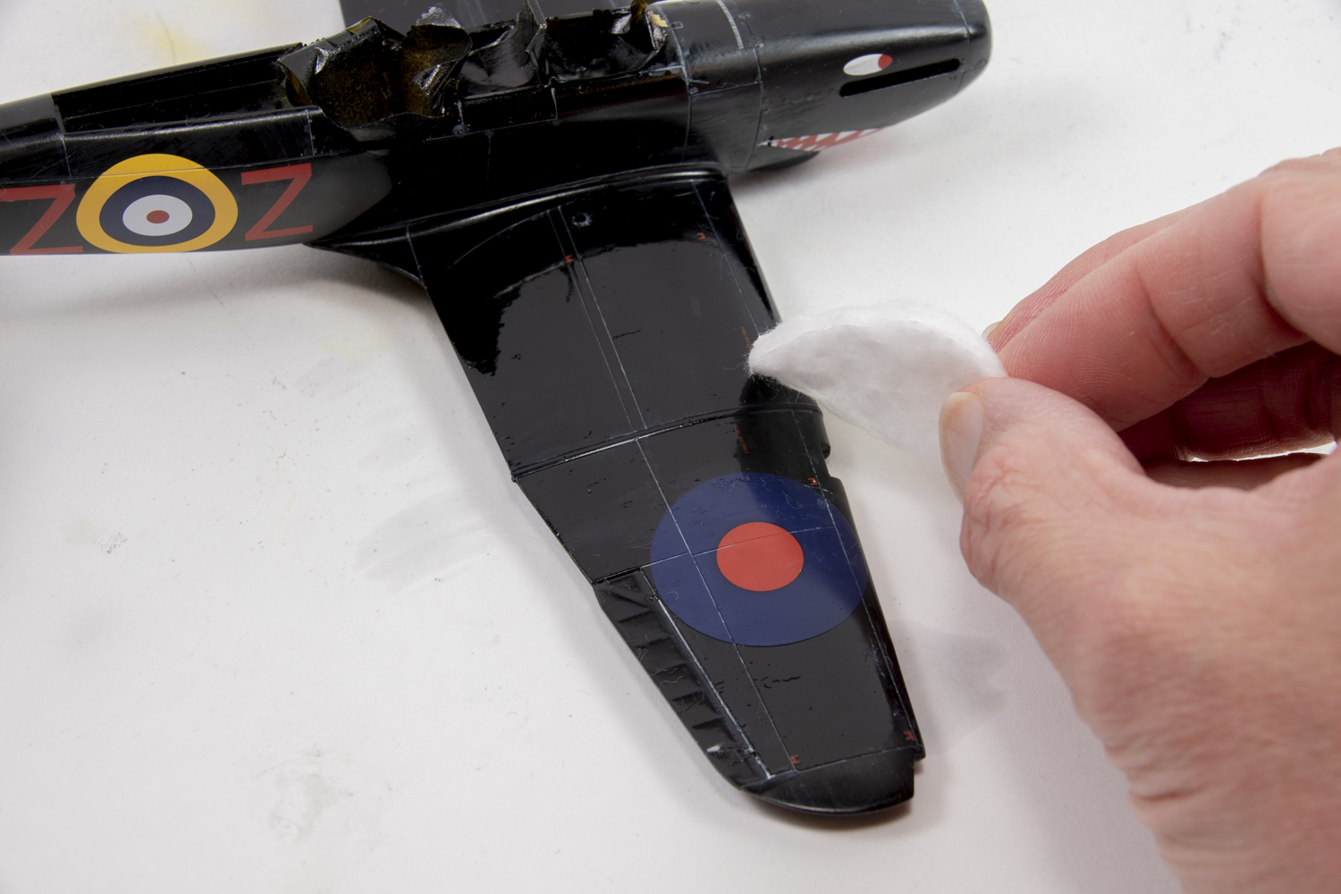

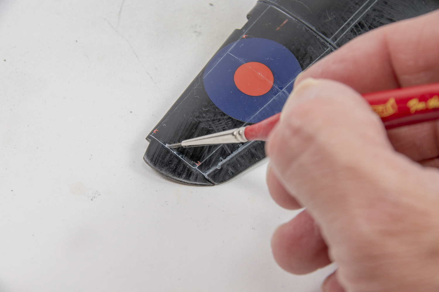

Don’t panic if you color outside the lines. Take a cotton pad damp with Turpenoid and draw it gently back across the surface. It should remove excess wash from the surface and leave it in the recessed detail of the model plane.
FSDAB1122_49
Go carefully to be sure the thinner doesn’t lift the paint off the model airplane’s painted surface. Tamiya spray cans are lacquers, so the Turpenoid shouldn’t affect the finish. Avoid using the same paint for a wash you used for the finish; never use an enamel wash on enamel paint, but enamel over acrylics is usually fine.

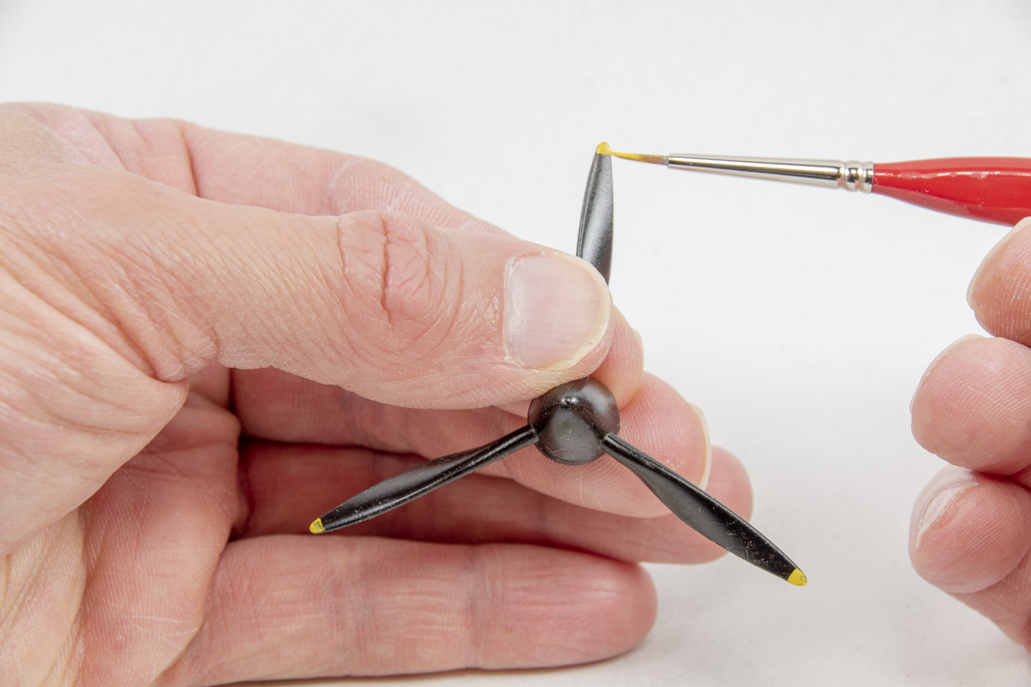

The Defiant’s propeller has yellow tips. After assembling the propeller and spinner and spraying them gloss black with the rest of the airframe parts, hand-paint the tips. Use two coats for color density.

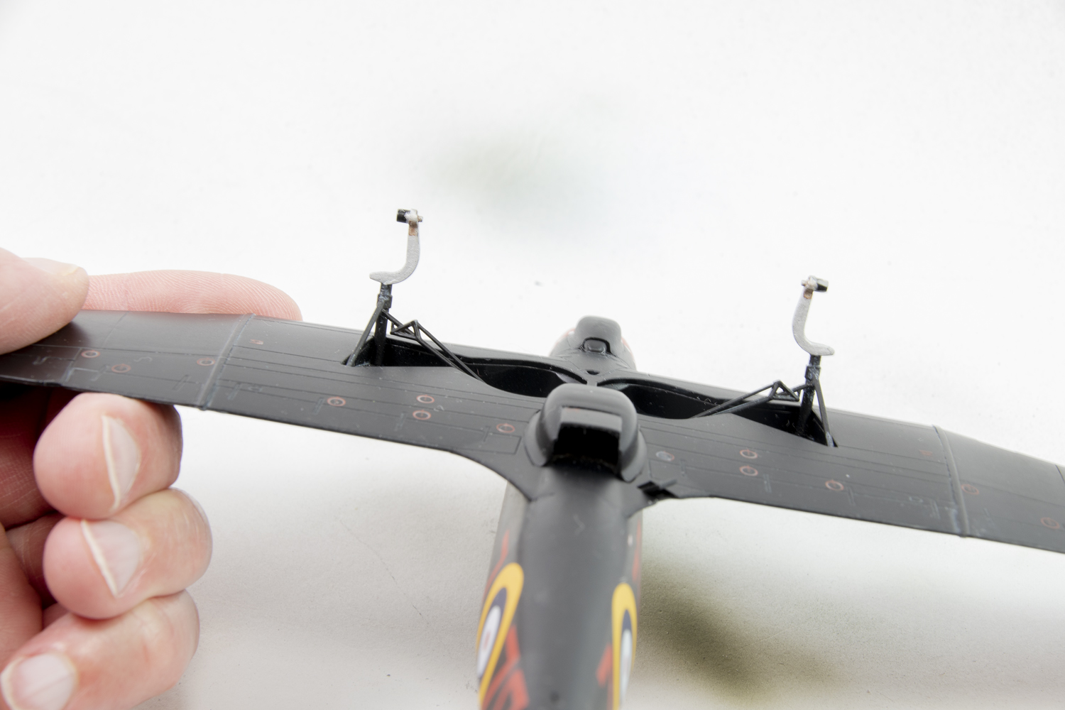

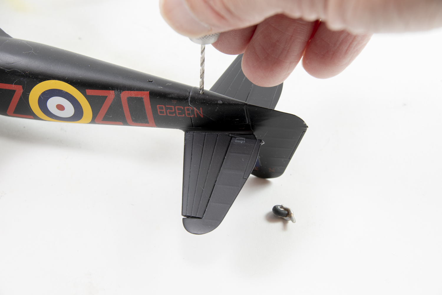

Scrape paint from the mounting pins and holes for the model plane landing gear and glue the legs and struts in place. Check their alignment with reference photos and one another.

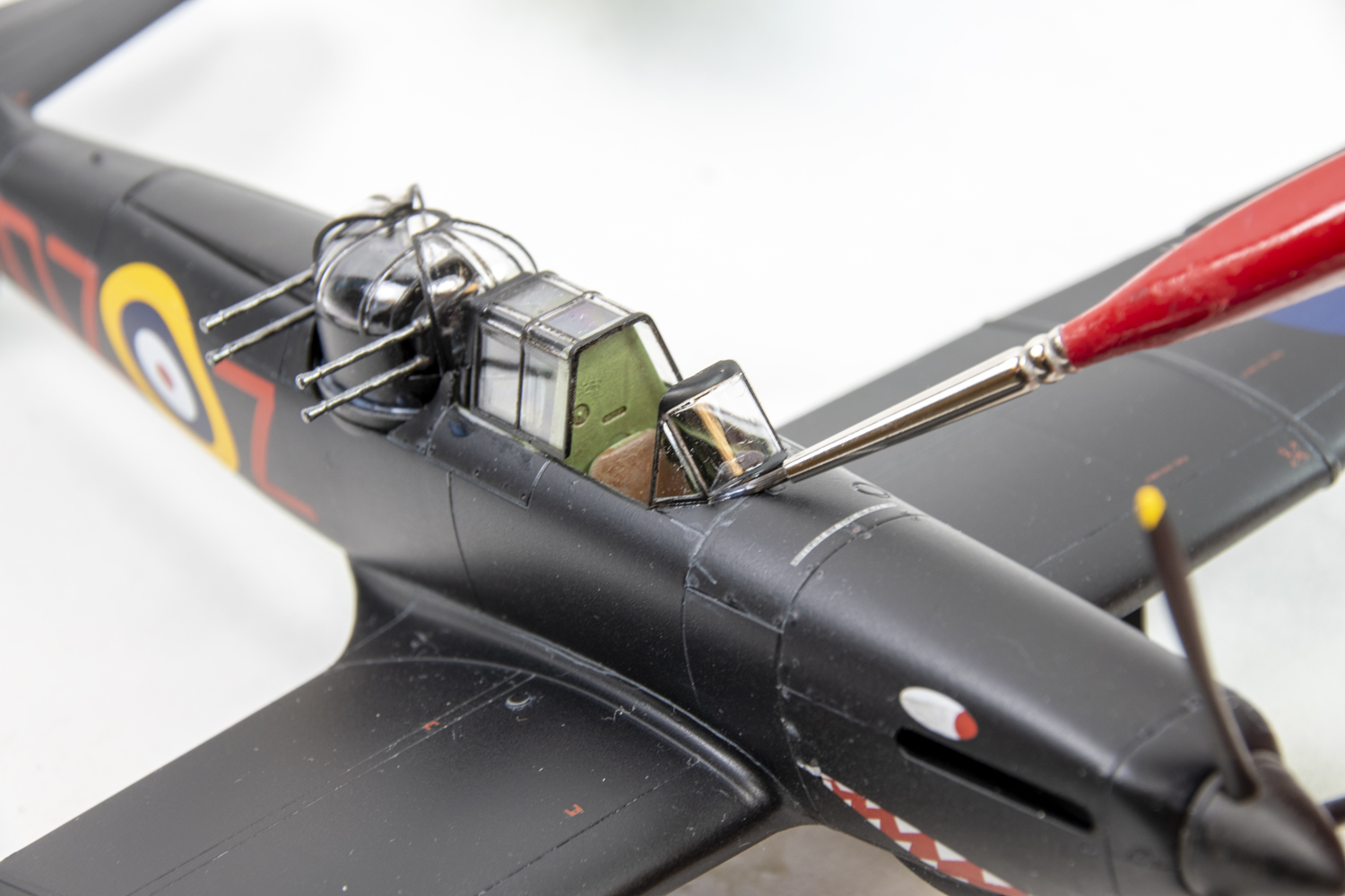

To remove the tape from the clear parts, placed the tip of a No. 11 blade under the edge of the mask and gently lifted it straight up. Grip the lifted edge with tweezers and pull the section away. Never force the knife under the tape or you risk scratching the model plane’s clear plastic.
FSDAB1122_56
Use clear part cement to attach clear parts. Some will likely squeeze out of the joint, but you can remove it with a little water on a paintbrush.

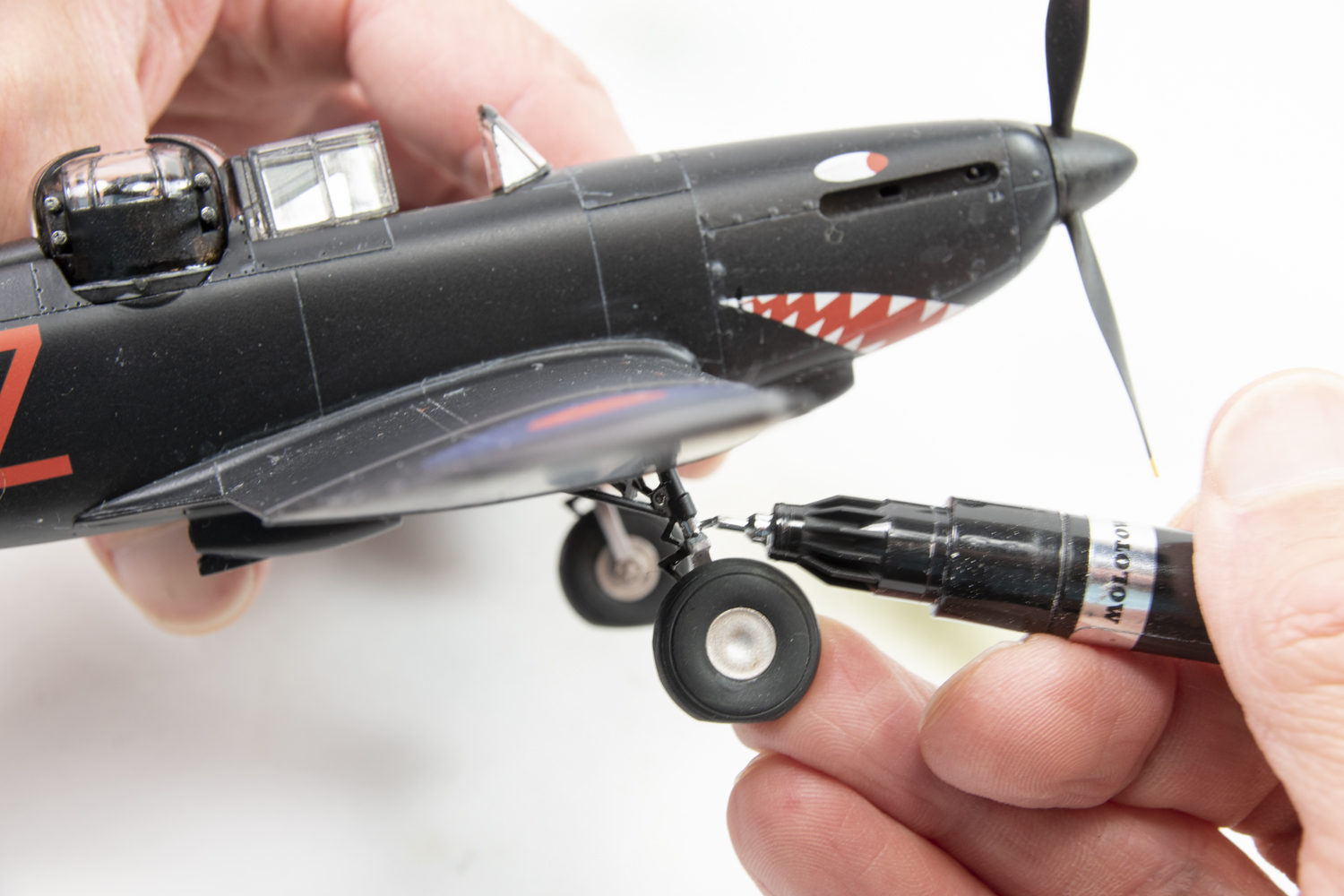

For model plane light lenses and the oleo on the landing gear legs, use a Molotow chrome pen. The shiny fluid flows easily onto the surfaces and dries quickly.

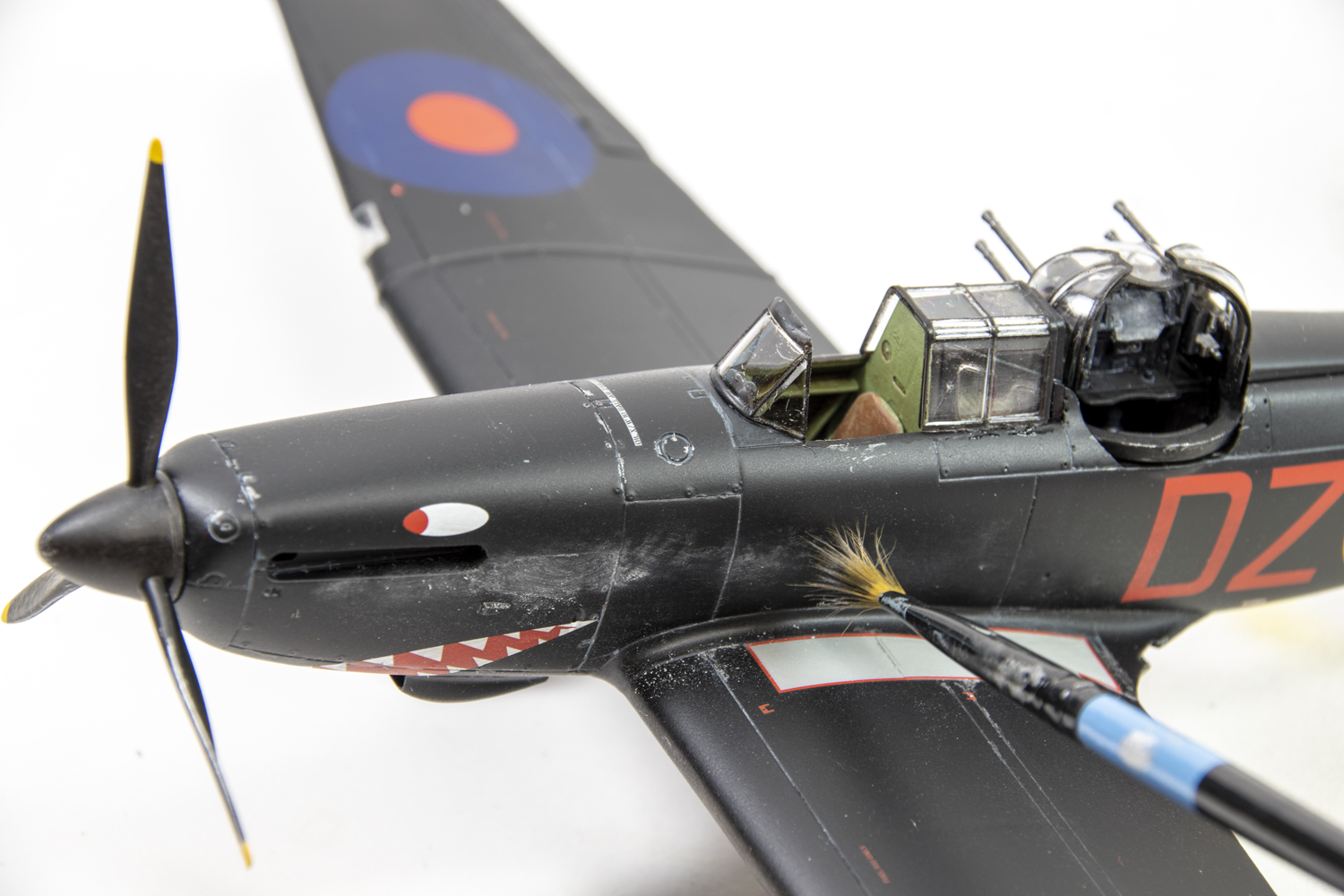

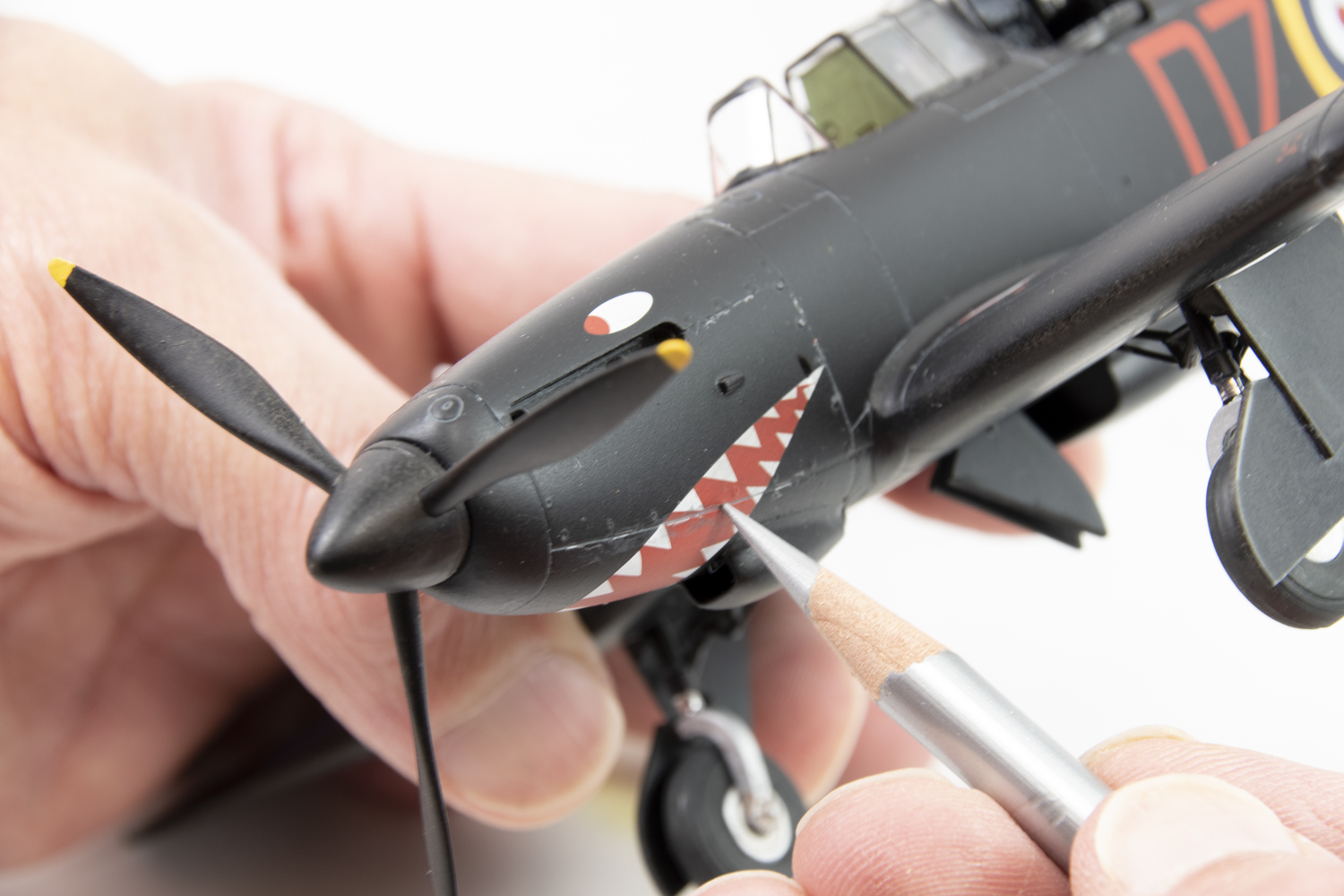

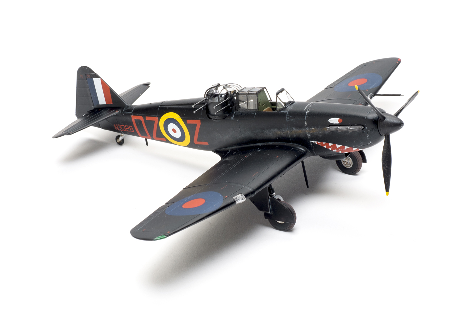

Weathering adds realism to a model. A silver Prismacolor pencil makes convincing chips in the paint around engine access panels, the edge of the propeller blades, and wing leading edges.
FSDAB1122_60
In addition, powdered gray and light brown artist pastels were brushed on for staining from the exhausts. Sweep them back along the fuselage in the direction of airflow. Be careful handling the model plane going forward as the pastels are easily removed with fingers. The exhausts were hand-painted with Tamiya dark iron (XF-84) before installation.
