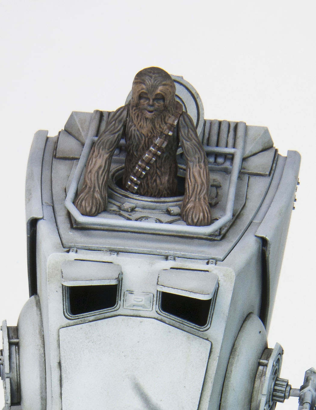

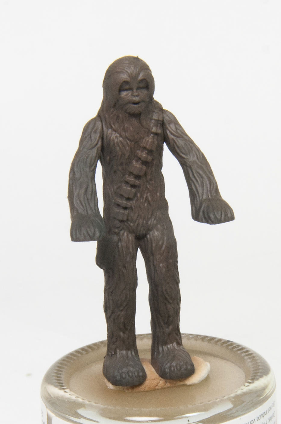

If you’ve built Bandai’s 1/48 scale Star Wars AT-ST (All Terrain Scout Transport), you know the included Chewbacca figure is molded in brown plastic, but you can make it look more realistic by painting its fur shades of brown and touching the bandolier with metallics. I used Vallejo paints unless stated otherwise.

First, prime Chewbacca black, then airbrush a light coat of Tamiya red brown (No. XF-64), allowing some of the black to show through.

Paint the bandolier and bag leather brown (No. 70.871). Pick out the metal pieces with natural steel (No. 70.864). Apply a coat of Pledge Floor Gloss followed by a wash of brown and black artist oils. Once that is dry, seal the Wookie with a coat of satin varnish. Done!
