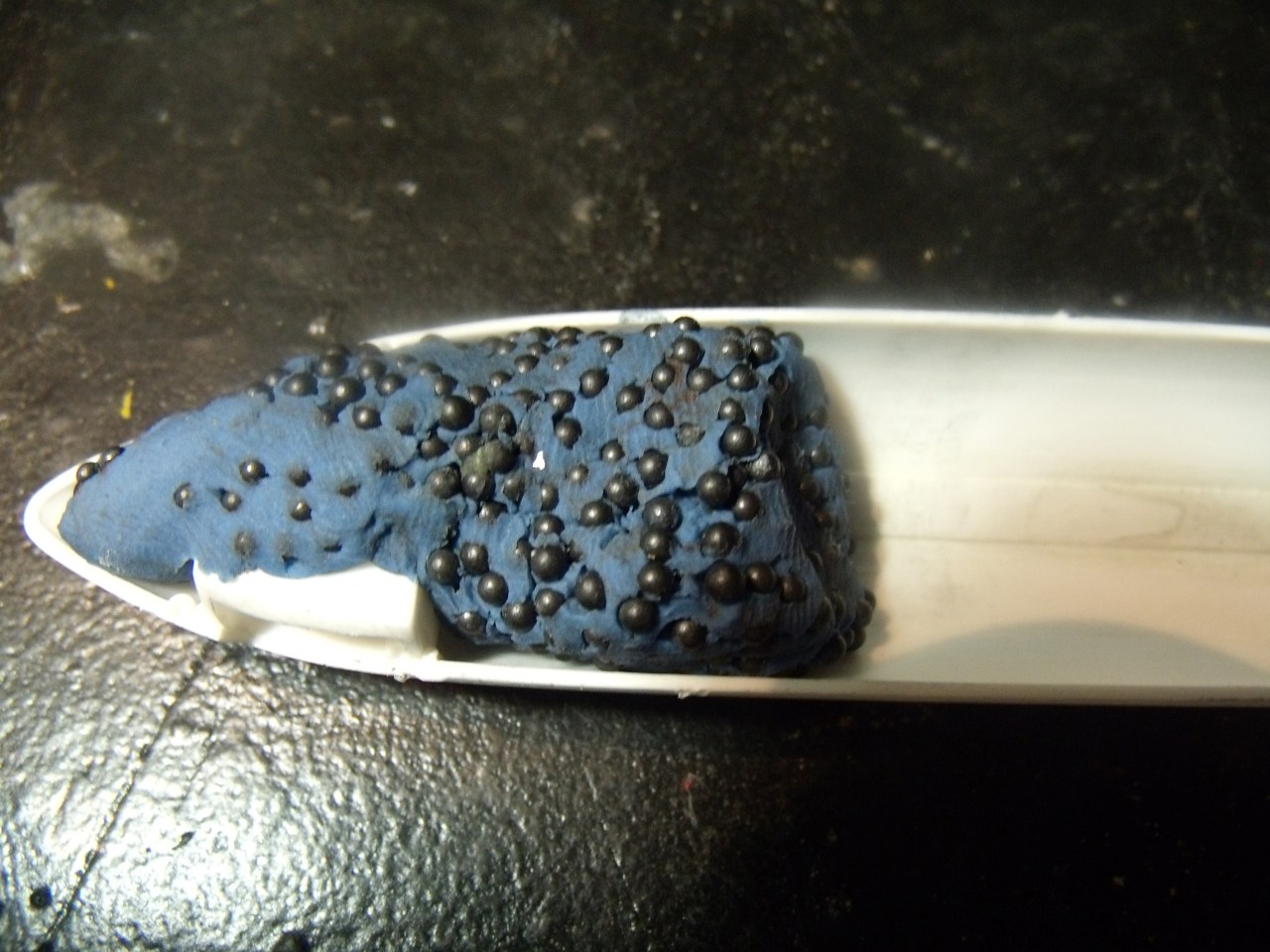

  • The many uses for modeling clay
    On my workbench is a substance that I couldn’t do without: modeling clay. Its many uses include:

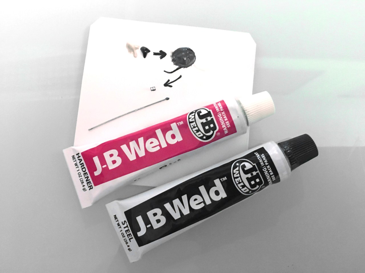

  • A good glue to have in a sticky situation
    If you are tired of counting to 100 while you wait for super glue to secure a photo-etched part to your model, try using J-B Weld epoxy resin as an alternative. This product is extremely easy to mix, is workable for an extended period of time, and has the viscosity to hold delicate PE parts…

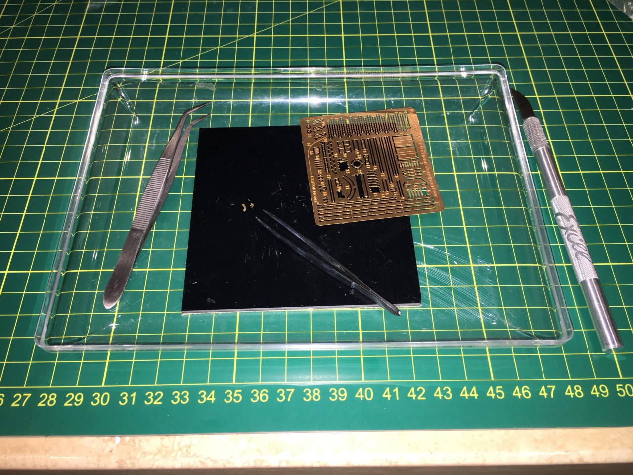

  • Inexpensive photo-etch tray
    Once I’ve enjoyed a box of Ferrero Rocher chocolates (and who wouldn’t?), the sturdy, clear lid makes a perfect photo-etch (PE) working space. I line it with black Perspex, which allows me to easily see tiny PE assemblies.
