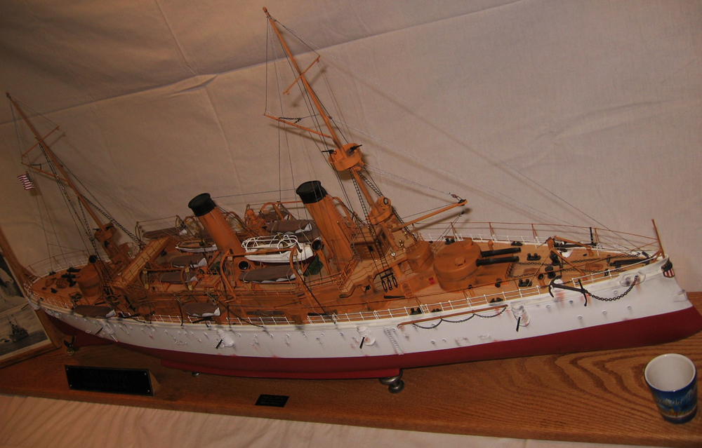

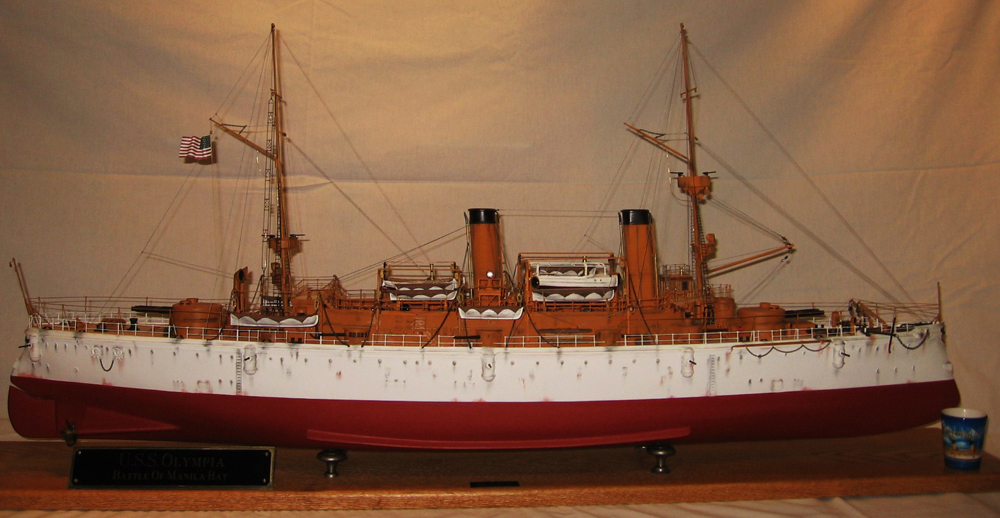

Iowa_1
Iowa_2
Iowa_3
Tim Quinlan builds large, scratchbuilt operational ships. Several years ago, he decided he was going to scratchbuild a 1/96 scale model of every ship in the U.S. Navy during the Spanish-American War. The May 2011 FineScale Modeler features his USS Iowa.

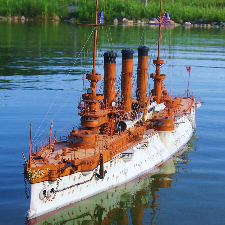

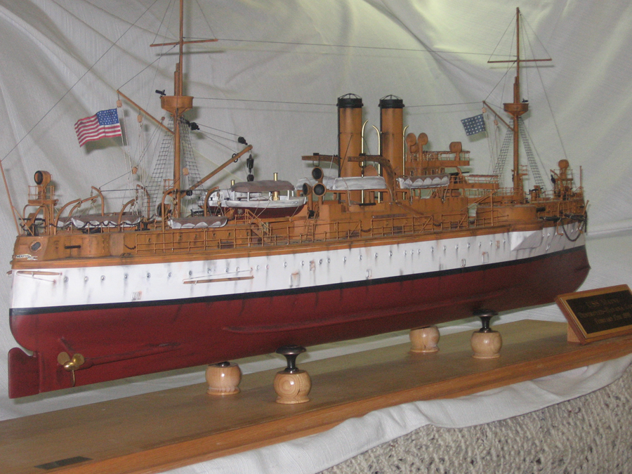

Brooklyn_1
Brooklyn_2

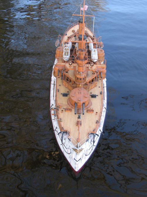

The USS Brooklyn sets sail: The 1/96 scale ship took Tim about a year to complete. He cast his own fittings in fiberglass resin using RTV silicone molds. The model was painted in Spanish-American War colors.

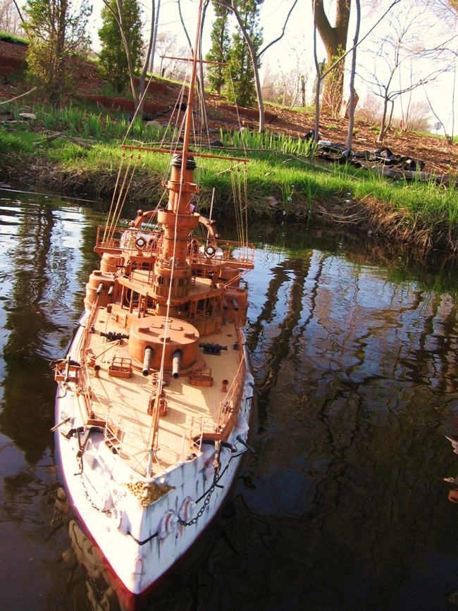

Maine_1
Maine_2

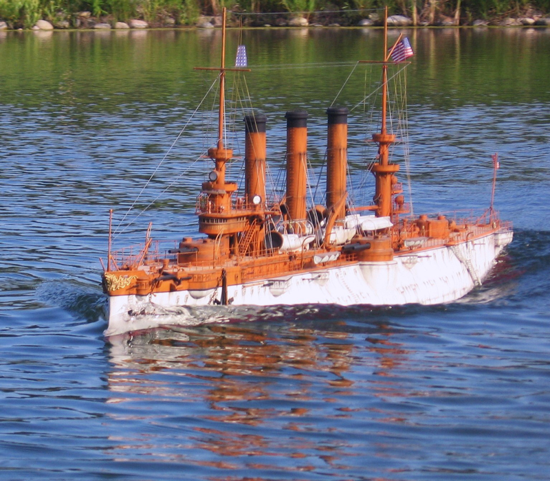

The USS Maine was Tim's first airbrushed model. He used small snaps for the ship's pulleys and made tarp covers with tissue soaked in a mixture of white glue and water.

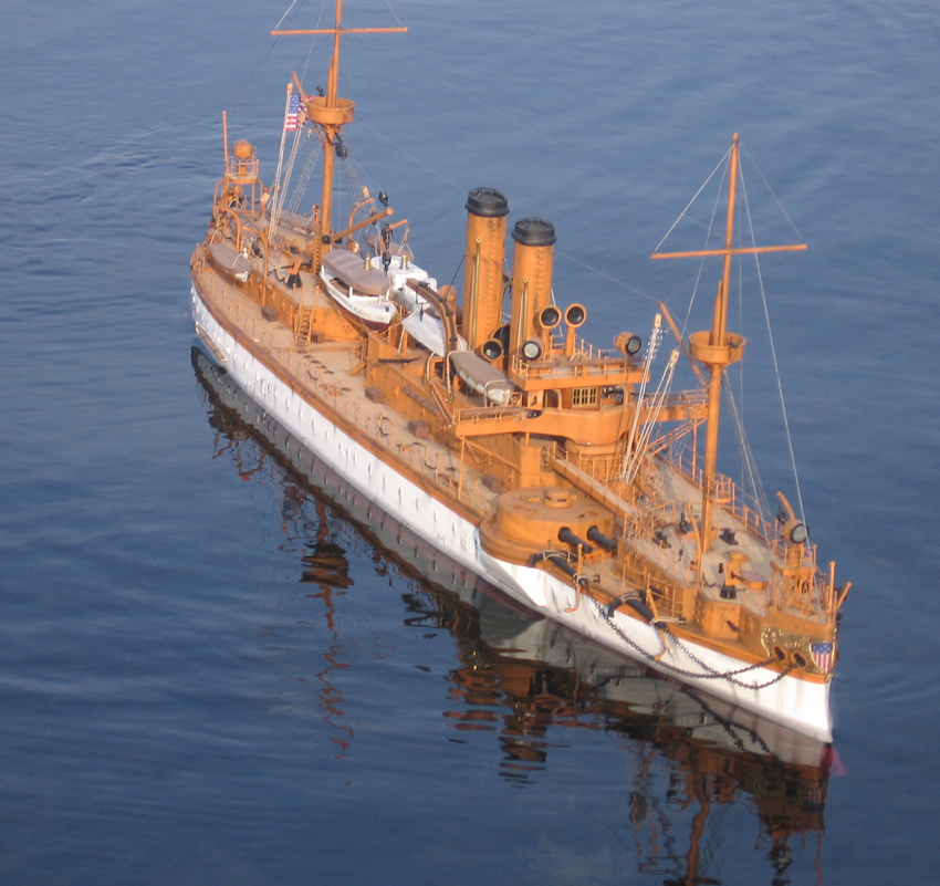

Olympia_1
Olympia_2

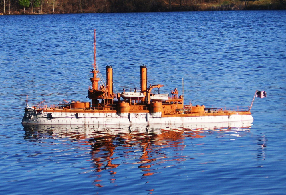

"Ships that I have seen have been really hammered by the elements," says Tim. "So, I consider weathering to be one of the most important aspects of creating a model that looks real on the water." He used a variety of techniques, including washes, pastels, and abrasion, to give his USS Olympia a sailed-in look.
