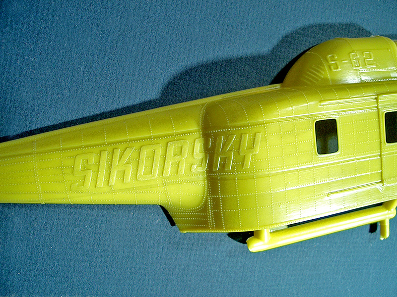

The kit was, to say the least, crude. The heavy yellow plastic was deeply embossed with pinstripes and factory markings and adorned with golf ball-sized rivets.
05
This required a lot of Squadron Green Putty, sanding, filing, and more sanding until a smooth, unblemished finish could be achieved.
