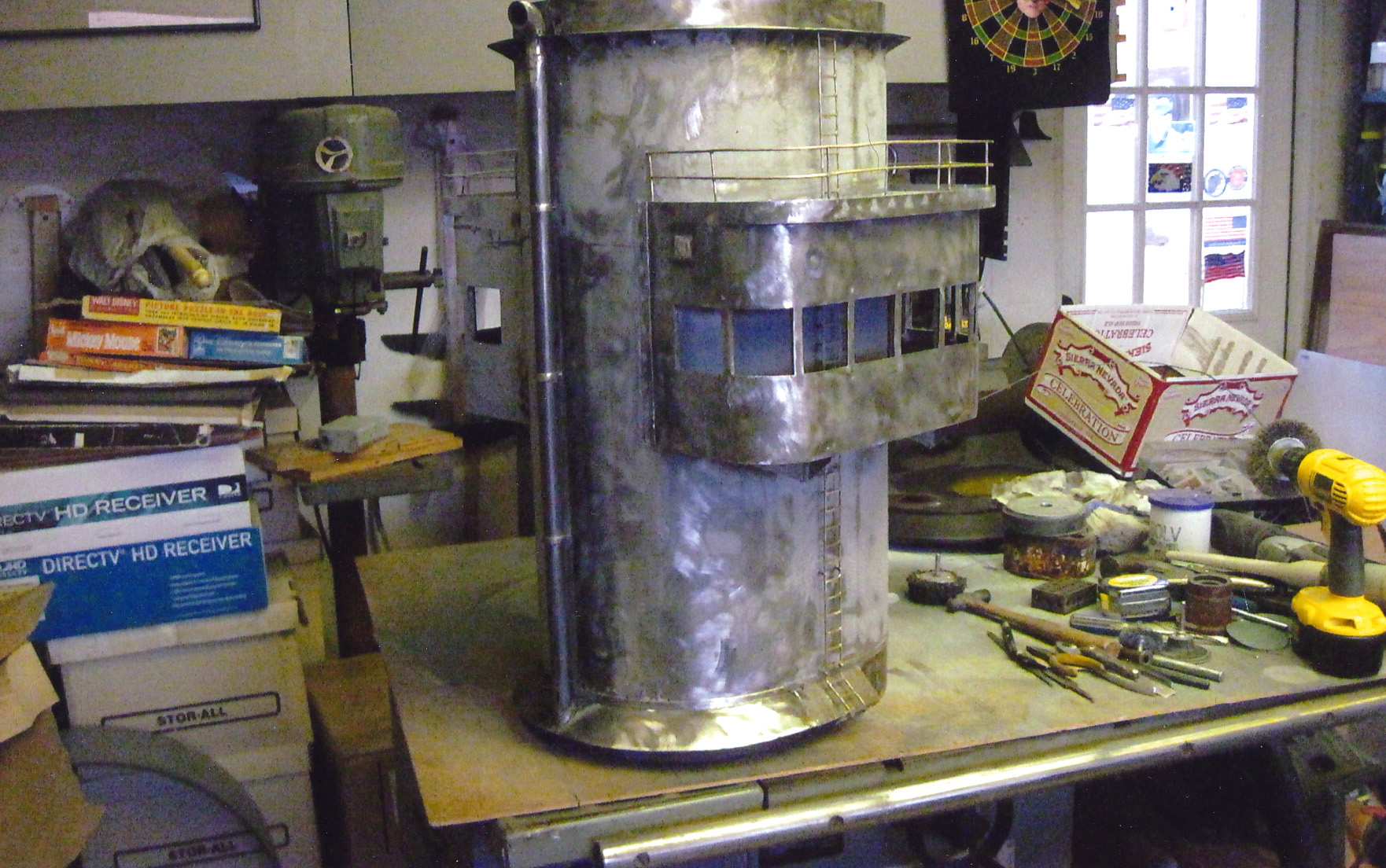

Stewart’s task was monumental, thanks to the wood rot, termites, mold, and rust that was consuming the ship. But he was honored to be asked.

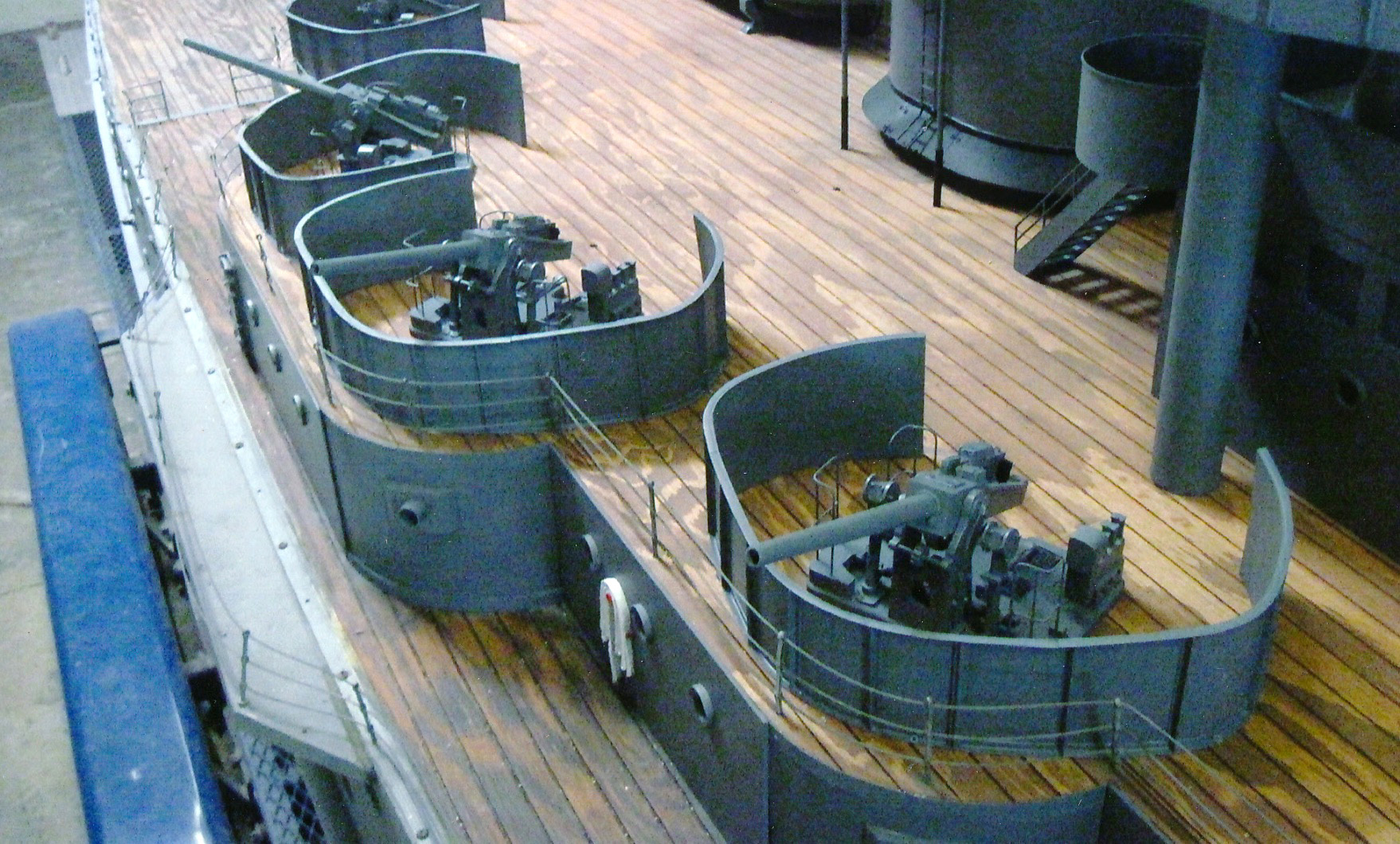

He hand-scraped at least half the ship’s paint off and had the rest, including the steel, sandblasted. Bulkheads were replaced with Plexiglas, as were superstructure decks. New plywood was used for the main deck, while the funnel, railings and cranes remained the original steel. Guns were rebuilt.

Stewart used as much of the original metal as possible, having it sandblasted, but replaced brass railings.

The ship’s 10 guns were cast in silicone molds.

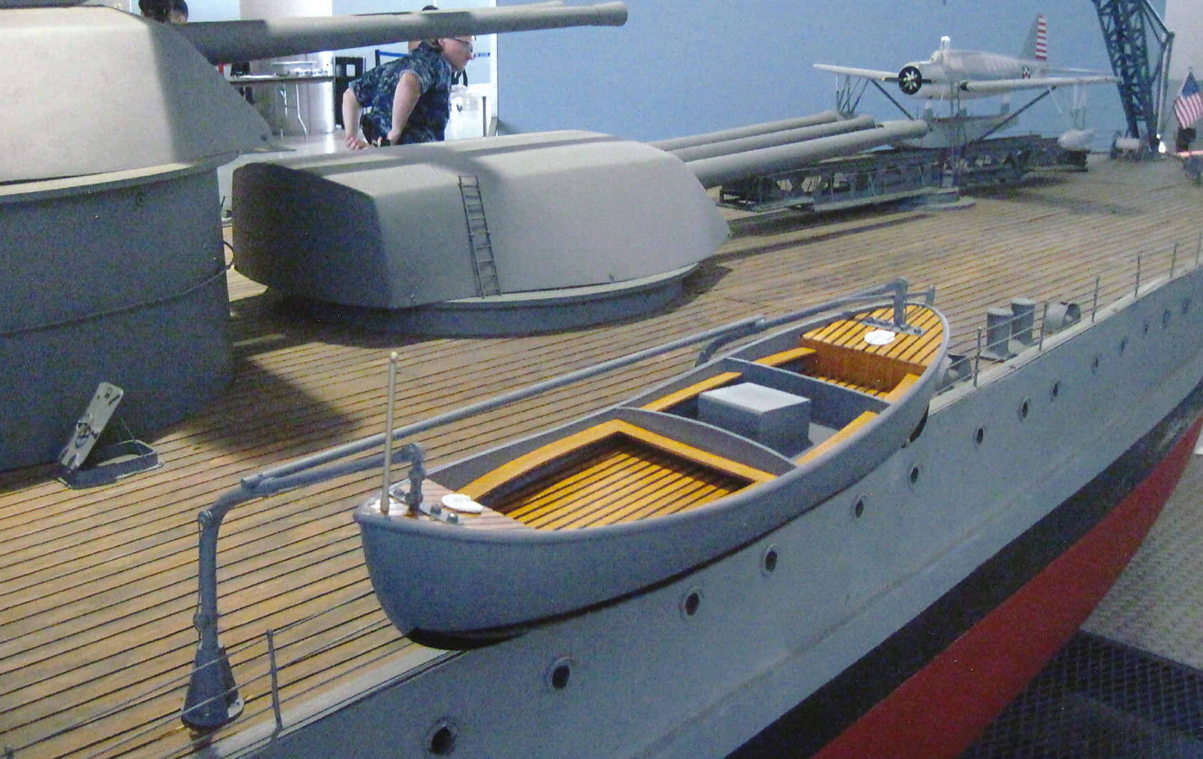

Stewart made a master copy of a lifeboat, then had others vacuum-formed from it.
