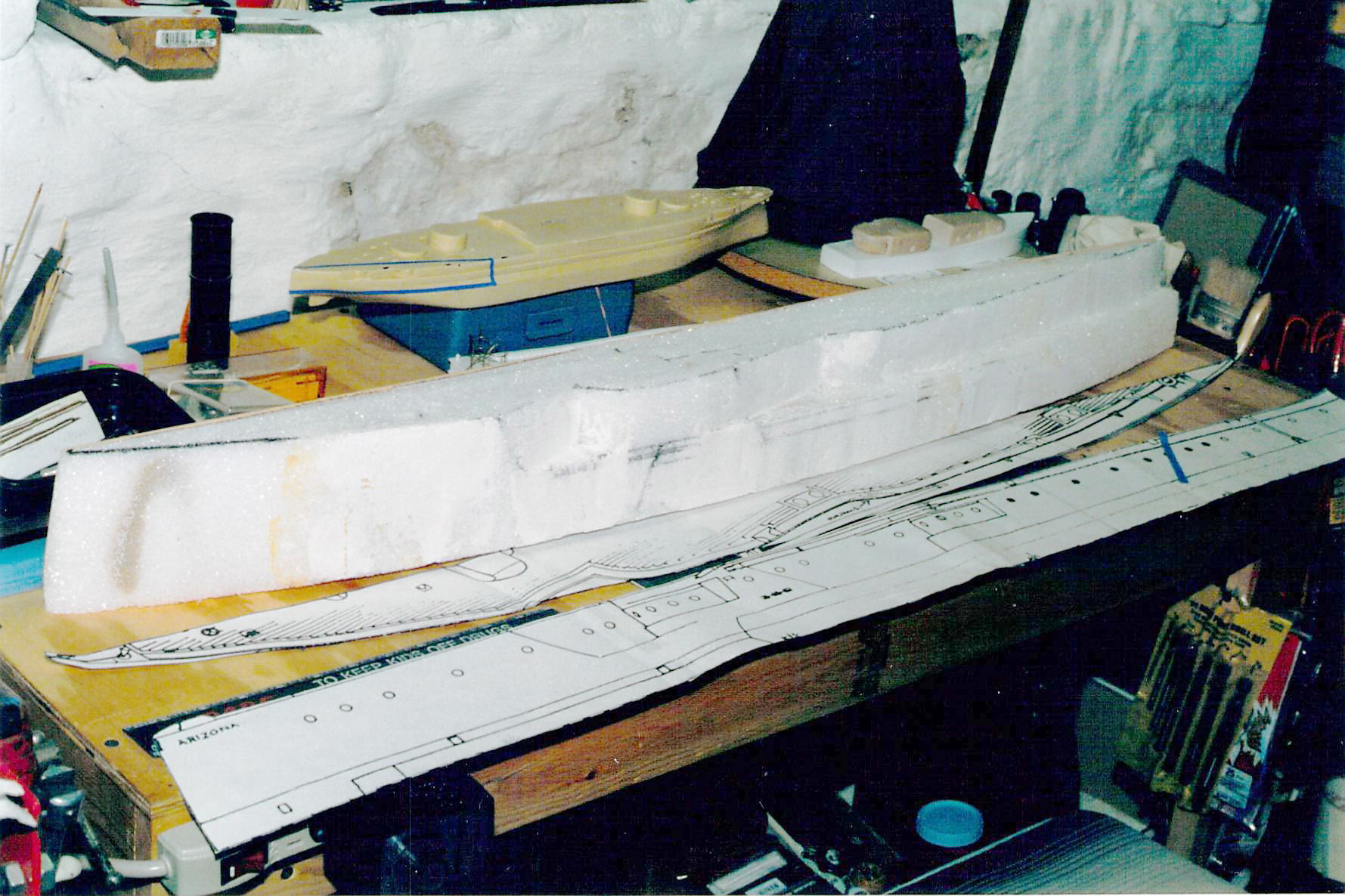

Rob’s battleship started with scale plans and several 2'-long plastic-foam 2" x 4" blocks. Choosing 1/48 scale opened a lot of possibilities for figures, but the whole ship would have been 12.5' long! Instead, he showed the stern with its nameplate for instant recognition.

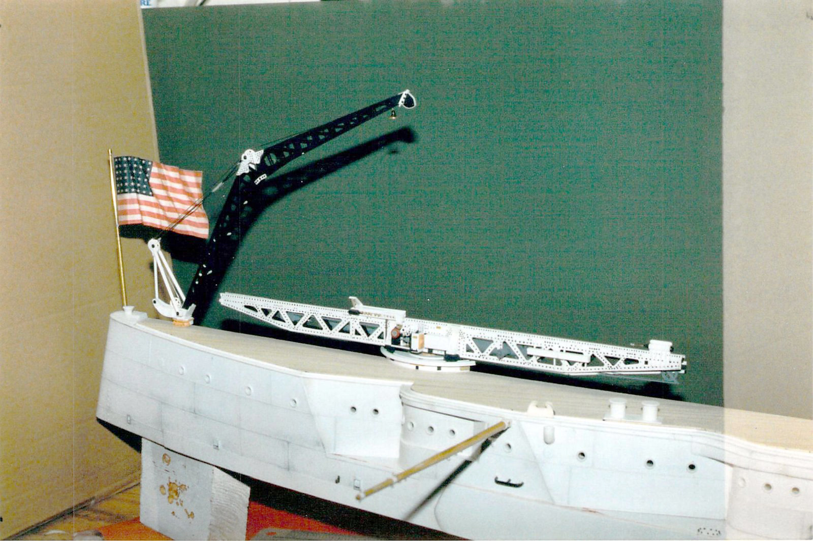

Rob sheathed the foam form in 1⁄16" basswood sheet to which he super glued .010" sheet styrene to plate the hull. He scratchbuilt most of the ship’s fittings from styrene sheet, strip, tube, and structural forms, adding Grandt Line bolts and brass elements to the aircraft catapult. The boat boom was a bamboo chopstick.

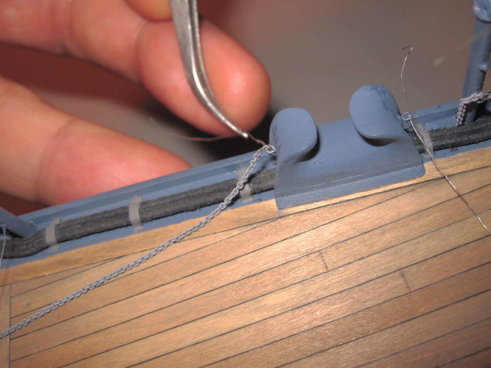

Basswood planks 1⁄8" thick cover the deck. Rob used more than 10' of scale chain for lifelines spanning the quarterdeck.

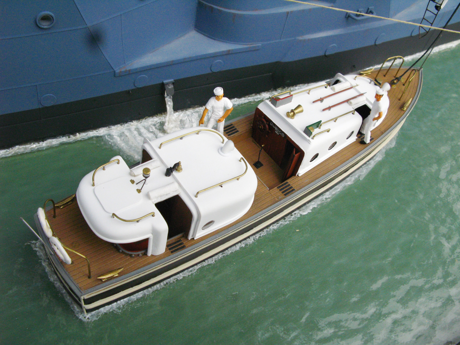

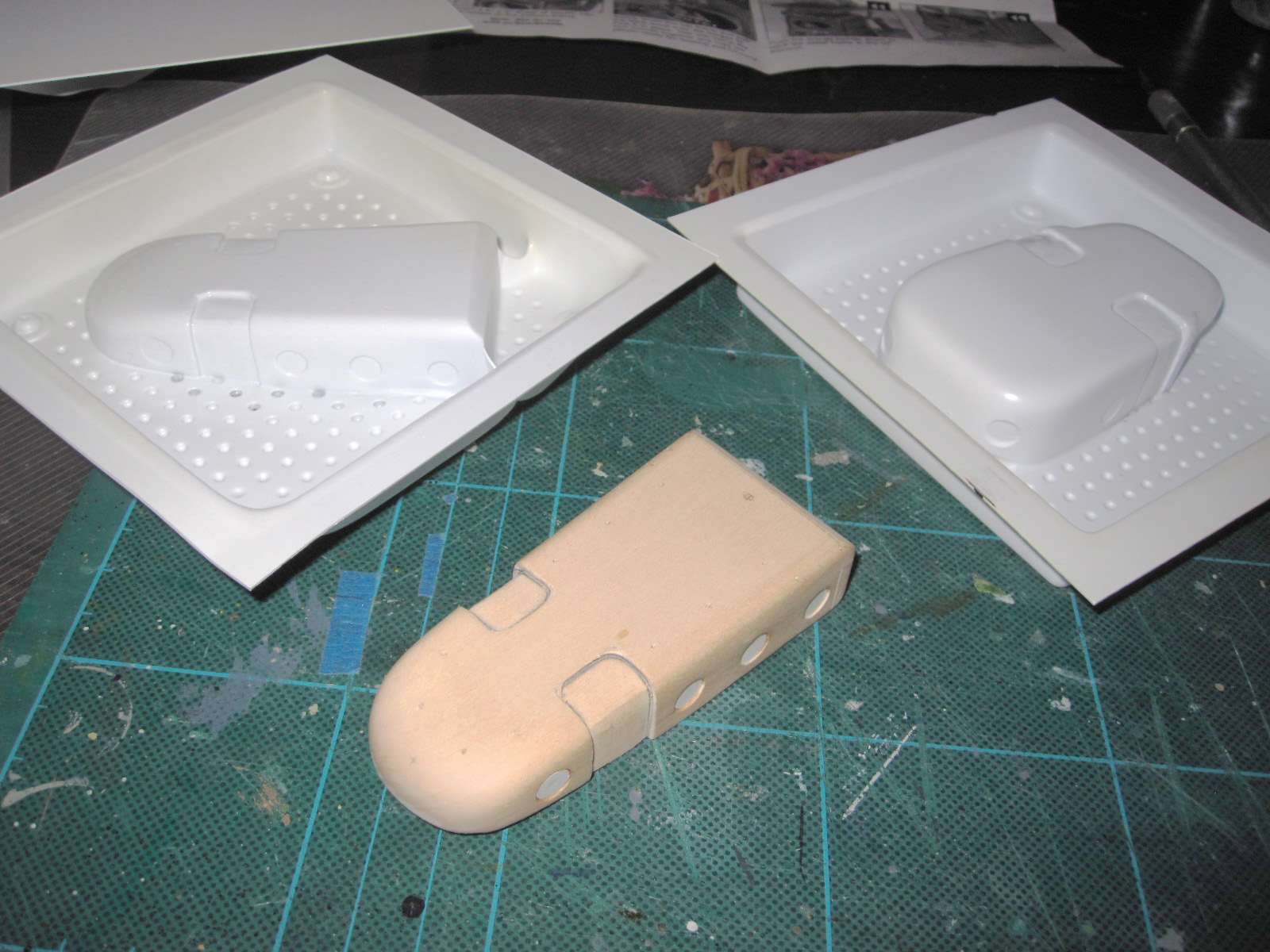

Rob carved basswood masters to vacuum-form cabin enclosures for Arizona’s auxiliary boats, which he made from styrene sheet and strip.

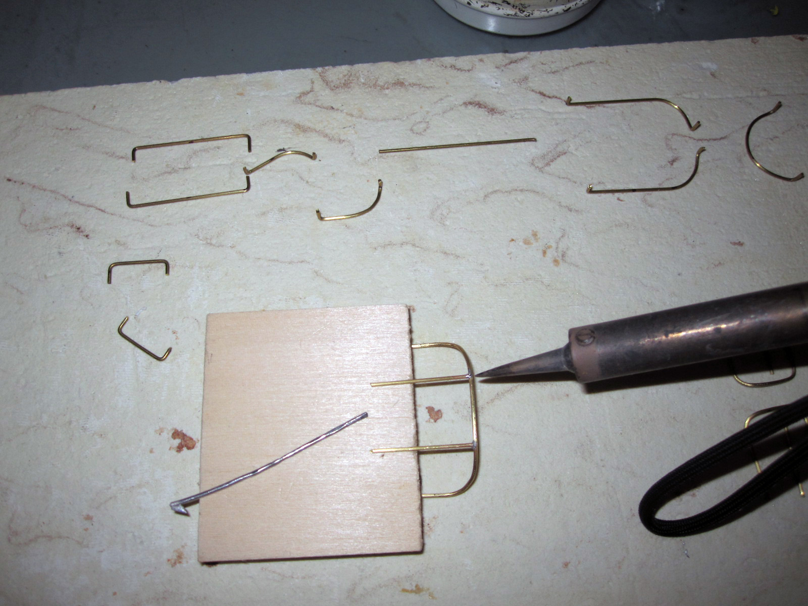

Brass railings and fittings were formed in segments and soldered …
FSMPD1216_06
… before being installed on the auxiliary boats. Rob painted textured acrylic sheet for water and floated the boats on two-part epoxy.

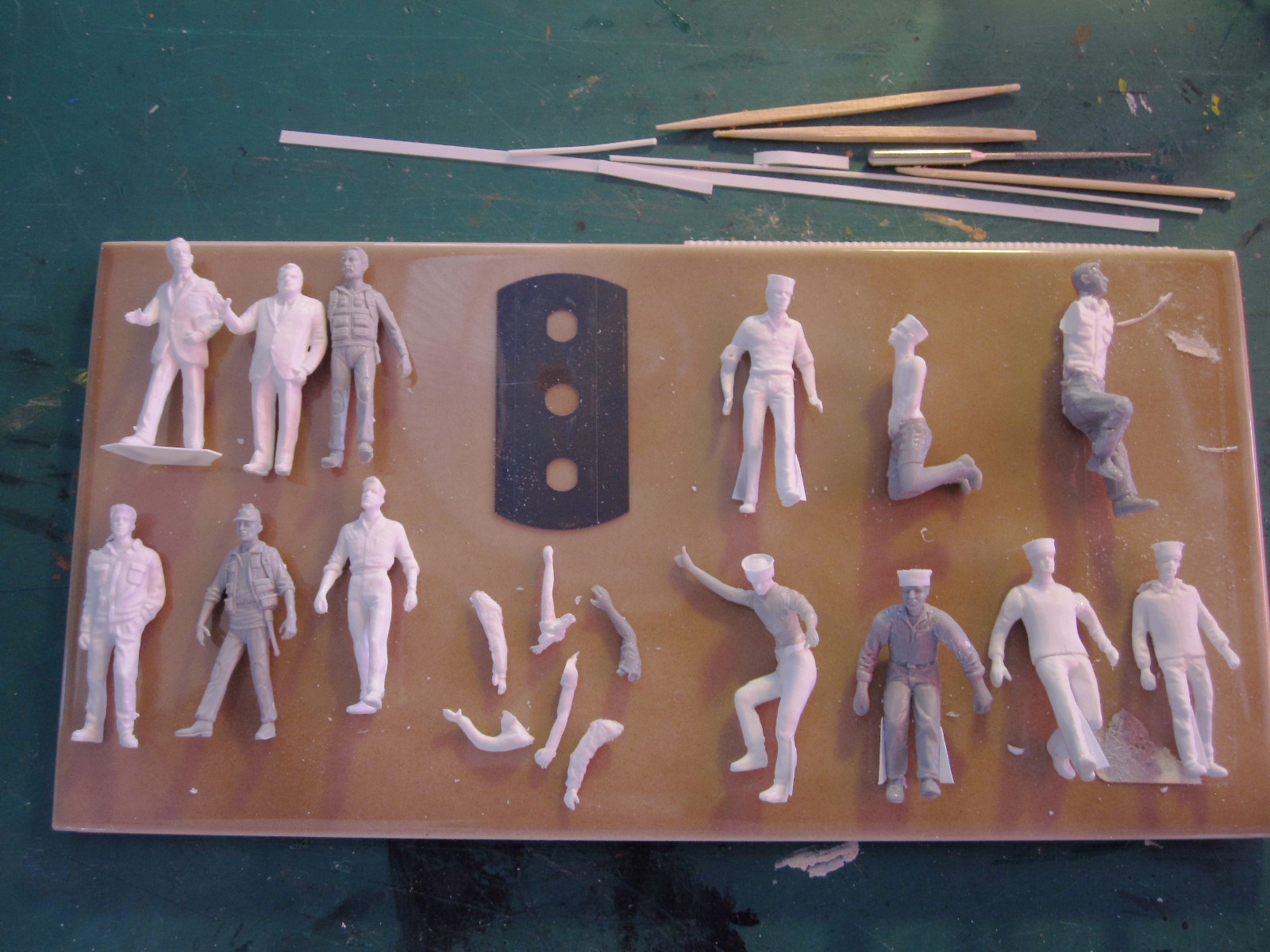

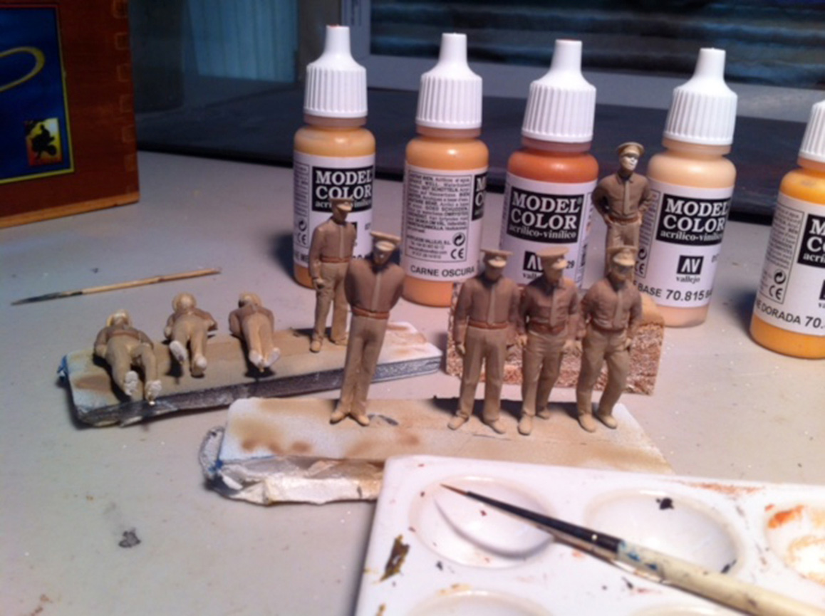

Despite all of Rob’s shipbuilding, the stars of his show are the figures — all 97 of them! He collected a variety in 1/48 and 1/50 scale, then used his razor saw to mix and match parts.
FSMPD1216_08

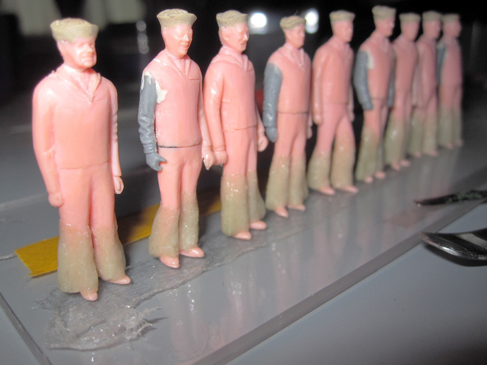

The 1/48 scale figures from K-Lineville’s “Presidential” collection were difficult to work with, Rob says, but useful for the enlisted ranks. He used epoxy putty for bellbottoms and sailor caps, adding .002" styrene strip to the cap brims.

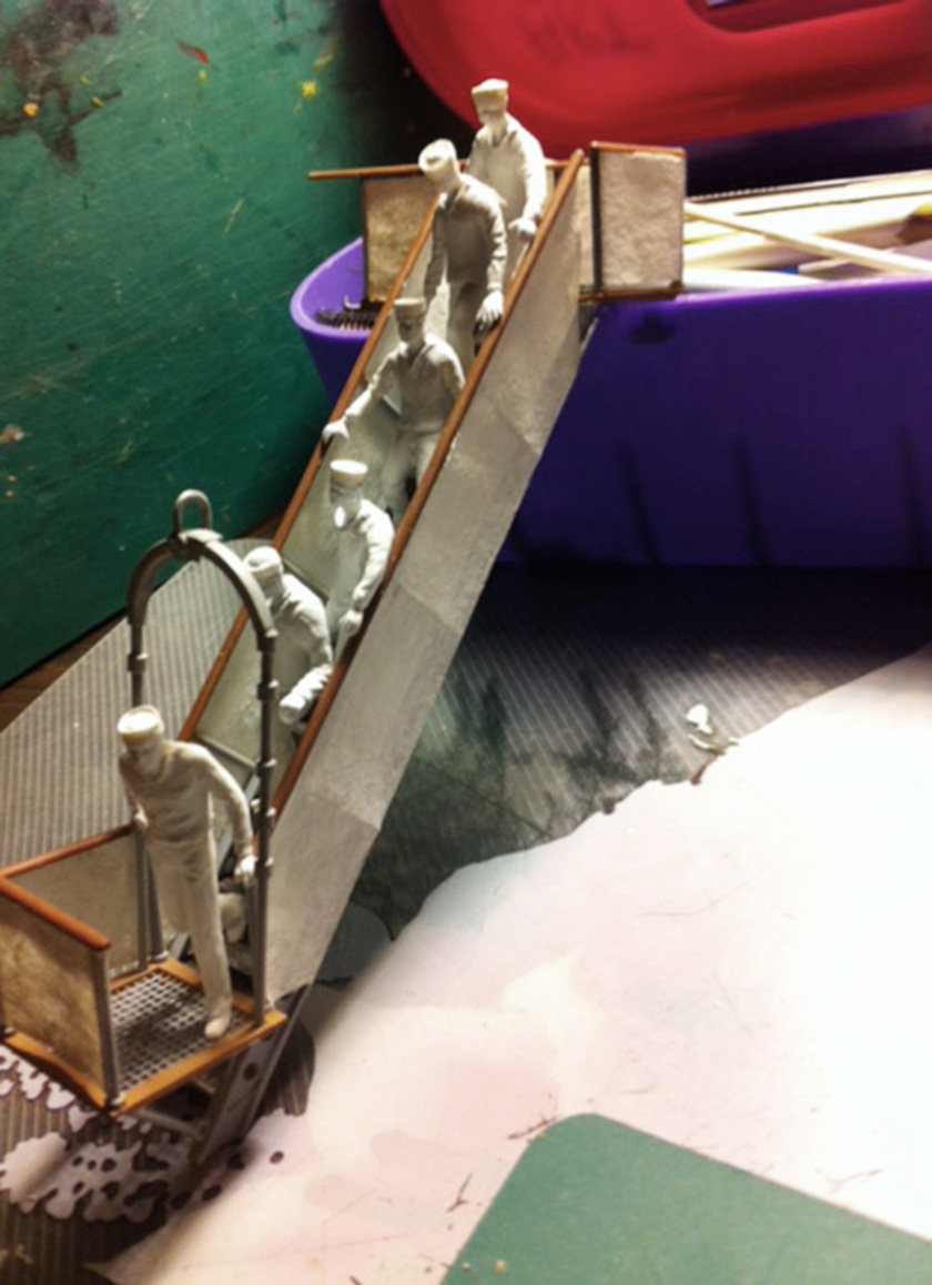

Nearly all the figures were modified in one way or another for the variety of poses needed in the scene. Rob made the accommodation ladder from styrene rod and strip; surgical tape stiffened by diluted white glue served for the windbreak.

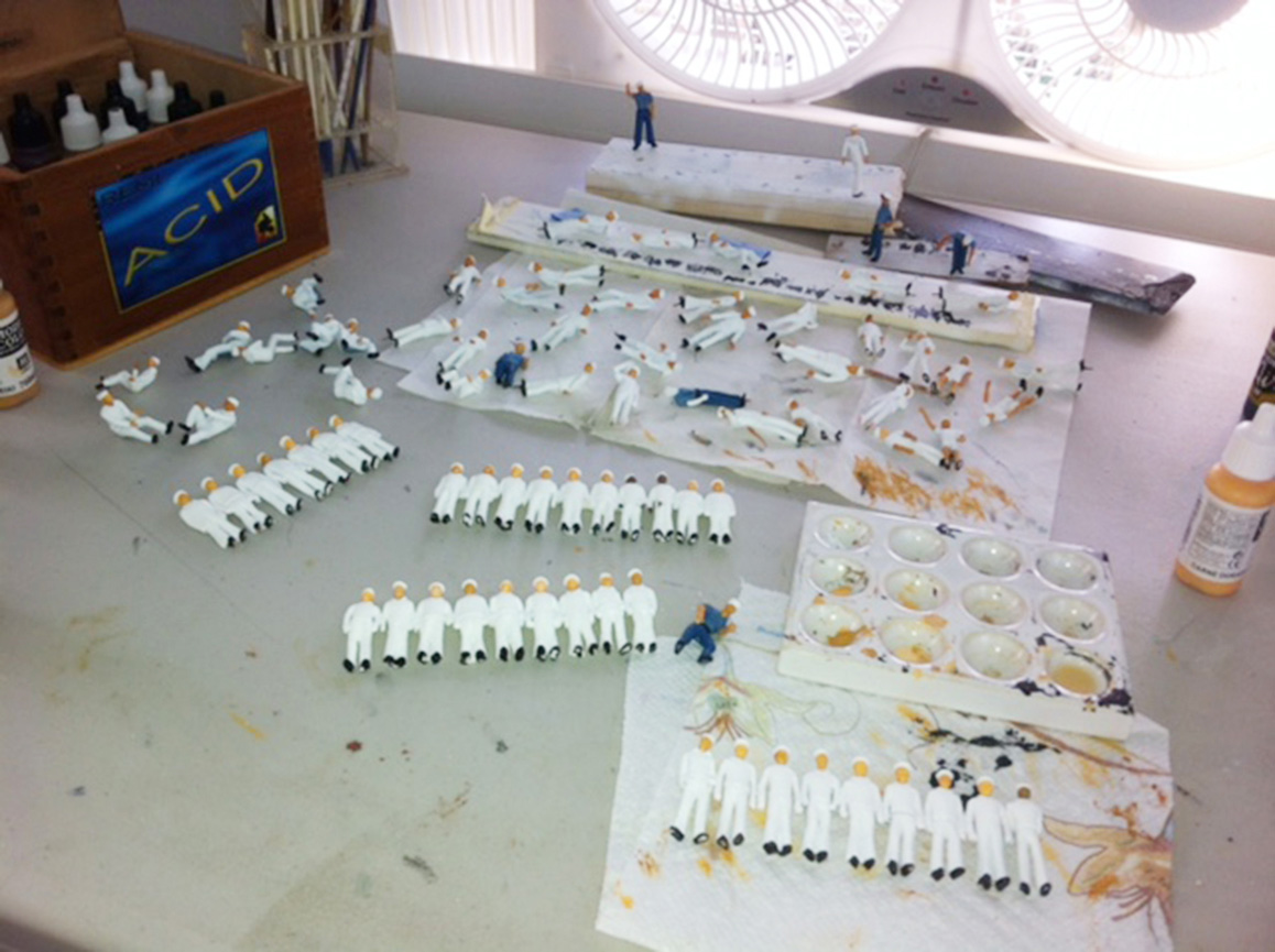

Seeing most, but not quite all, of the figures gives some idea of the scope of Rob’s undertaking. Rob made more than 80 sailor caps …

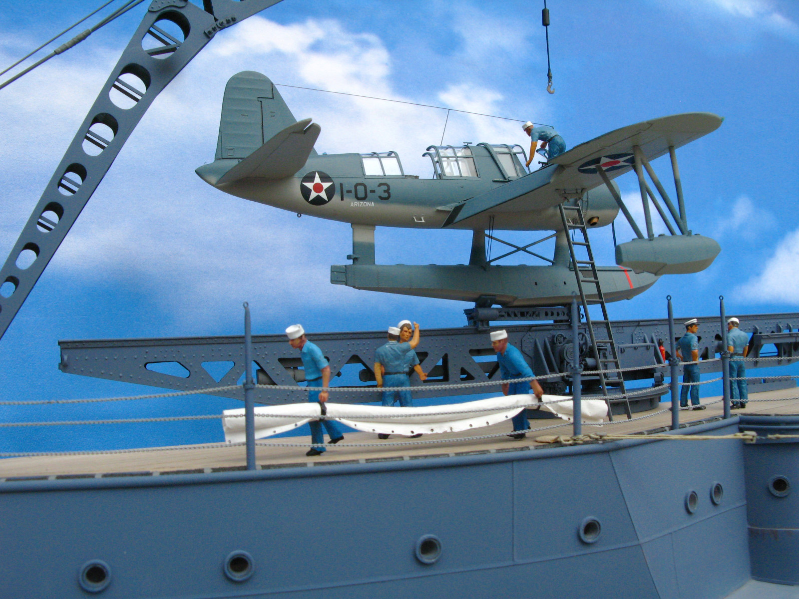

Sailors head aft to set up a canvas awning on the fantail for the next morning’s Sunday services (which were never held). Forcing perspective, Rob sawed off Monogram’s OS2U Kingfisher at 1 o’clock and 5 o’clock on the port side — not quite a wall mount, but almost — and shortened the starboard wing. Decals are from AeroMaster.
