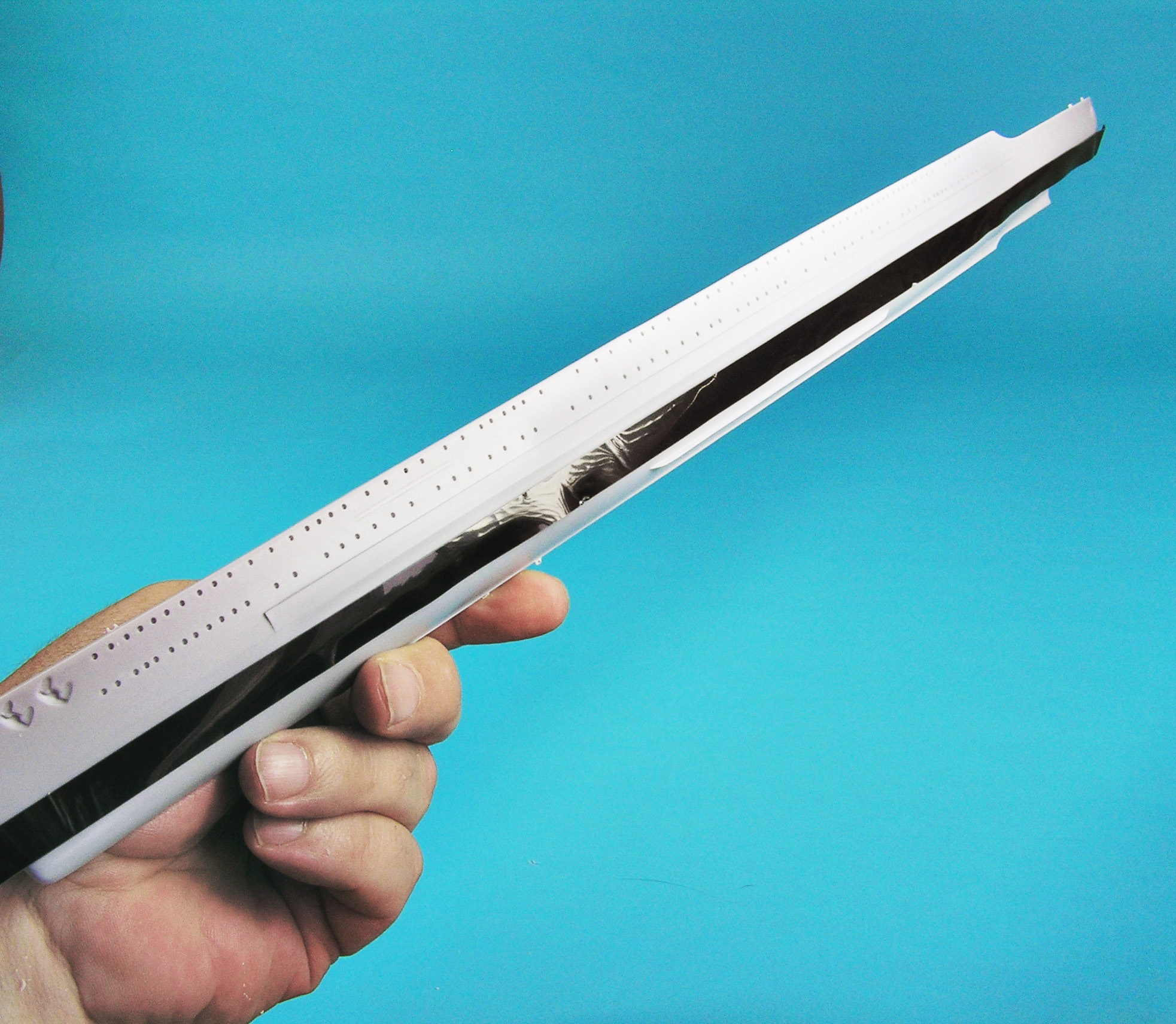

On some models, the waterline is marked with a raised line on the hull. Ultimately, it is up to you to decide how high or low you want your ship to sit in the water. Once satisfied with the waterline location, mark it with plastic labeling tape.

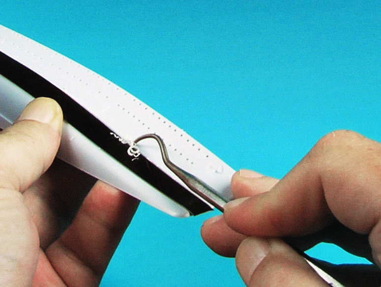

Ted carefully runs a scribing tool along the hull, using the labeling tape as a guide. He makes several passes to cut a deep groove.
FSMWL0913_03

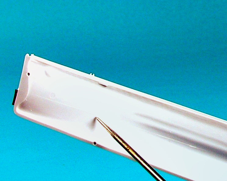

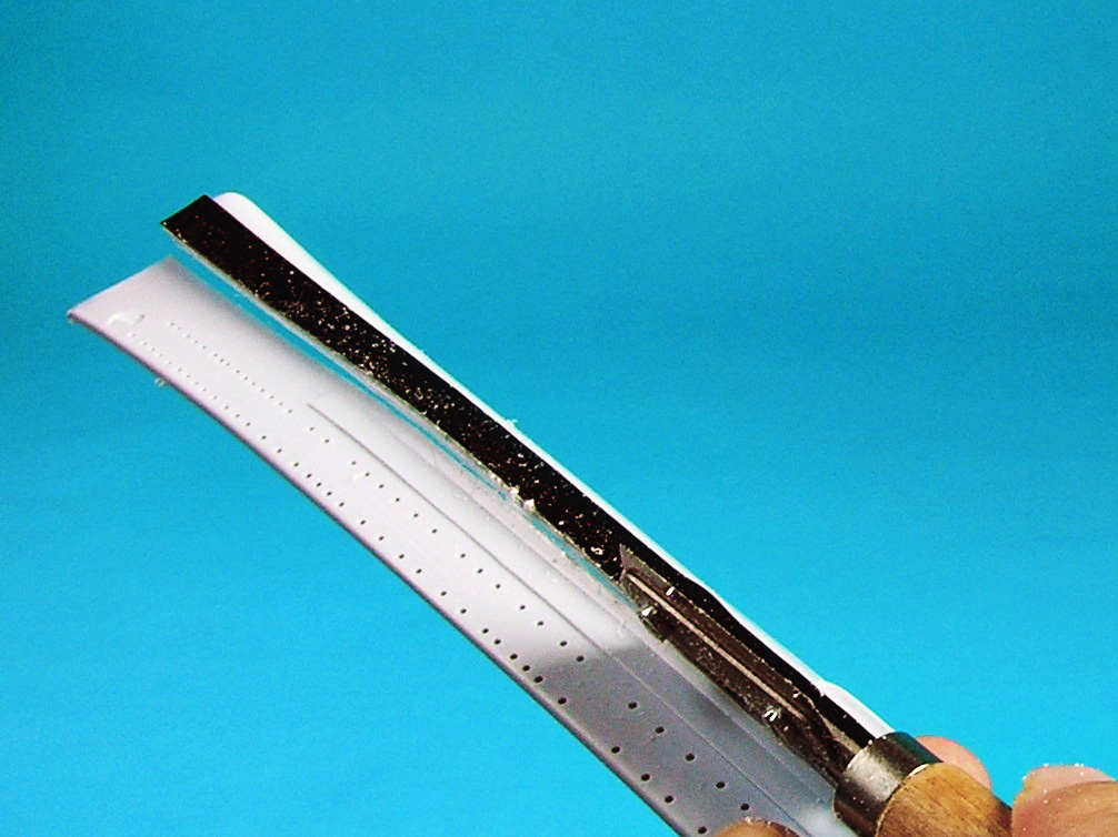

“Continue to use the scribing tool until you see a thin line on the hull’s inside,” Ted says. “You could cut all the way through with the scribing tool, but it’s easier to finish with a razor saw.”
FSMWL0913_04
Starting at the bow and working toward the stern, Ted cuts along the groove with a razor saw. “If you find the cutting difficult or the saw binds, go back to the scribing tool and cut a little deeper,” Ted says.

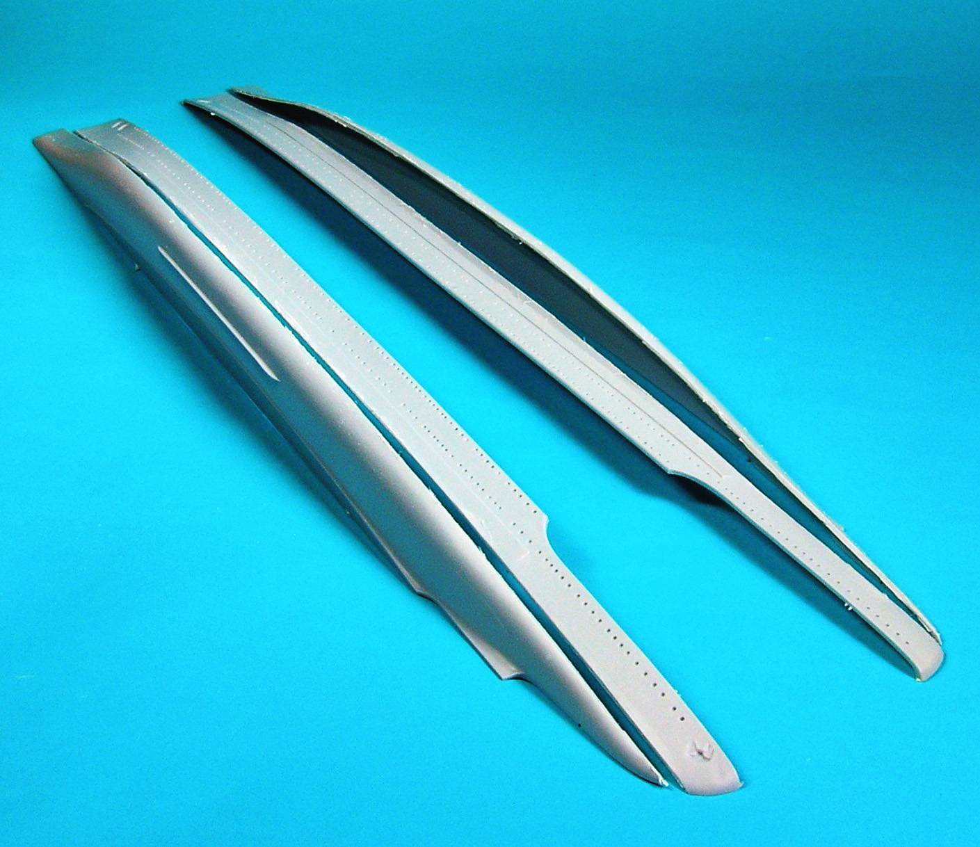

Once the cut is complete, you have the beginnings of a waterline ship model. But it’s not ready yet.

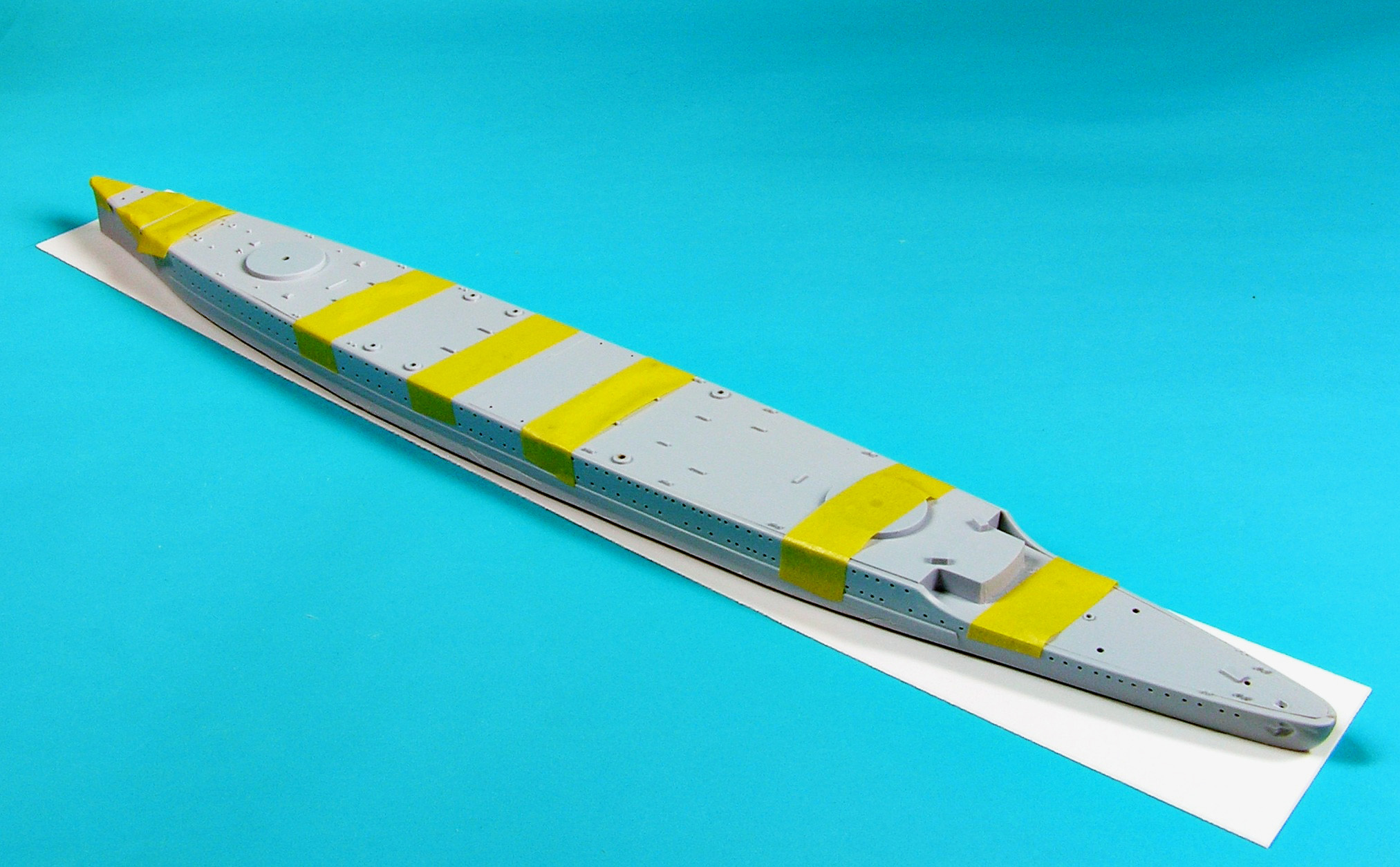

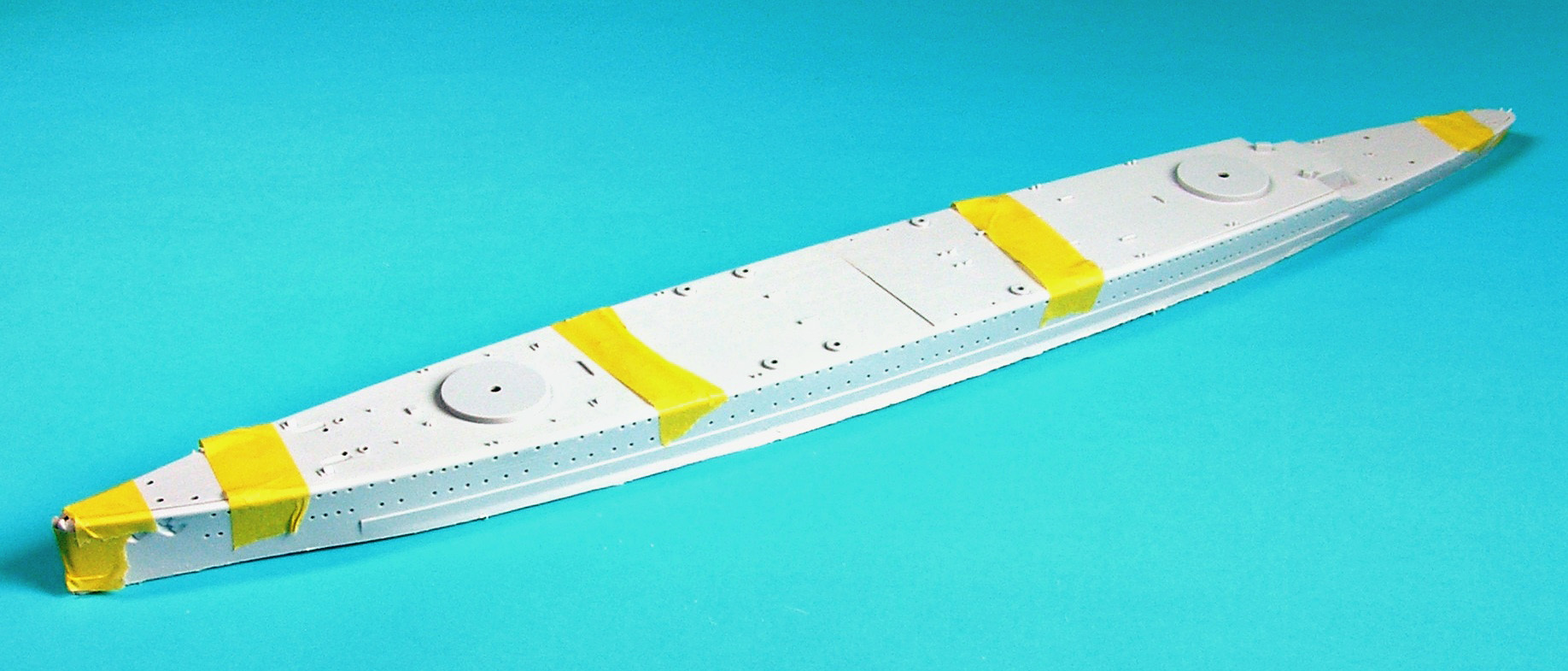

Ted glues the hull halves together, temporarily taping the deck in place to ensure proper alignment.
FSMWL0913_07

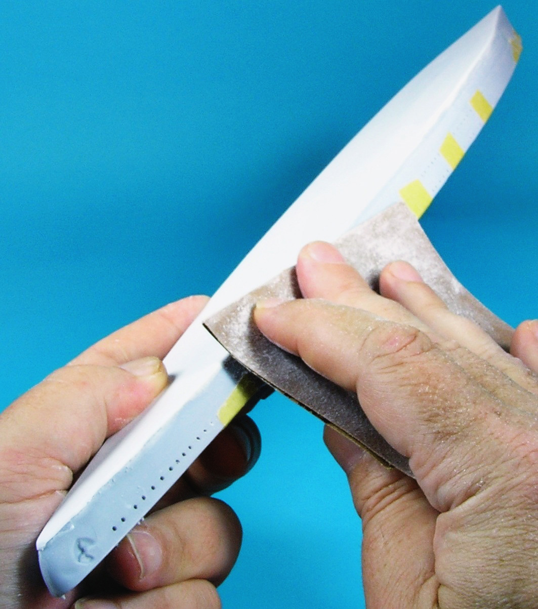

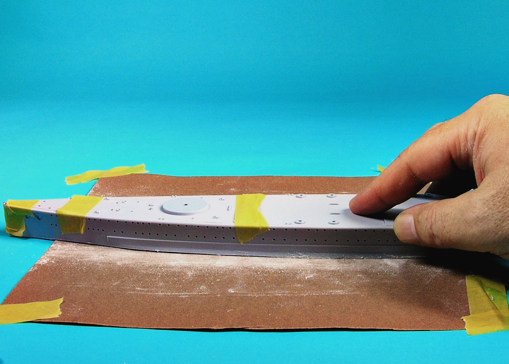

To make sure the hull halves match along the waterline, Ted sands the cut edges even with a sheet of coarse-grit sandpaper taped to his workbench.

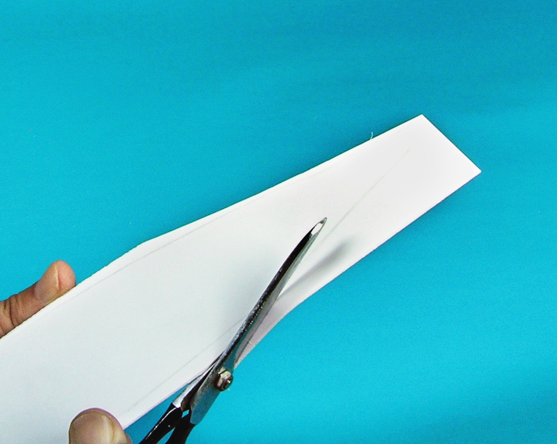

He cuts along the line with a pair of scissors. “No need to be exact,” he says. Make sure to leave some space around the edge for final shaping.

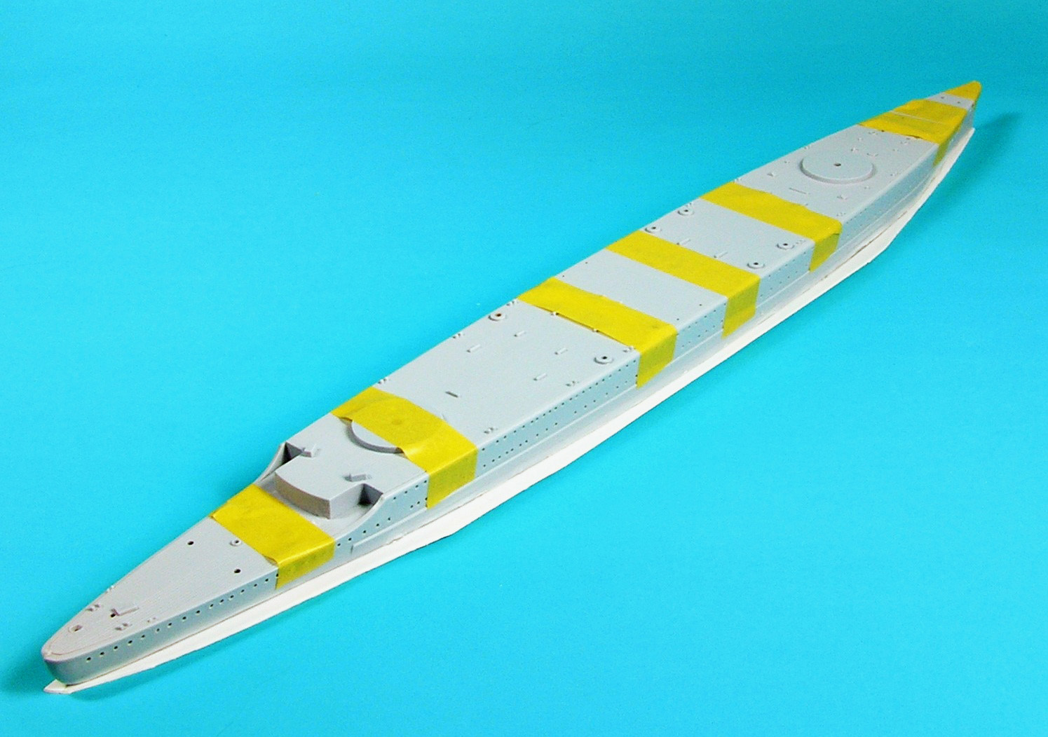

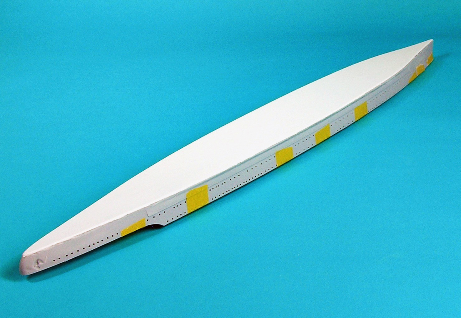

Ted super glues the hull to the waterline plate and allows the assembly to dry overnight.
FSMWL0913_11

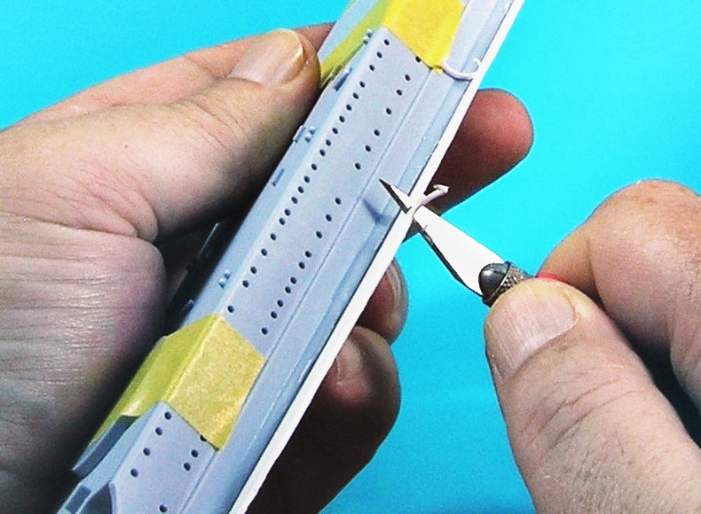

Trim the waterline plate’s excess plastic with a sharp hobby knife.
FSMWL0913_12
Once the plate is almost even with the hull, Ted starts shaping it with coarse sandpaper, shifting to medium for final shaping and fine to finish it off. Use putty as needed.

Then, assemble the ship as usual. You can attach the model to a finished wood base or create a sea for the ship to sail through. The choice is yours!
