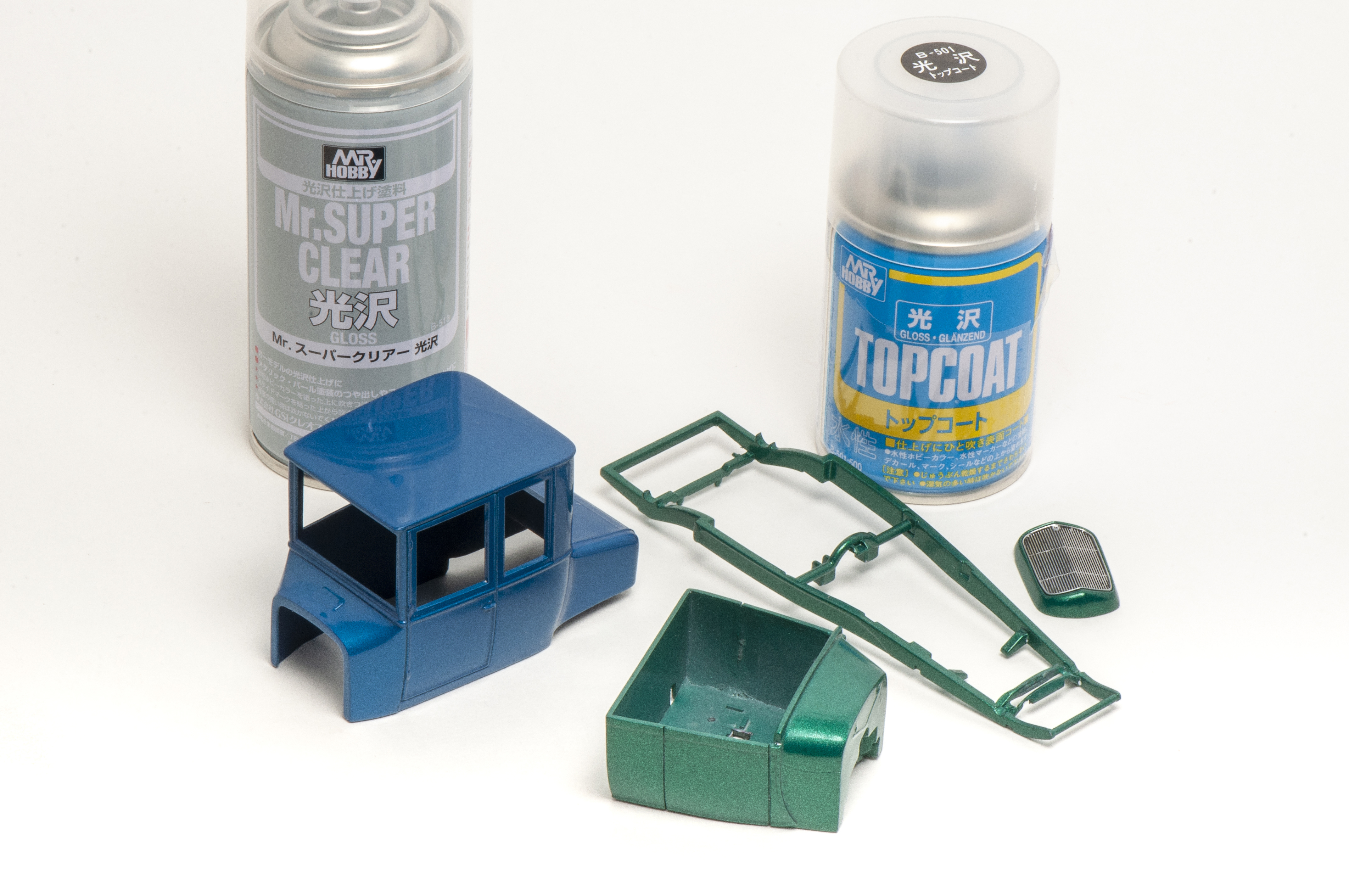

FSDTB0521_MrHobby_TopCoat
Mr. Hobby Mr. Super Clear Gloss (B-513) and Gloss Topcoat (B-501)
Pros: Both products apply well, seem to be very forgiving during application, and dry quickly to a much harder surface than some other clears.
I have not found any cons after multiple uses.
Advice:
The formulas are somewhat different between the two Mr. Hobby paints, so I recommend trying them both. FSM contributor Bob Downie says he is impressed with Gloss Topcoat and has decanted and airbrushed it when combined with Mr. Hobby Mr. Color Thinner.
