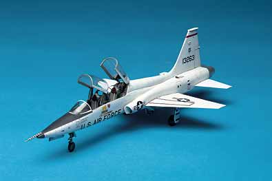

The resin cockpits go together well, but I had to remove excess resin from the backs of the instrument panels to make them fit into the fuselage. Joining the fuselage halves proved to be a challenge. There are no locating pins or ledges to help align the halves, and assembly is complicated by positioning the two cockpit tubs - again without locating devices. I had to repeatedly test fit the cockpit tubs, then scrape and grind plastic and resin to get it all together.
Once that battle was won, the rest of construction proceeded rapidly. General sanding of seams reduced the already faint panel lines in places, so I rescribed them.
I painted the model with gloss white, then added a dark gray "sludge wash" to pick out the recessed details. Decal options for two gloss-white trainers are provided. Printed by Techmod, the decals went on without problems and responded to setting solution.
Final assembly uncovered a few minor problems. The horizontal stabilizers have mounting pins, but there are no corresponding holes in the fuselage. I drilled holes, taking note of the stabilizers' four-degree anhedral.
The main wheels appear too wide compared to reference photos. You could sand down the inside faces of each wheel half and make them look better. Posing the canopies in the open position is tedious due to the intricate supports. My sample's windscreen did not fit into the recess in the fuselage, and I had to fair in the leading edge with white glue. If I were to build another Talon, I'd sand the insides of the vertical stabilizer to thin it down, and sharpen the tip of the nose a bit.
But even straight from the box, Sword's Talon is much better than any previous attempts at providing a plastic kit of this important, graceful trainer. I spent 25 hours building my Sword kit. You should have experience working with resin parts before taking on this Talon.
