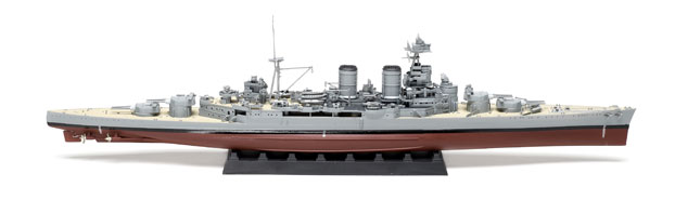

Construction was straightforward with no complications. Parts fit was mostly excellent, although some smaller parts required flash removal. Bridge parts and lifeboats had ejector-pin marks that required sanding or filling.
I chose the full hull version to take advantage of the unique dry-dock display stand.
Alignment gaps in my sample's upper and lower hull halves were immediately apparent and required extensive filling and sanding along the entire length of the hull.
In Step 3, a gap between bulkhead parts A22 and F2 had to be closed with .010" strip styrene.
I built the kit in subassemblies, leaving off deck structures and equipment until after painting. Ignoring the color suggestions in the instructions, I used the HMS Hood Association's Web site (www.hmshood.com) as my color guide and painted the 1941 scheme using Gunze Sangyo grayish-blue H337 for the upper hull and superstructure, Vallejo dark sea green 868 for the boat deck, and Polly Scale old concrete for the wood decks. The lower hull was painted in Polly Scale's oxide red with scale black for the waterline. The hull draft number decals went down nicely with a little Micro-Sol to finish the build.
I spent 42 hours on my Hood, a bit longer than usual due to all the small parts. It was a fun build, and it is a clean representation of the real ship. The kit scales well to the Hood association's dimensions. While it's very detailed, Trumpeter's engineering makes it easy for a beginner with a few kits under the belt. The minor gaps can be easily overcome by more-experienced modelers.
