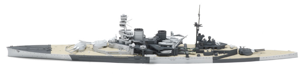

Construction was straightforward with no complications - fit was flawless! Seams are engineered to be unseen after being assembled.
In Step Two, the diagram isn't clear. It's best to install the main mast (B33) first, then the pilothouse roof (B42). Also, Step 10 is vague on the placement of the turret rangefinder (C32) on the turret (C31). Proper placement is behind the turret and flush with its roof.
I built the kit in subassemblies, leaving off all the deck structures and equipment until after painting.
I painted Repulse as she appeared at the time of her sinking in "contrast camouflage," an unofficial scheme with British 507A and 507C grays applied in a disruptive pattern.
I used Gunze Sanyo light gray (H338) for the lighter 507C gray and Polly Scale scale black for the darker 507A gray, following instructions for the disruptive pattern.
Vallejo dark sea green (868) was used for the boat deck; Polly Scale old concrete for the wood decks completed the painting.
I spent 18 hours building and painting my Repulse. According to dimensions in Steve Backer's British Battlecruisers of the Second World War (Seaforth), the kit measures very slightly short. Still, it looks accurate.
The kit is a painless, quick build into a clean representation of the real ship. Lacking some surface features or photoetched-metal parts, superdetailers may want to add aftermarket details.
