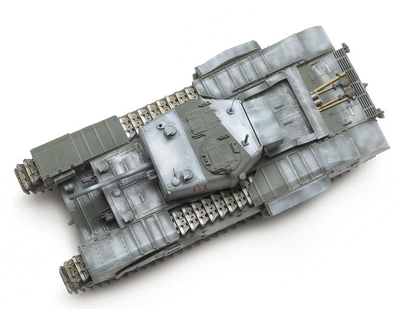

The vinyl tracks were a bit of a letdown, with ejector-pin marks on their faces; aftermarket individual-link tracks will suit those who want more detail. The instructions make no suggestions for joining the track; I tried different glues, and the only one that did the job goes by the name of Goop. You could sew the ends together and place that section under the track cover. With the track covers being separate pieces, you can choose whether to install all or just a few. There is no definite location for the back top track covers, so I used the two bolt heads in the illustration as a point of reference. This caused a fit issue for the two center pieces (parts B31 and B18). I planned on leaving those pieces off anyway, so it is better to start at the front and work your way back.

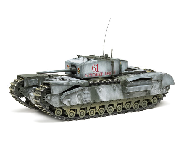

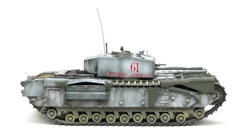

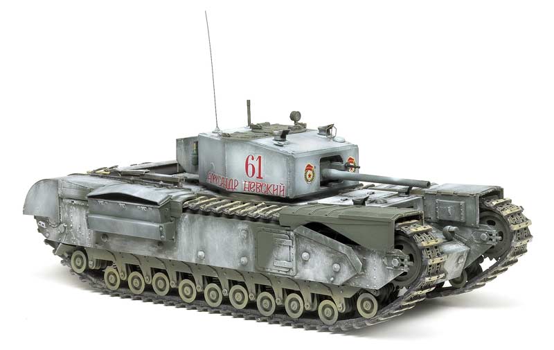

I dithered over the four markings but finally settled on the Soviet Lend-Lease vehicle. I painted it Floquil Pullman green and used Tamiya pastel white for the temporary snow camouflage. The tracks were painted with Tamiya metallic gray (XF-56).

I was glad to see this model of the Churchill shown as it fought on the European and African fronts. The kit has a lot of modeling potential, but, because of its complexity, I cannot recommend it to beginners. It took me 30 hours to complete this kit.
