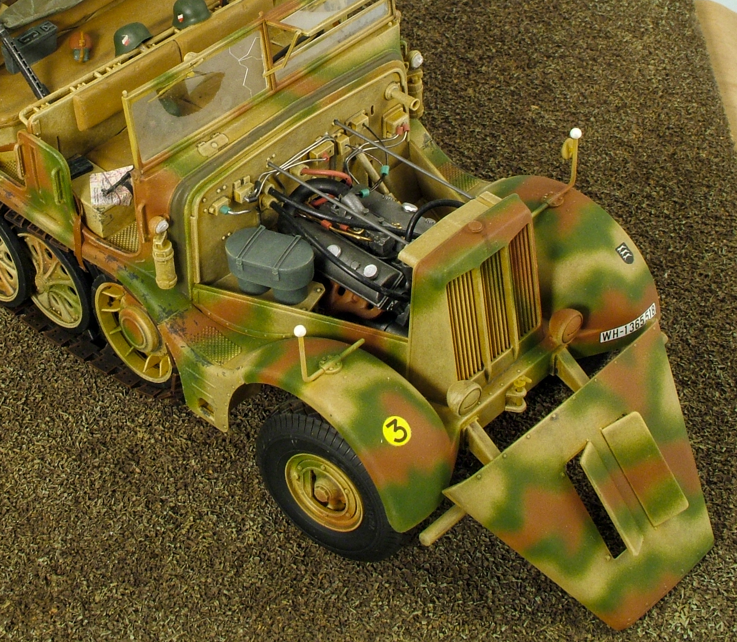

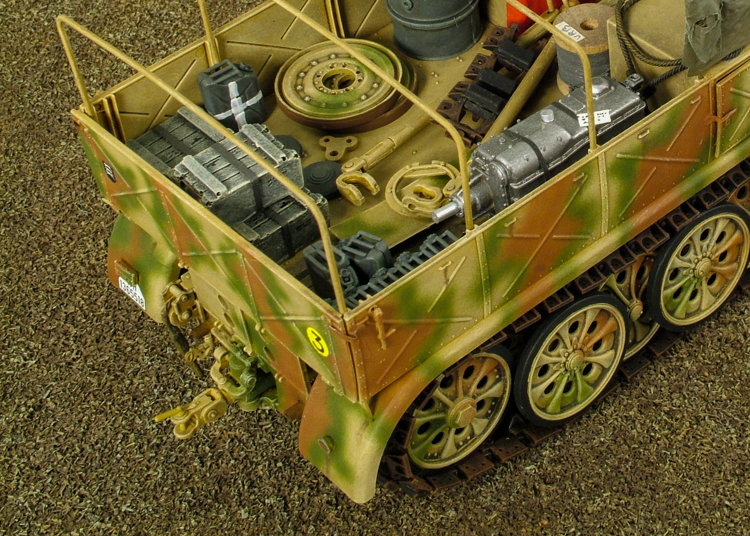

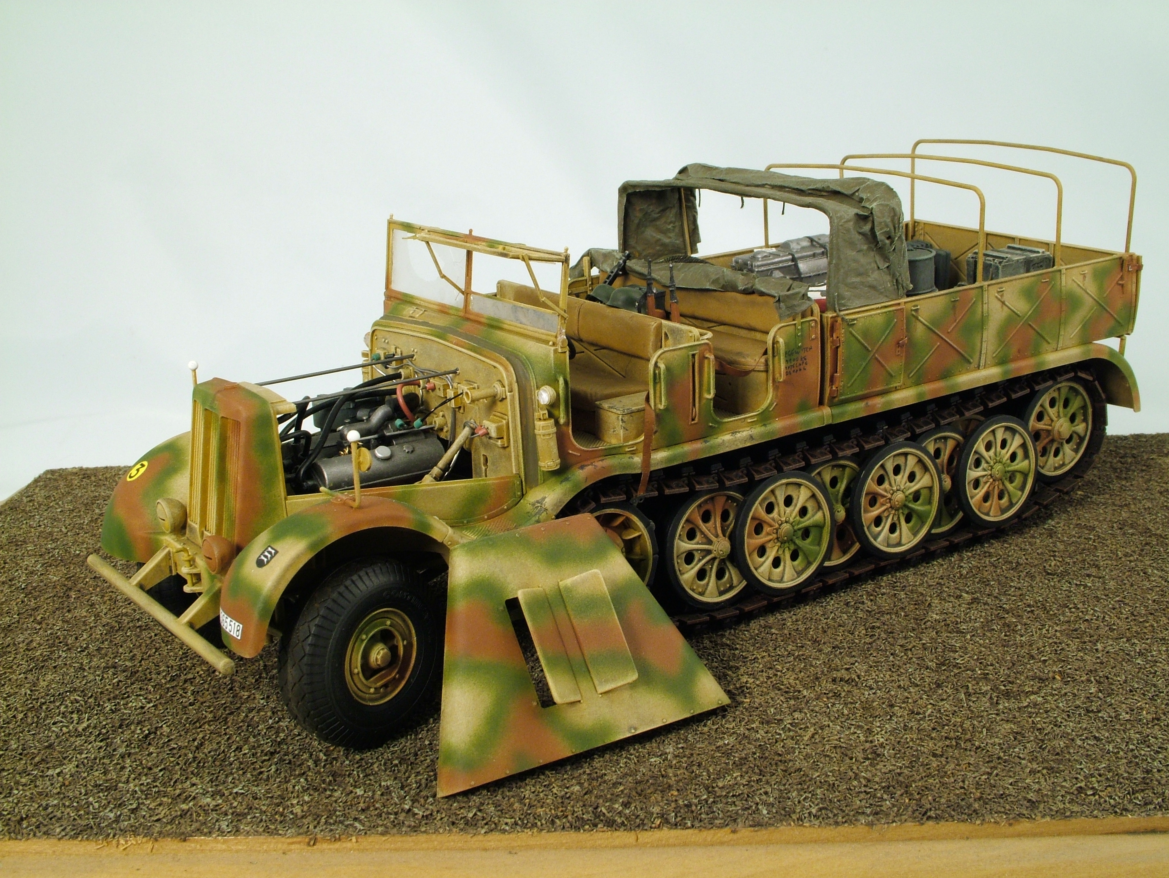

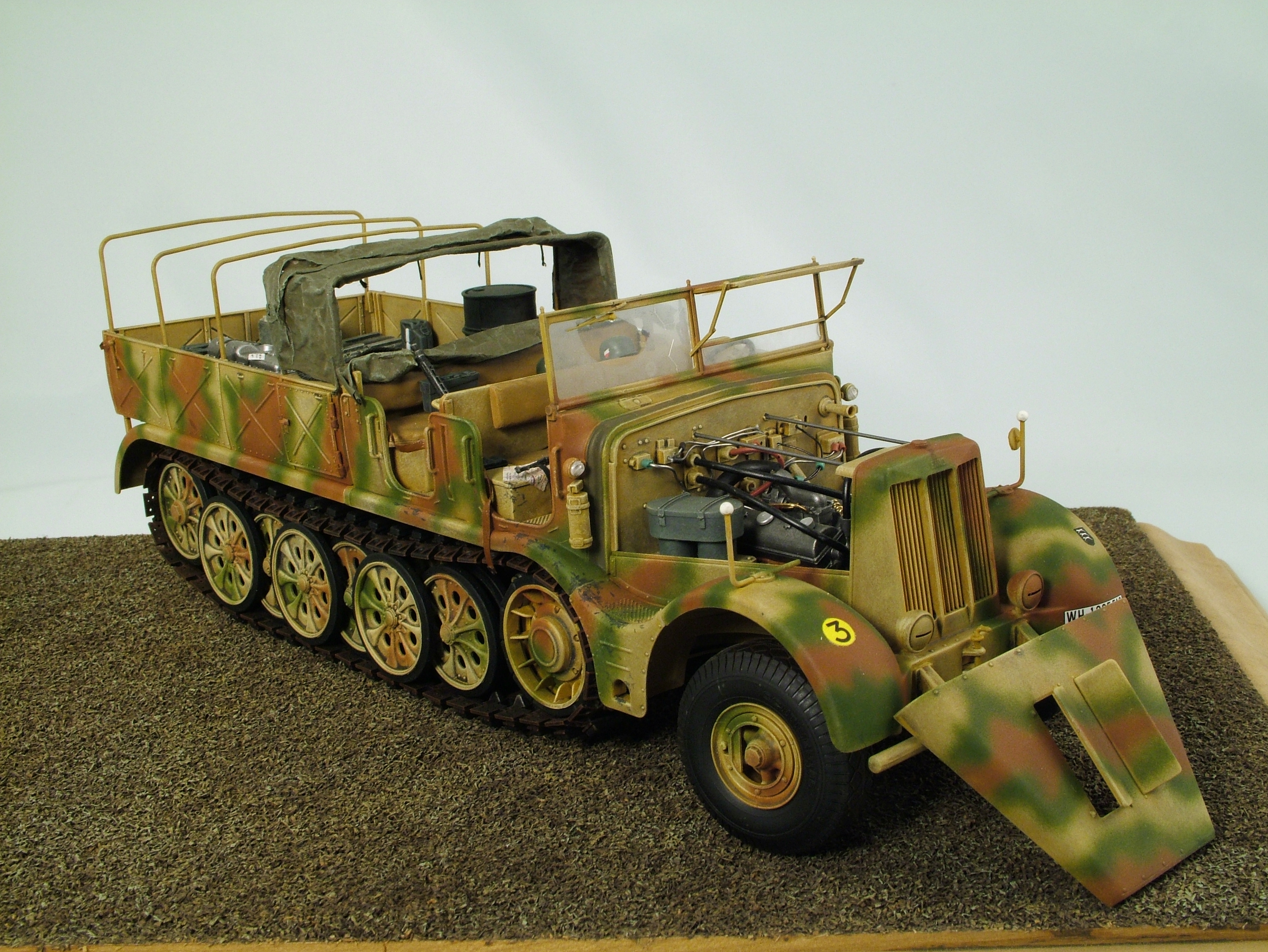

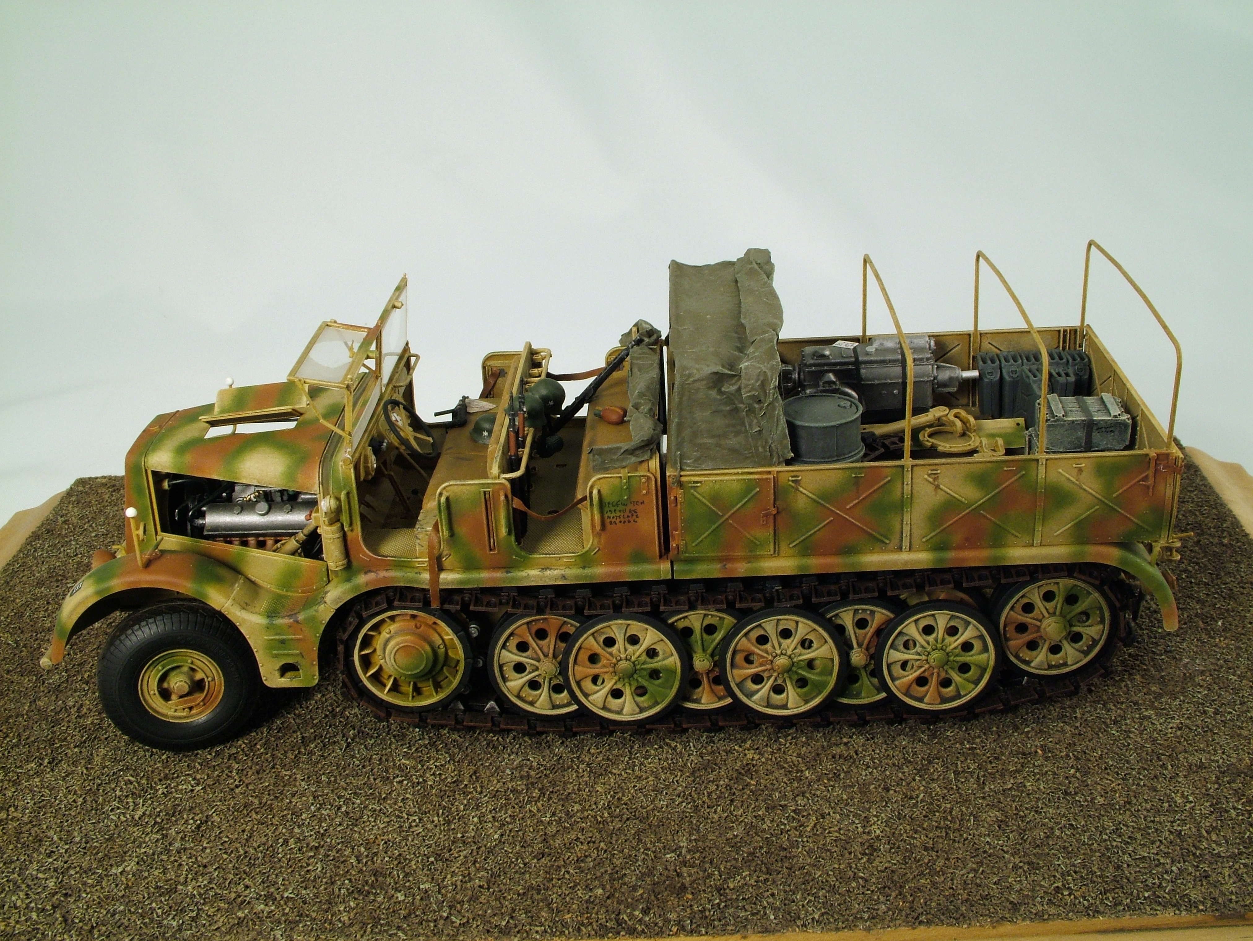

1/35 scale SdKfz 9 18-ton halftrack
Basically built out of the box, I made the doors and the tailgate functional and superdetailed the engine and firewall. The cargo bed has all sorts of parts that might have been found in a real halftrack during the war, and I made the canvas top. I used the kit decals and Testors paint.

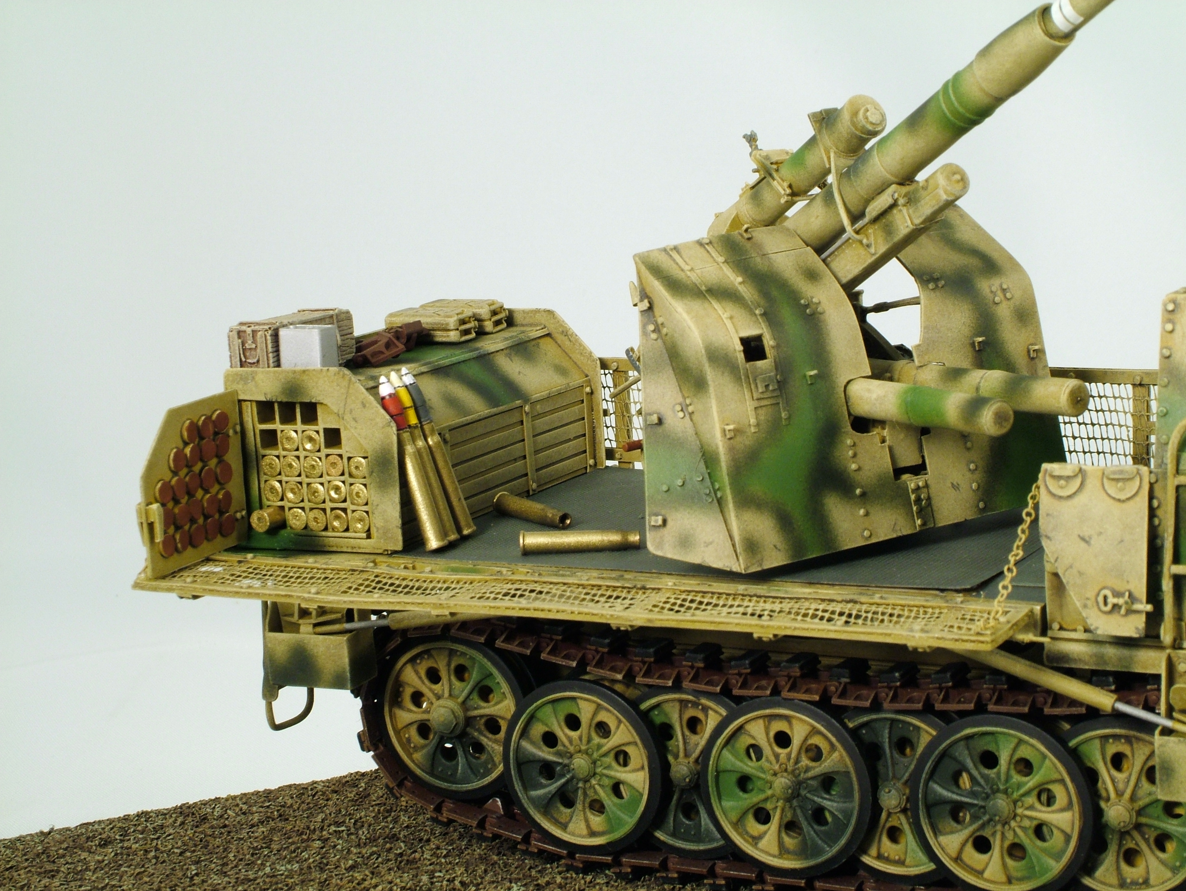

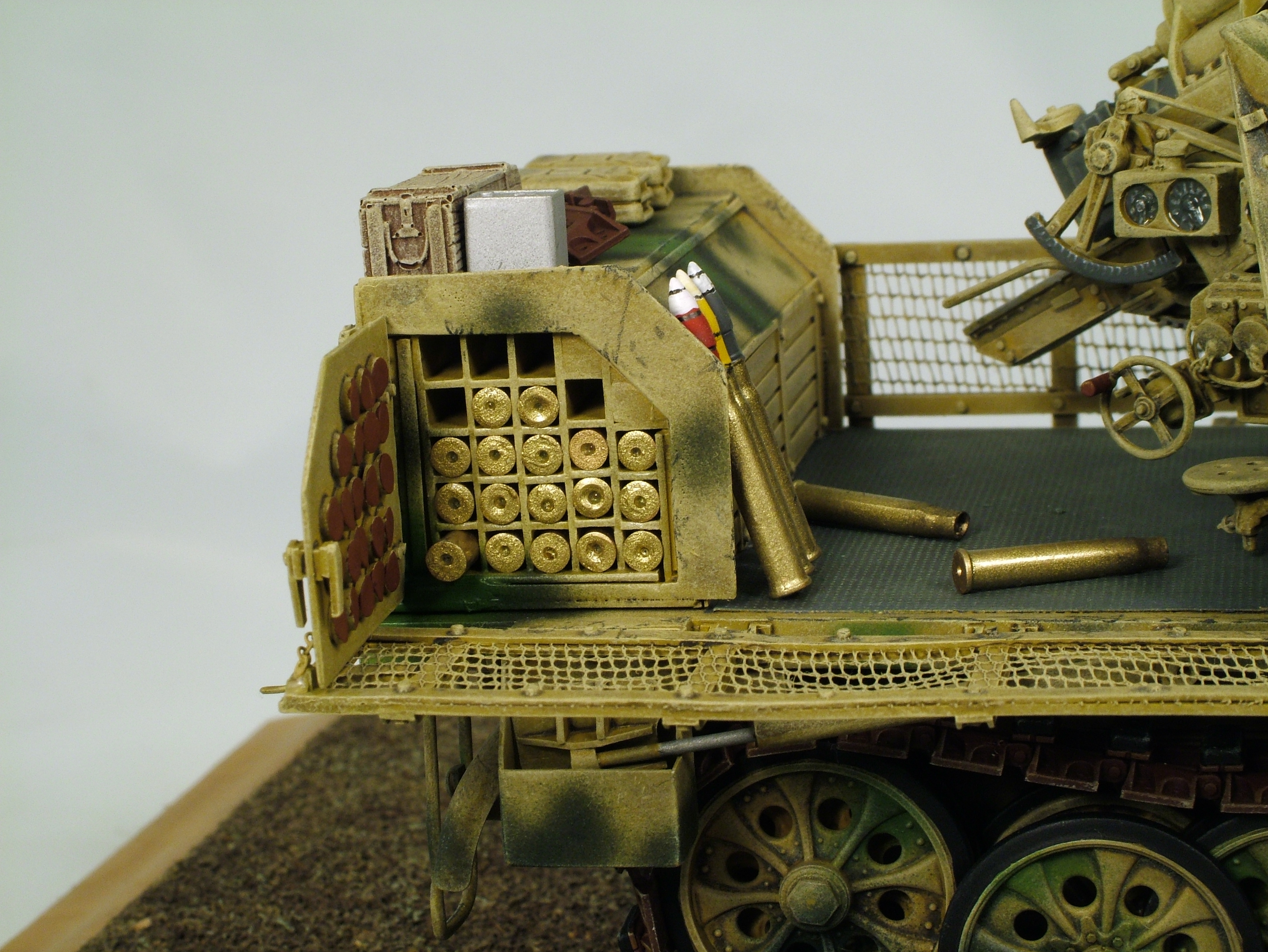

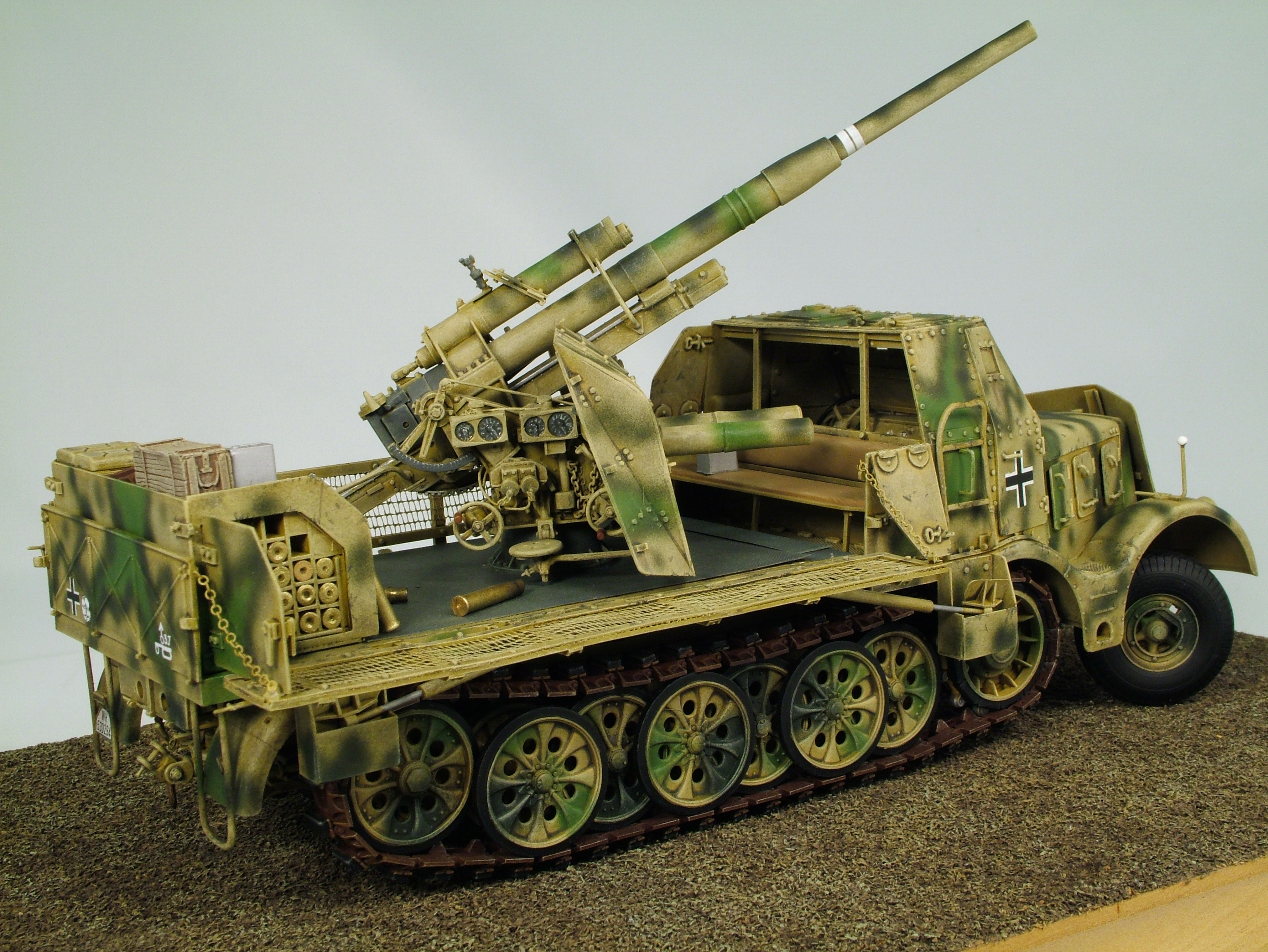

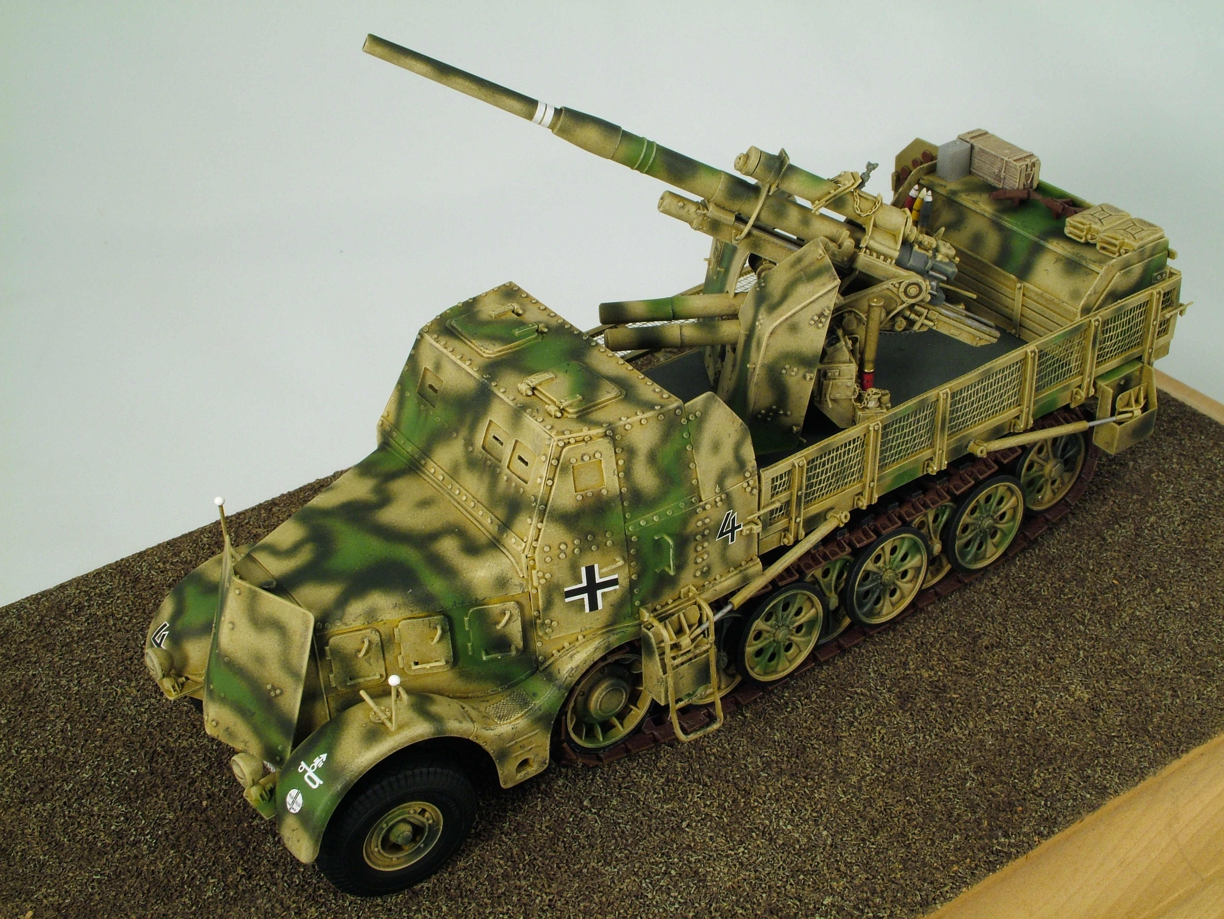

1/35 scale SdKfz 9 halftrack with 88mm Flak 37 - Flakartillerie Abteilung 304
Using the basic Famo frame, I scratchbuilt I-beams to support an extended, scratchbuilt cargo bed. A photo-etched metal tread plate was glued in place. The side drop gates, ammo box, side steps, outriggers, armored cab, hood, and front armor plate were all scratchbuilt. I modified the Tamiya Flak 37 kit, scratchbuilding the gun shield and backdating to an earlier version. I scrounged details from my spares box and painted with Testors enamels.

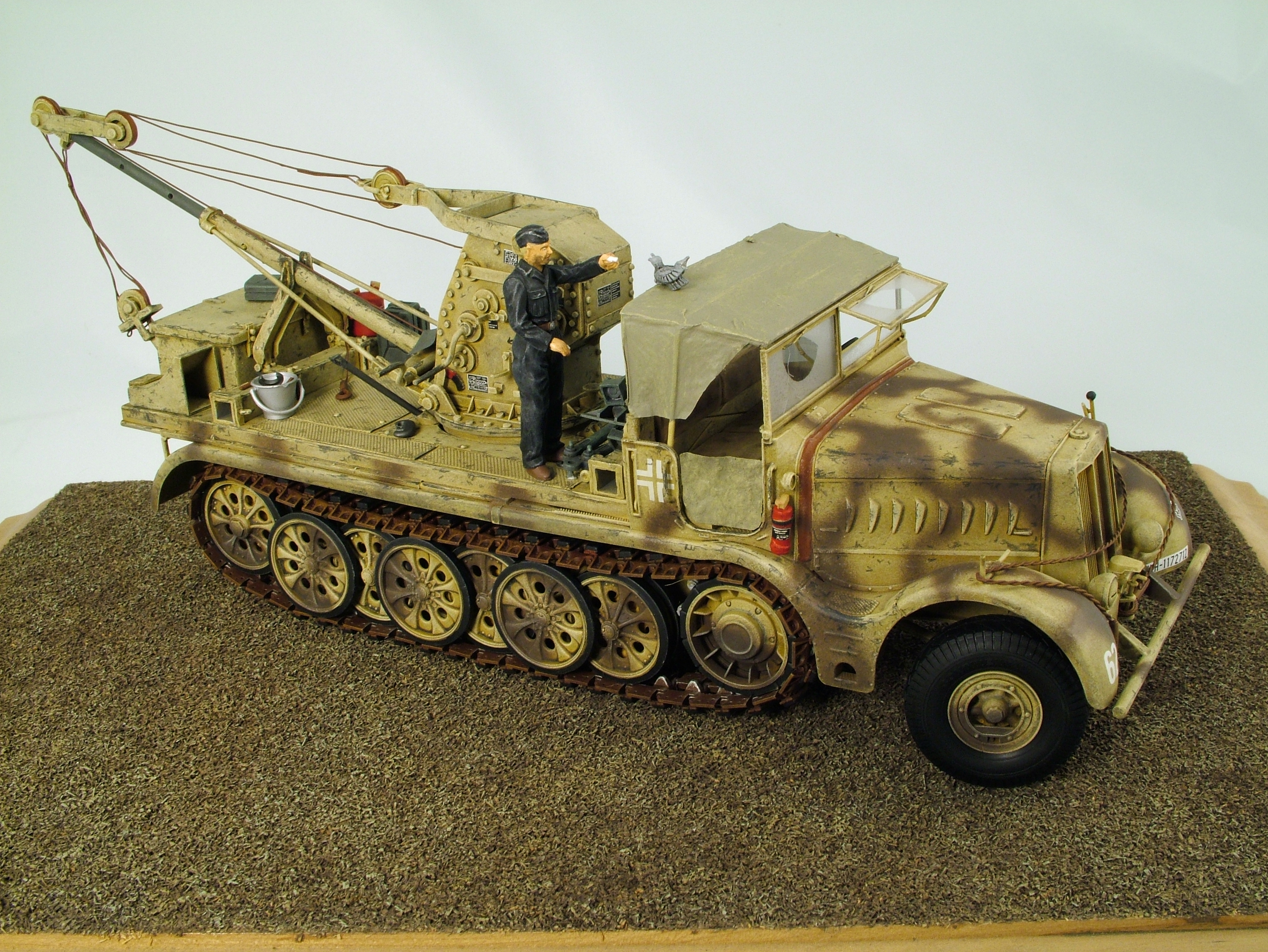

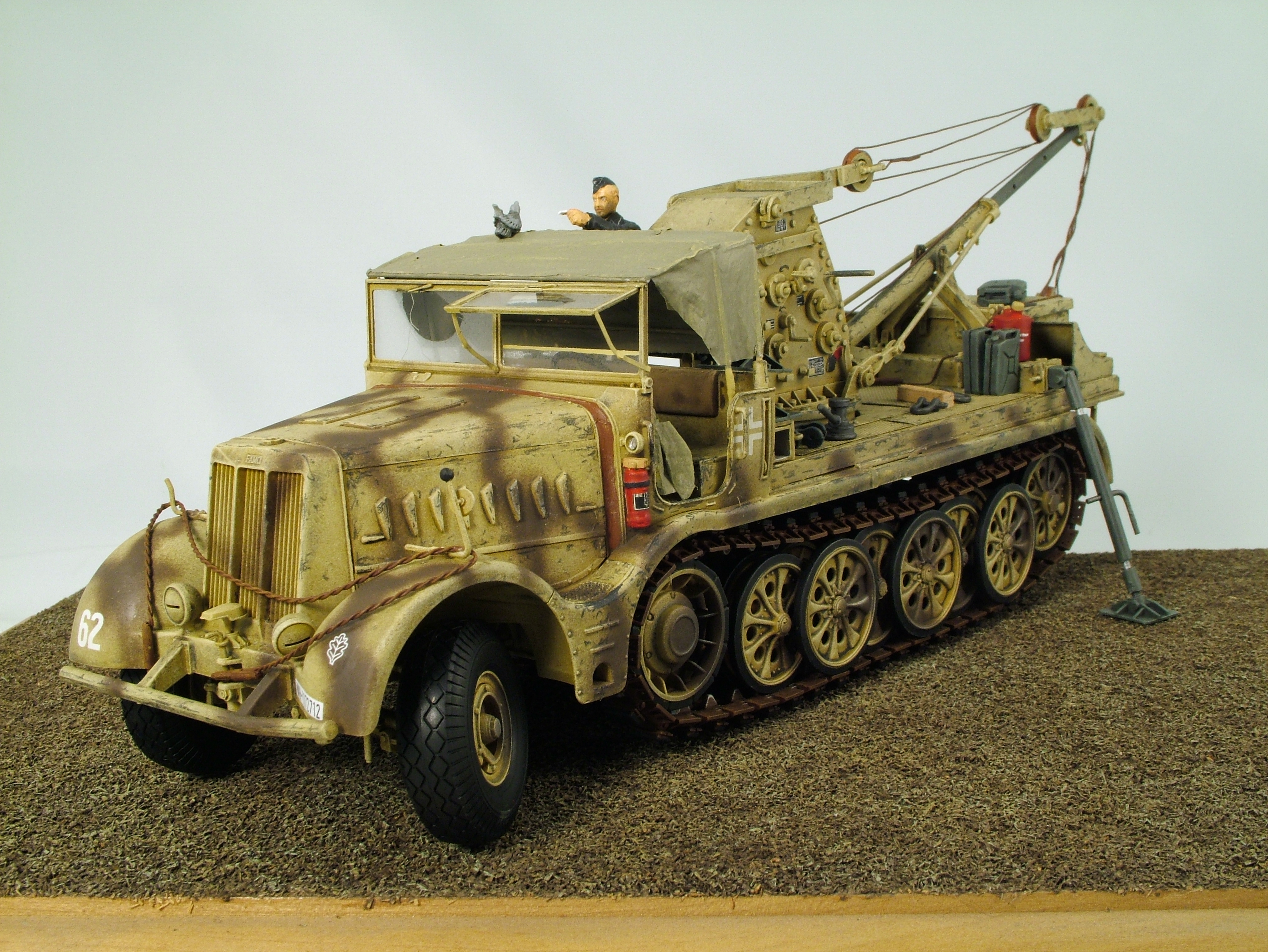

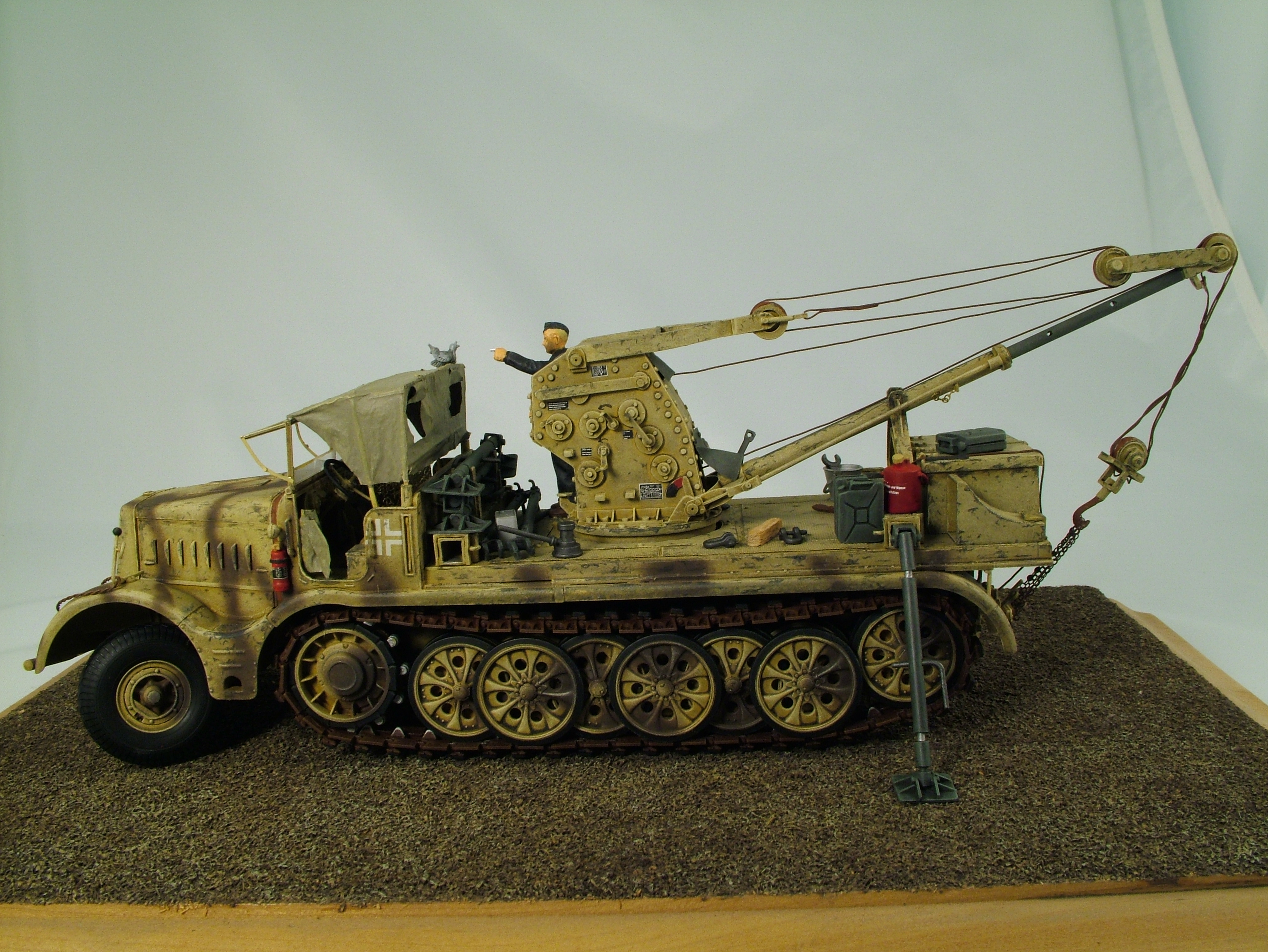

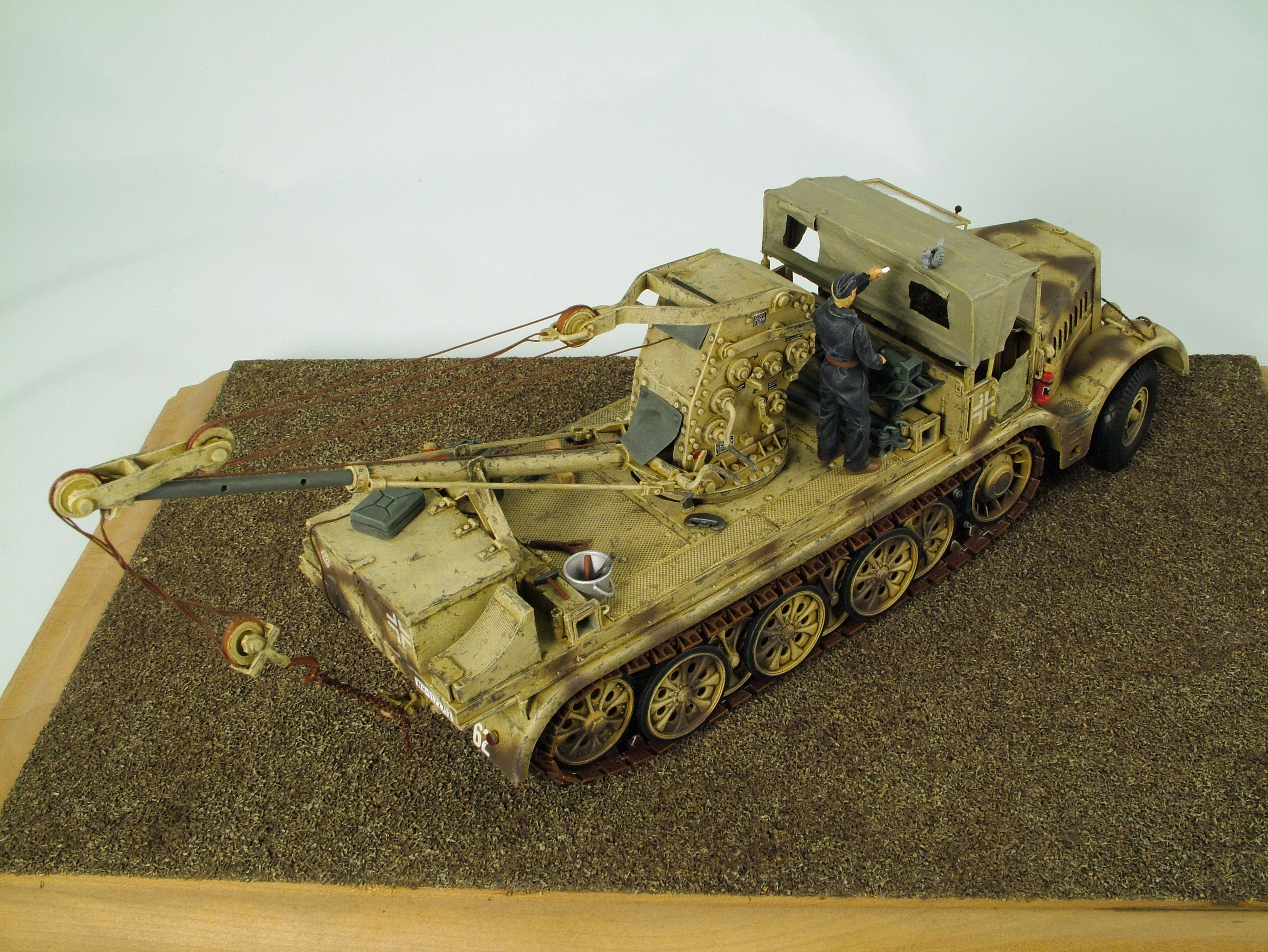

1/35 scale SdKfz 9/1 with 6-ton Bilstein crane
Again, the Tamiya frame was the starting point for this model. The cargo bed was stretched and scratchbuilt. Brass tread plate was applied. The Famo’s rear cab was removed, and a canvas top was made using gift-wrap paper. The aft toolbox, outriggers, mounts, travel lock, and wheel chocks were all scratchbuilt. The Bilstein crane was completely scratchbuilt with about $5-worth of materials, like Evergreen plastic sheet, tubing, rod, and tin. Tiger Model Designs sells a resin kit for much, much more! The figure is from the Tamiya kit, and I swiped the bird from my daughter’s charm bracelet.
