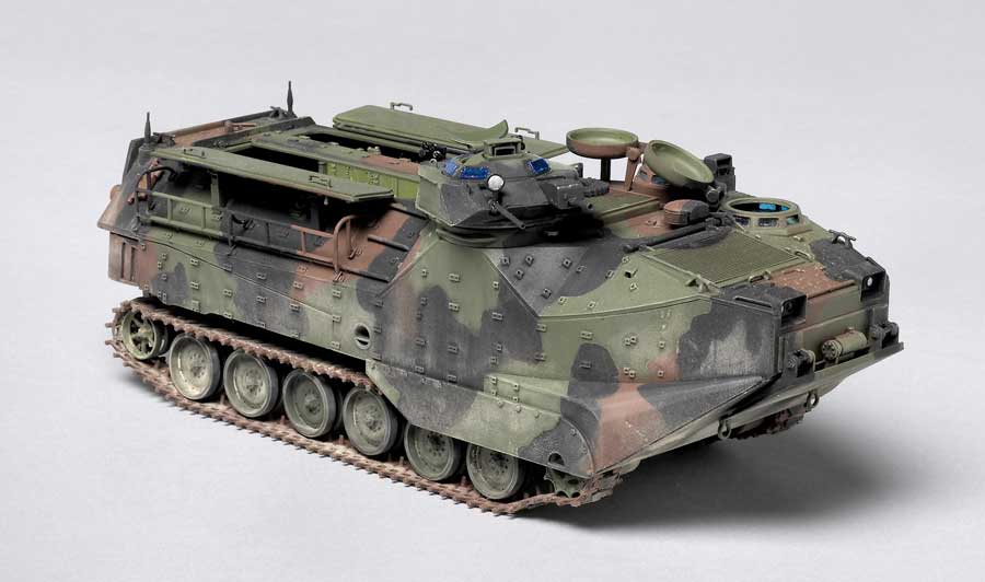

The tracks snap together long enough to place and glue them. I added the rubber track pads after assembly and painting.

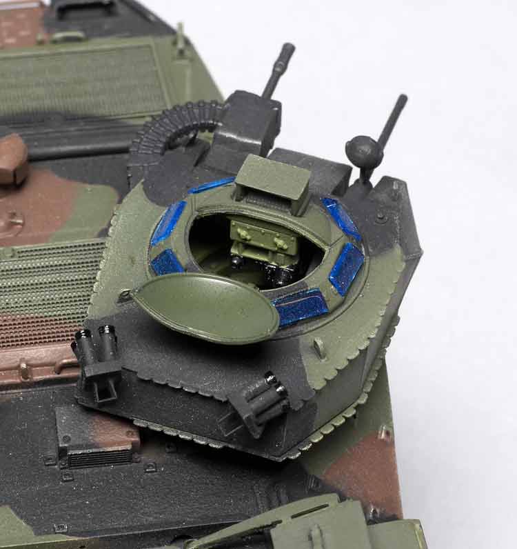

There is a lack of color instructions for the interior or any of the detail parts of the interior and exterior - but good reference pictures abound on the Internet. I painted the interior Polly Scale interior green lightened with white. Tamiya clear blue spray covered the clear parts.
A color sheet shows the three-tone camouflage scheme and indicates three different paint brands. However, these instructions are incomplete. I painted with Tamiya NATO colors and used Silly Putty to mask the patterns. The decals went on just fine.

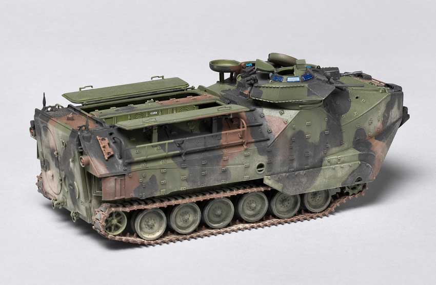

It took me 34 hours to build the AAVP7A1, with most of the time spent building the interior and cleaning up and assembling the track.
The vehicle matched scale drawings I found at www.the-blueprints.com (you'll have to register to see them). Now all I need to finish off this model is a ton of personal equipment - packs, tents, tarps, and any of the slew of other items you usually see stowed on these vehicles.
