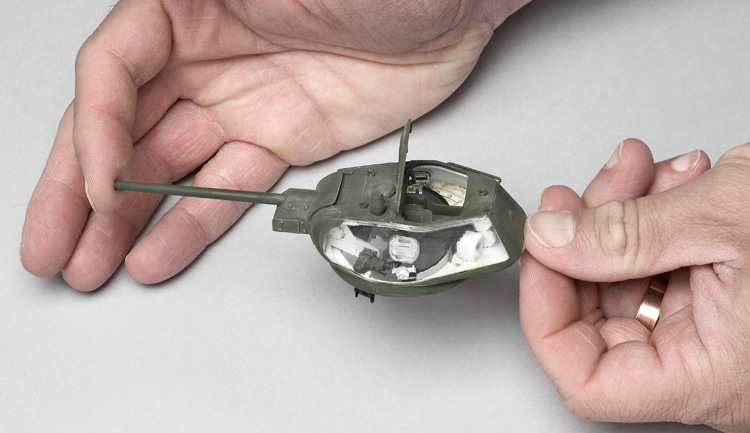

Building the turret was straightforward, although a large seam on the back of the turret needed filling. I substituted turret hatch cover support Part E14 (open position) for Part E15 (closed) and painted the interior Tamiya white. The main armament is Tamiya J.A. green XF-13.
