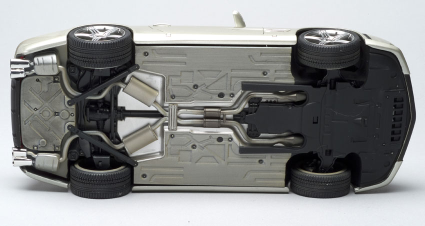

The chassis also is nicely detailed, including a working suspension (though the actual range of motion is only a millimeter or two). The only issue I had was the very difficult assembly of the wheels and poly caps on the suspension and axles; they’re loose and wobbly. The discs are well-detailed with vents molded on the outside, but there are ejector-pin marks and plating to remove before painting. The brake discs should rotate with the wheels, as they are loose inside the two-piece calipers. While clean on the outside, the inner wheels needed attention before assembly to remove sprue attachments and ejector-pin marks prior to painting. Still, the wheels can be easily turned to a perfectly aligned position. Considering how well the suspension fit the chassis, I would be comfortable attaching the wheels to the brakes/axles/hubs before attaching those subassemblies.
The exhaust system is one of the more complex and visible parts, and requires careful preparation to remove visible mold lines.
