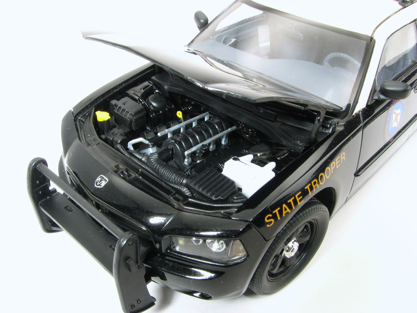

The engine is the basic 5.7-liter Hemi. Watch out for incorrect instructions: The engine top is shown backwards. The intake manifold that fits above it needs the vertical slot facing the front of the car, not the back as the instructions show.

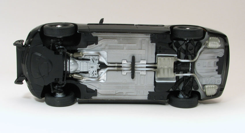

Otherwise, assembly was straightforward and well detailed. Most police Chargers omit the intake dress-up parts optional in the kit. The chassis is packed with detail and goes together well, though it is a tight fit into the body under the front fenders and the stance seems slightly too tall. The front wheels can be made to steer using parts 83 and 84 to trap the tie rod on the front struts.

A couple of decals for the front fenders are missing, shown in the box art but not included. I built the Florida version. The decals looked good and applied easily.
There are eight different lightbars supplied; some of them need more inner detail, especially in the reflector areas. The lightbar designated for Florida is incorrect; I used one of the lower-profile lightbars, not an exact match but closer.
