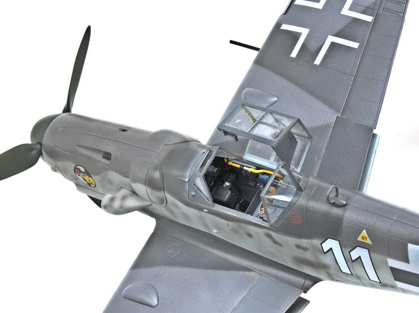

Following the instructions, I started with the cockpit construction. Options include either a plastic or photoetched-metal seat bucket along with photoetched-metal seat belts. The instrument panel is provided as a solid clear part. I drilled out the instrument faces so I could more easily paint the panel and show each instrument decal placed behind, or “inside,” the panel.
Trumpeter has molded the fuselage with separate panels for the engine compartment. This makes the front fuselage susceptible to warping, as it was in my kit. Installing the cowling panels helps eliminate the warp. I believe if you plan to have the cowling panels open, it will be a challenge to true up the fuselage in this area.
The engine creates a very tight fit for adding the cowling parts, particularly the lower cowling part. I needed several dry runs to figure out an assembly plan. An important detail became obvious — the lower cowling assembly must be installed first when bringing all the fuselage parts together. This will help spread the fuselage. I believe any other sequence will narrow the fuselage, creating a fit problem for the lower cowling part and large gaps at the wing roots. Also, do not glue the cockpit/engine module — just test-fit its position so it has some movement.

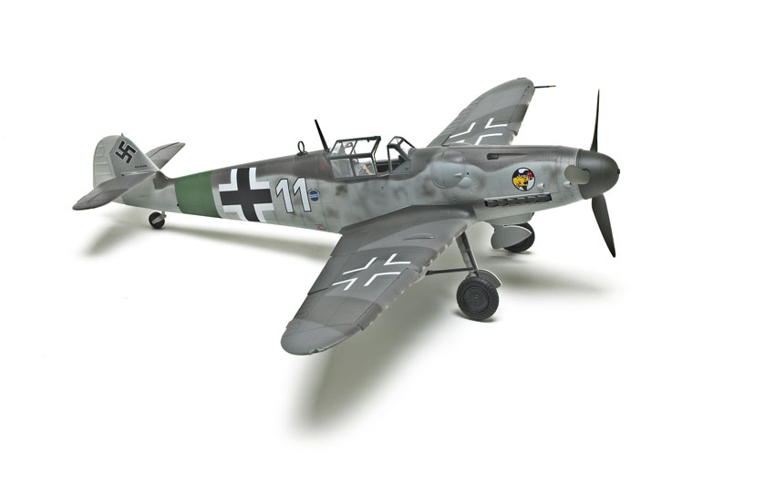

Based on the references, the Trumpeter kit is a mixed bag of accuracy. It has better proportions for the cowling forward of the windscreen than Hasegawa’s kit, but there are shape issues going back from the cockpit to the tail. The rear cockpit angle seems too steep, and the tail and rudder profile look off.
I completed my Bf 109G-6 in 28 hours. I had high hopes for this kit, but fuselage fit and shape issues were a disappointment. On the positive side, the completed model does look as sleek as a Messerschmitt.
