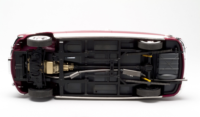

Obviously, the main difference between this kit and the earlier Hornet kits is the new convertible body. A new interior boot across the back seat is added, as well as some subtle changes to the interior door panels. Virtually everything else remains the same. There are also a few parts left over from the racing version, and a set of chrome “steelie” wheels to go along with the factory set.  The front and rear suspension mount on a separately molded frame and are designed to make sure the completed car sits flat. The interior builds up on a floor pan, with separate inner door panels and bench seats. Although it seems somewhat simple in terms of parts count, everything is beautifully detailed and molded.

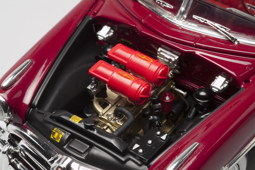

The body has a few small mold lines, most noticeably on the front fenders and across the rear trunk. Once the body is prepped, it and the hood, dash, fire wall, and sun visor can all be painted in your color of choice. I used House of Kolor Maltese maroon on the review model. This body doesn’t require quite as much Bare-Metal Foil as the standard version. But be prepared to spend some time foiling — there is a lot of chrome on this car.
My preferred method when attacking these kits is to get all the body panels prepped and painted. Then I paint all the individual parts in their respective colors. Once the metal foiling is done, all the individual parts and subassemblies can be brought together very quickly. The design of the kit and the detailed instructions make assembly go smoothly.
I did have one small issue with the front window, though. It is made to snap into the front window frame, rather than just sit behind it. Without paint or foil, it fits in place perfectly. But once the body edges have been foiled, it is easy to damage the delicate foil when the window is snapped in place. The marriage of the body to the chassis/running gear goes exactly as it should, with the chassis snapping into the body perfectly. The final bits of chrome, such as the bumpers, mirrors, and wipers, can now be added.
