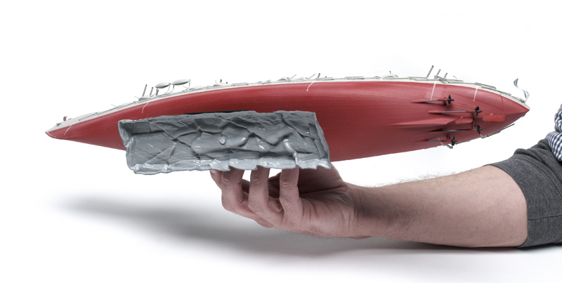

Zvezda’s Sevastopol comprises 432 parts on eight sprues molded in light gray plastic with better-than-average detail. Four clear parts provide windows for the conning station. A decal sheet and paper flag sheet are included for the Sevastopol only. You can build a full hull or waterline it using a deeply scored line on the inside of the hull sides. The lower hull has a rough texture compared to the upper hull sides and is apparently finished that way on purpose. A display stand is included.

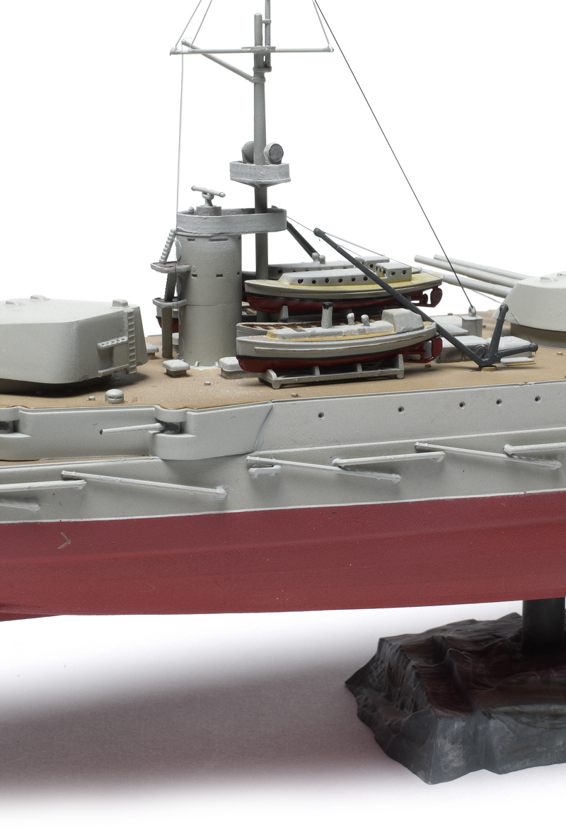

In Step 1 you must decide whether to mount the anti-torpedo booms and service platforms; the guide holes are impressed on the inside of the hull and are easily hand-drilled. The lineup for parts fitted later is perfect, so you can trust your drilling. Or you can decide not to mount the booms and keep the hull sides flush. Either option is correct for 1914-17.
From the very start, there was evidence of the close tolerances of this model as the hull halves stayed together without glue. I completed steps 1-5 quickly, except for mounting the 16 casemate guns.

After sealing the decals, I mounted casemate guns as steps 6-14 moved right along. Trim the undersides of hatch covers F3/F4/F5/F6; ejector-pin remnants on some will prevent flush fitting to the deck mounts. Step 14, where the booms and working platforms are added, only denotes the port-side placement. But rest assured of the symmetry of the part numbers for the starboard side.

Steps 24 and 25 reveal missing parts; eight funnels are needed for the four boats, but only six are on the two sprue trees C.

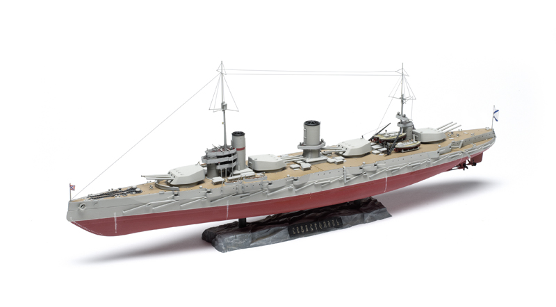

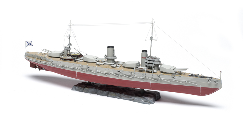

By Step 30 the masts will drop in place, perfectly aligned and supported by the decks. This was a nice feature. Regarding the masts, the lower, wide, forward yardarm noted on the box art is not part of the model. A 1914 photograph shows just a narrow crosstree on the leading edge of topmast support platforms. I used stretched sprue for the ship’s rigging.
A final note about decals: The double-head eagle (Decal No. 1) will straddle the stern; that’s not clear in the instructions.
Painting with Testors Model Master Acryls, I used: flat gull (No. 4763); wood (4673); and German gray (4795). I also applied Testors flat red (No. 1250) and Tamiya red (X-7) enamels along with PanPastel ultrasoft gray and umber pastels.

The tight fits result in a model with no fillers. The deck could have been left unglued — a tribute to Zvezda engineering.
I spent 92 hours building my Sevastopol. It was a pleasant time with no surprises or glaring faults to correct — and I learned a great deal about the tumultuous times from 1914 to 1921 in the Baltic region against the backdrop of the Russian Revolution.
