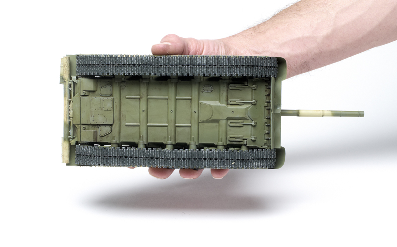

Construction starts with the hull. Note that the slightly larger gaps between the front plate (C4), the rear plate (B1), and the upper plate (A1) are supposed to be there.
Generally, I leave the running gear off until the hull is painted. But Xact uses an unusual system of gluing the road wheels and drive sprockets to their mounts, and I thought it would be easier to paint the parts as I went along. I had a bit of trouble bending the photoetched-metal mud extractors for the drive sprockets, even though Xact provides a template for them on the fret. With no crimp lines in the metal, it is difficult to determine exactly where the creases need to be.
The one-piece tracks fit well, but one side of each track has a few distorted end connectors. I made sure that I installed the tracks with those sides facing in. Also, one track had an unusual twist in it that I could not correct; I hid this area of the track under the fenders.

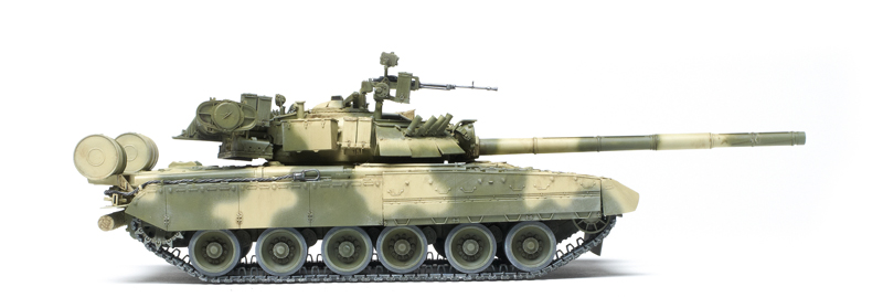

I chose the light tan and olive color scheme for my T-80U, mixing Tamiya paints according to the instructions. After a coat of Vallejo clear gloss, I gave the model a pinwash of Vandyke brown artist’s oil and followed with a coat of flat clear. Finally, I dry-brushed the model with lighter shades of the base colors.
After several attempts at using the material supplied for the tow cables, I gave up and made my own by braiding four strands of .020" lead wire.
It took me about 27 hours to complete my T-80U. The numerous small and delicate parts really put this model in a class for experienced modelers.
My tank matched exactly the dimensions posted on Wikipedia for the T-80U. Xact should be proud of its initial release. I’m looking forward to seeing what comes next.
