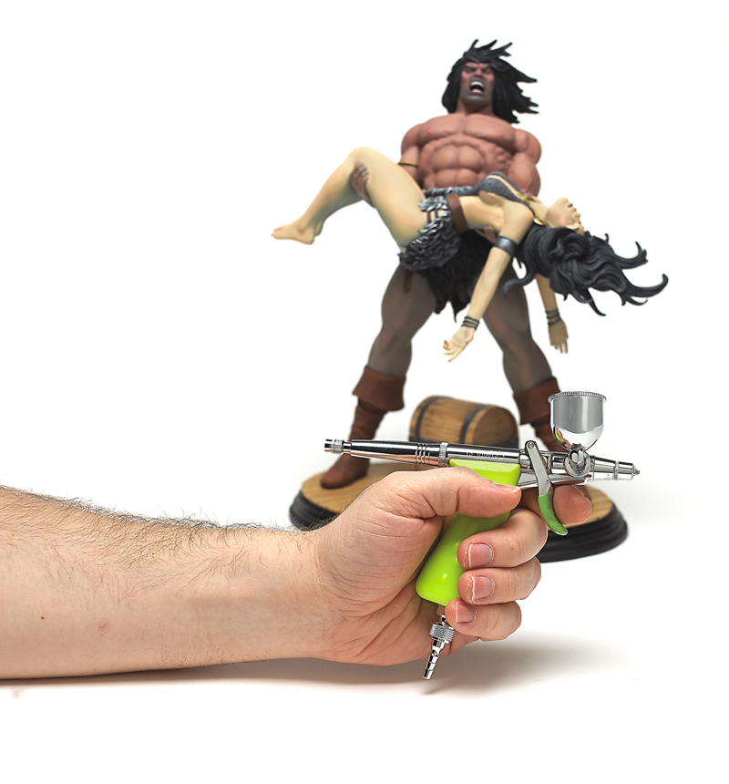

Grex Tritium.TS3
I'll be upfront with you: I like Grex’s Tritium.TS3. I know some will look at a double-action, internally mixing pistol-style airbrush and think it's hard or uncomfortable to use, but nothing could be further from reality. I painted most of a 1/6 scale figure while testing my TS and found it provided reliable performance and enjoyable sessions.
The TS comes with three side-feed paint reservoirs: two metal gravity cups (1⁄4 and 1/2 oz.) and a 1-oz. siphon bottle. All three mount to the side of the airbrush and are adjustable to allow for painting at odd angles without spilling. To me, the reservoirs are the weakest part of the TS3’s design. Because they screw into position and are secured with a locknut, the reservoirs must be turned upside down to remove — not always the quickest or cleanest of operations. I think I’d prefer a friction fit instead, like on an Iwata. Luckily, this is possible with an optional adaptor (No. AD31).
The “quick-fit” needle caps are one of the coolest design elements of the TS. The airbrush comes with both a standard and crown cap that can be easily removed from the magnetic nozzle cap and swapped. I found myself switching from one to the other on the fly as my painting needs changed from broader strokes to detail work and back.
Unlike sessions with my Genesis.XT, I never suffered fatigue using the Tritium’s ergonomic handle. The trigger mechanism operates smoothly, and the preset knob on the back of the brush is useful for painting consistent line widths. Moreover, the TS is suitable for right- or left-handed use.
The TS disassembles easily for cleaning. However, I’ve found that special attention must be paid to the fluid nozzle. At .3mm, it can be clogged with acrylic paints. So, be prepared to disassemble the brush between color changes and give it a thorough washing before proceeding.
 Veteran painters who are used to the more-traditional pen-shaped airbrushes may not want to add this brush to their arsenal, but I think the TS would make a great place for beginners to start. It’s pricey, but most quality airbrushes are. The TS, if properly cared for, will last your entire modeling career and allow room for growth with optional nozzle sizes and performance kits.
